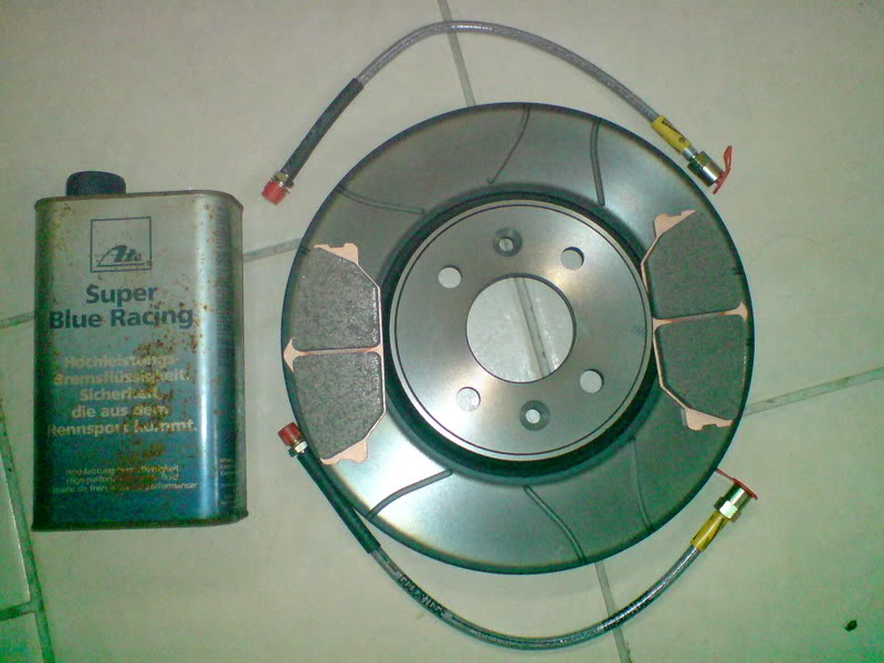

My Carbone Lorraine pads came this morning will have them fitted by next week will let everyone know how good or crap they are people have already said they squeal but hey that the price you pay for performance here is a pic of my set up.
you'll have fun cleaning the brake dust off the paint work, and you'll eat the max discs running those pads with them
they'll work well though!
we got through 2pairs of max and 1 pair of HC discs to 1 set of PF97's
