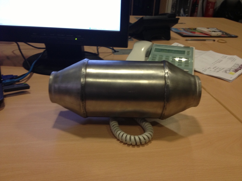

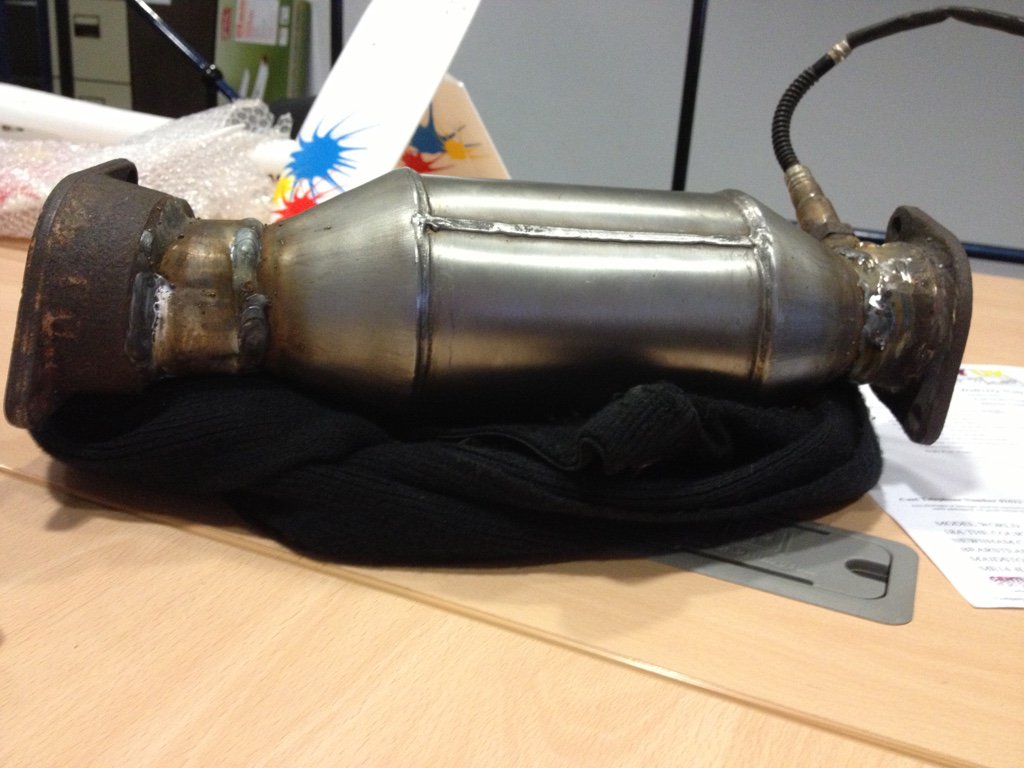

The main reason i got mine was my 172 cat had died, and it was cheaper to get a 182 manifold and link pipe than a new cat.
Then i found a sports cat cheap on ebay (£30) and had a custom sport cat link pipe made using the flanges off the 172 cat for mots.
Atleast with the 182 manifold, cat/decat swaps are easy
