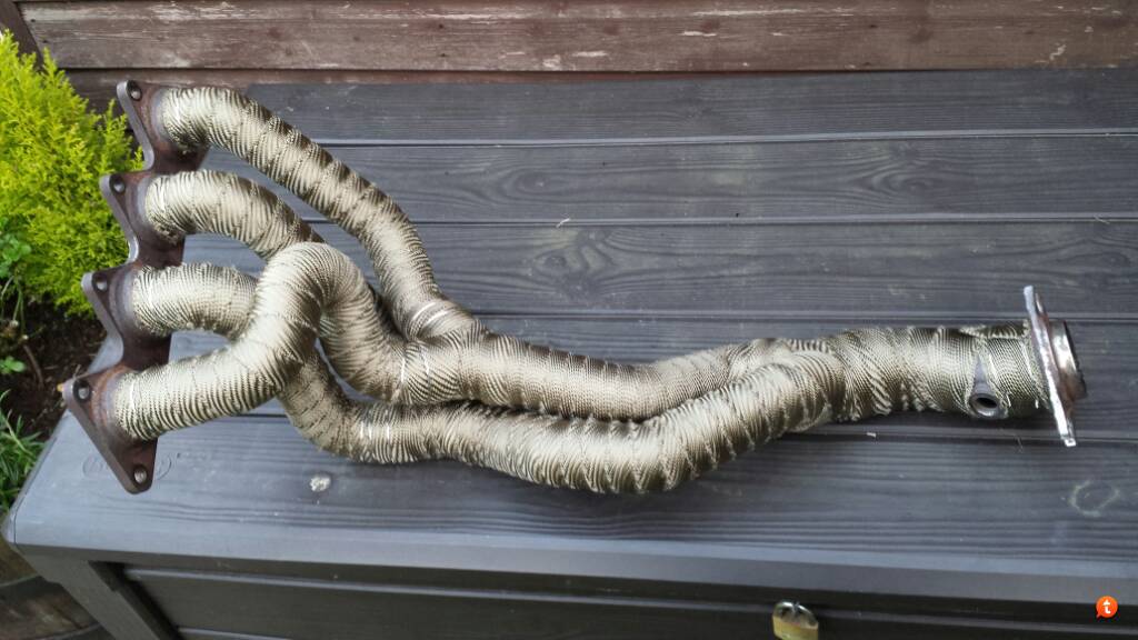

I'll always pop over to help, mine all wrapped up. :cool:
That looks good Scotty.
