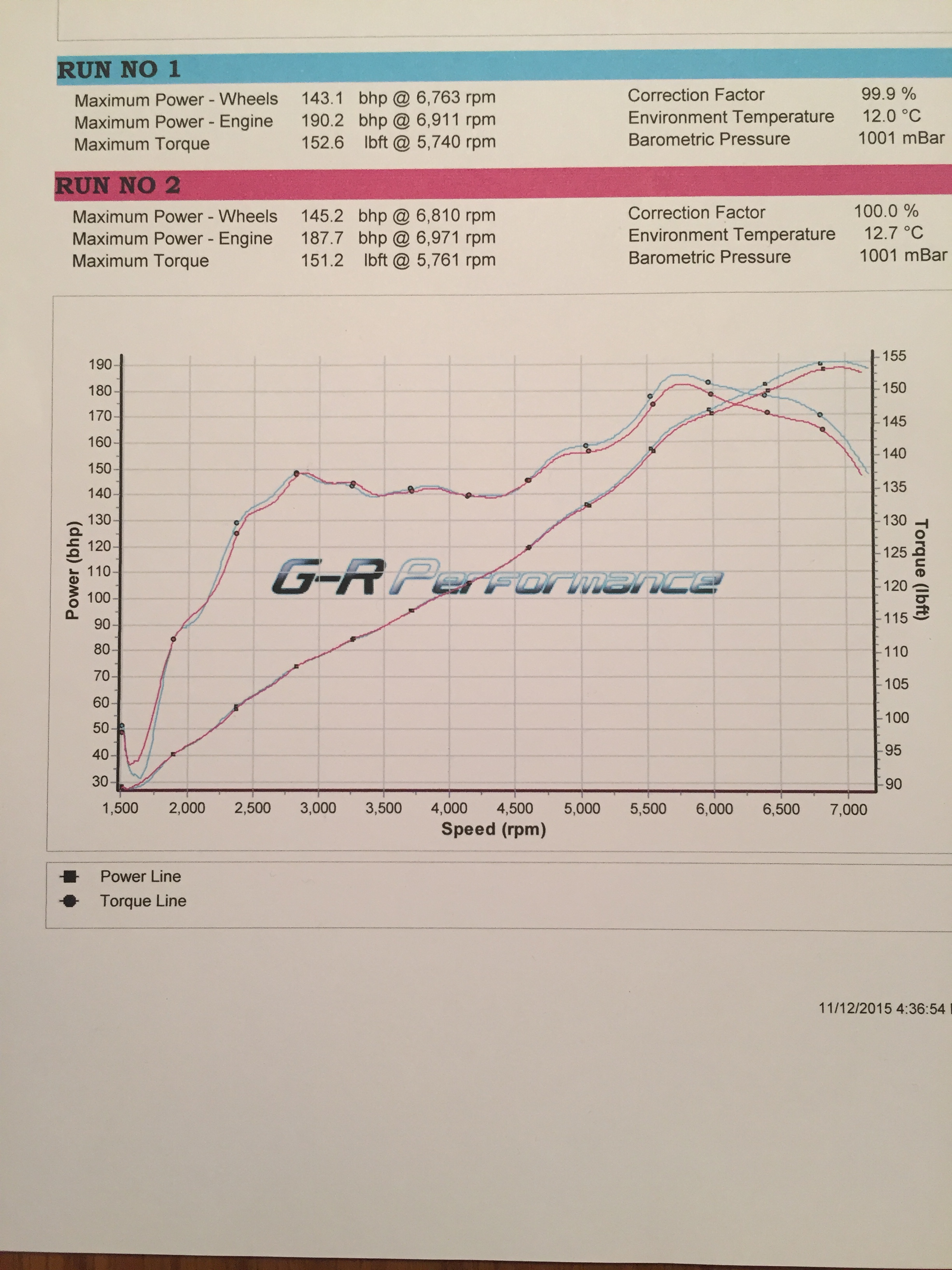

So after recently purchasing my 182 for track use next year, I decided that before we started to spend money replacing things in the search for more power that we should run it on the RR to see what sort of power she is making. I run an ECU re-mapping company in south Yorkshire so it was without question that we should make some changes to the map on there to suit the mods the car already has. It has a dirty piper X air filter with no cold air feed, a gutted cat and a Scorpion cat back exhaust system.
After putting our stage 1 Re-map on here, raising the rev limit to 7100rpm as I simply could not stand the standard 6700rpm it achieved 190,2 bhp and 152.6 lbft
After looking at many other results people have had id say im pretty happy with these results at the minute given the cars state.
We could modify the fuelling further to get it running slightly leaner although im planning on making my own intake for it so were going to wait and see how the fuelling is with this.
Whats everyones thoughts
Thanks
On run 1 it runs less power at the wheels than run 2, but in run 2 it makes more power at the fly than run 1.
How does that happen?
It's an inaccurate way of testing really. They run up then let the rollers run down and measures transmission loss. Easy to forge results like this by doing stuff like touching the brakes to get transmission losses up.

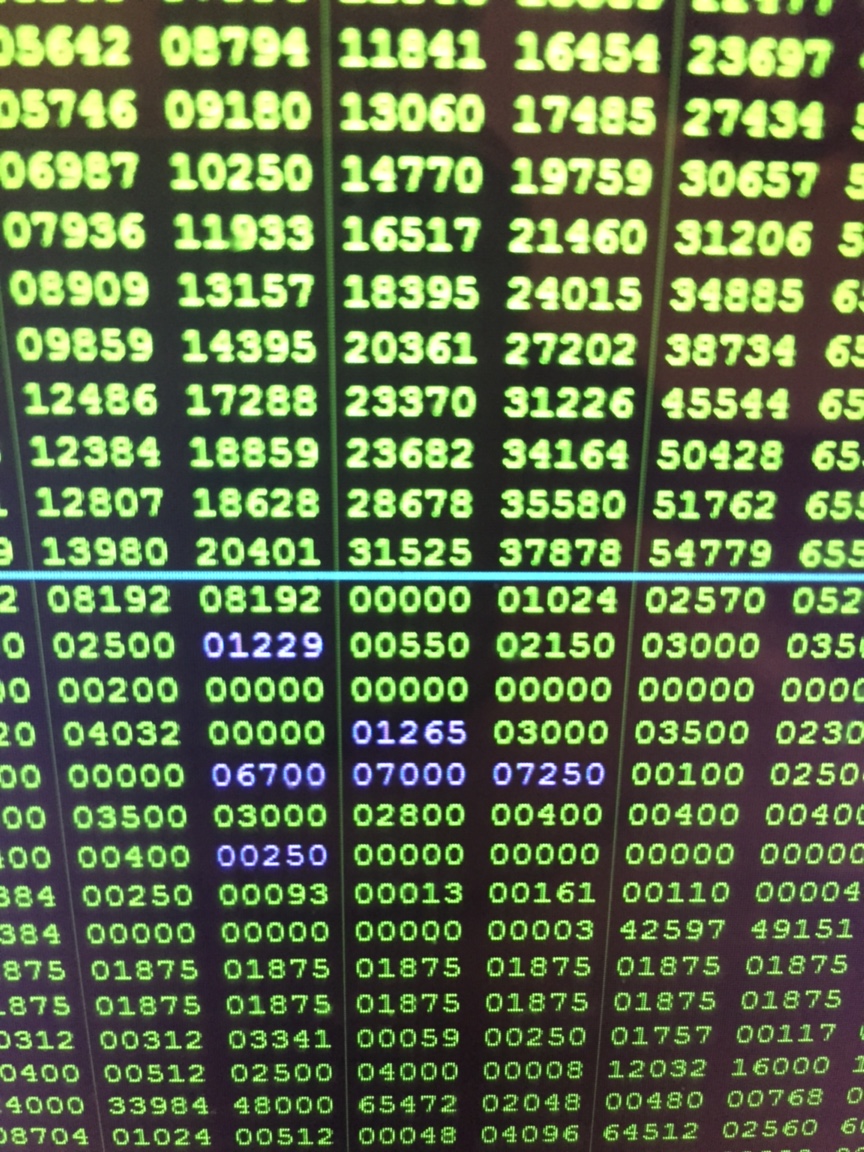

If any of you know what this even is then you'll see the original value of 6700 in purple code block 1 being the cars original rev limit. And im happy to take the car to another rolling road to confirm. The rollers we used here are well known around here and have always disappointed customers in the past believe it or not.

Also, FYI, looking at the graph it looks like you're still running the closed loop fuel strategy. If you change that it delivers the power a lot smoother throughout and looses the pre 5k flat spot.
