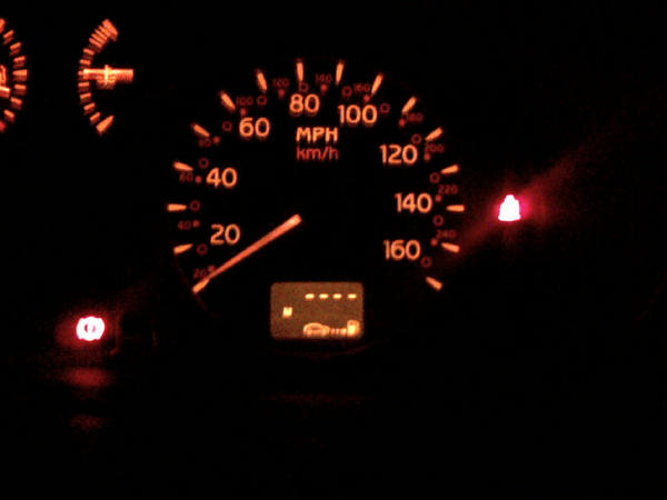

So i looked through the on board computer and looked at my projected fuel and it just had the dashes but they where flasing. I had over half a tank and it still flashed. Also when my fuel got low the fuel light would come on as you would expect but then sometimes it would just turn itself off which my clio has never done before. Then it might turn back on 20 mile down the road.
This is what the on board computer looks like:
