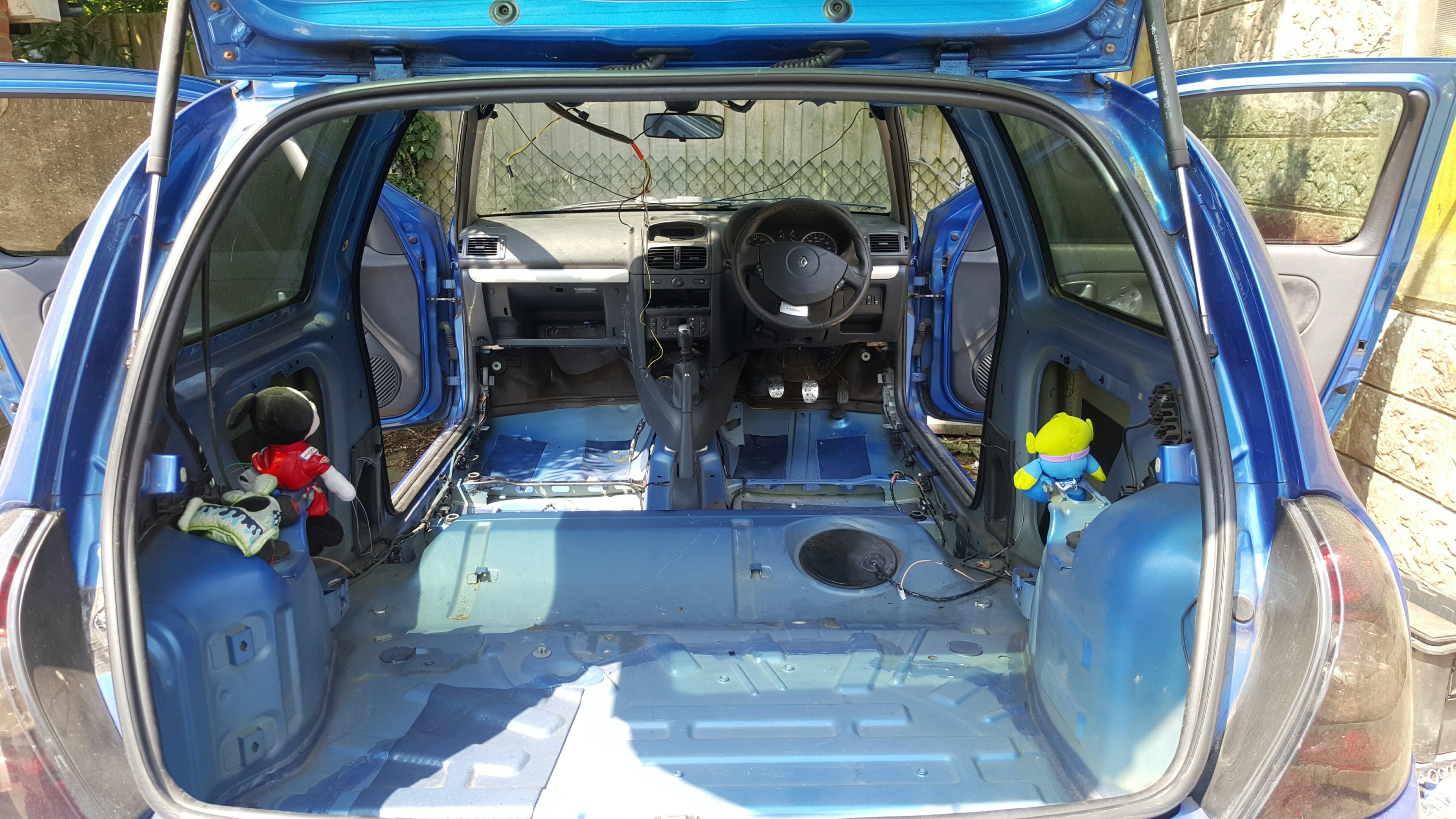

The interior is completely stripped and we have a Sparco 6-point cage primed, ready to fit.

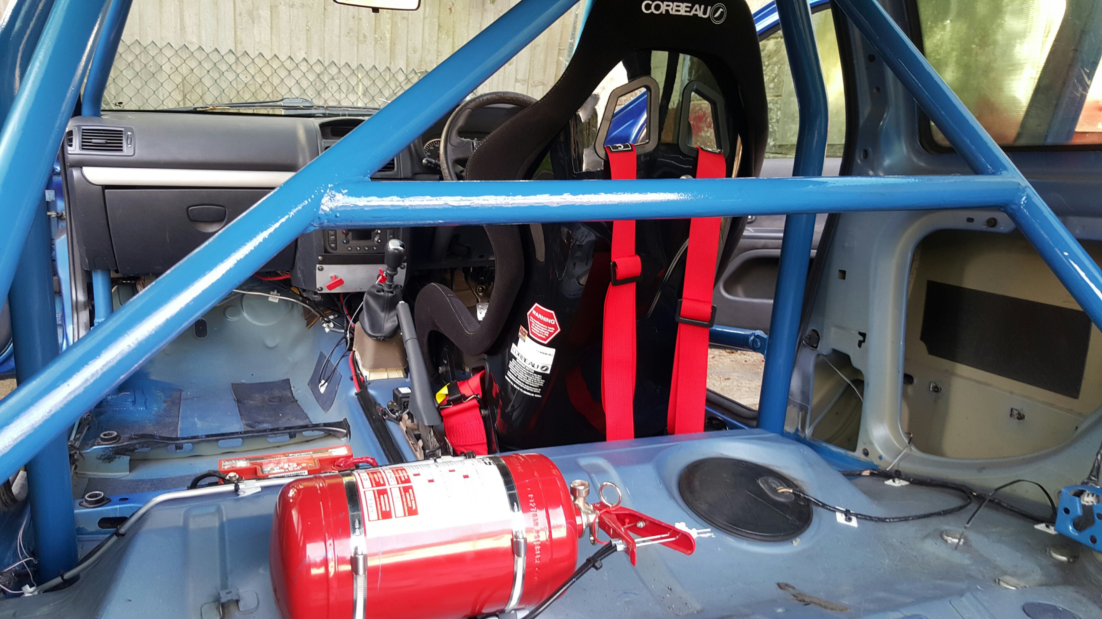

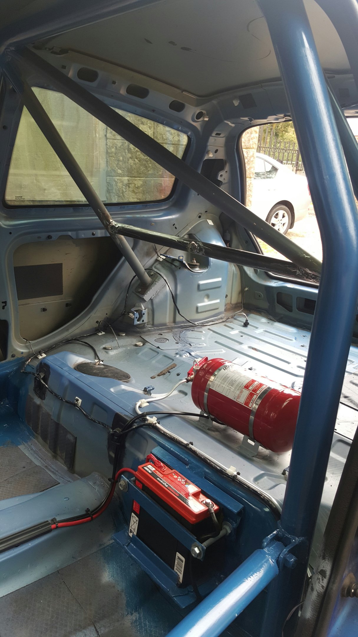

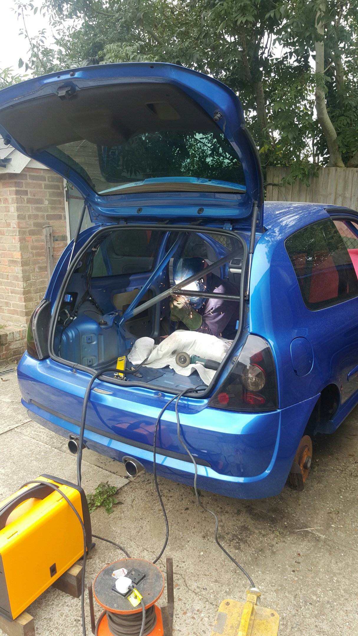

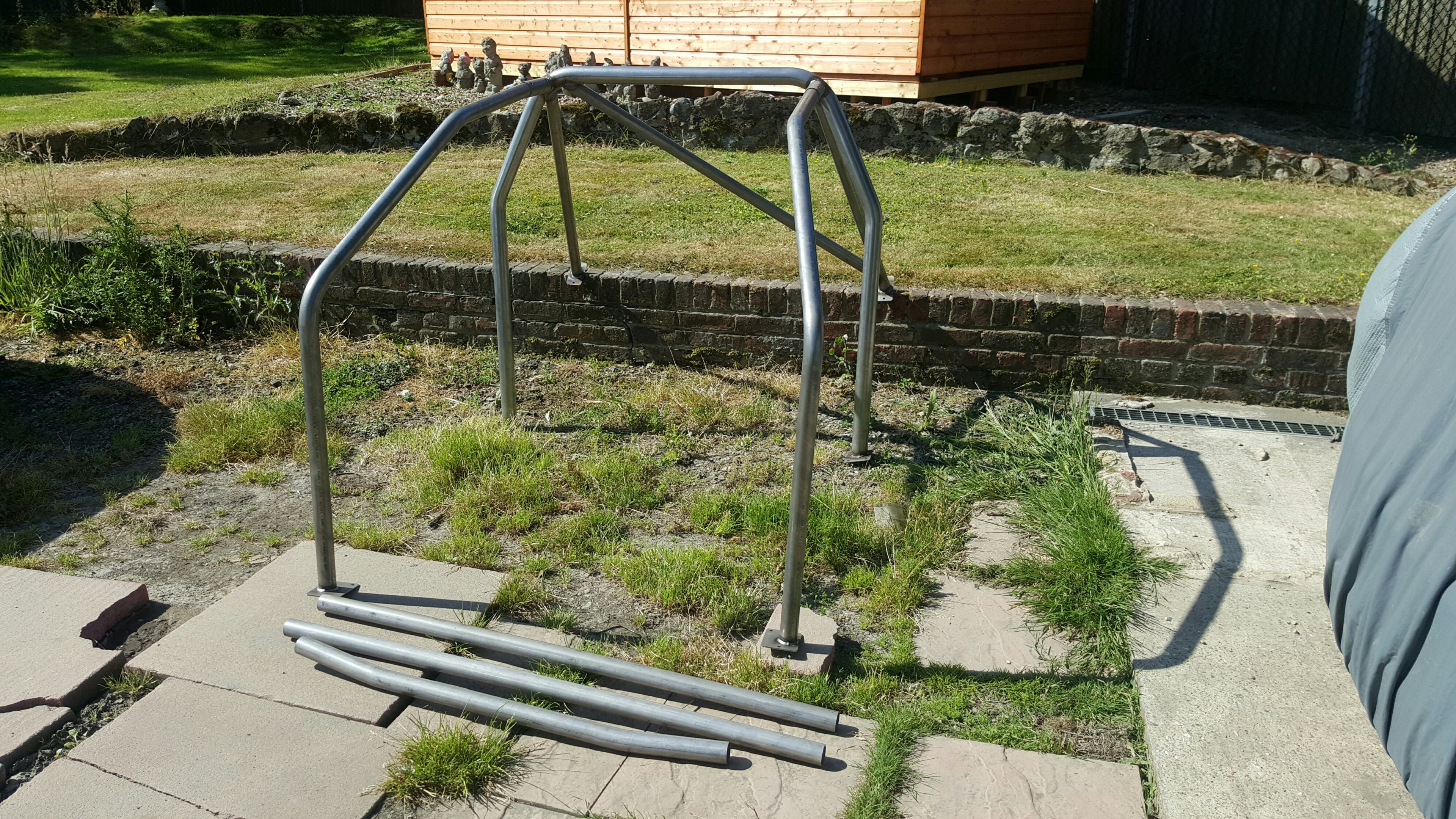

Finally managed to get some time to work on the car, and despite best intentions I completely forgot to take 'progress' photos.......just sort of cracked on while we had the time!
Cage fitting was the biggest job, and don't be fooled by the term 'bolt-in', there's just as much welding required as a 'weld-in'.
Bolt-in means you can just about remove it without cutting it out..........you'd still have to remove dash, seats, steering wheel etc.
Just looking at the way the car reacts on the jacks it seems substantially stiffer, so looking forward to seeing the difference in handling on track.

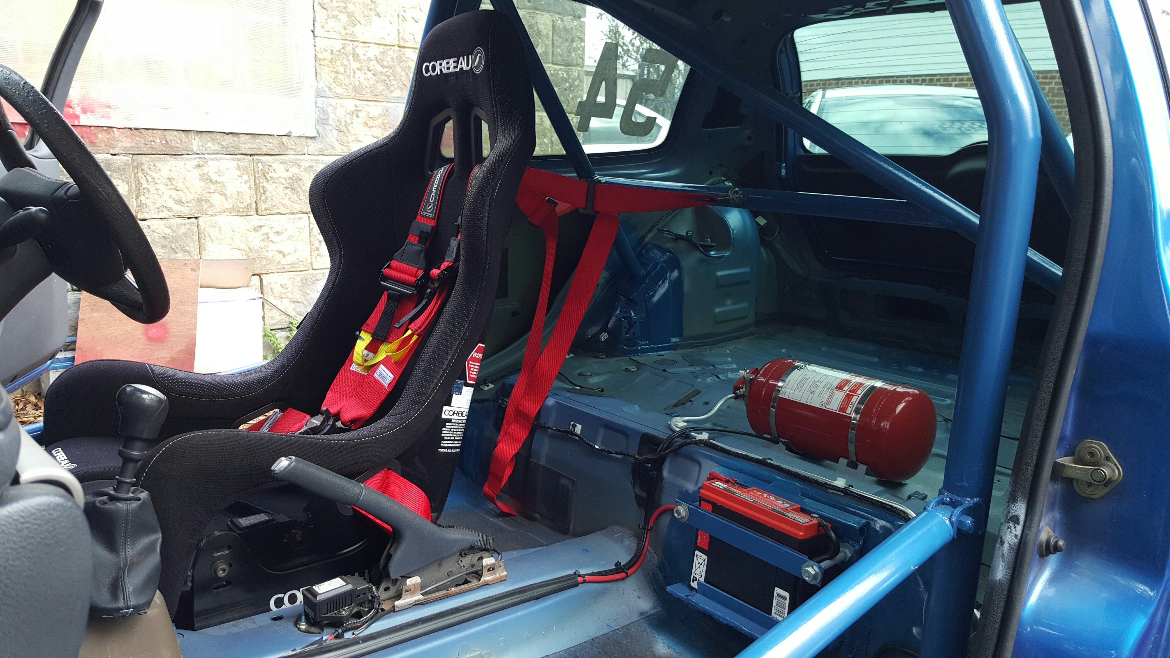

Other than the cage we've fitted:
Corbeau pro-race FIA seat and mounts
Corbeau 6-point FIA harness
4.25 Litre AFF extinguisher with 2 sprays in the footwell and 4 in the engine bay.
Odyssey gel battery, relocated to passenger rear footwell

We've also removed all airbags and SRS ECU, the very annoying UK alarm system, and various other electrical bits.
It will be interesting to see what the car weighs after all the changes.

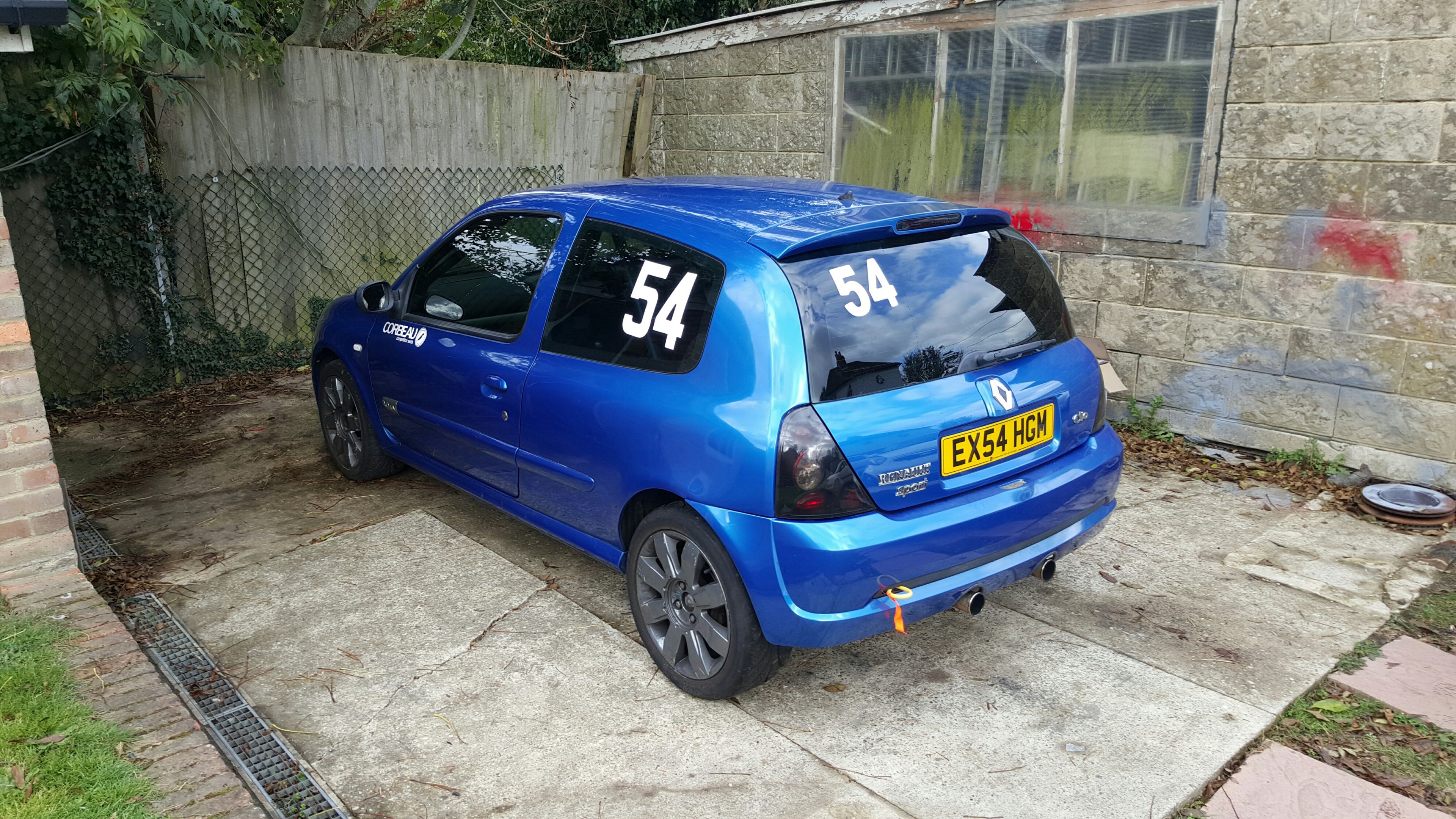

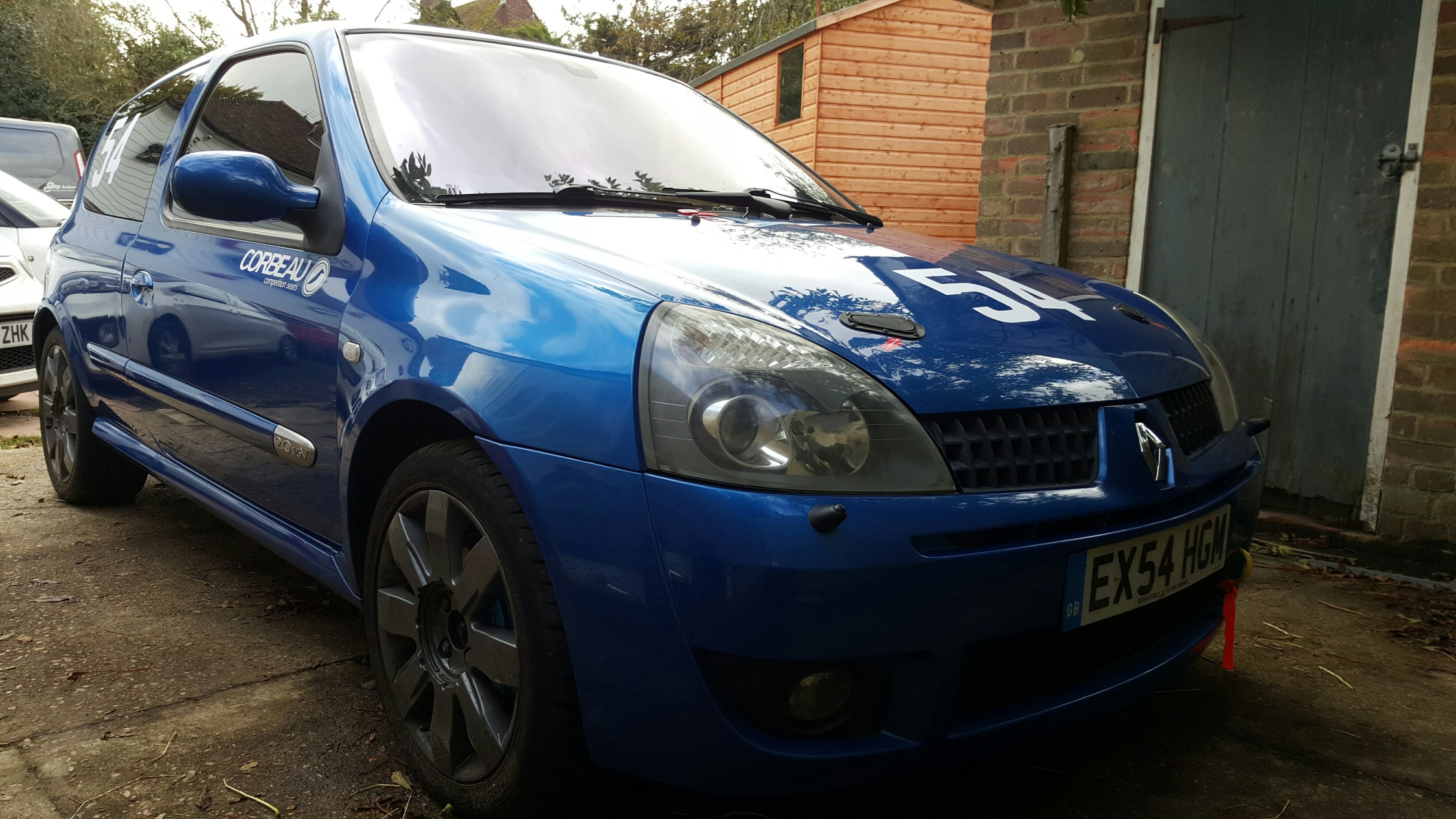

A few pics, some better ones to follow I hope.
Nearly ready for the Clio's first race next weekend.
A bit of a test before we enter a full championship next year.

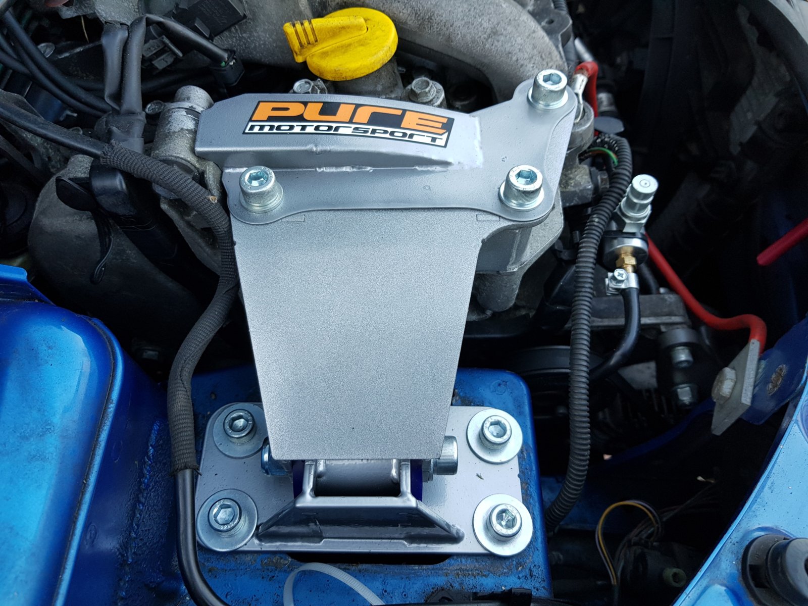

I've also ordered a the Pure Motorsport uprated engine and gearbox mount kit on advice from other Clio racers, and will try and get that fitted for Snett as well.

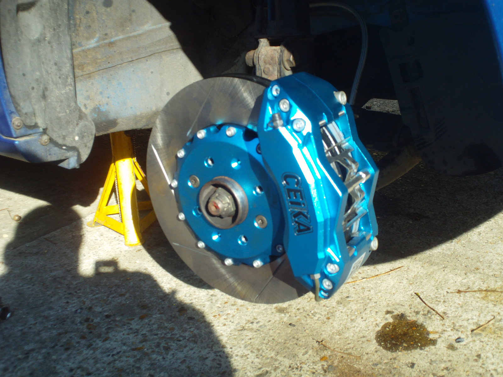

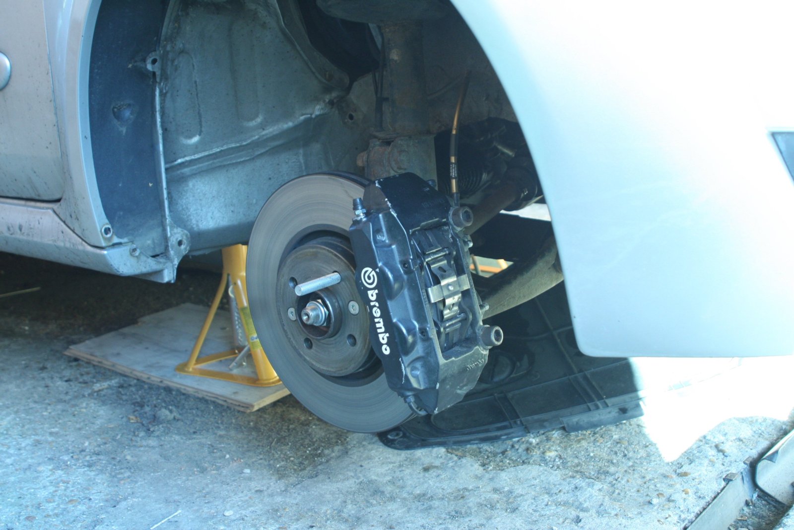

Have you got your brakes fitted yet? This is the first build I've come across that uses them, can't imagine 6 pots on a little Clio! Assuming you're going to stick with the 16" wheels?
Yes, I rushed to fit them for a race at Lydden at the end of last year, and initially was a bit disappointed. However I had stupidly got air in the ABS pump when flushing through new fluid, and also Ceika had send 'street pads' rather than the race compound I had specified.
Having fully bled the brakes I decided to try the 'sports pads' rather to save the discs. Now it stops really well, good bite, but good modulation also....you don't stand the car on end when braking firmly. Also after a 30 minute race and an outing at Curborough there's no real sign of wear on either pads or discs.
Having said all that it's probably still a bit 'overkill' !

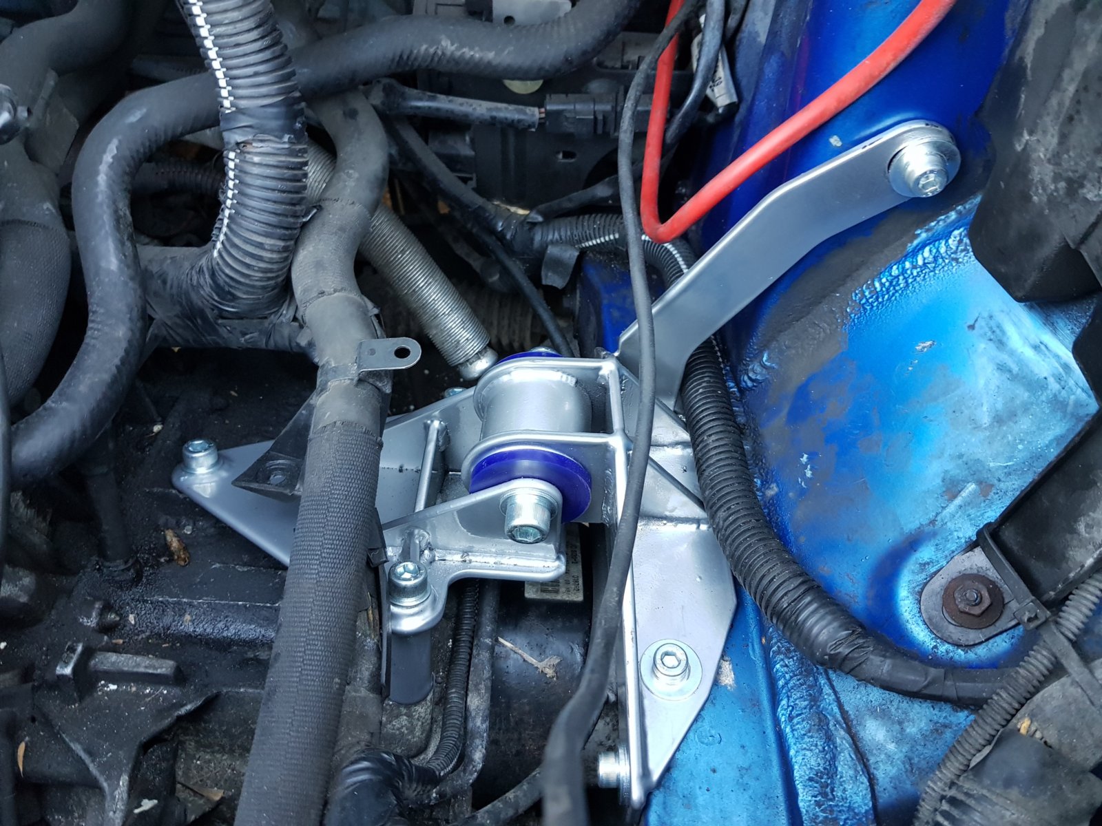

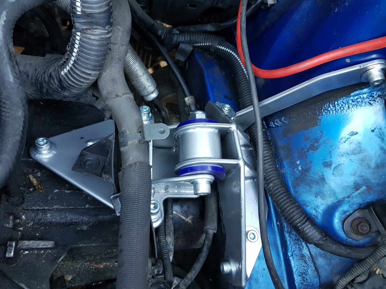

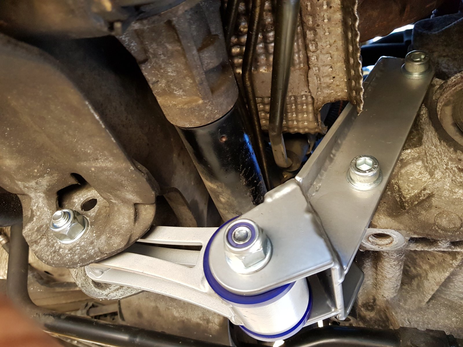

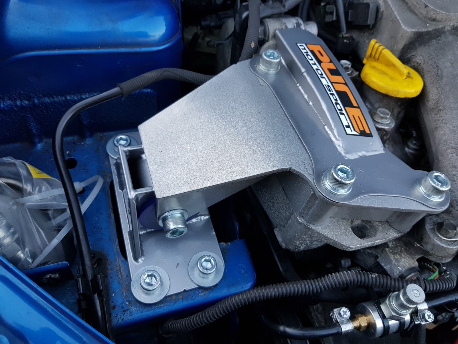

Had a bit of time this evening so fitted the PureMotorsprt replacement gearbox 'dogbone' mount.
Impressed with the quality and fitment, also the concise fitting instructions.
Will do the 2 upper mounts at the weekend.
Having said all that it's probably still a bit 'overkill' !View attachment 1418260
They do fit snugly behind the OEM 16" wheels so I will be keeping those for now, also have to stay on 205 or smaller tyres to be in production class so that works as well.
Cheers, Andy
Took this a while back :sneaky:
1418421
Same colour axle stands and everything!
So those are 4 pots, what sort of compound pad do you use, and how do you find the set up?
What seems to be the common theme is that if you improve front braking but have soft suspension (in compression at least), and/or have lowered the car, the front will compress under braking enough for the tyres to contact the bodywork at some point.
I'm guessing nearside is a bit worse purely because most tracks have more right hand corners, however you would think offside might be worse as the driver's weight is on that side???
What are the solutions? Could be loads of things, one of which I thought might be to stiffen the front dampers to give less compression......that didn't go well as it made the already silly understeer almost hilarious!
So I've gone the other way with that, soften the front damping, harden the rear and try to get the rear to rotate and the front to grip more.

I'm also hoping the competition mounts will have some effect, I've been running on 130K old mounts so the engine/gearbox weight might have been shifting about in a very unhelpful way.

Interior and MSA compliance
Interior removed, (except upper dash to comply with TP class regs)
Roll cage Sparco 6-point bolt-in
Ignition cut off with resistor
Dry-break fuel sampling point
OMP 300mm steering wheel
Front and rear tow straps
Aero bonnet catches
Transponder
Data Logger

Ceika 6-pot front brake kit, with Ceika race compound pads
Ferrodo FCP558H rear pads
Pure Motorsport Engine and Gearbox mounts

I'm not sure I have the option to go to 15s due to the 6-pot caliper's, but would have to see if there are any wheels that work.
You're right @ZachB I don't think I'd want a taller tyre or increased diameter, and r888s would be good but in 16" would have to be on special offer.
Maybe I'll try a new set of the new Federal 595 RS Pro at the start of next season.
Only one more race this year at Lydden so that will kill off the AD08s anyway.
ZachB
  182
You could speak to ceika to see if they would offer you just a smaller bracket? It says they do 286mm for 6 pots, discs Im sure you could find some used ones for cheap that are more than up for the job
