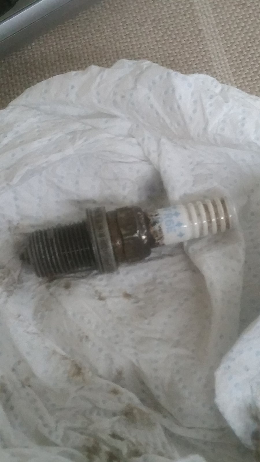

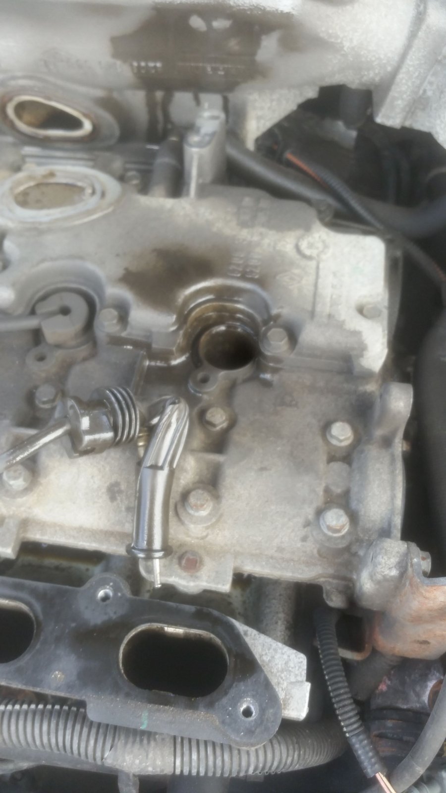

I'm going with the assumption that the plug has worked lose and popped out causing all of this. Before throwing a new plug and HT lead on I'm guessing i should be checking the cylinder for debris? Couple of pics below and any advice what i need to look out for and how to go about it much appreciated.

Looking briefly at your plug it looks like I can see a bit of cast still on the thread of your plug. About 5-6 threads up. What may have happened could have been similar as in pulled the last few threads out of your head.

Well it`s stripped the threads - cant even get a new plug tight :mad:
Helicoil time for me :cautious:
Yep common problem with ali heads, some dickhead previously will have massively over-tightened the spark plugs when installing them and fucked all the threads up.
Whip all the plugs out, see if anymore are damaged.
Then you'll need to think about helicoiling the plug holes or just getting a new cylinder head that isn't already damaged.

Glad iv found this thread, just had a plug pop out on my 172, checked plug and doesn't seem to have much thread collected on it. Tried fitting a fresh plug and it feels as though it's about to strip whatever threads are left. Il order the same helicoil that you have purchased. My question is, how do you go cleaning out the cylinder of any debris after helicoiling?

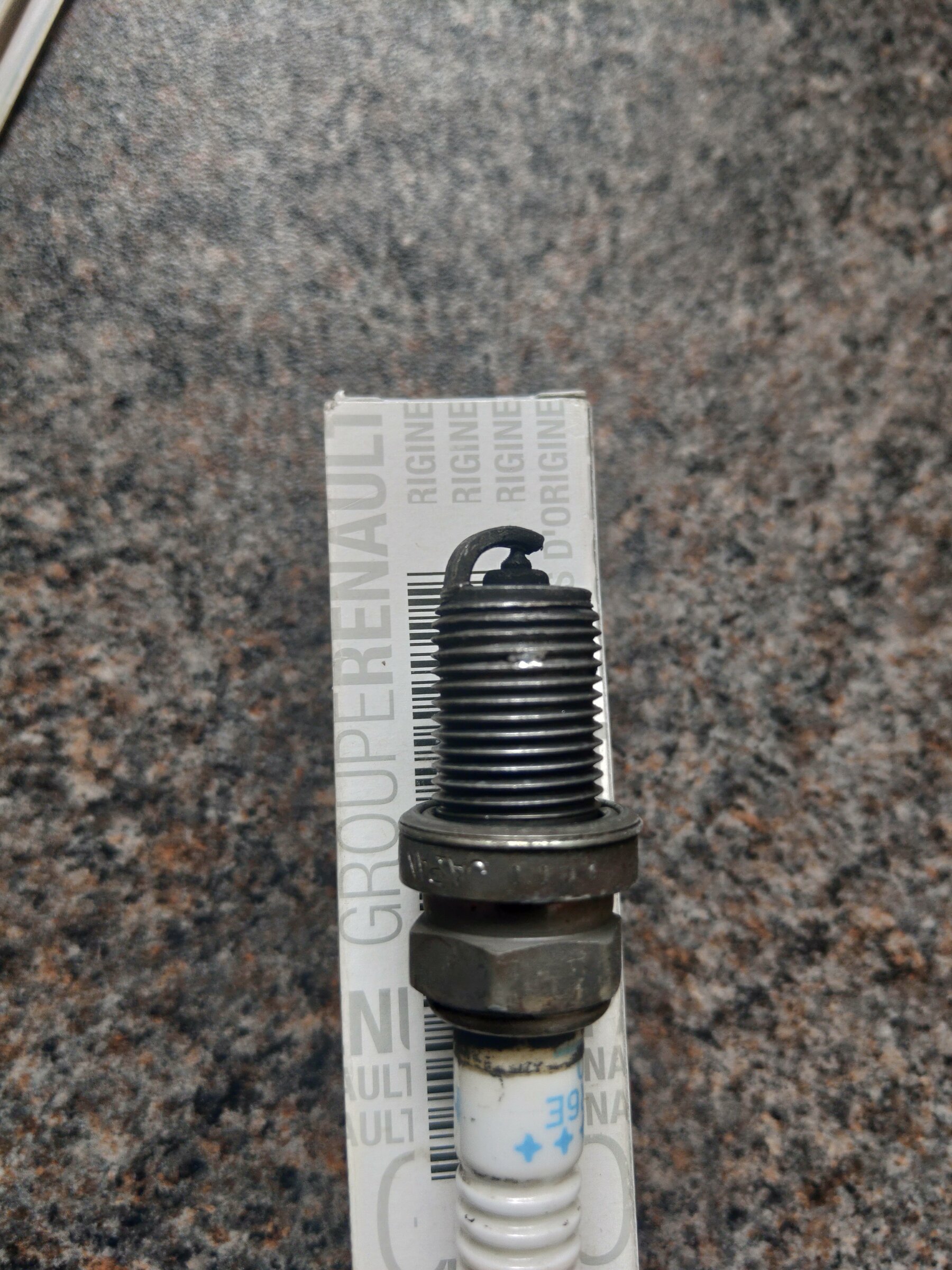

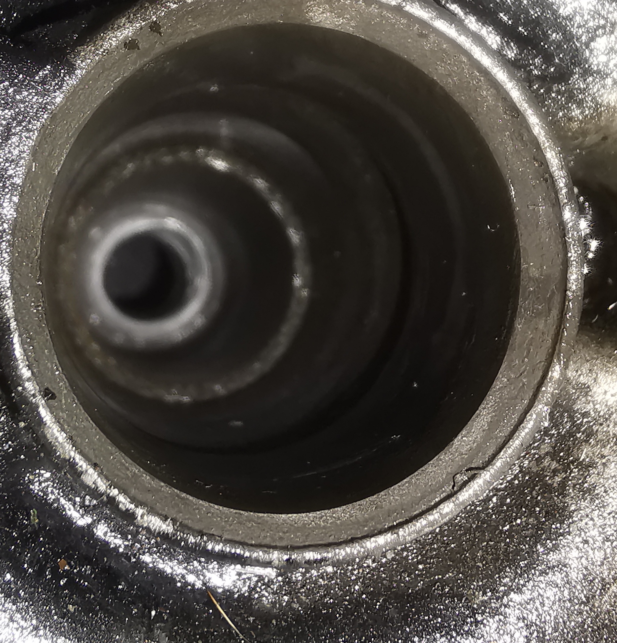

Sorry for bumping but I'm having the same issue..
Plug number 3 blew out and you can even see on pictures that thread is damaged..

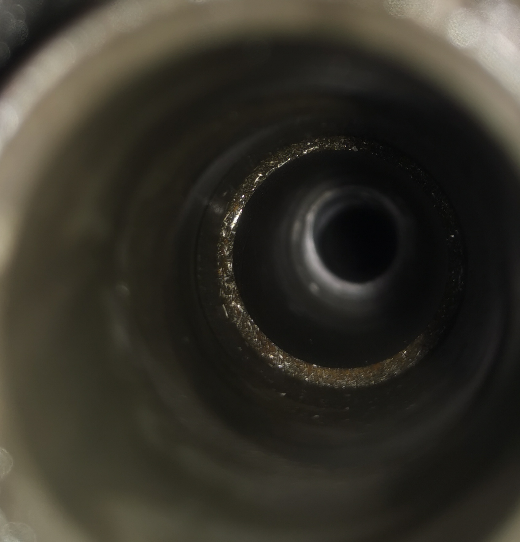

The kit I bought comes with an M12-M14 step tap, there was 1.5 threads left in my head luckily. It just helps to centre and plumb up the thread so you don't cut new ones in on a weird angle. I added fresh grease on each tool with each full turn making sure to back it off every so often
Then I washed it all down with brake clean, dumped a slight amount into the cylinder and then thoroughly hoovered it all out making sure there was nothing else. The grease caught most of the metal swarf, I wouldn't advise doing it dry
