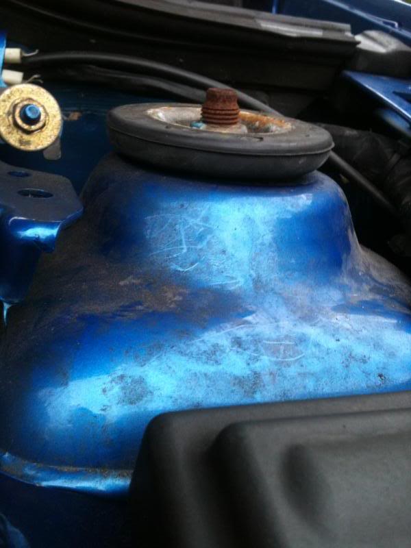

Right guys that's just a week I've owned my Clio 182 and was noticing that its pulling to the left and generally bit wierd to drive. Was going to get the alignment checked but looked under the bonnet and noticed this?
Whats up here? Strut top mounts or something worse? Its under warranty with the dealer but want some advice.
Drivers side

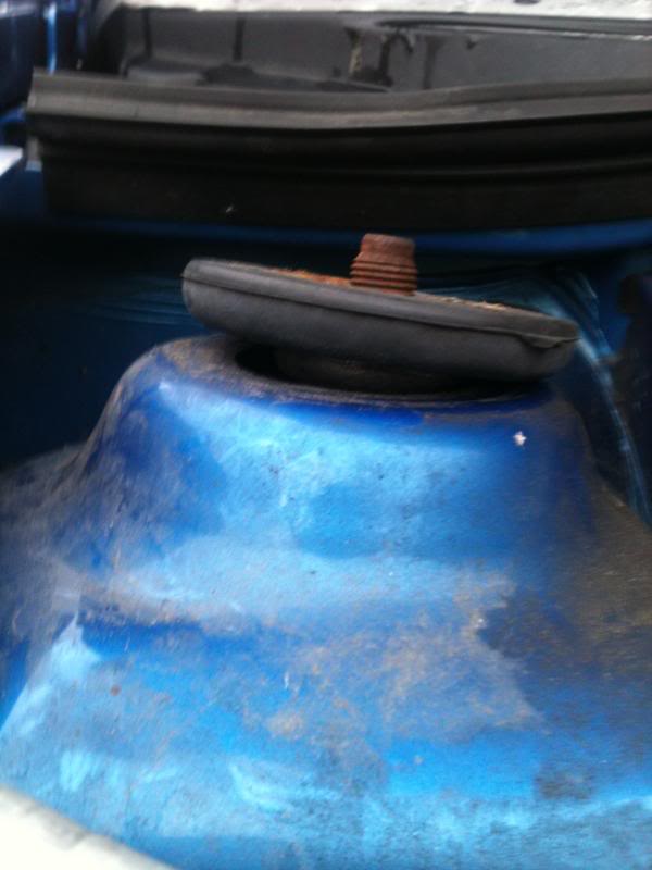

Passenger side

Wheels are near enough mint. No deep kerb marks.
Looks like the whole strut has moved? Its Going back to the trader on saturday, he's sorting it.
lol he means are the wheels straight not on full lock etc. if they are straight then yes it is top mounts or accident damaged bent strut/wishbone could of roger'd a kerb
