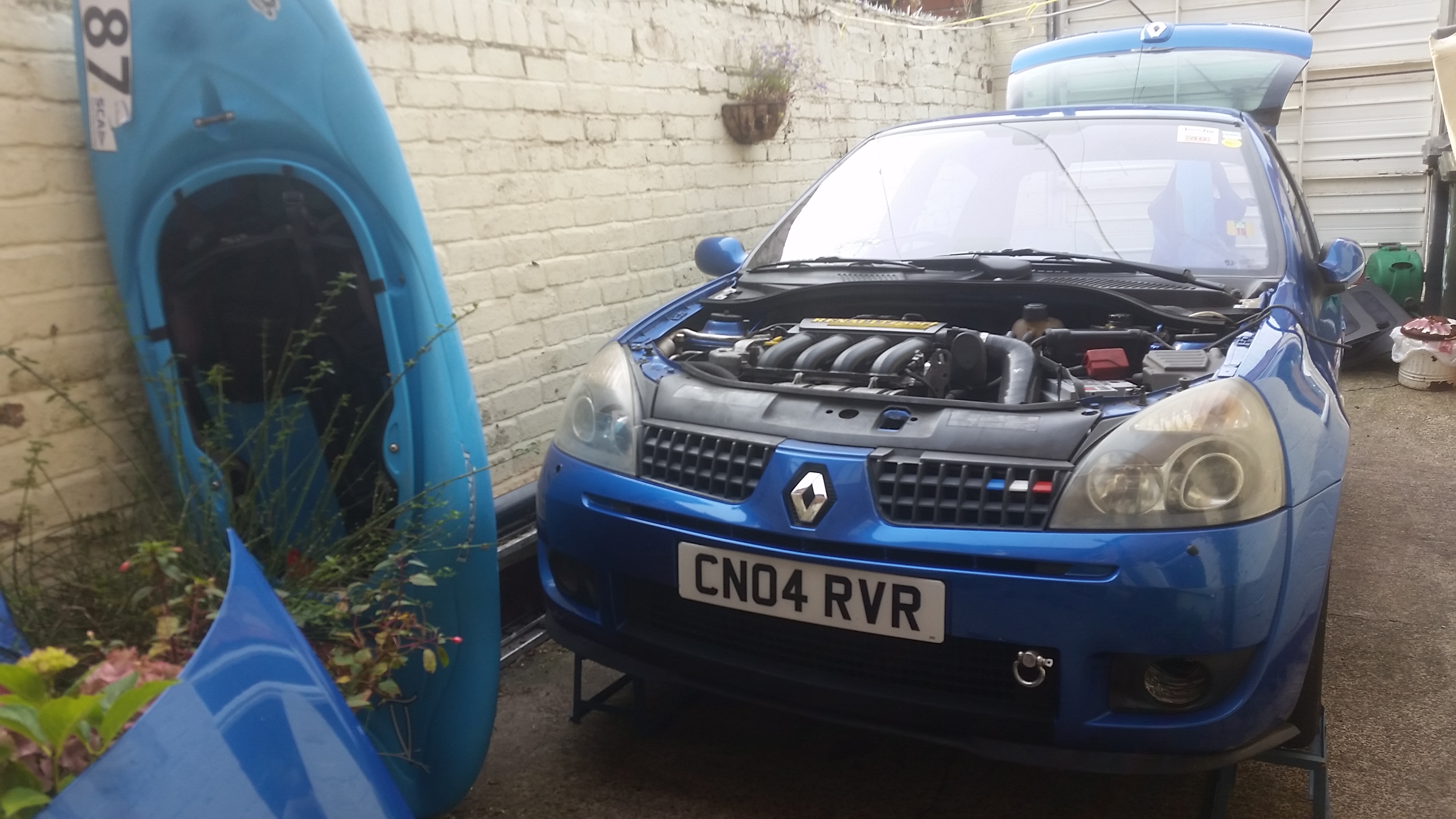

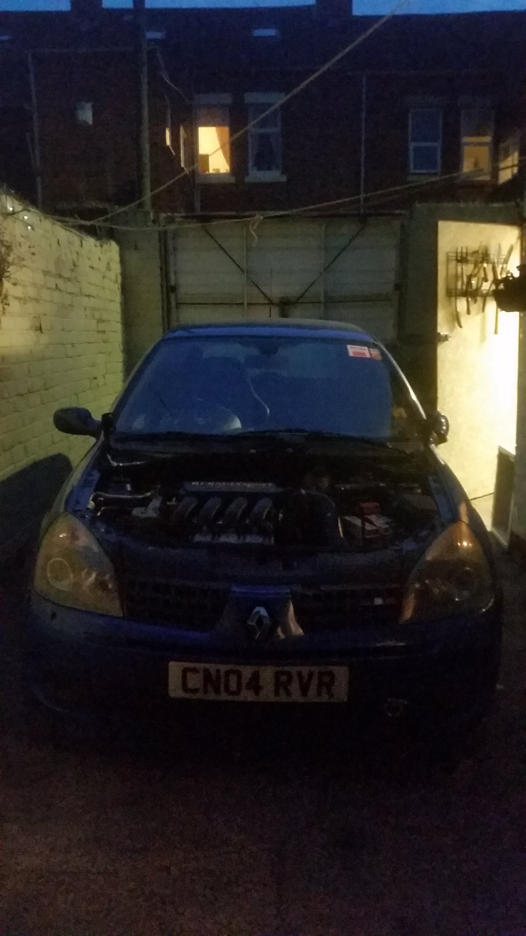

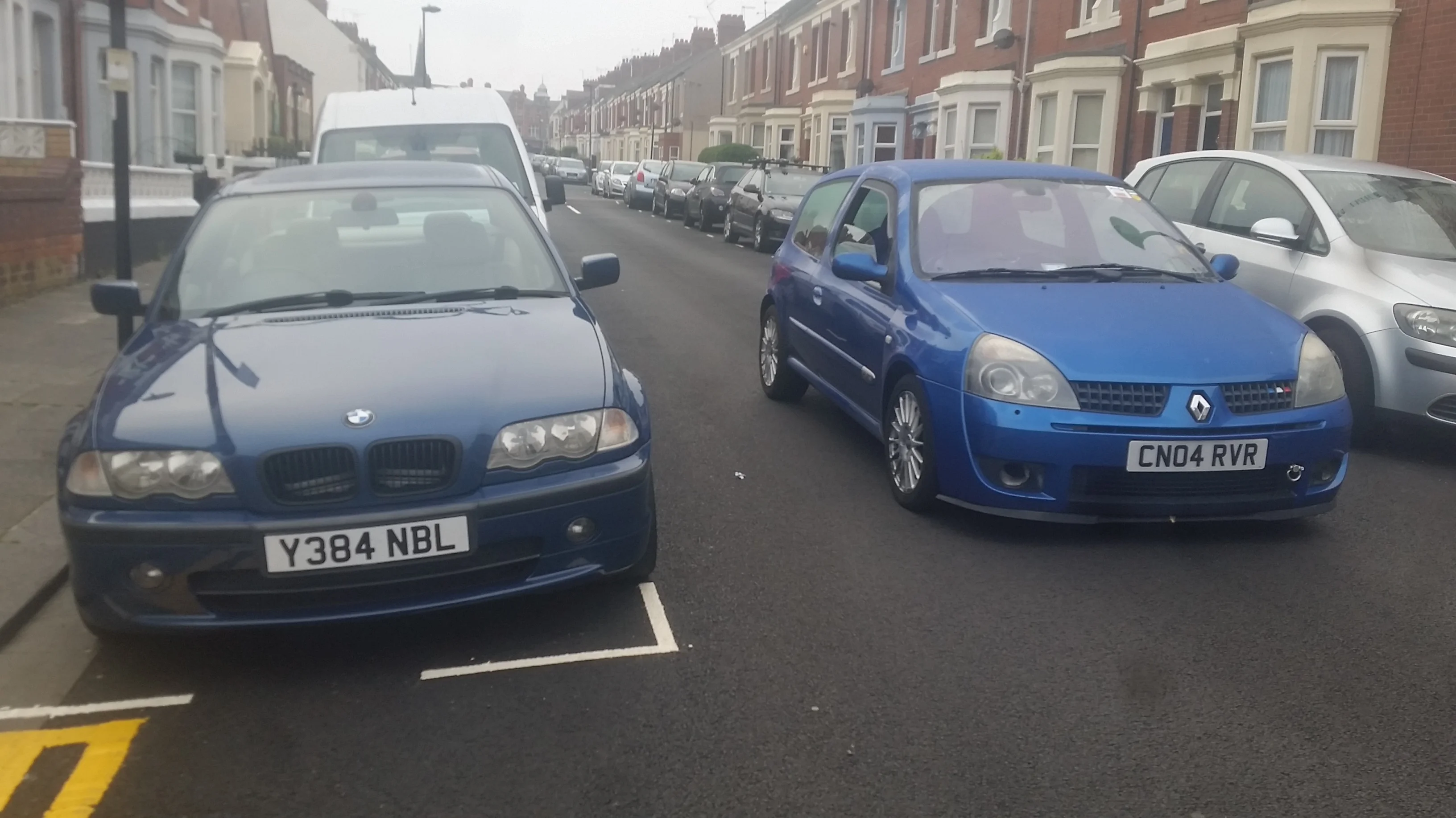

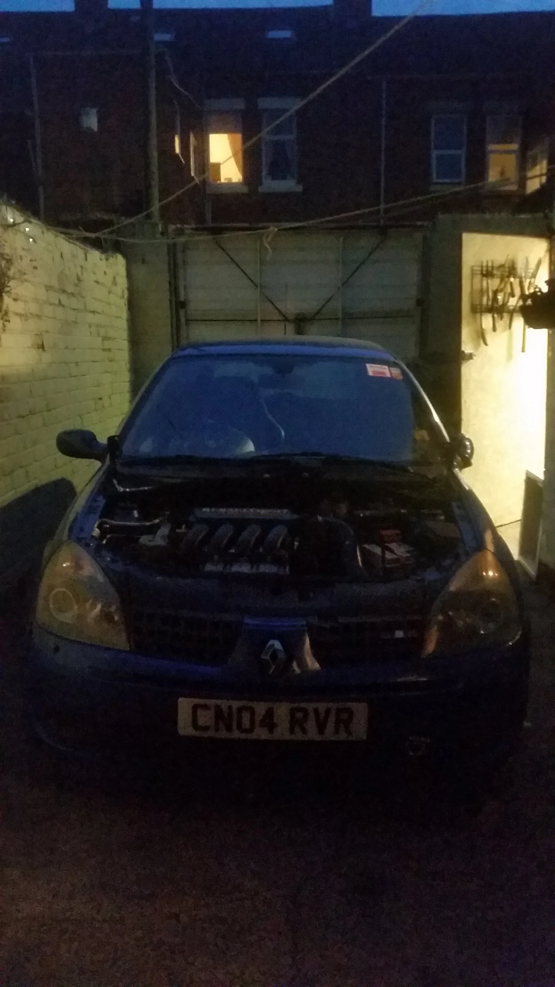

Heres how she looks right now tucked away in the back yard while I use my E46 330I as a daily :)

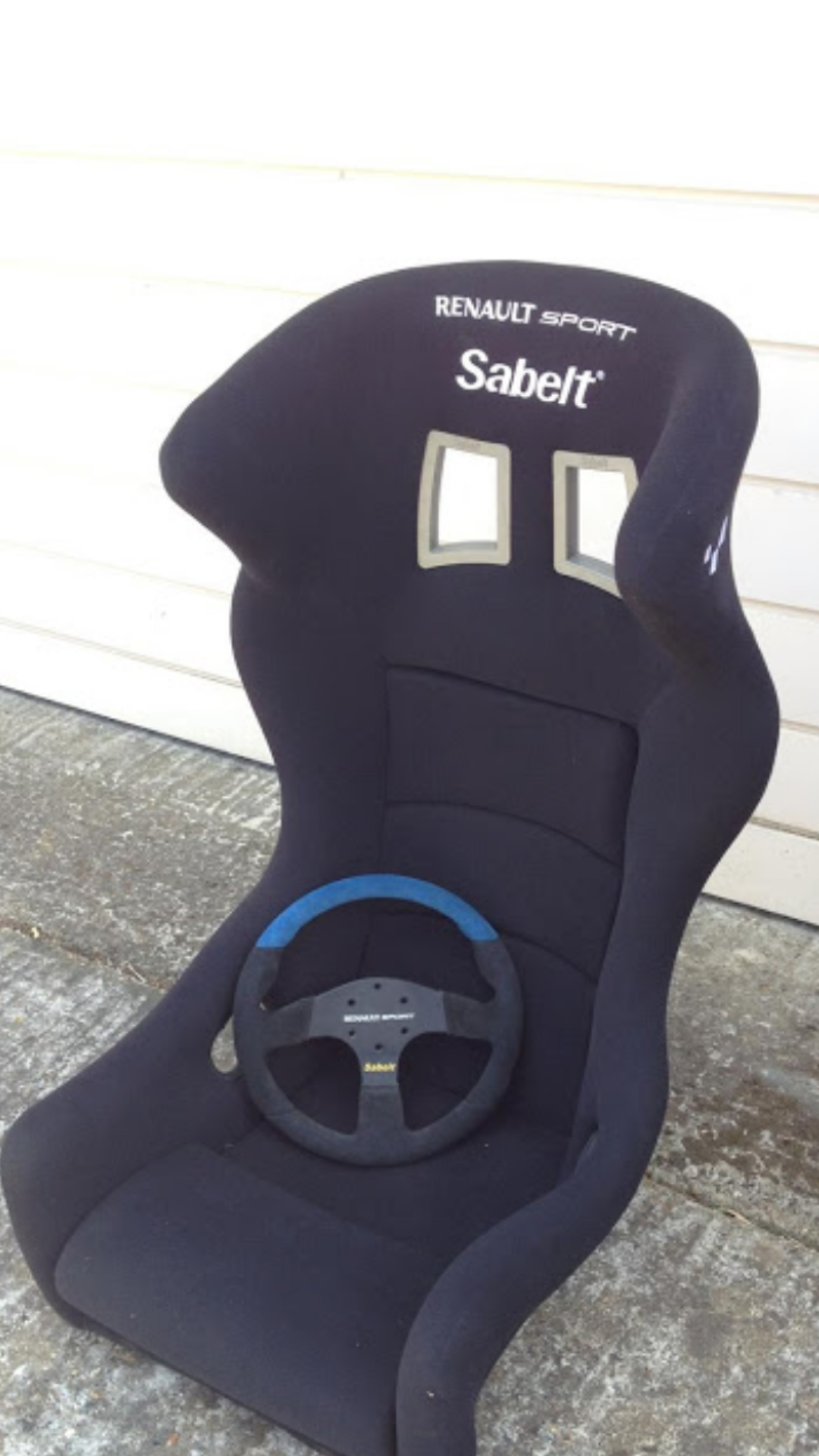

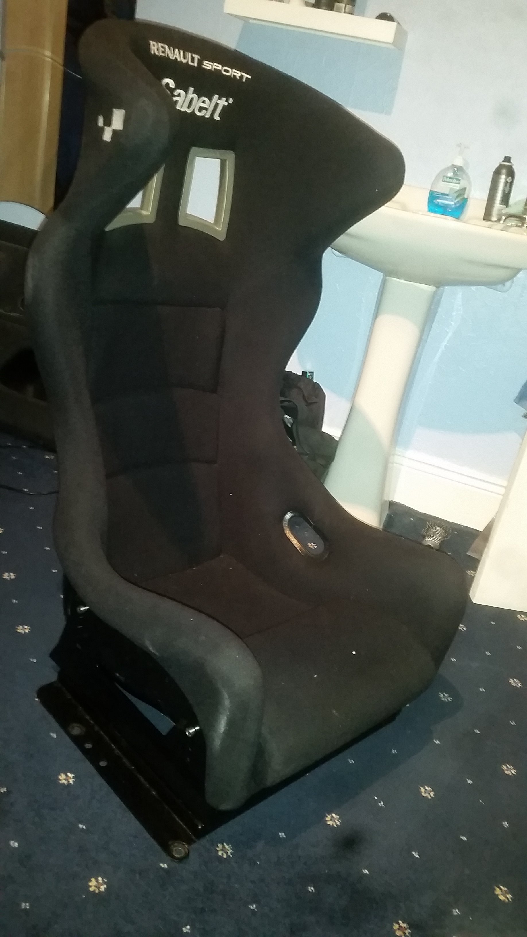

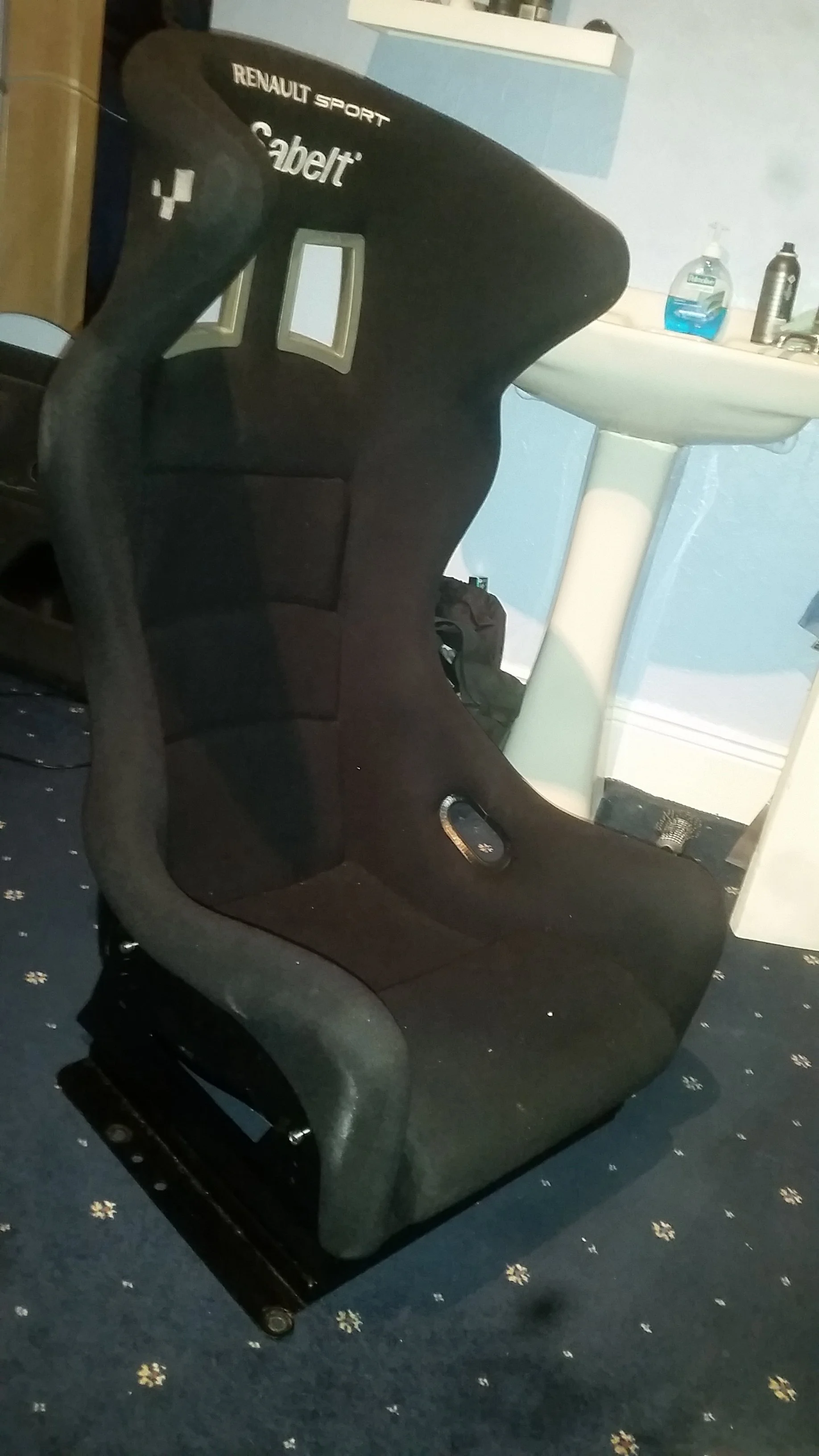

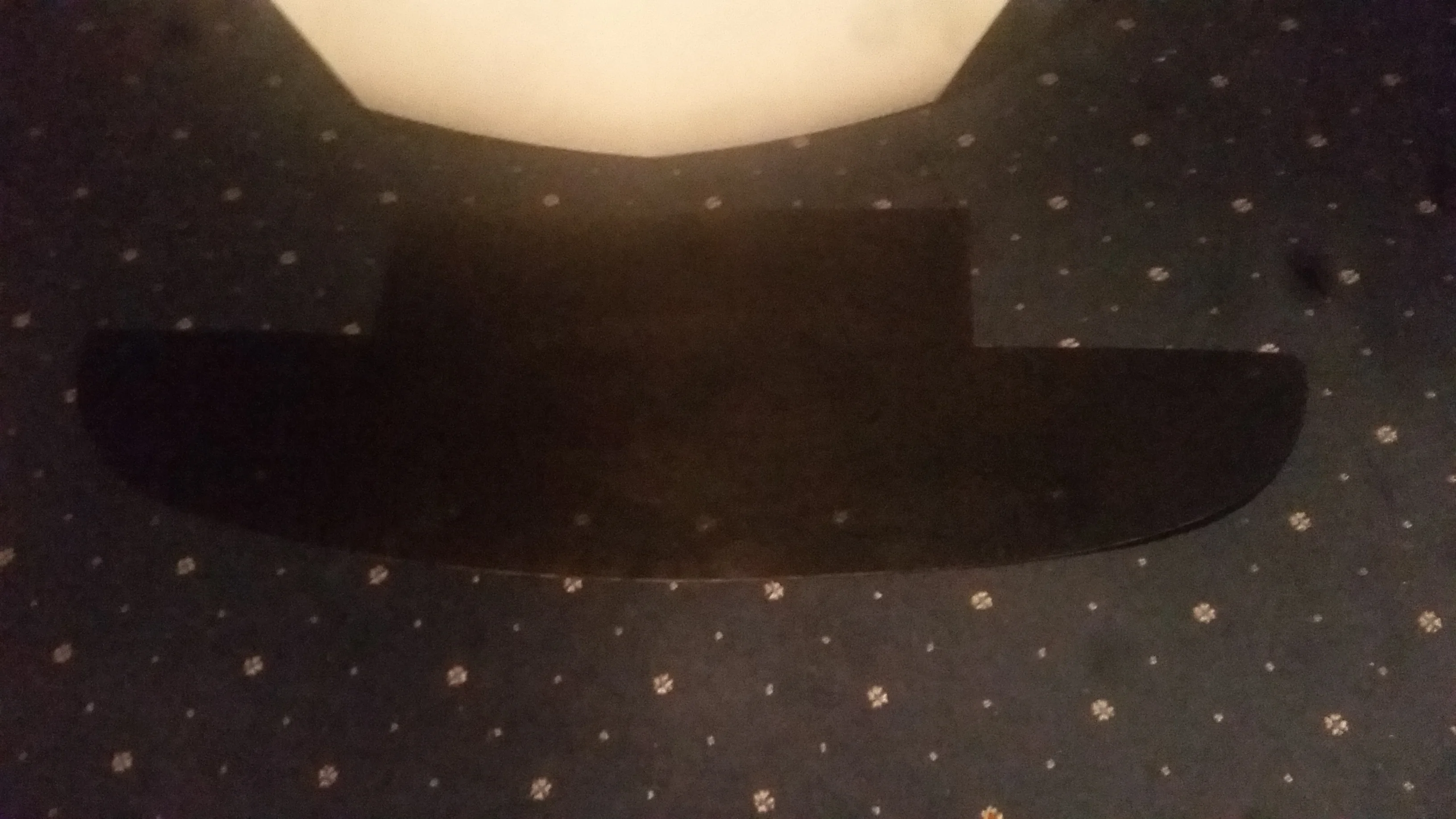

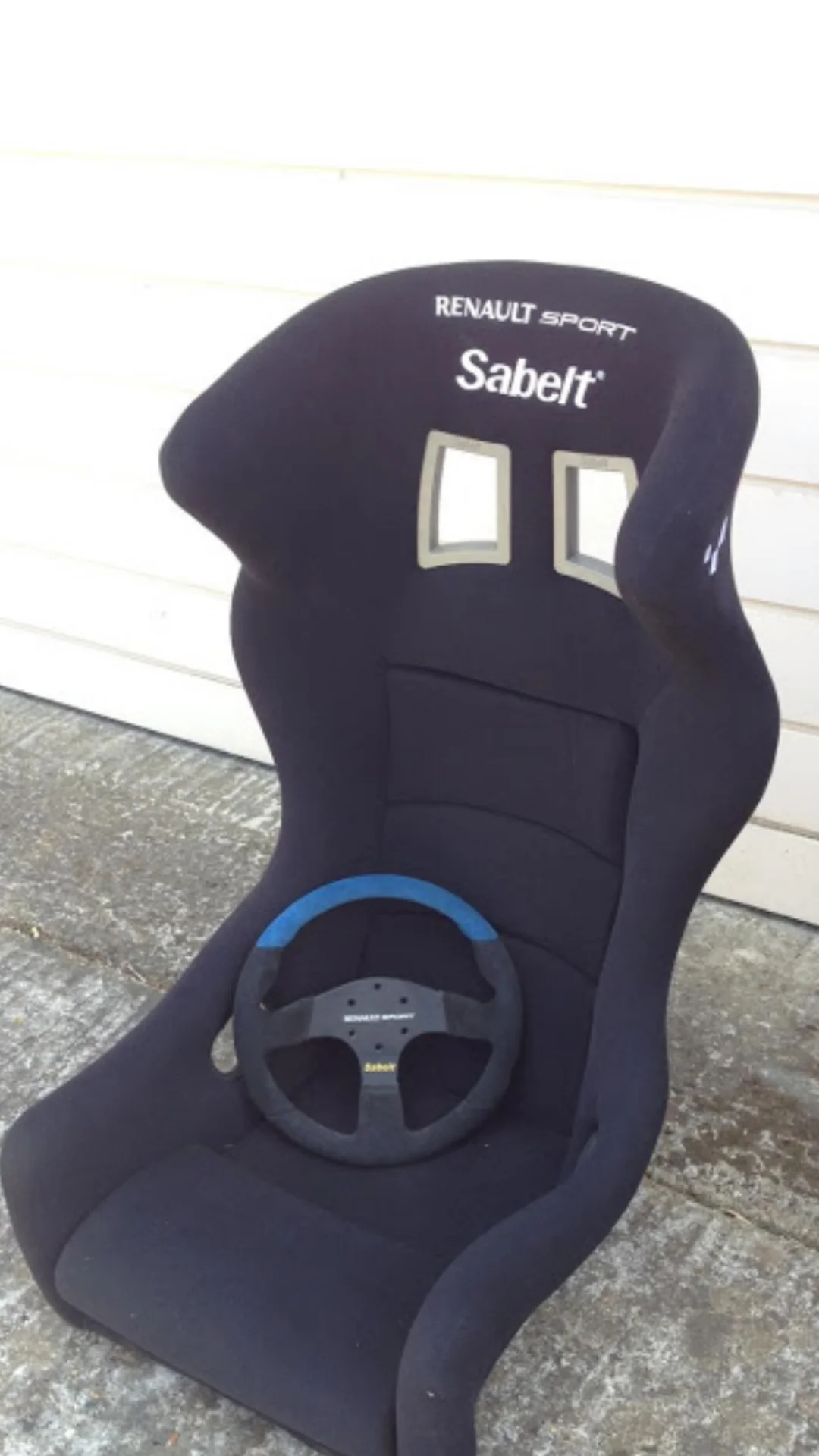

Cheers mate :smile: new seat for the build purchased today too
I'm all the way up in Newcastle but lucky had a mate 20 miles from the seat so managed to call in a favour and he went to collect it for me :)

Looks like your starting off in the right direction mate, weight loss is the best performance mod in a Clio.... Good choice in seat too, I have 2 in mine. Vey comfortable and certainly up for the job! They are the same as the genuine cup racer seats seemingly...... Looking forward to watching this grow, I like the liquid yellow route, its great to see something a little different from the norm :-)

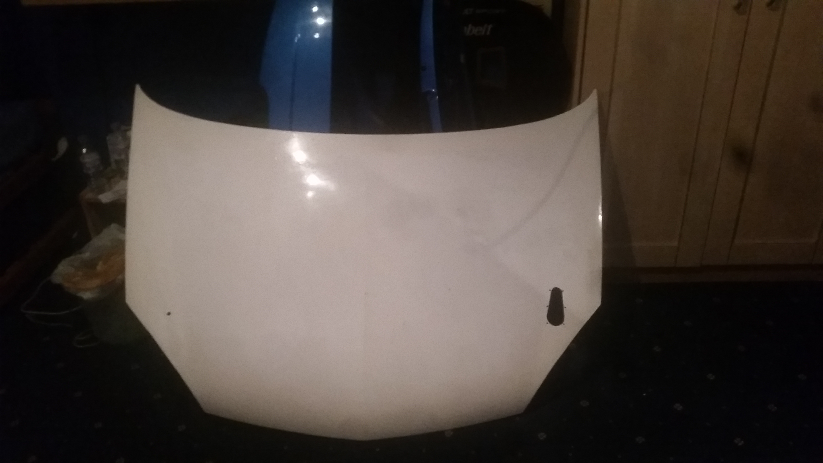

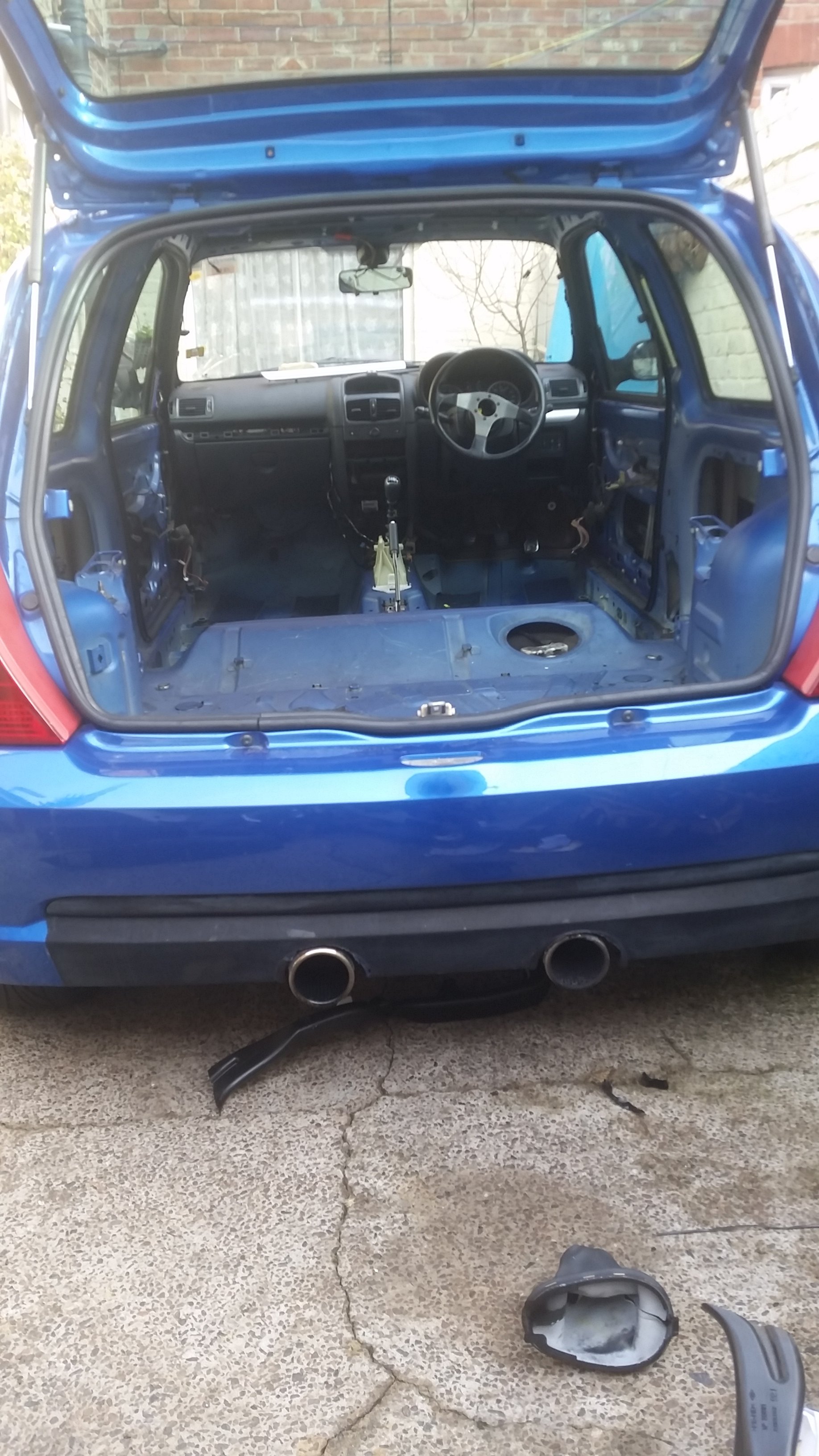

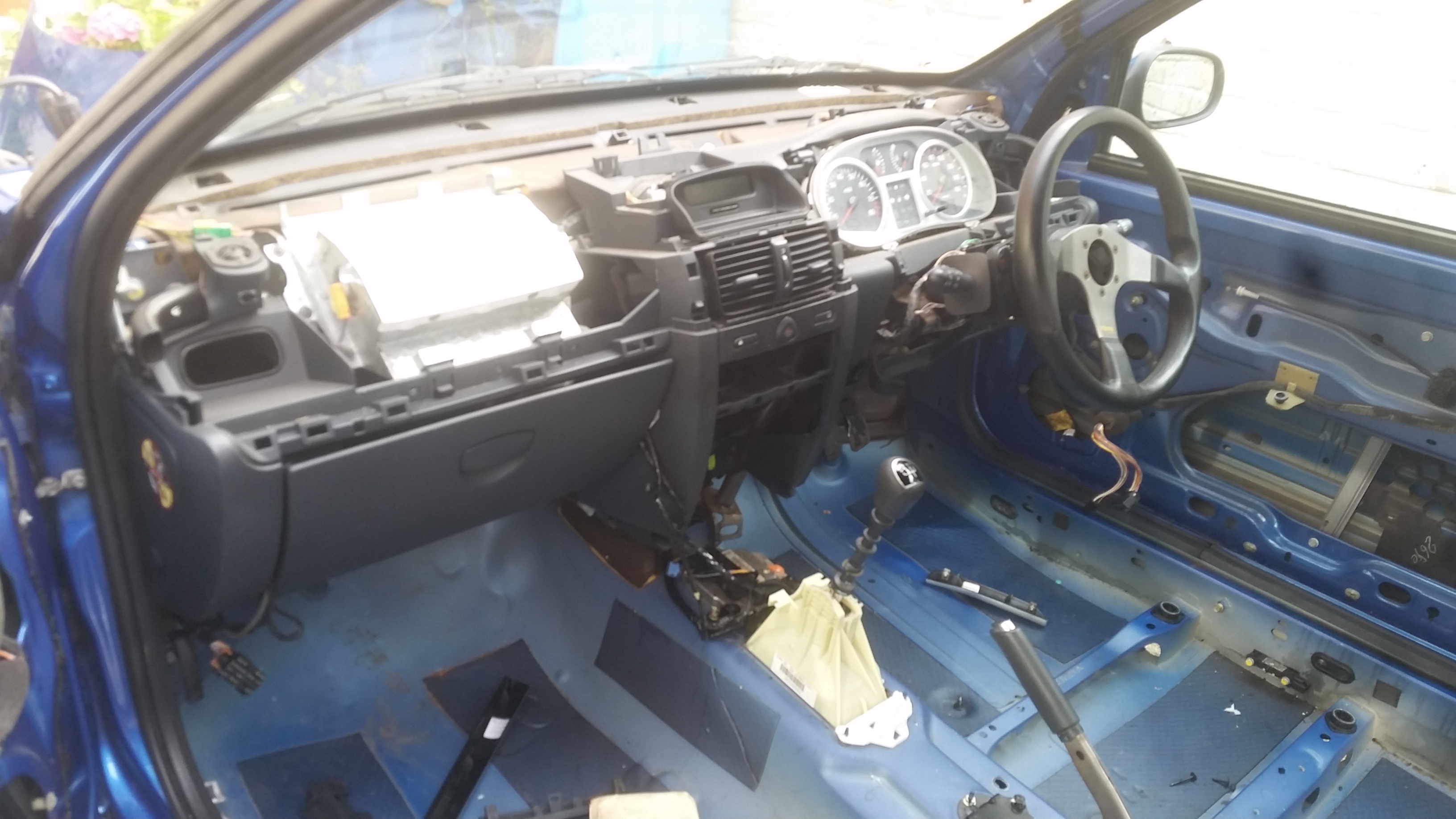

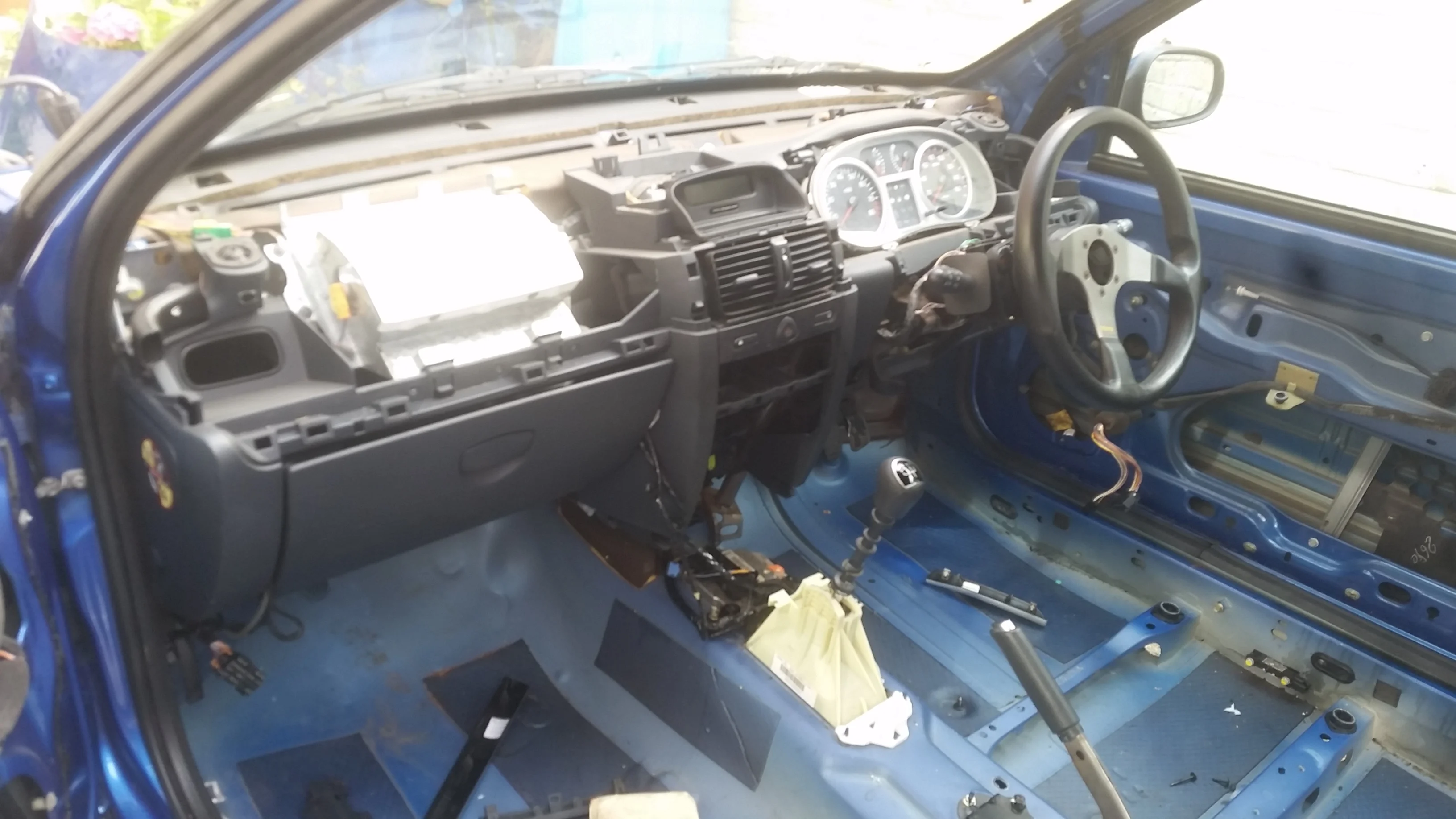

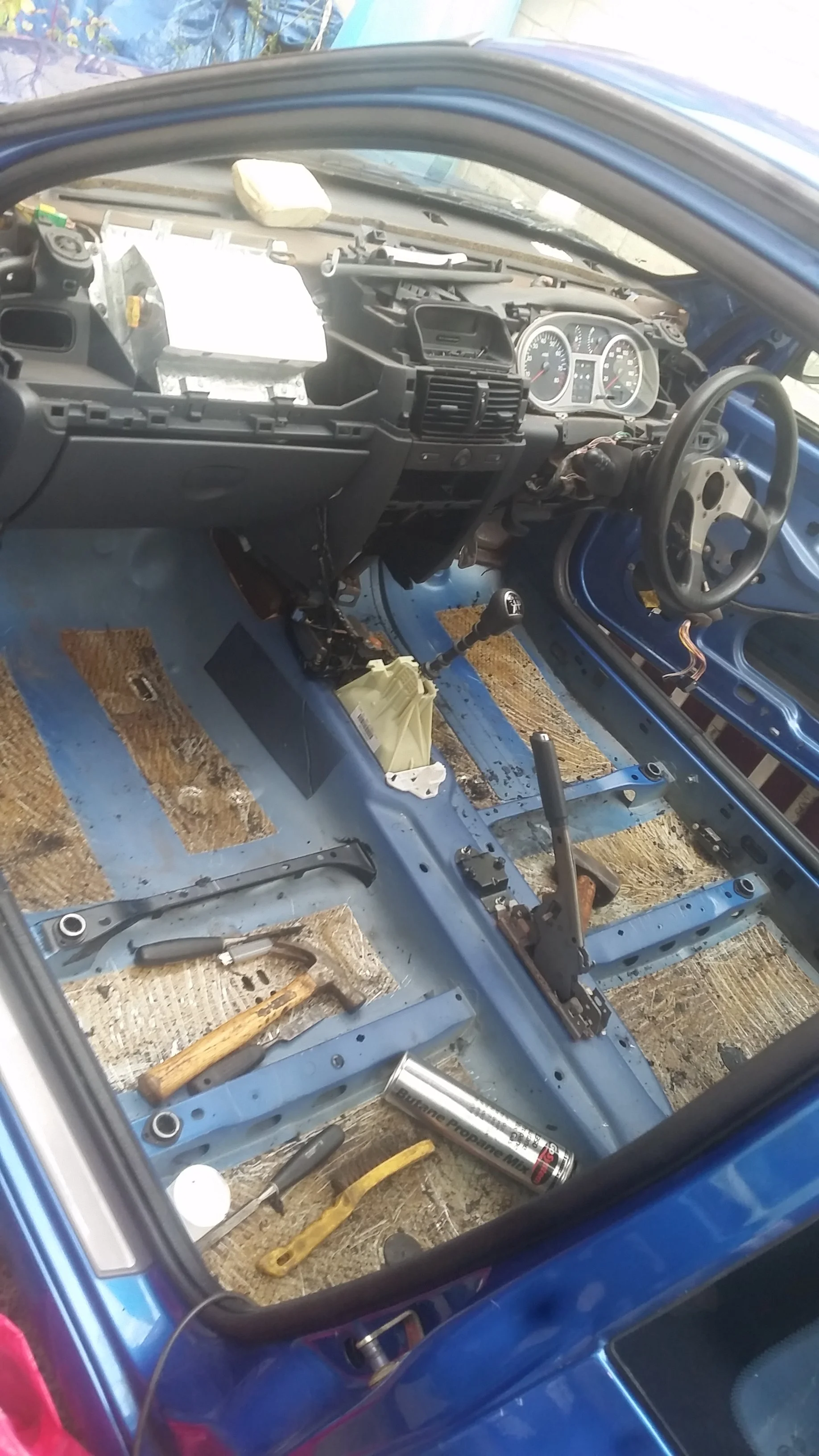

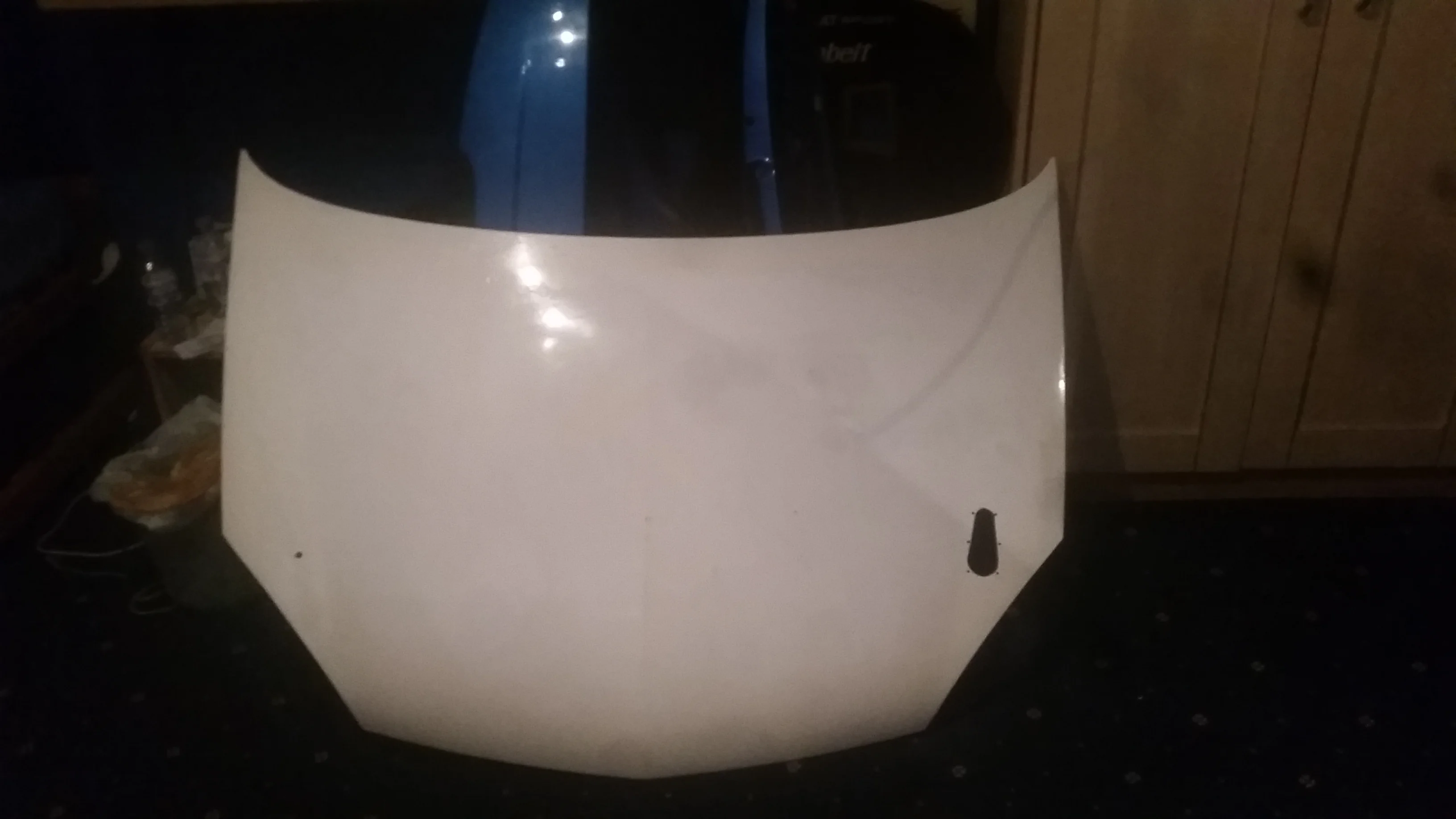

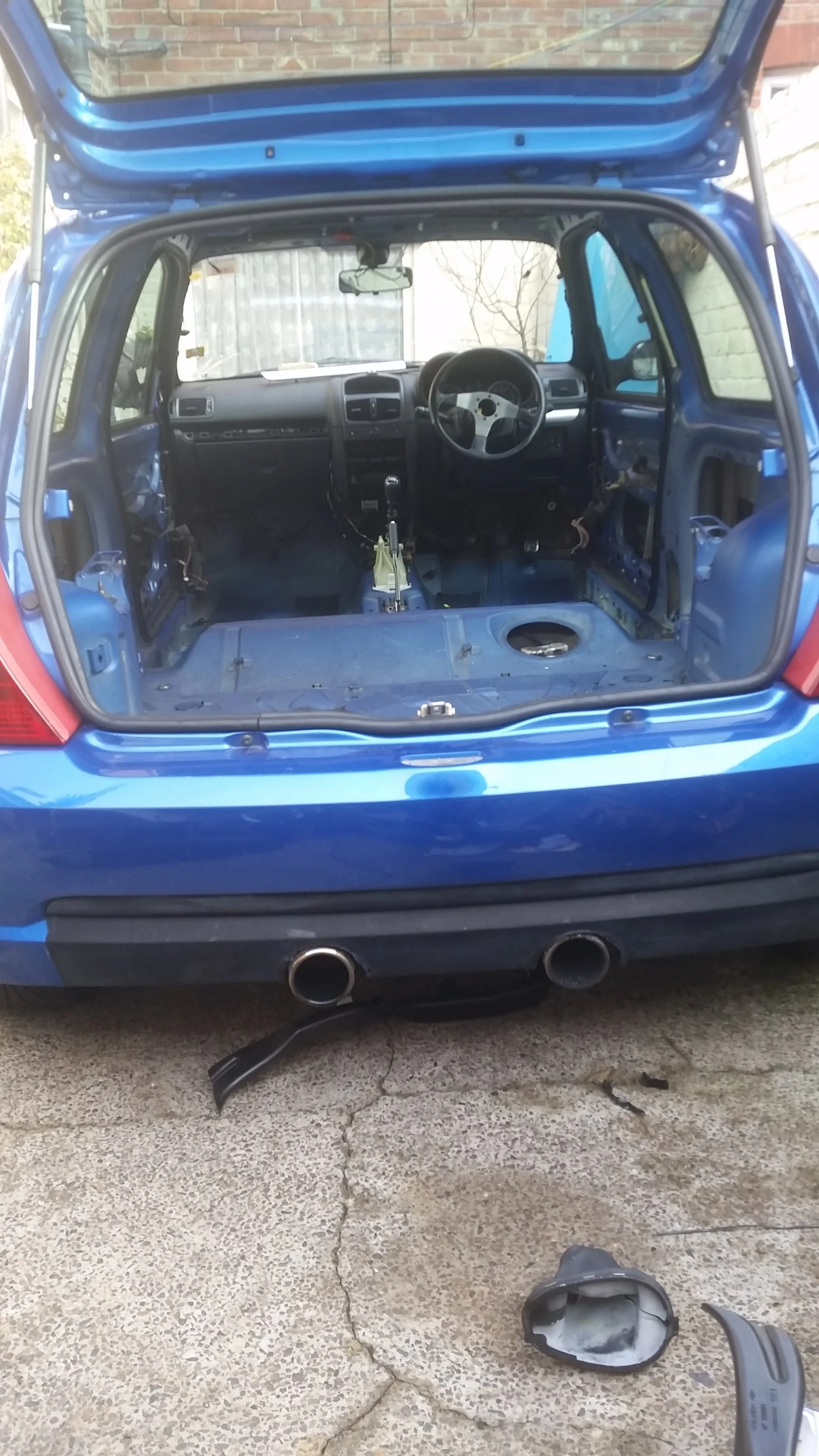

So a bit of progress today, interior is now fully stripped, wiring loom removed and top half of the dash is away to get flocked....also went to collect my CM composite fiberglass bonnet and splitter today :)

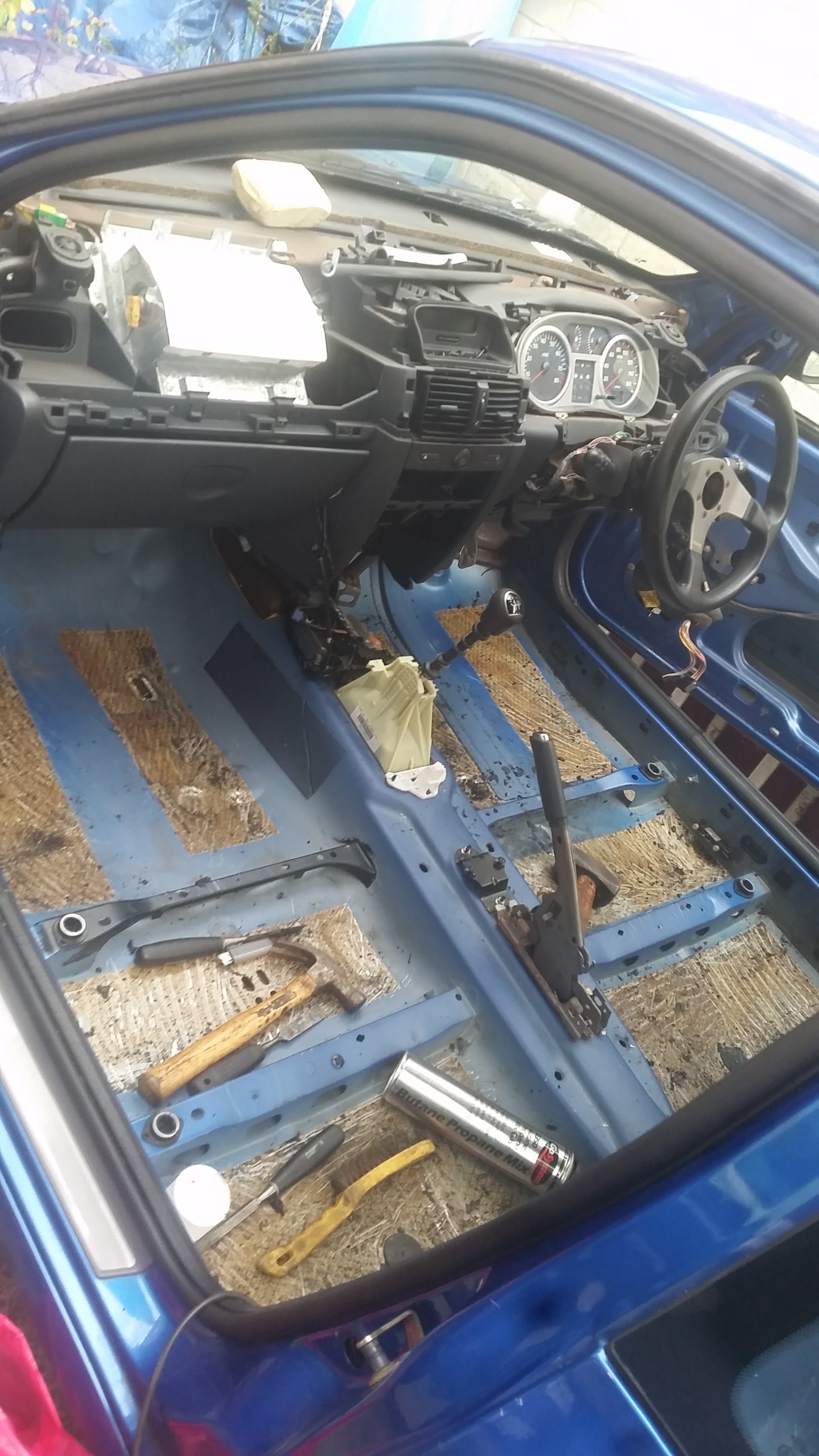

Made a start stripping off all the sound deadening....I know it anal but the bag weighed 7kg so well worth the afternoons work....just need to paint stripper off the glue and then the interior is ready to be prepped for paint.

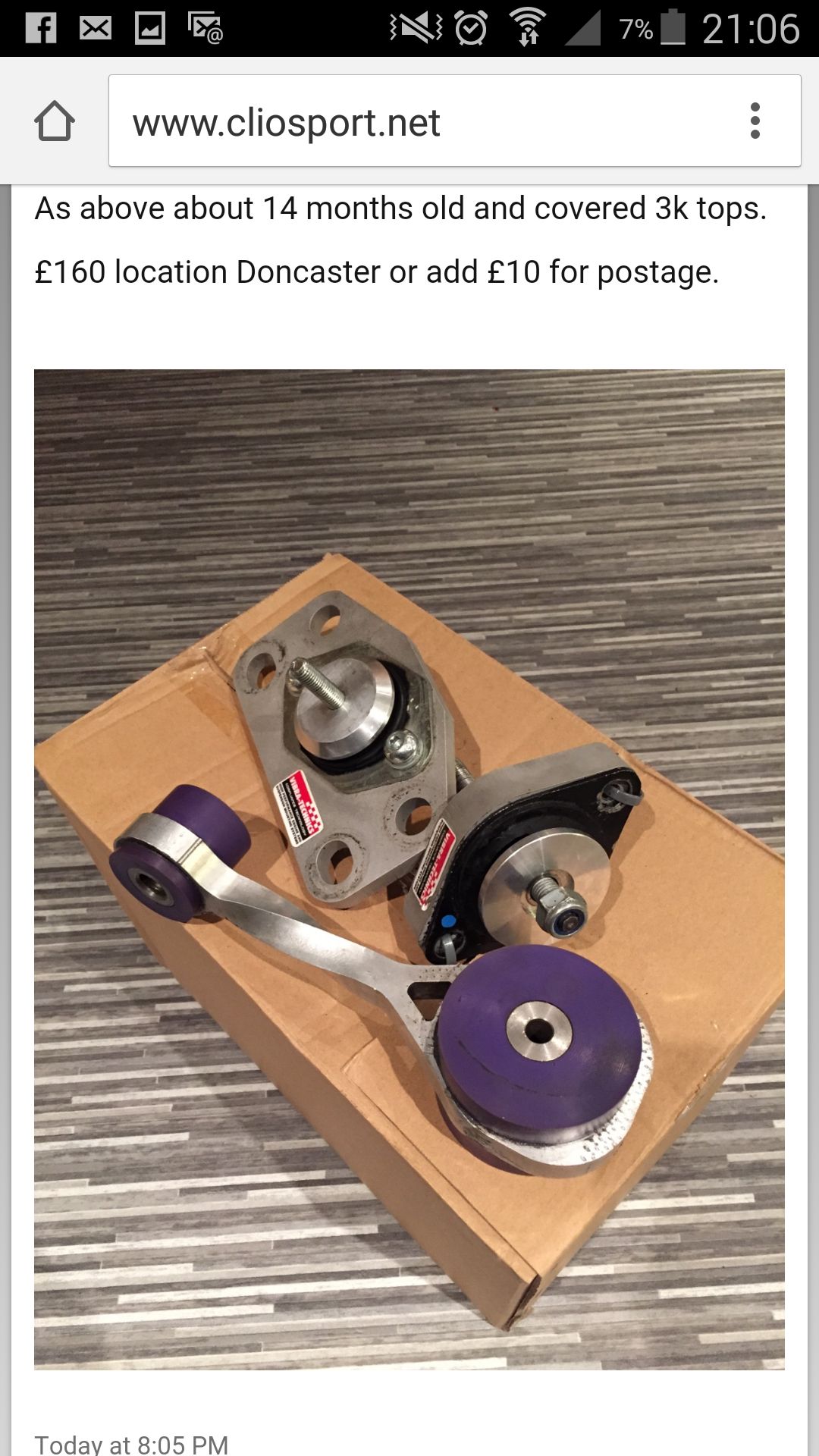

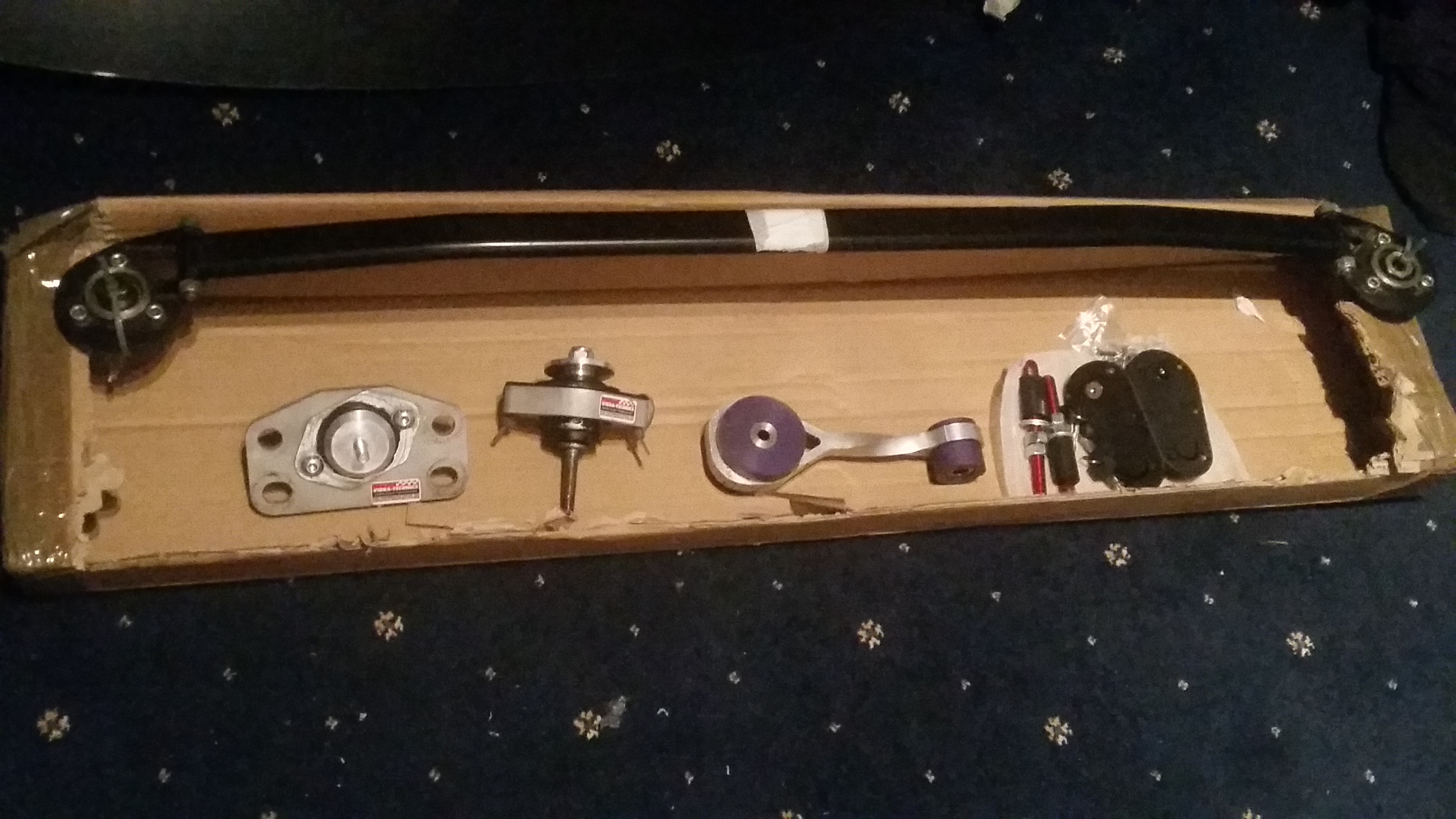

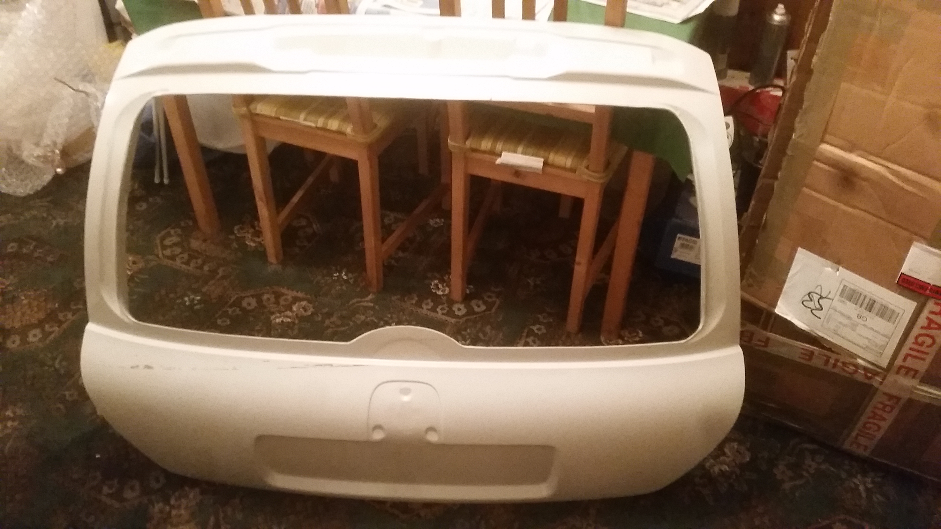

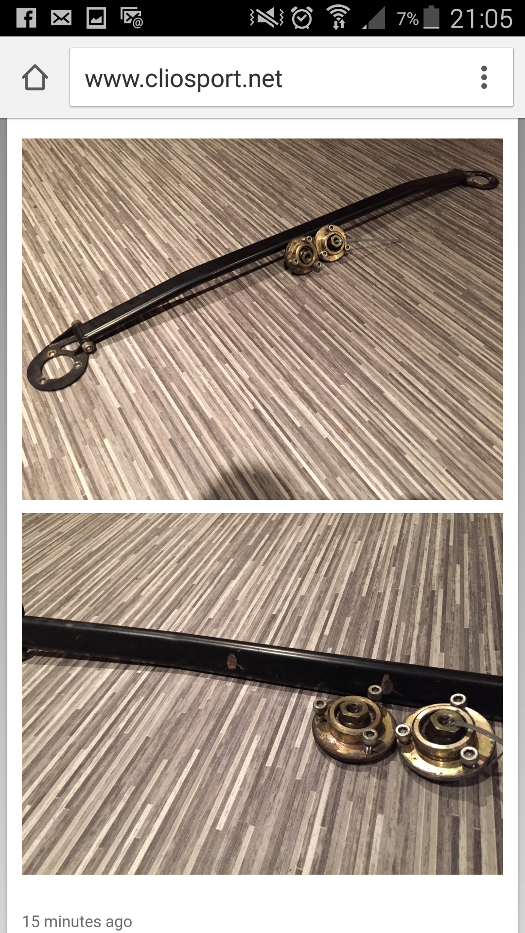

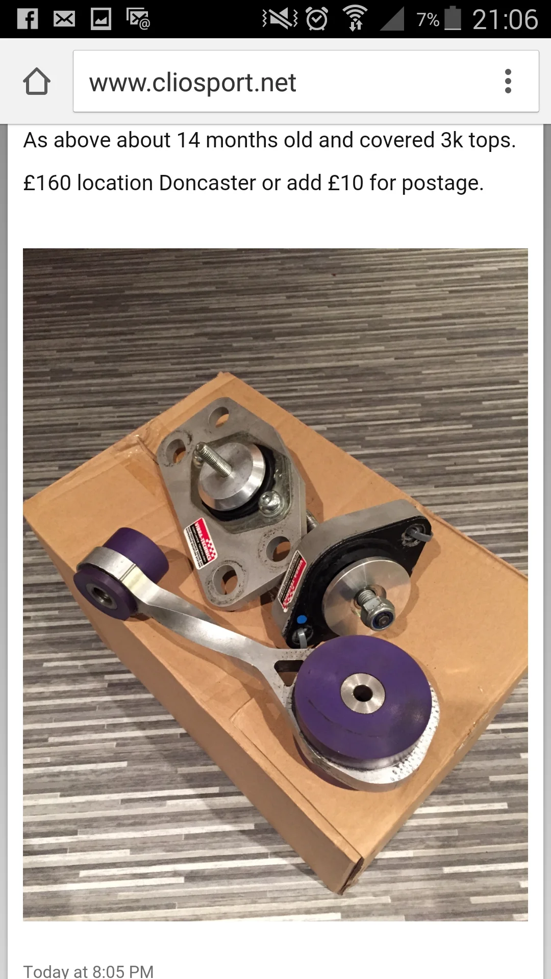

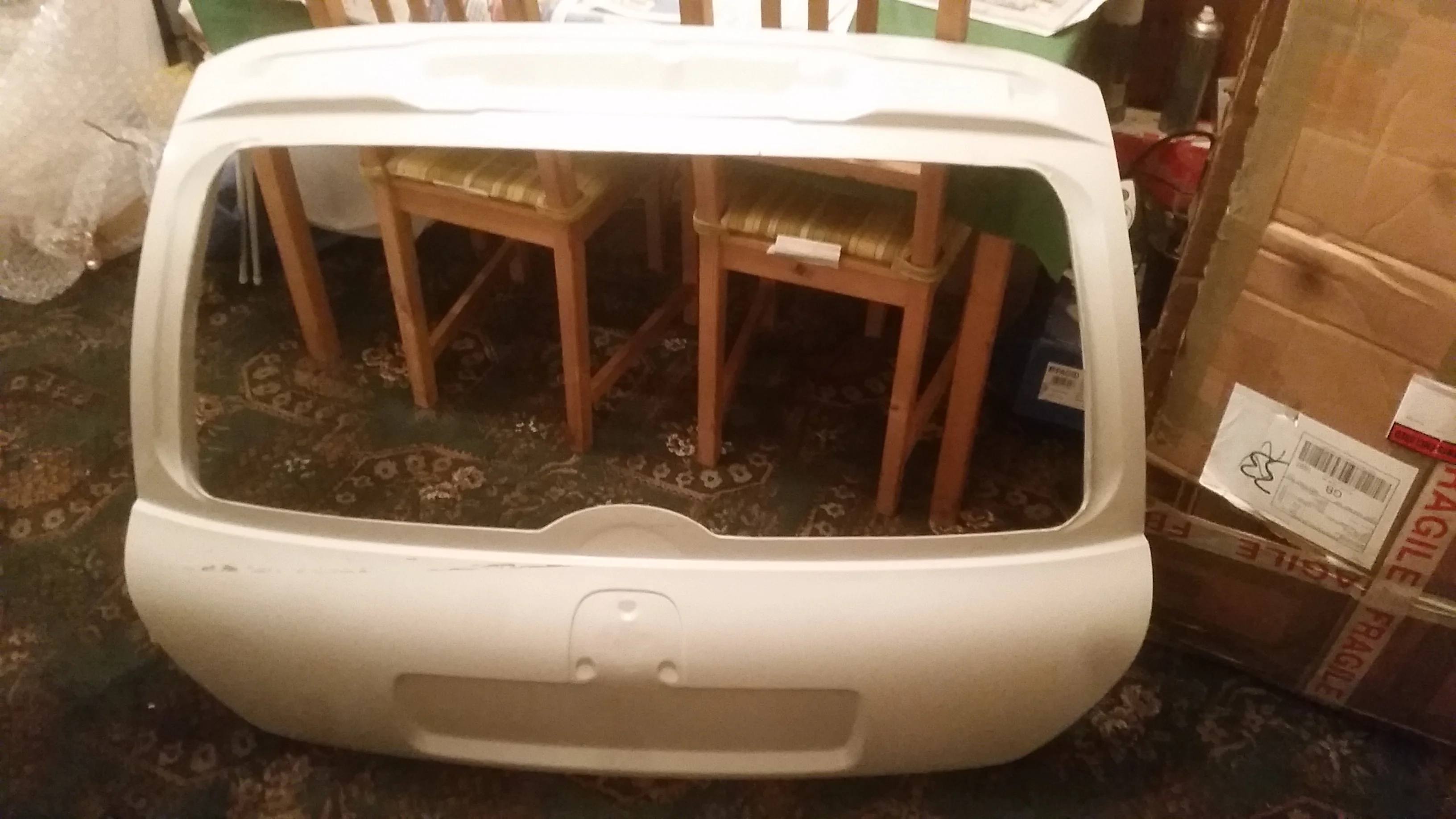

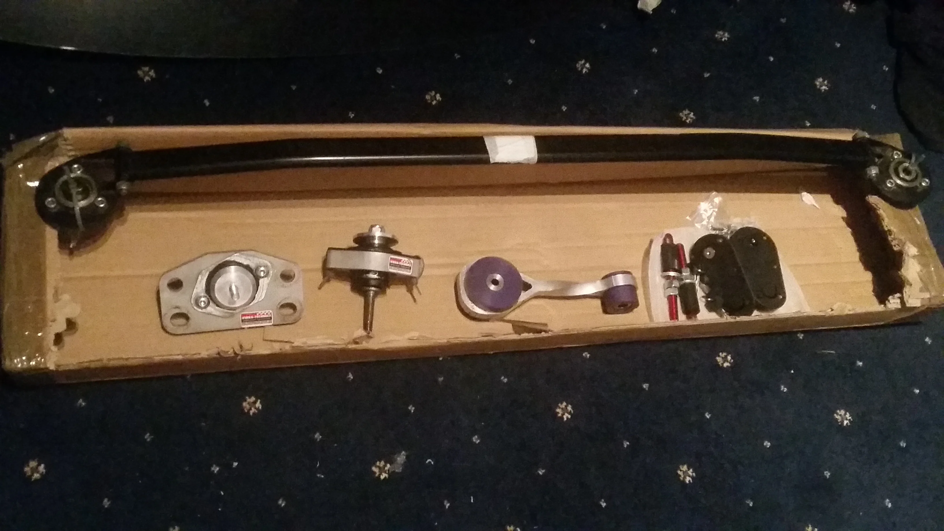

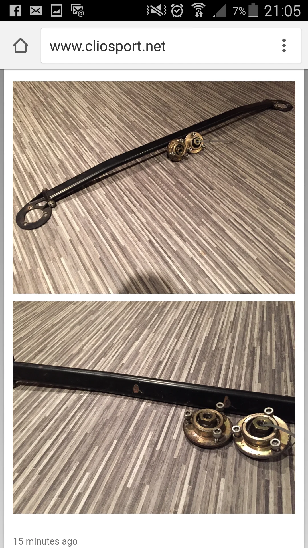

More new parts ordered! PMS top mounts with matching brace along with vibratec engine and gearbox mount + polly bushed dog mount.....oh and I ordered my fiberglass tailgate too!
Can't wat for the post man to arrive!

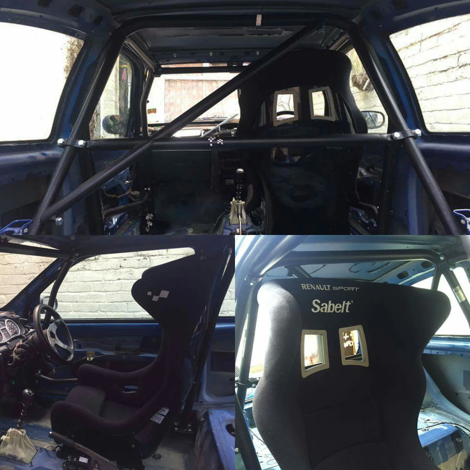

Rollcage is here!! Looks like an awsome piece of kit, also off to collect my PMS shifter and lexan window kit this week too.
All systems go just need to get the time off work now to fit it all!

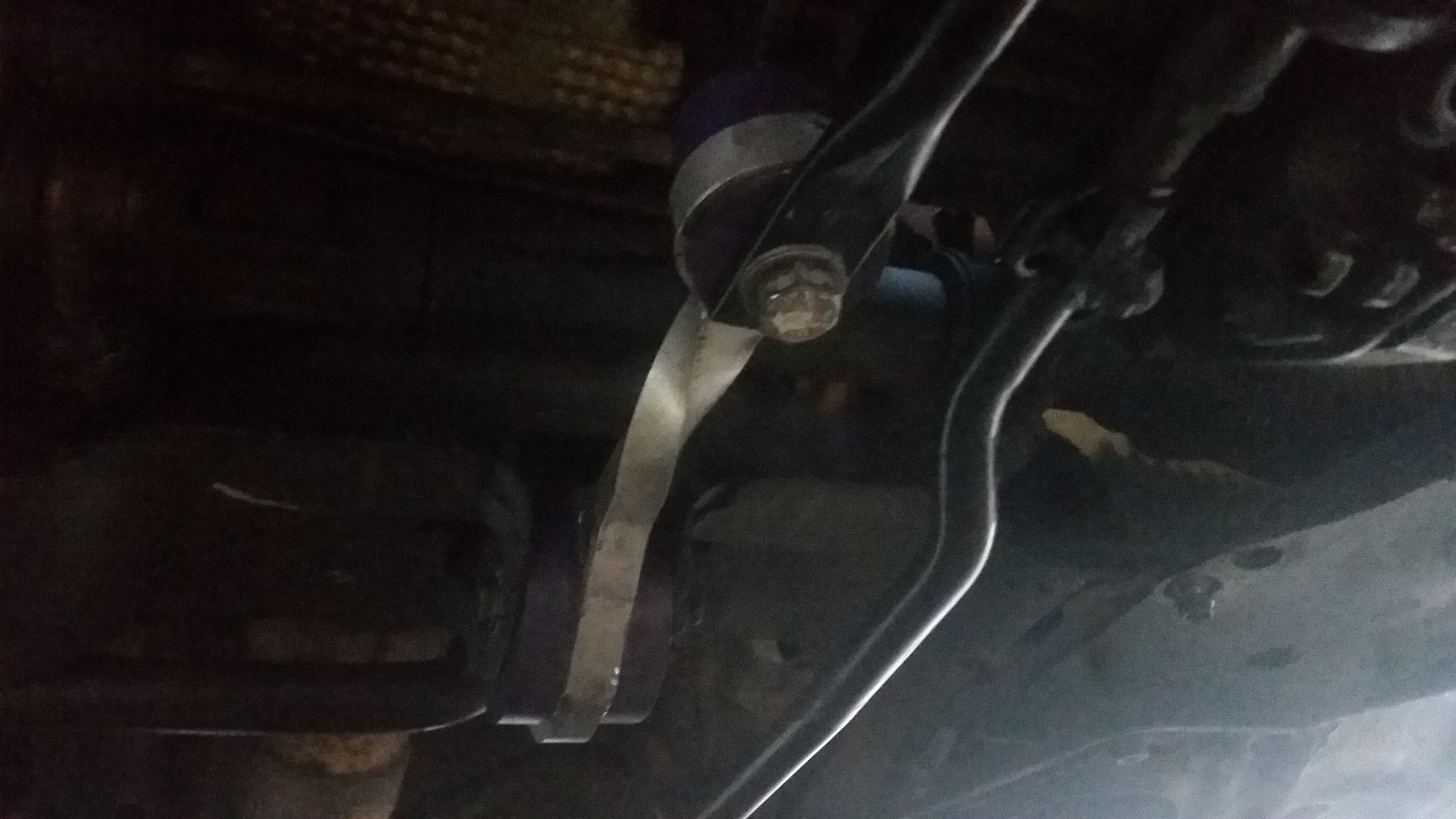

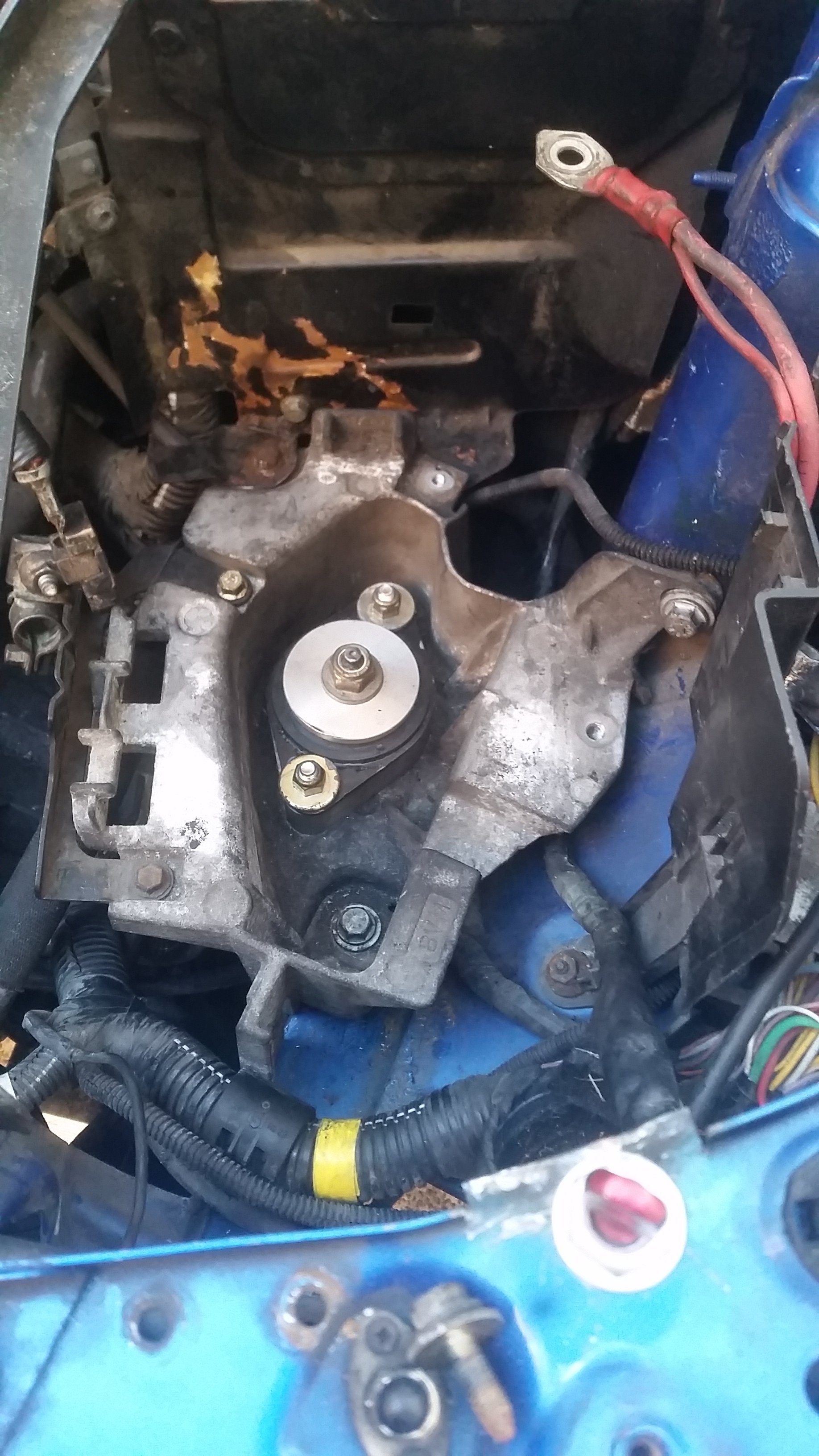

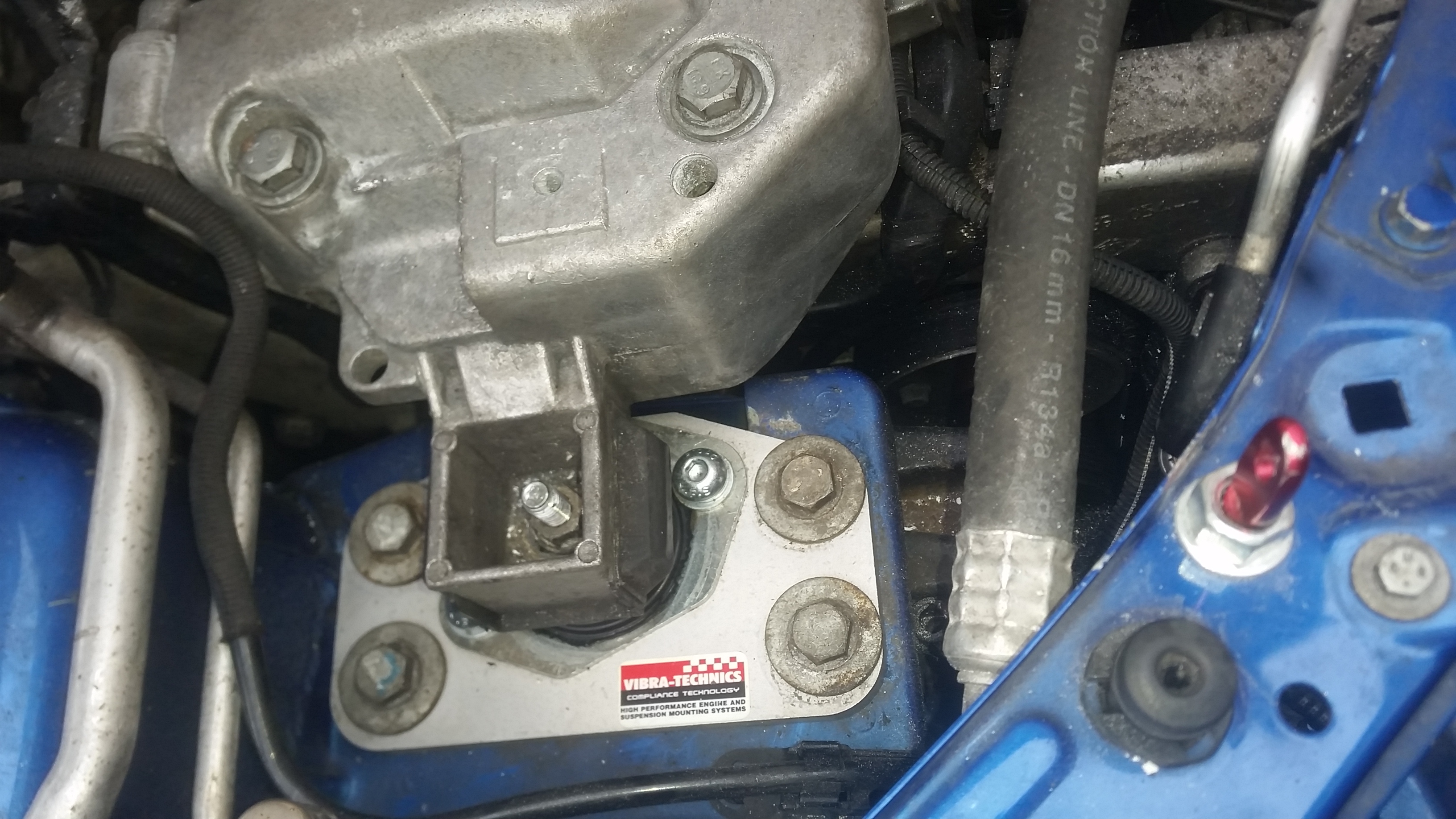

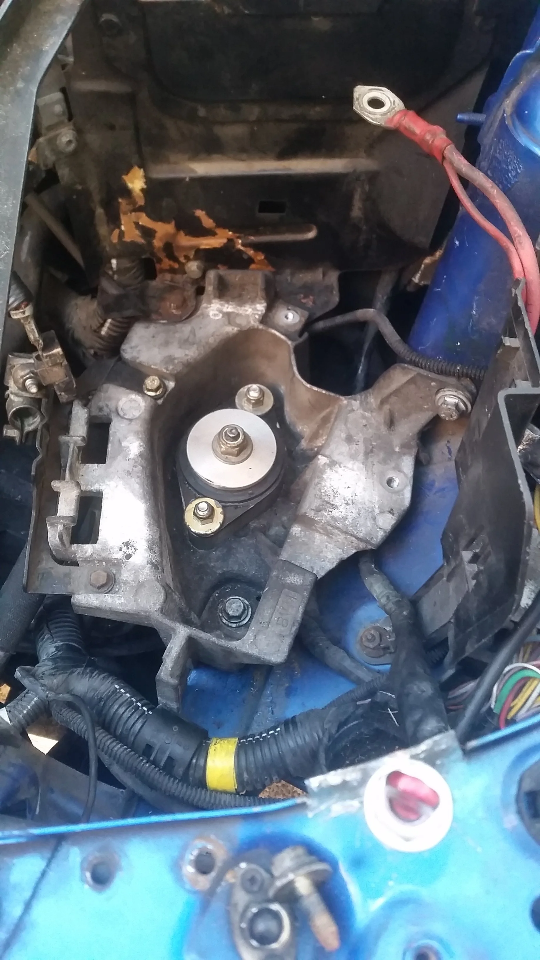

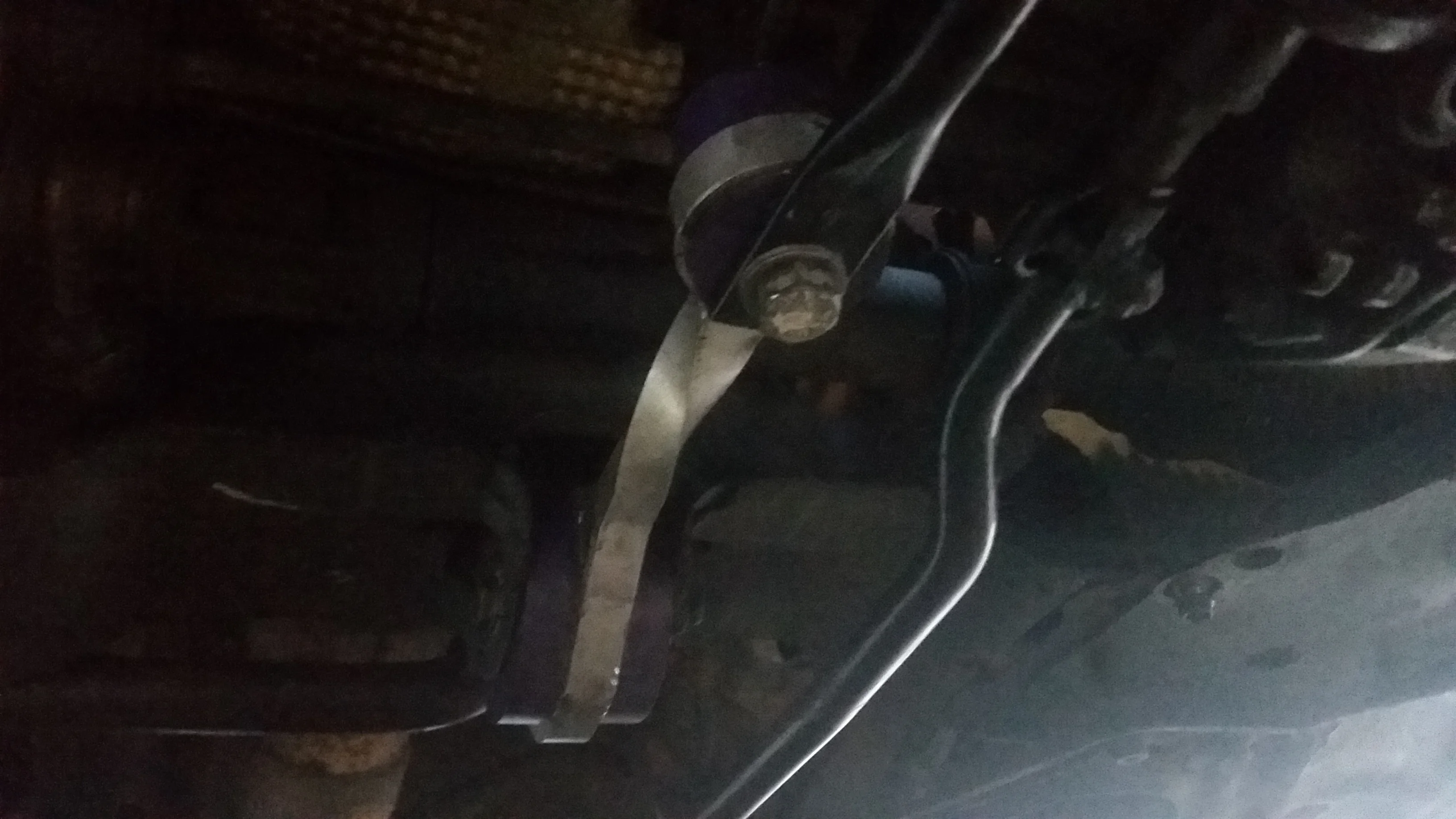

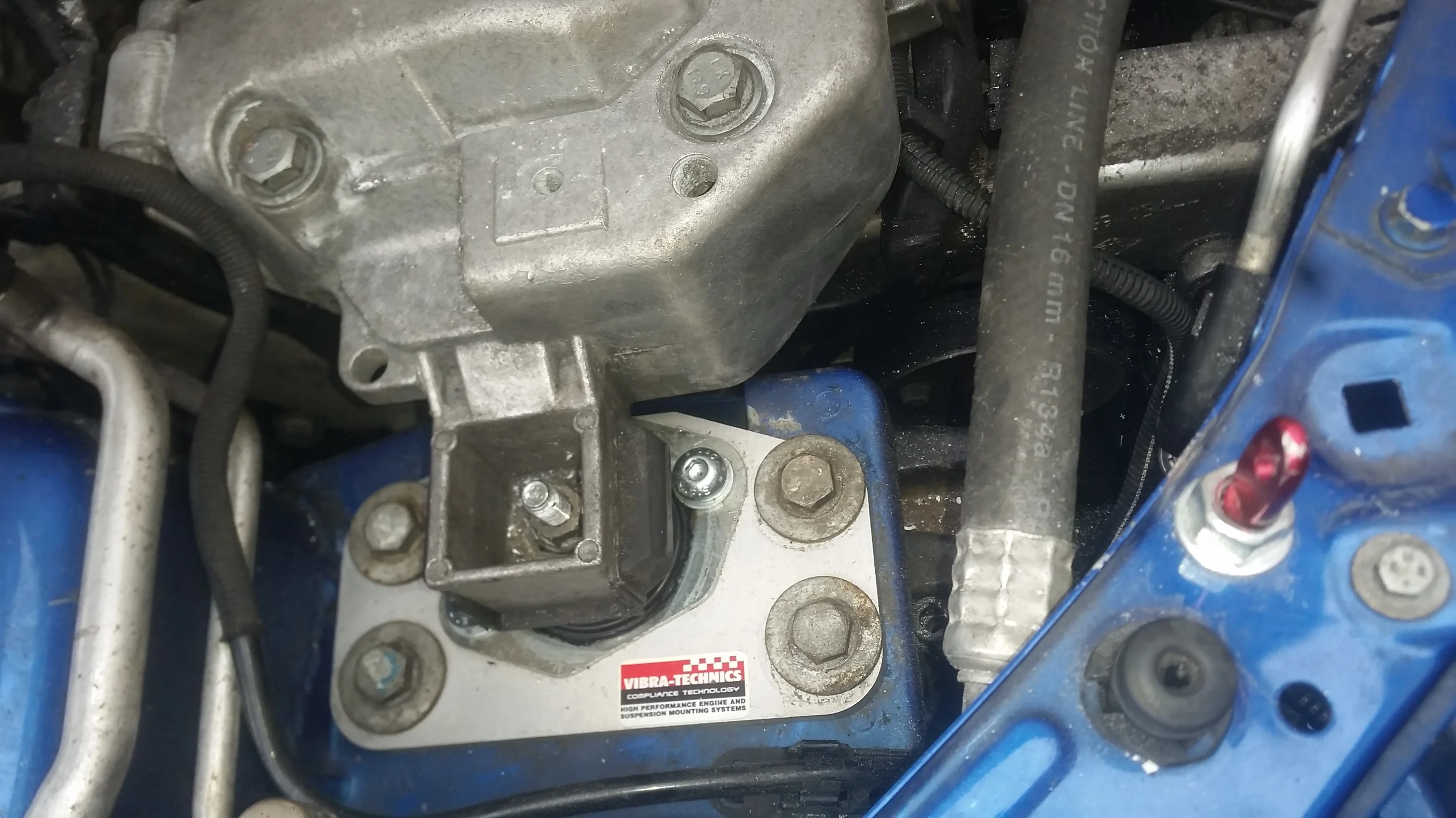

So today I fitted the vibratec engine and gearboxmount along with the powerflex polybushed dogbone....gutted I can't take it for a spin to see how it feels as it's off the road but I look forward to that!

PMS Fiberglass boot as arrived :) lexan rear screen on its way. So much weight saving :)

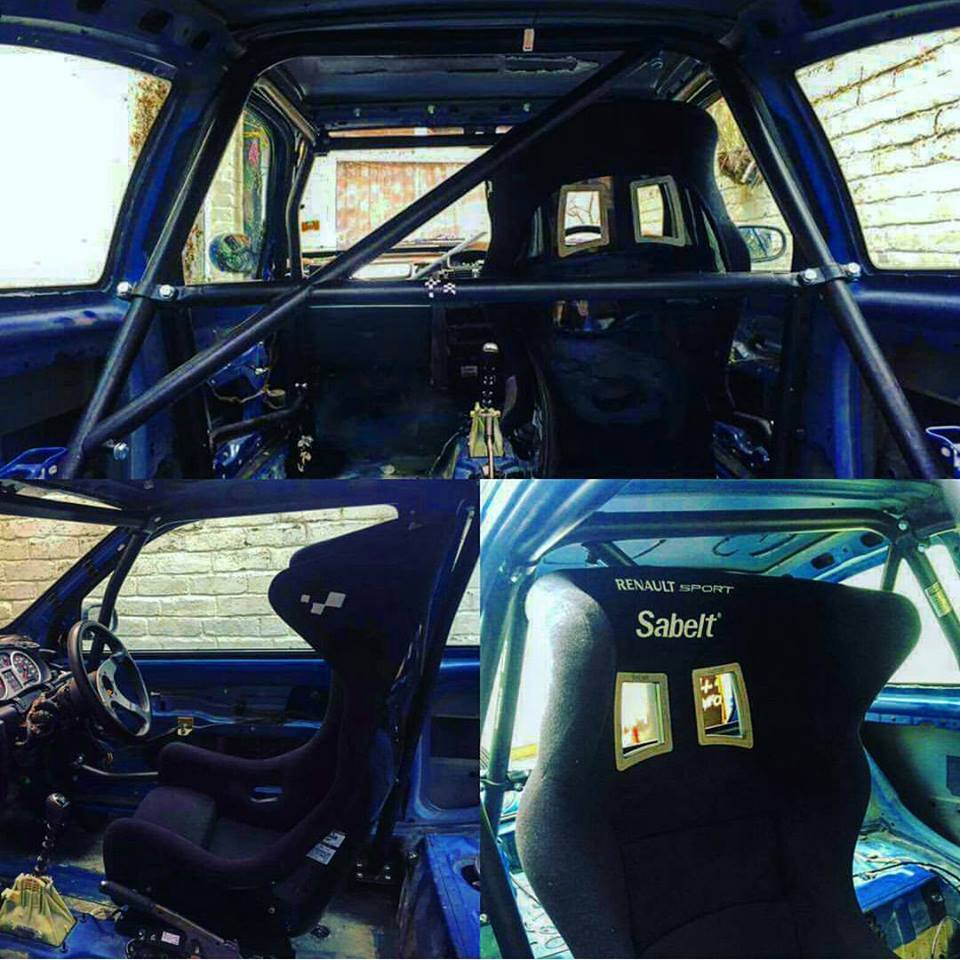

Looks awesome so far, did you fit the cage yourself? Suppose I really should get on with mine really as its sat on the driveway doing nothing

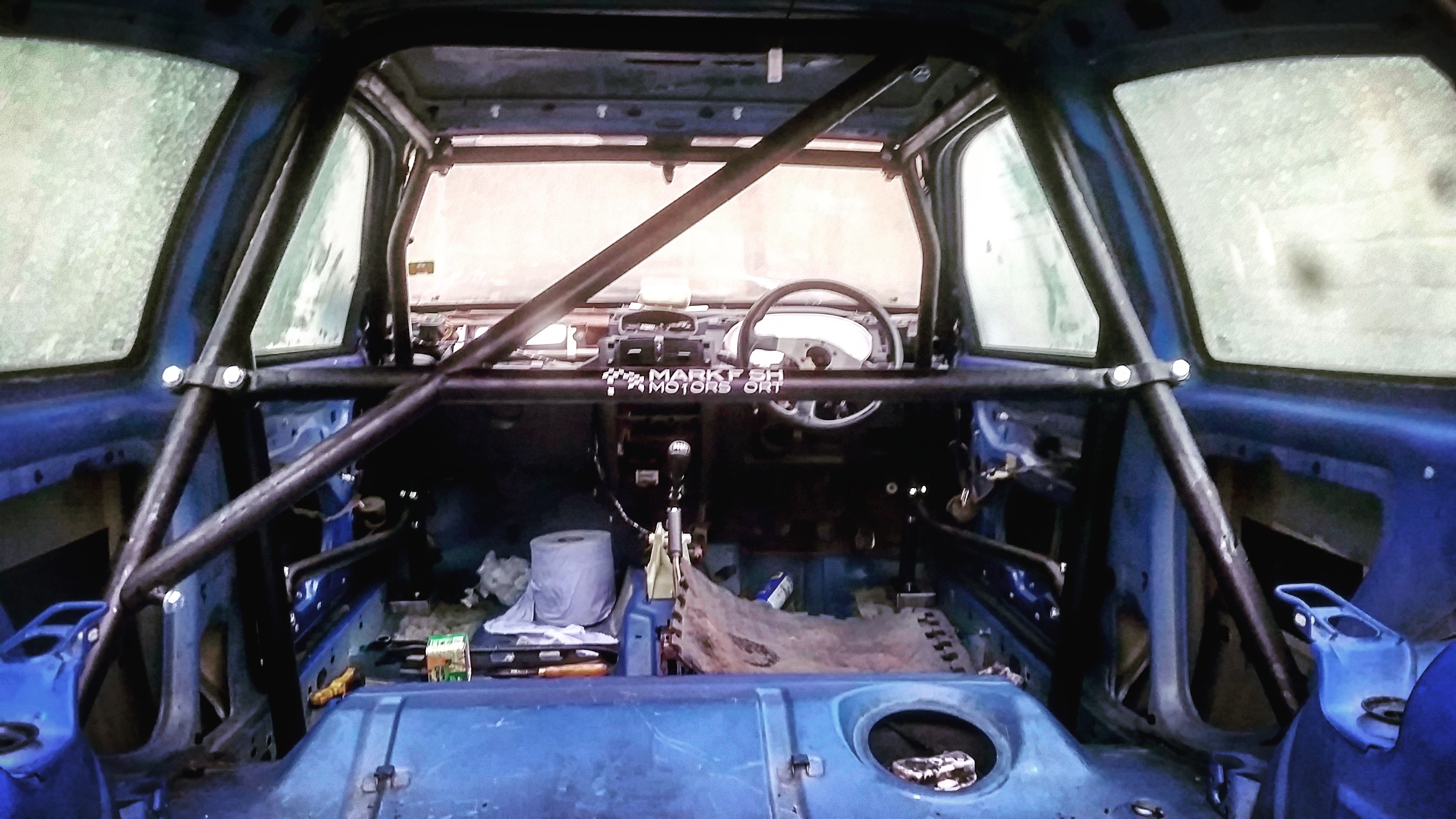

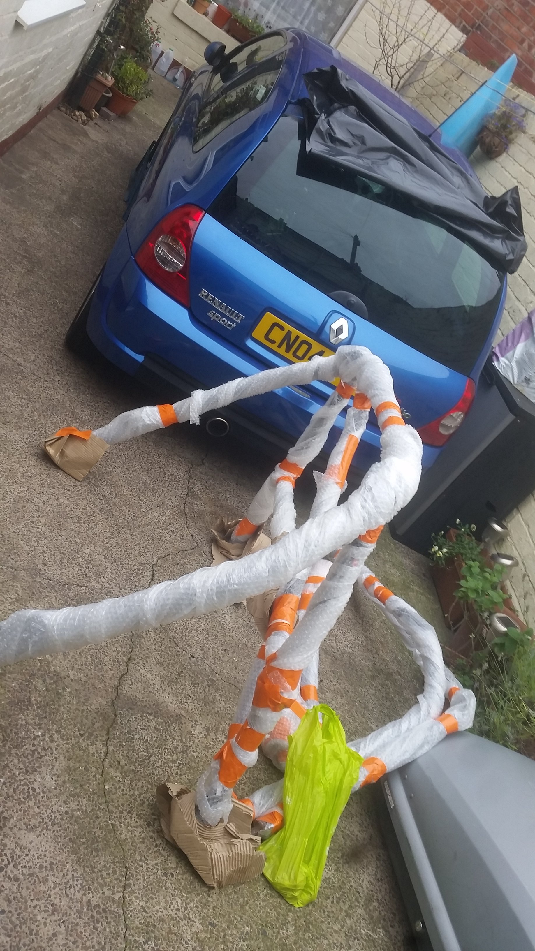

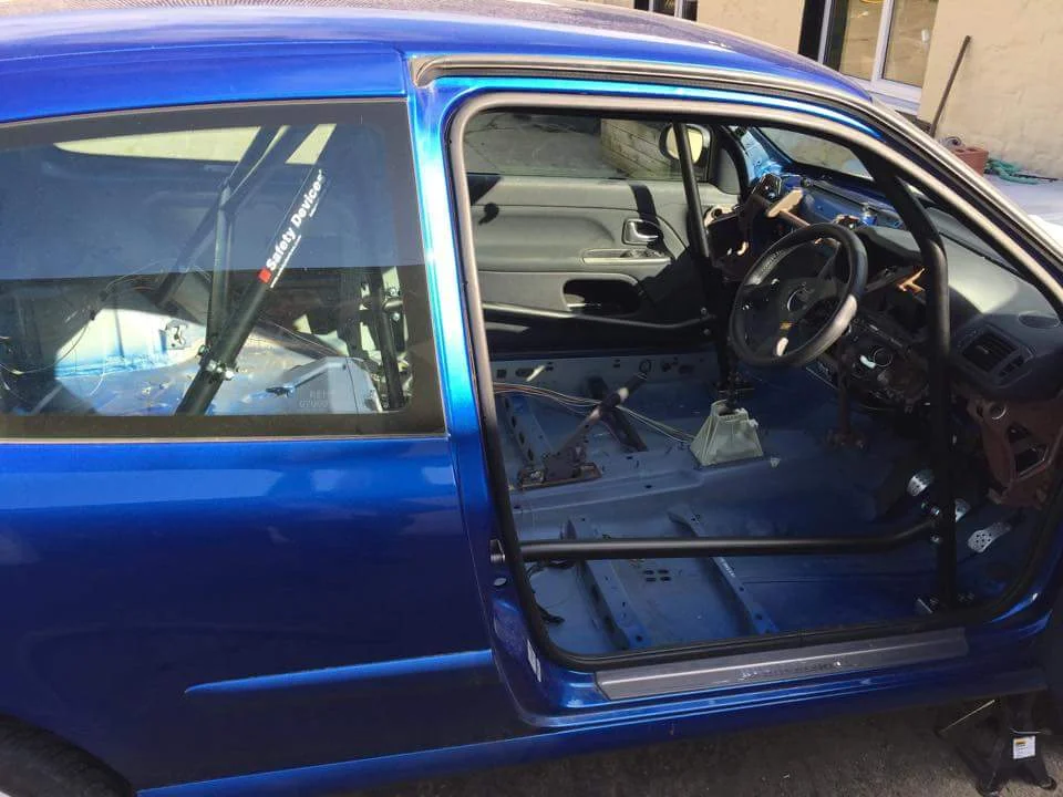

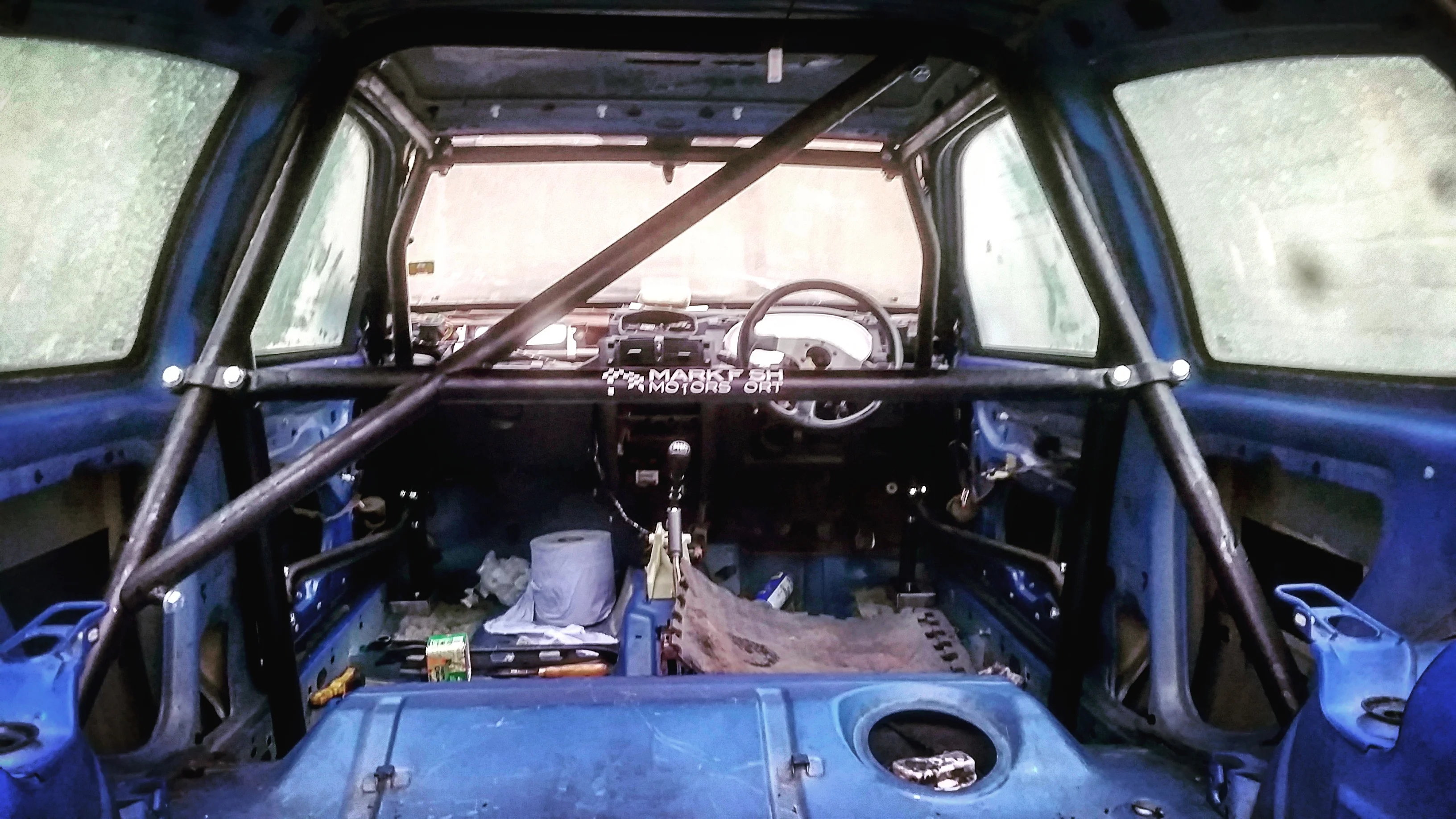

Thanks mate! Cage isn't actually fitted yet. The photo of it in a car was it in the guys car I bought it off! New mounting kit should be here next week then ill be welding those in and fitting the cage

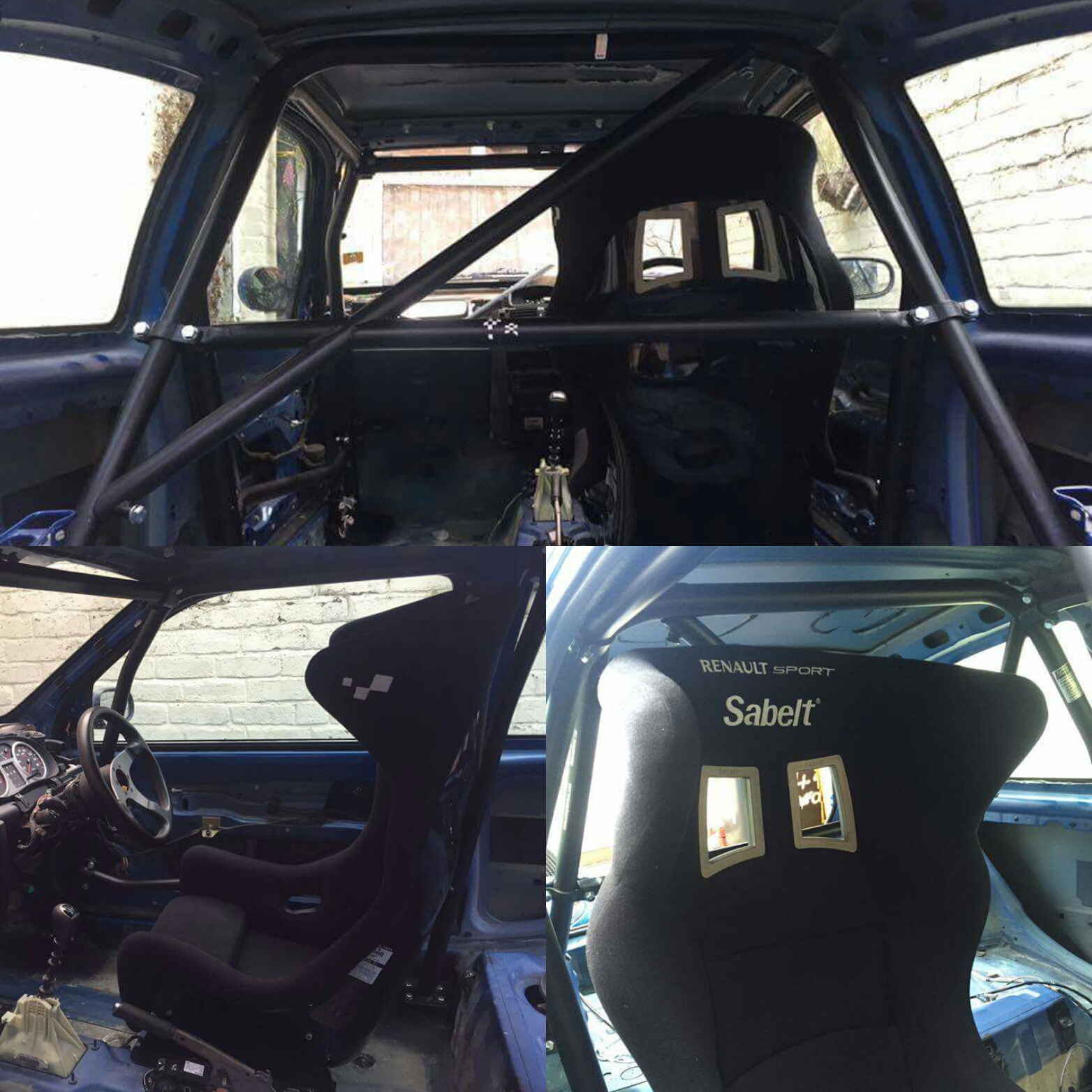

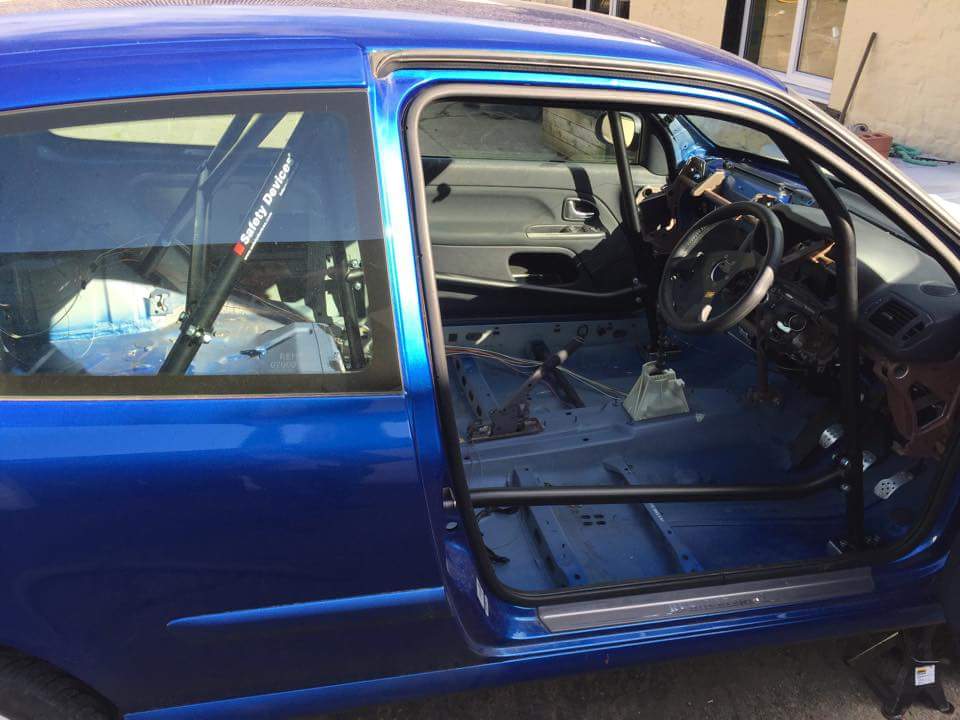

Built up the cage today and started to do some welding! Love how it's looking :)

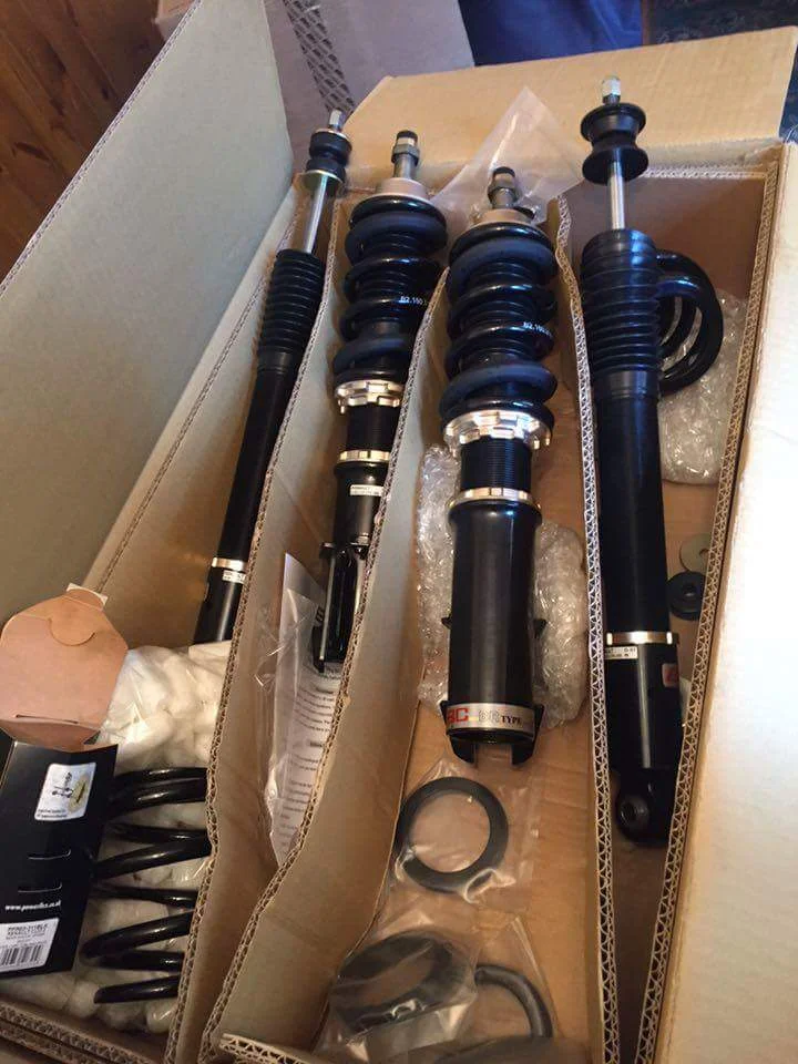

Been quiet recently with progress.....weather has been poor and new job has ment not much time off, however plenty parts have been arriving :)

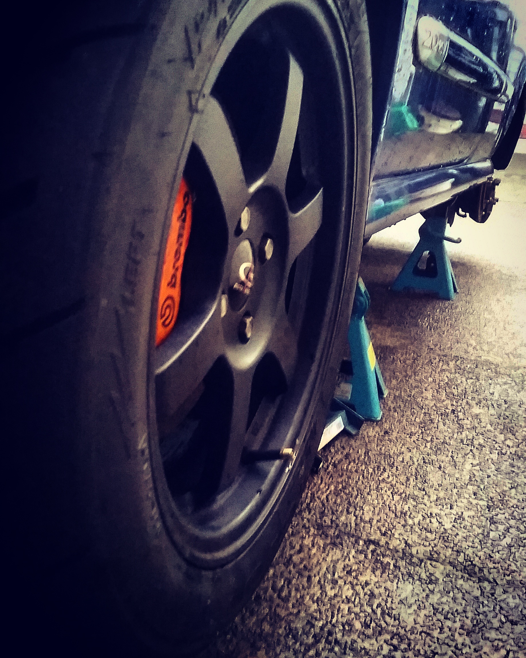

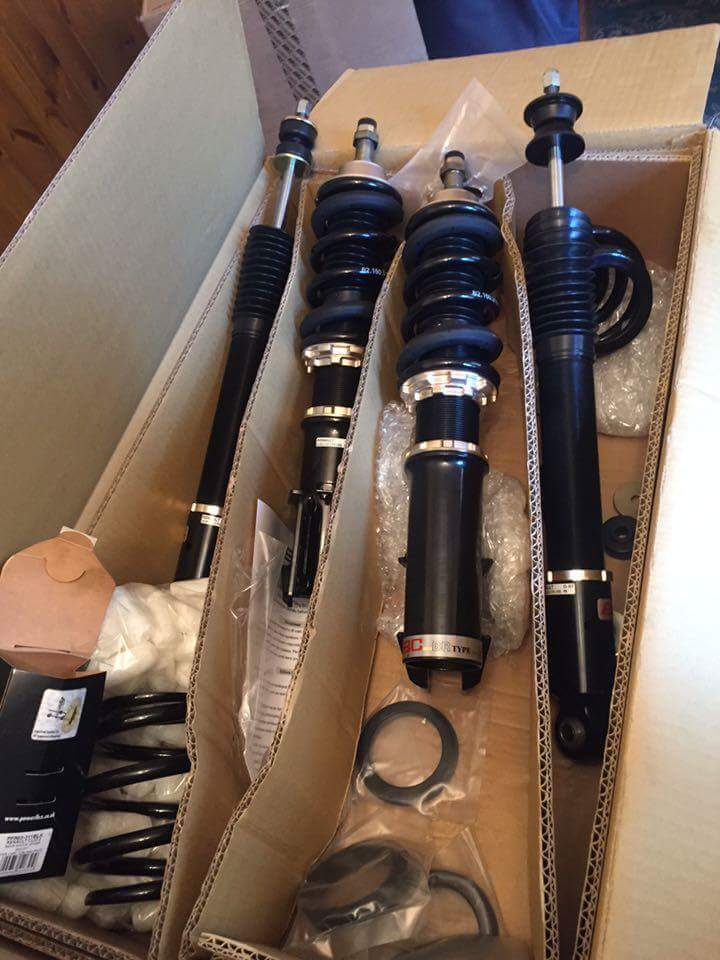

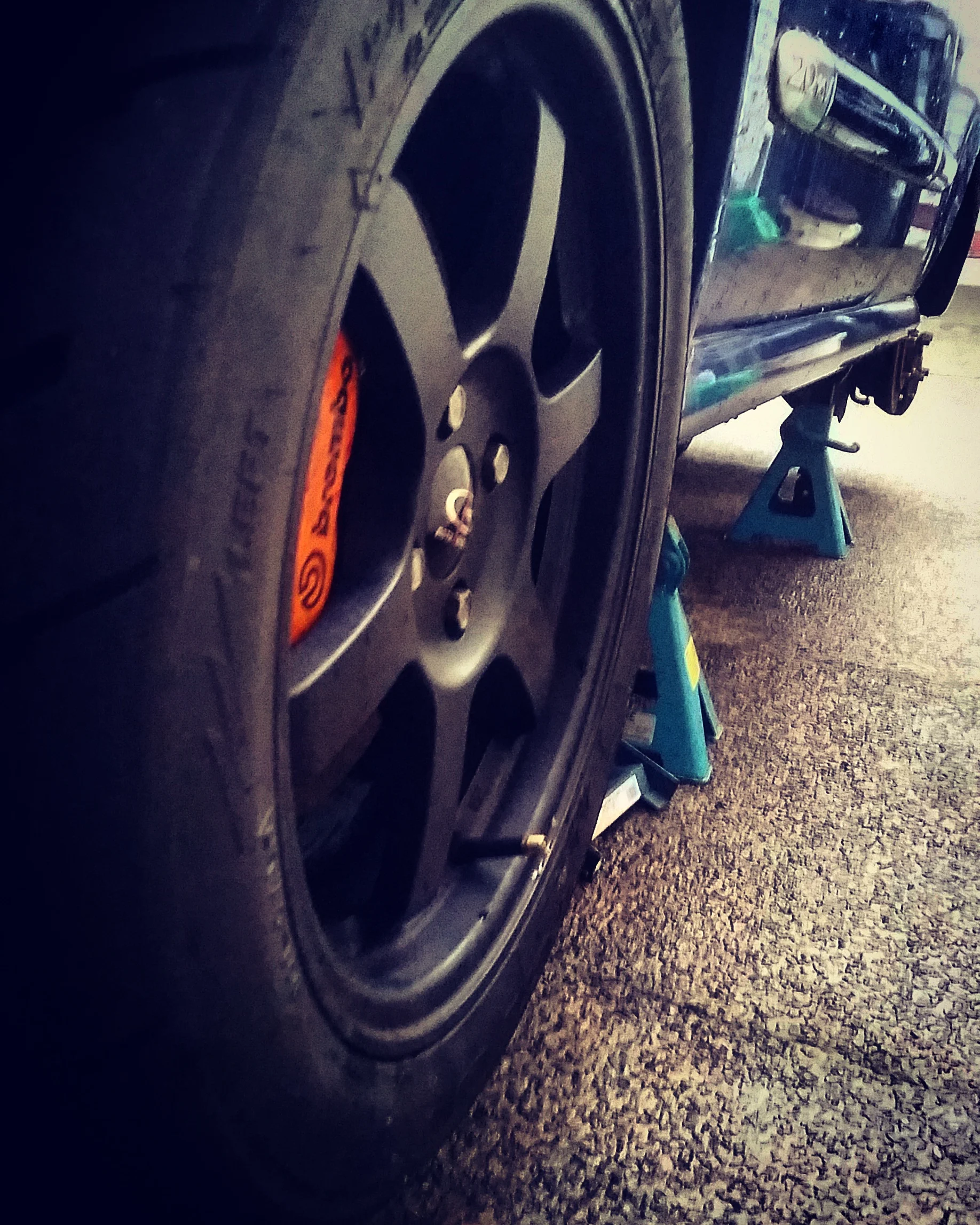

Bc racing coilovers are here, set of 300mm brembos arrived along with my new rota grids with 888rs...happy days!

Aye LY inside and out :) brembos are going red, all windows apart from front screen are going lexan so yea, should look and go quite well I hope :)

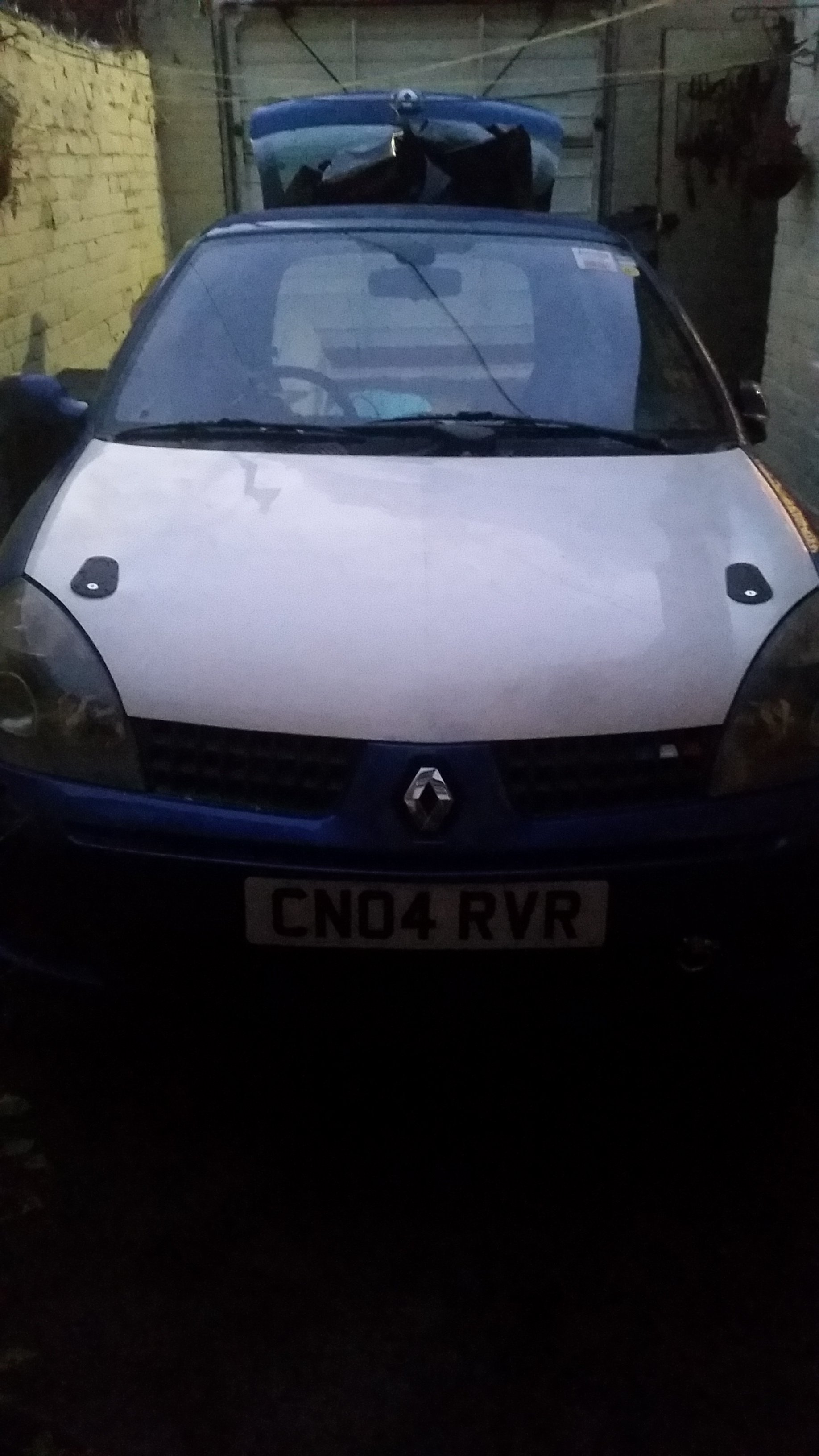

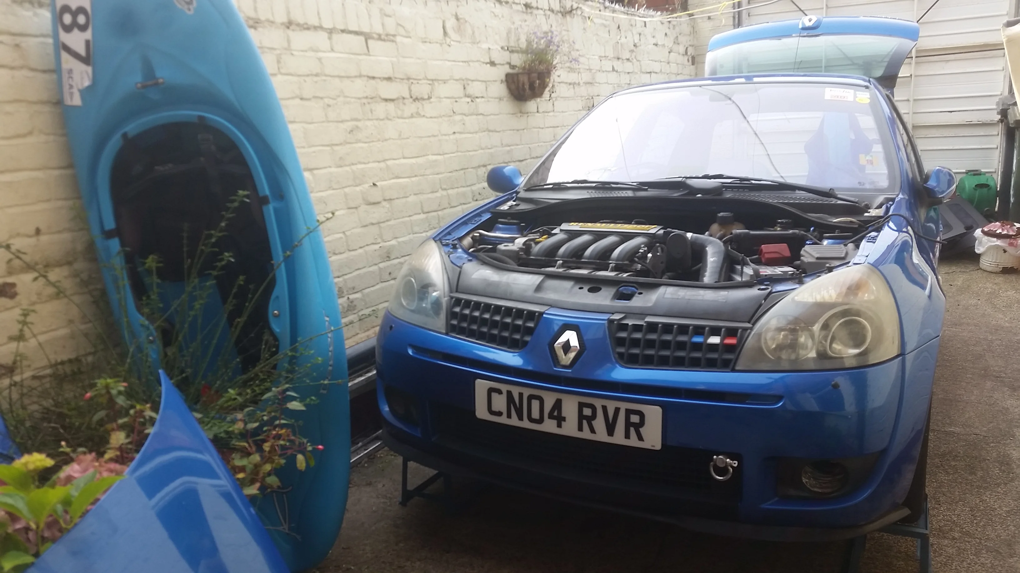

few progress pics today, away with work for a week and the car is sat at home waiting to go in for its colour change next weekend :)
