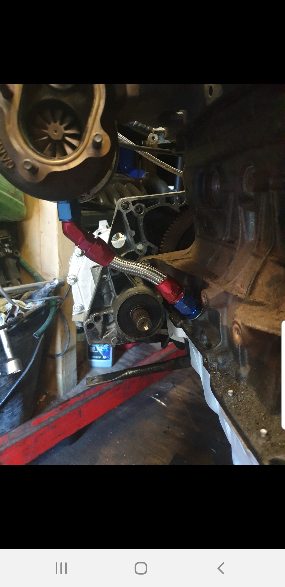

Tapped it into the block. There is a small flat area just above the sump which is big enough to tap, thread and fit barb.
You can see it in this photo:
This only cost me about £45 I think or somewhere near
