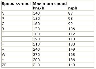

The one that came off the car was a R16 83V. The spare one that I have just fitted to raplace the gubbed one is an R16 83W.
I know that the W/V referes to the speed limit the tyre can handle, but which one has the higher value the V or W??? I think its the W but I aint sure
