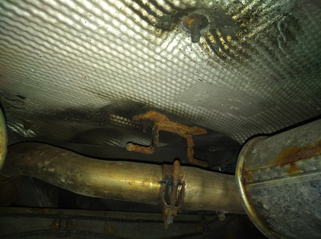

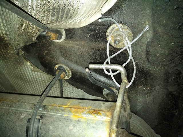

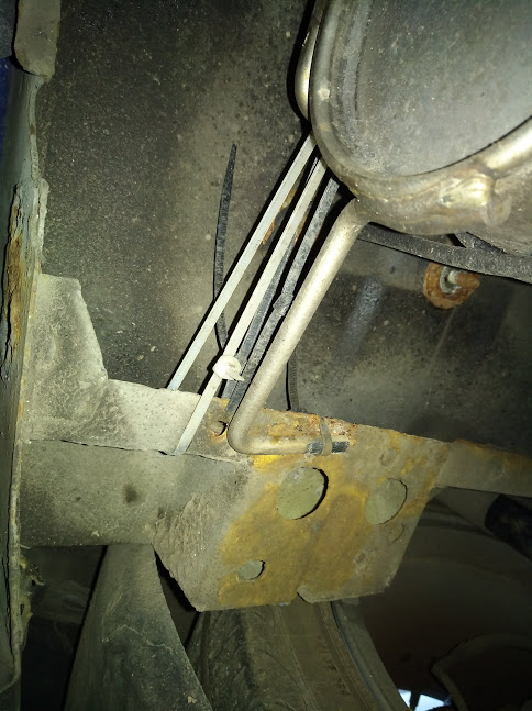

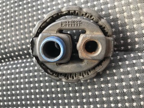

Erm... I've inspected the exhaust on a project I bought a while ago, it's a reet mess.
It's some powerflow thing, I think. The welding isn't great, so guessing it's not an off the shelf item. Anyway, WTF should the hangers look like at the rear, as this is proper blue peter:
Gus
  182Turbo,DCi90
There should be two of those - you are missing both the black bracket and the exhaust hanger on both sides. There is then the U shaped bar hanger nearer the rear beam for extra support.

Might not, looks like the hangers are right up near the body. Maybe a set of universal back boxes designed for something else?

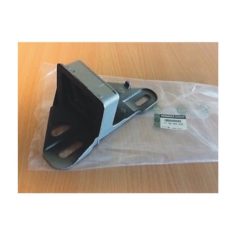

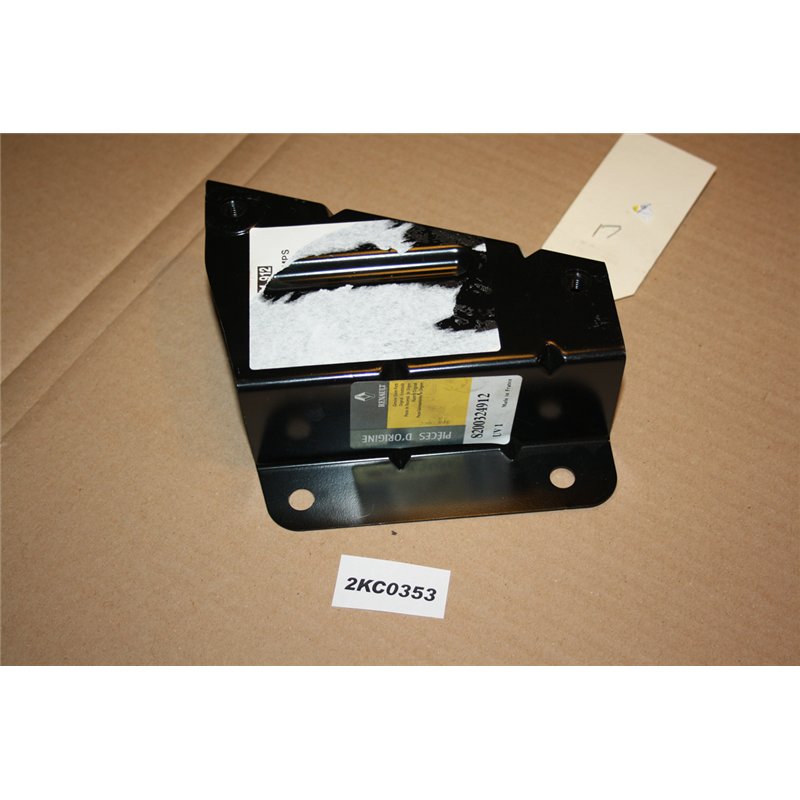

As @Louis says you need the actual floor mount bracket when is no longer made or supplied by renault.

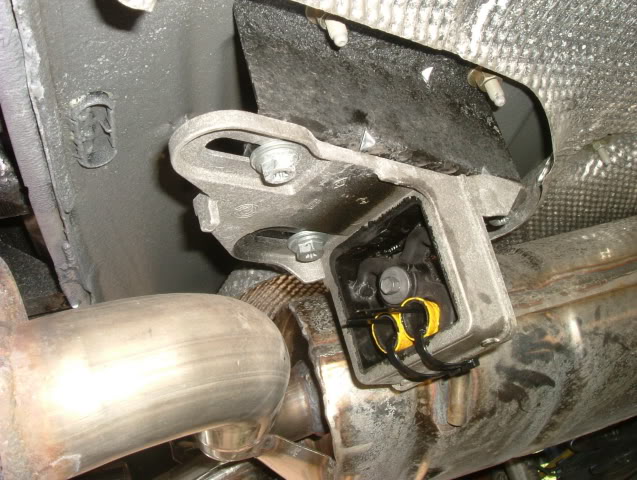

You also need new exhaust mounts and rubber by the look of things.
2 x These - Believe these are around £25 each from renault.
2 x These - Exhaust hangers that mount to the one Louis posted - Can pick them up as little as £9.00 each
2 x Exhaust Floor Mounting - As Louis says and now no longer made or available from renault.

Thanks dudes.
I've bought a hanger. going to make a bracket out of some spare sheet metal.
