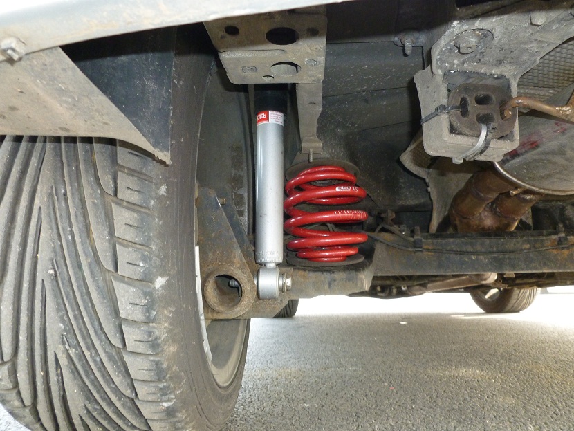

off topic, this pic just shows the shabby exhaust mount. How can Renault come up with a cracking car and slack in the exhaust department yet again.
I have sportlines, money well spent they are !
lol, that "shabby" exhaust mount was made by me as a quick fix when I was fabricating the exhaust. Just got a big old rubber mount and cable tied it in there. Not forking out top brass for the renault shite what will last 5 minutes :rasp:
my fix is rubber pondliner from work rolled into 20-25mm rolls and pushed into the gaps between the arms of the renault mount then cable tied through the hole in the middle. Job done!
