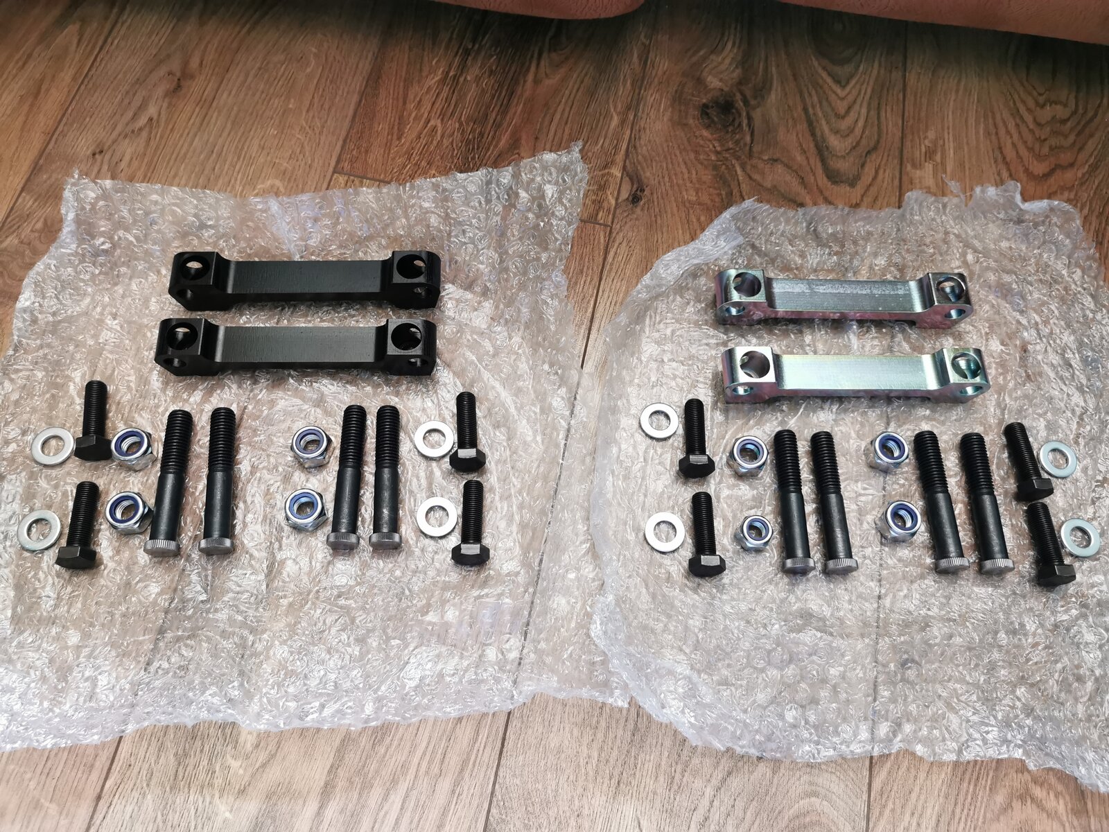

I did some in steel and some in 6082t6 aluminium. They were zinc plated / hard anodised for extra corrosion resistance.
Those ones above say they are for 300 discs and you can machine the calipers to fit 280's. The calipers need 5mm off to fit 280's with the correct size brackets anyway, I've not seen anyone say they have machined 10mm off a caliper as it's unknown if that will break through into the cavity and scrap the caliper! If someone has a fucked caliper I'll happily try and see what happens. Also the ones on here that are crumbling were made from 7 series aluminium and like those un coated. It's strong but has bugger all corrosion resistance, which is why I used 6 series and hard anodised them. These are mine:

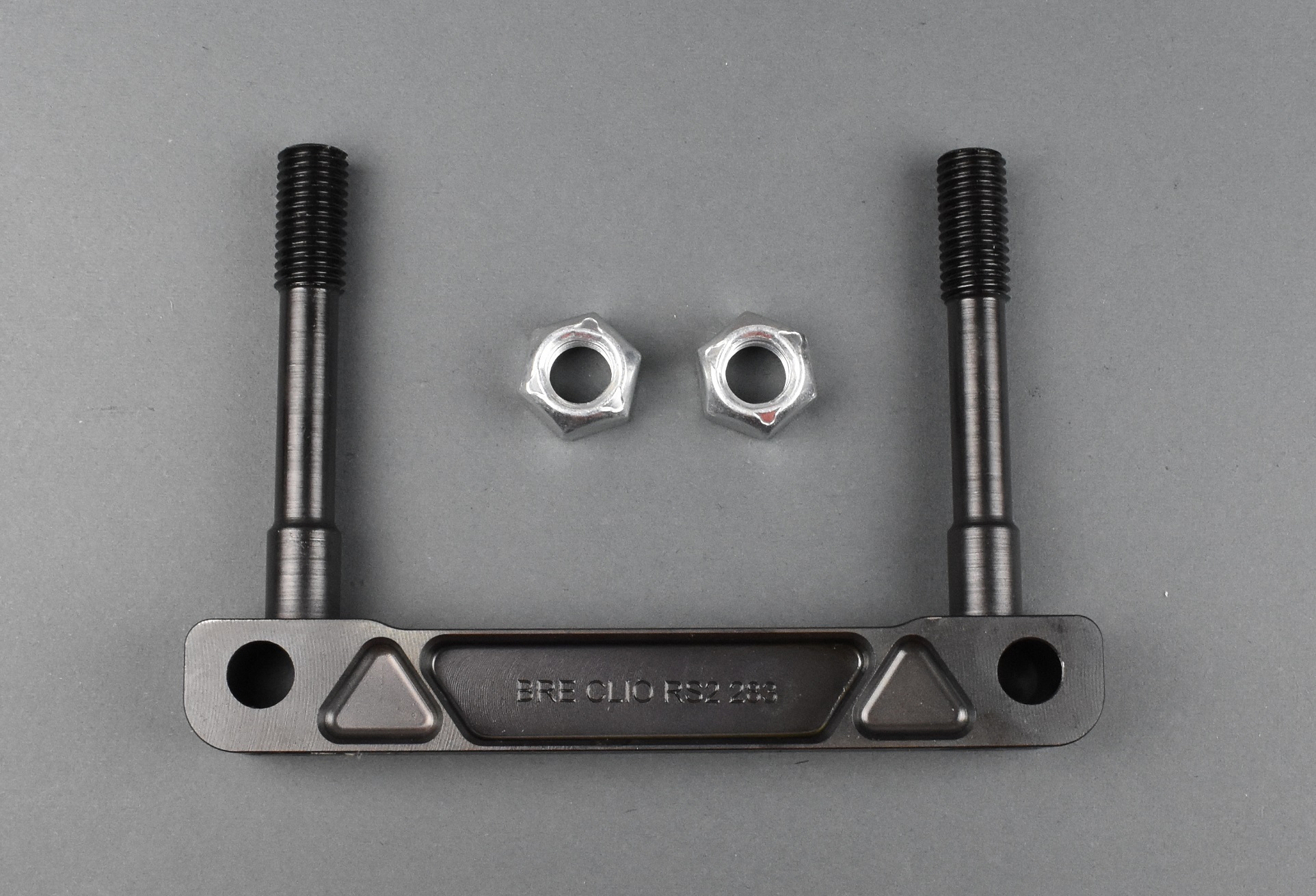

I’ve taken on to do the very same, 197/200 brembos under OZ Superleggara 15’s.
I ordered 280mm brackets from Nick in PMS and he sent me a diagram where 1mm needs to be machined off the callipers face that meets the bracket and the to enlarge the holes where the original bolts go. I’m going to hold on until I receive the brackets in the post and offer everything up to the car ... just in case I misunderstood his instructions.
Although, in fairness, Nick is very thorough.
He mentioned that he was trial fitting the same thing under 15” 2118 with very un-Renault offsets and them requiring spacers ... but seemed to think my OZ’s with ET37 should be fine ... will know in the next week I guess.
Clio_fool
Yep that allows them to retain the minimum thread engagement in the bracket. Obviously your caliper machining is going to be more expensive once a machine shop see those tolerances!
