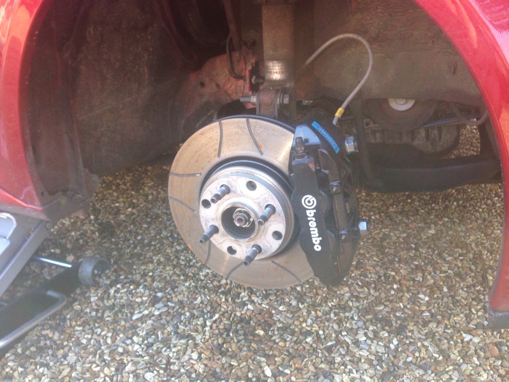

I have recently had my brembos machined down to fit with my 280 mm discs
I understand the wheels need spacing before they fit on but i must of put on like 35mm worth of spacers today, the caliper fits in the middle the top of the caliper hits, do these wheels just not fit or have I done something wrong can any one shed some light ?

Brembos won't go under 15" Oz F1s I'm afraid.
15" wheels they are known to go under;
- Speedline Williams
- Team Dynamics Pro Race 1.2
- Team Dynamics Pro Race 3
There are probably more. I think certain offset 2118s will go over them.
All will need varying size of spacers still.

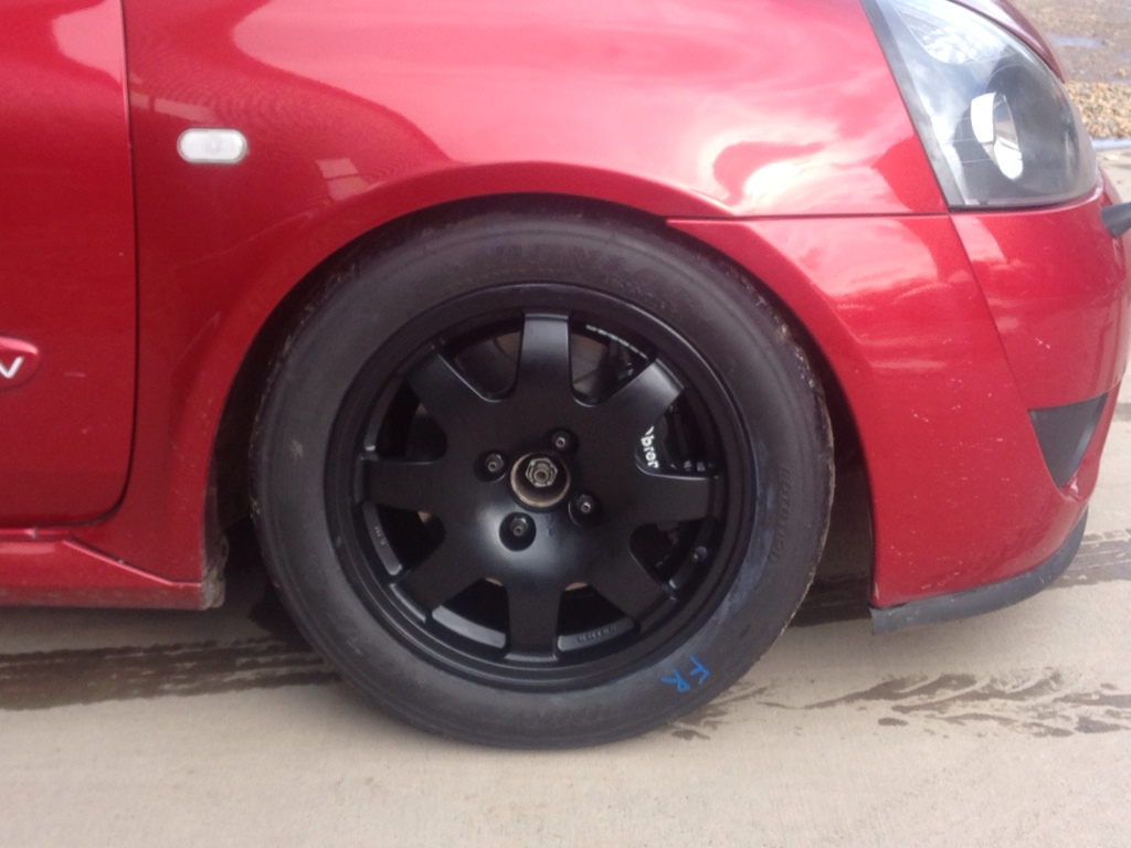

Hi, thanks for the replies.
They it over my oz ultralaggera track wheels with 10mm soacers guess I'll need some td1.2's then.

Is that 15s ultraleggera or 16?
Keith185
ET43 2118 with a 15mm (playing safe) spacer.
Not measured what's the minimum you can run yet with 2118's but in standard Turinis I could in theory run 6mm spacers.
botfch
  Clio 182
Interesting should easily fit mine with 20mm spacers.
Off to find some 2118s I go.
botfch
  Clio 182
Thought I would update this for anyone else.
ET43 2118s fit over 197/225 brembos with no spacer.
However the clearance is about 1mm and I'm not brave enough to run that.
Currently got some 16mm spacers with longer wheel bolts which I'm a little uneasy about tbh.
@Cub. what size are your spacers out of interest/links to the stud kit?
