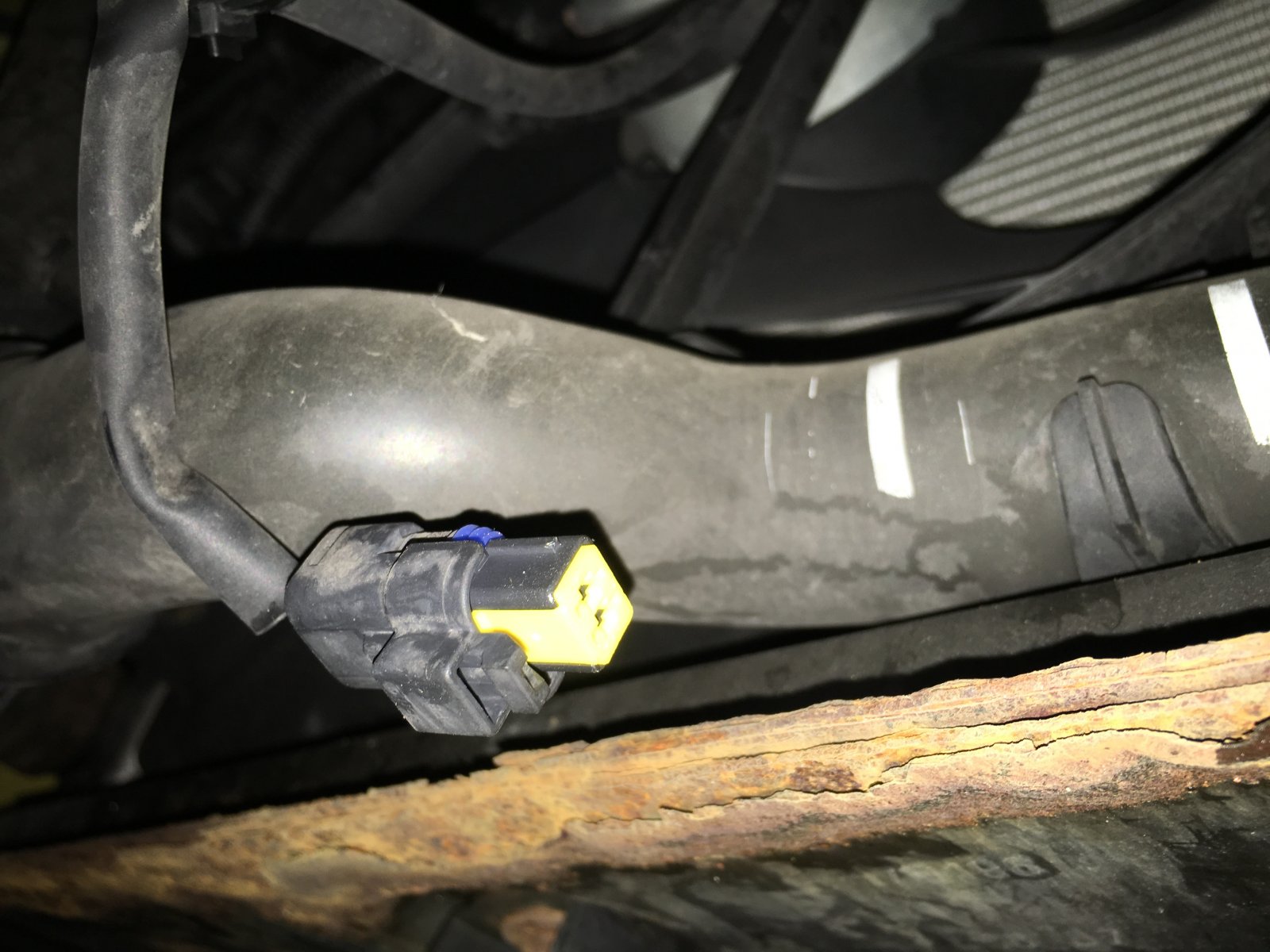

When I popped the undertray off a wire fell on me, weird. It turns out it was the wire that plugs into the crank sensor. Brilliant I thought.
Plugged that back in, turned the ignition on to let the car adjust, tried to start it. Nothing.

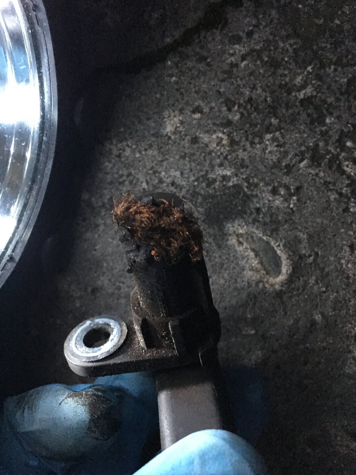

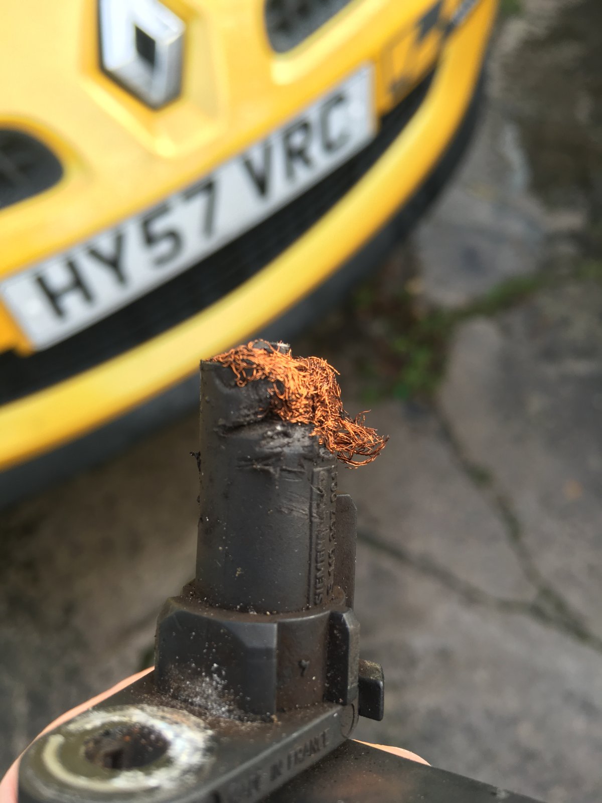

Decided to change the crank sensor for the new one. I removed the old crank sensor and holy hell it was destroyed.
It looks like someone took a hacksaw to it! I'll upload a pic later when my phone turns on.
What could've caused something inside the gearbox to chew through the crank sensor? I heard no crunch, knocks or bangs before or after it went, and still when I try and turn it over it makes no grinding/crunching/untoward noises.
Does anyone have any idea where to go from here?
@JamesBryan I thought you'd like an update lol
The damage could've been caused by anything mate tbh. Bit of debris that made its way in, or signs of a clutch failing.

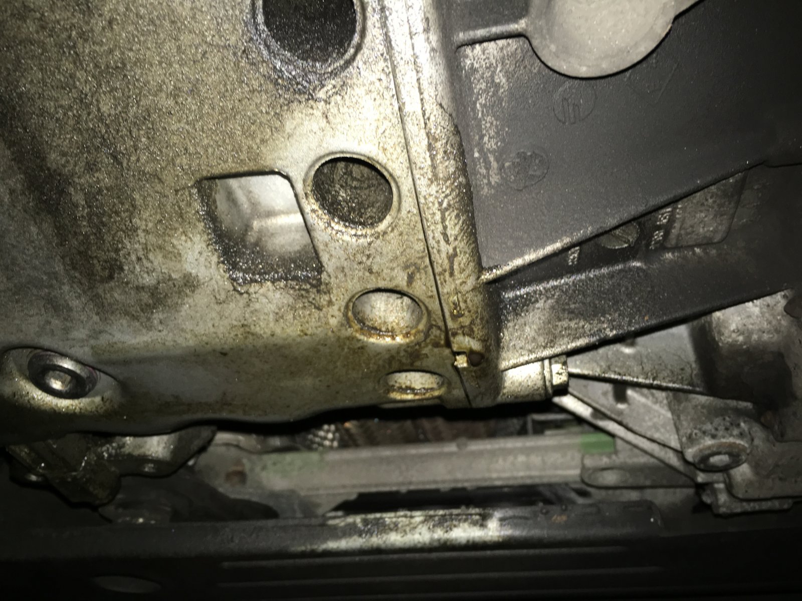

Any idea how this could've popped off on top of the undertray?
Did not expect that
Also, there seemed to be oil on the casing, hopefully it's just the remnants of its last oil change, I couldn't see a leak or anything

Something's had a good go at that, time to open it up unfortunately.

Does the old sensor smell burnt?

That's well fucked! I never saw mine when it got changed. Fingers crossed its just this and nothing more serious.

Well if this any comfort I had the exact same problem,
my sensor had looked like it had been sliced or hit but not quite as bad as yours this was about a year ago no problems since...
