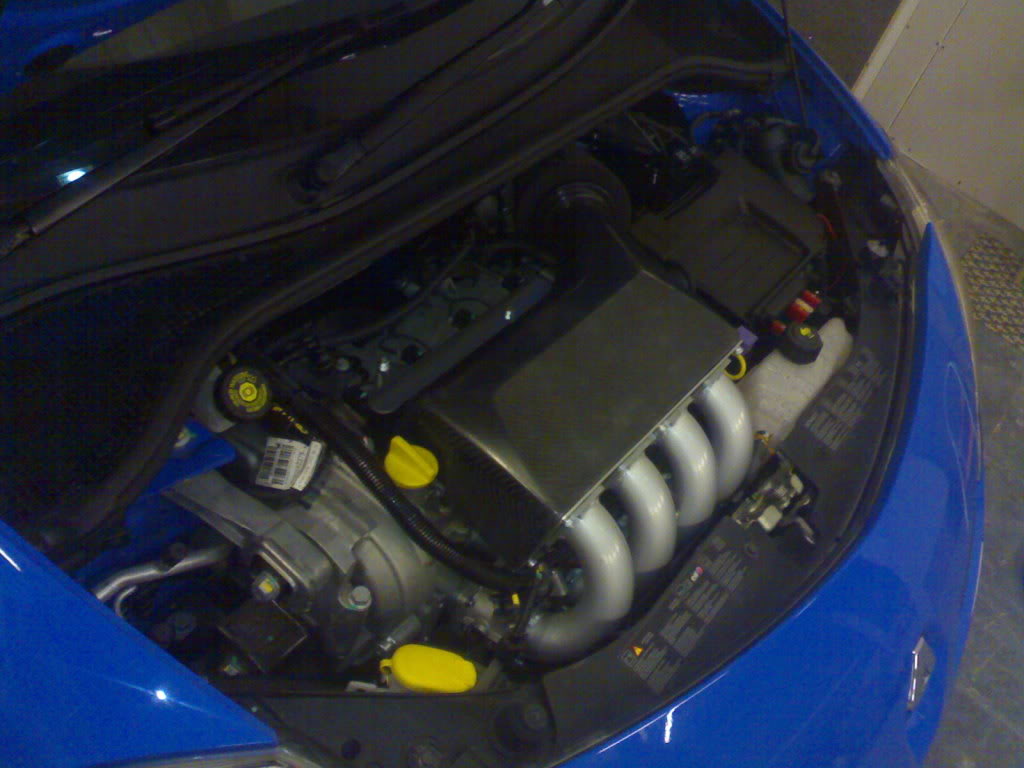

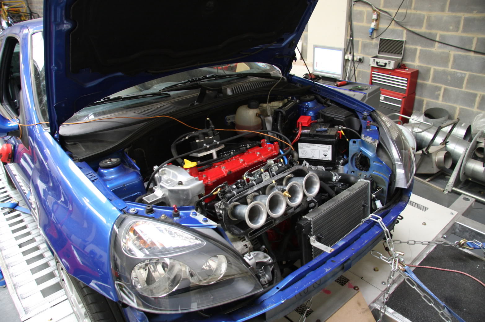

you ever think to read what has been said rather than be destructive? Picture still shows total induction length to be about half what is necessary.
Try it yourself. Oh no wait.....
eh? the car in the picture makes a big chunk of power and hasn't got a long inlet

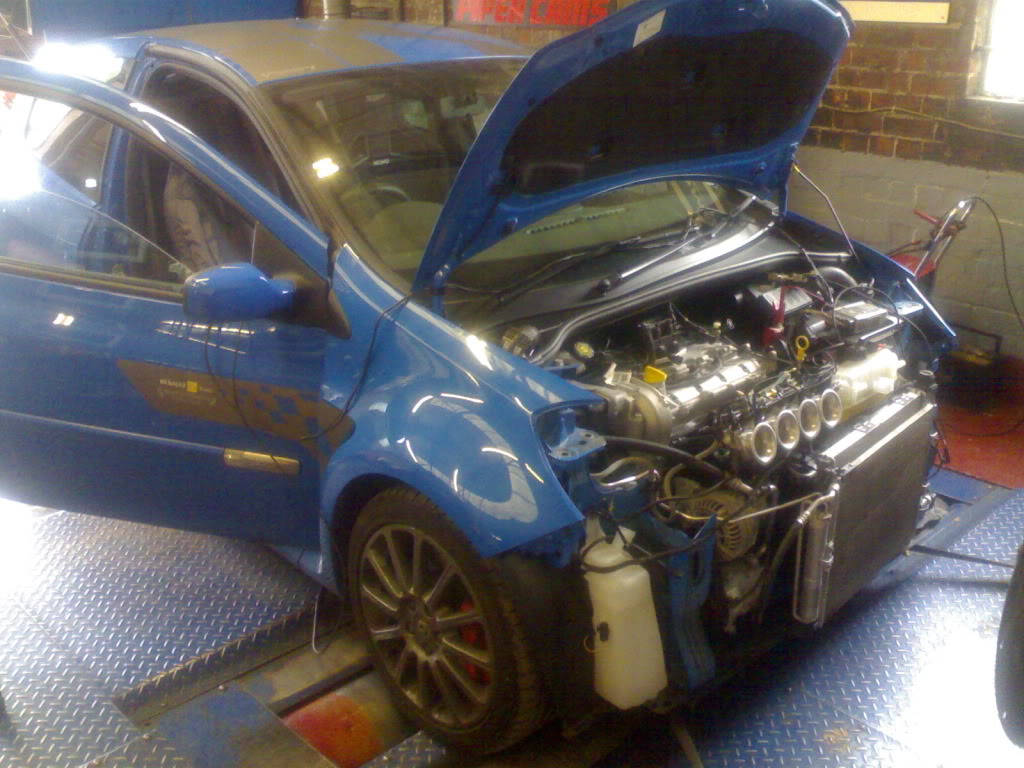

fred, whats the spec of the car in the pics? whose is it? any details?

Nab I don't care for turbos. Na is the only way. Deltav just so I fully understand, what induction length do people get on the 182 engines? Does the 197 setup you developed give more induction length than a 182 setup? Just trying to understand whether even the 182 is a compromise as well. Sorry for all the questions.
  raw striker

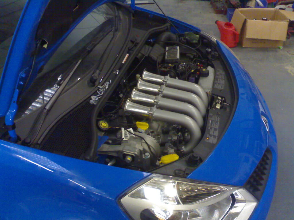

yes of course the 182 is a compromise 99% of the time every car is a compromise due to packaging issues. unfortunately that's the way of the world :( yes the 182 is similar, the best results are with running the longer 120mm air horns such as on gdi's black demo car, but again....to do this you are talking about a different rad and totally removing the front slam panel ect which is fine on a race or track car but 99% of people dont really want to part with the extra cash to do this or plain and simple they just dont like the look of it with no pannel there.
the 197 appears to be a little more sensative to induction length so running out the front just isnt really an option if you want the best results rather than just an expensive way of makig a nice induction noise. even with cutting through the plastic crash structure on the front of the car you will be nowhere near the optimum length plus i certanly woulndt want to be drastcally reducing the strength of that cross member, but thats down to you i guess.
im gussing that even with cutting through that member you would be nowhere over the length in this pic...which was well down on power compared to the up and over design.
but then of course you can go the other way and just go silly long
the thing to remember is just look at the legth of the standard runners on the cast inlet. you think there that long for a reason or not????
our test car was the optimum, and there isnt really anyway that i can see of doing it out the front other than cutting 4 big hole straight through your front bumper that is.

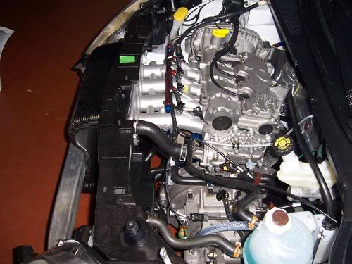

But that looks like nearly a stock set up if you think about it?
  ITB'd MK1
except for where the throttle plates are, ie very close to the valves, which is what gives the big respose inprovement. And the airbox has been designed with internal baffles rather than just being a plenum

the 2 cars i've fitted 120mm trumpets on have had the slam panel removed, and bonnet pins fitted. I also trimmed the plastic part of the grille down flush with the top of the "waffle" section.
this is the only pic i can find, and it's without the bumper and filter
