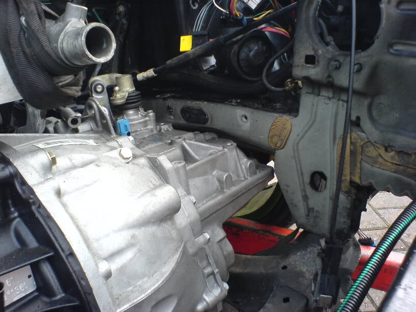

i can sell you all of my old stuff no problem, i have a brand new megane RS gearbox and an F4R turbo engine, you need to find a fabricator/motorsport specialist that can make the gearbox mounts
i paid £750 for a new megane RS gearbox, you can have an F4R turbo engine and the gearbox for £500, just need rid now (no inlet or exhaust manifolds and no turbo)

it just fits

given time and money its deffo possible just a good bit of blood sweat and tears on the way lol i looked into fitting one into my old 1.2!! i just dont have the time to sort out fabricating mounts and making up custom shafts thats before we come to wiring!
