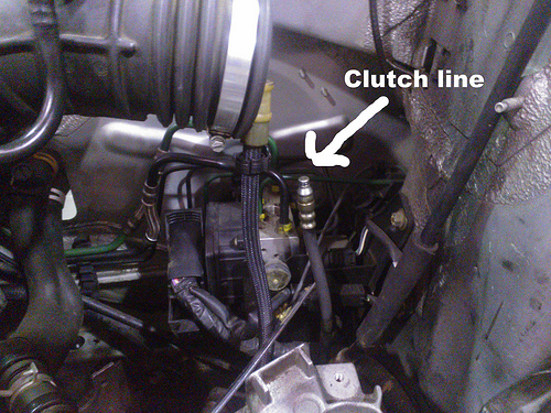

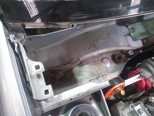

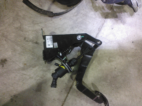

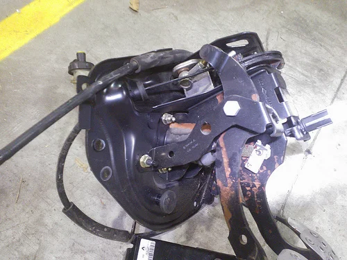

i swapped my master cylinder for a peugeot 406 v6 master cylinder as the fittings are on the other side and had new lines made to help stop my down pipe clashing search for 225 clio build youll see in there but cant help you with the gearbox issues tho
