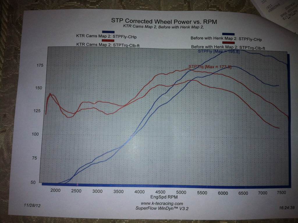

Car  172 Cup & Mini C 1.6
I had my car on the rollers in november when i had my cams fitted and the result was 195.8bhp & 173.8 lbs
Heres the graph

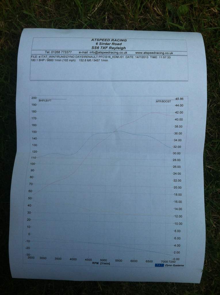

So i went for another run today with a few of the lads which i organised. Bearing in mind it was a very hot day today i ran 180.1bhp & 152.8 lbs.
Heres the graph

Two completely different dynos , i think regardless of who mapped it etc they will read different it's not uncommon to see differences , friend of mine had a saph cosworth and saw 511bhp at one place , and 480bhp at another !
Weather also doesn't help being HOT as hell, obviously cold air is denser , therefore making the bang better ! Minor I know but makes a difference!
Yeah very true. Im not to disheartened with todays dyno. I expected 185 but weather certainly dident help lol
Take it another independent and see what they come out with , can guarantee the weather didn't help mate , don't be dishearten either way it's only a figure mate as long as it drives well :)

I know some dynos have atmospheric correction on them. I.e they will allow for heat producing a lower output and give a higher readout. Same for it being cold, they'll read lower than it has done. So theory then means that it'll have read 180.1 on a cold day.

hot air makes things alot worse also k-tec have huge fans blasting on their rolling road to get more power
The dyno should take into account if there is positive pressure in there and should be correcting the final figure based on both that and ambient temperature.
So in theory at least, hot or cold, high pressure or low pressure, shouldnt matter much as the dyno does its best to take that into account.
(assuming its well operated on the day, if a dyno operator wants your car to have more power it will, end of!)
