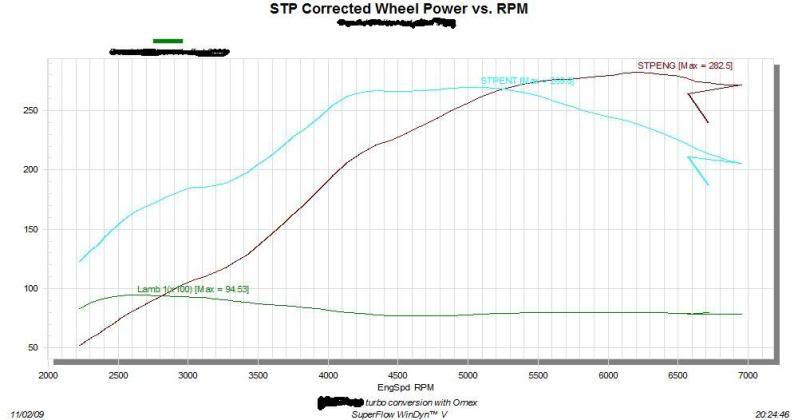

Here's my current RR graph. The boost does drop off a little bit and it does make peak power at about 6.5k rpm. It still pulls well after that though.
Bear in mind that at the moment it's running a similar boost level to the LPT conversions, except because the engine is low comp it's making slightly less power.
Sorry about the huge, poor quality picture. My scanner died.

When the boost drops off the power seems to pack its bags and go with it, to the point where you may as well just swap cogs at 6.5K.
shouldn't get too much power drop off, you'll get some unless you're running a BIG turbo,
making 280 at peak and still about 270 at limiter

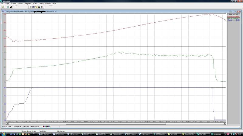

Danny my boost drop off is alot worse than that, what would you deem a reasonable size turbo for 300bhp? comp and turbine wheels and AR's etc..
Sorry mate thats what I meant the power drops off dramatically at 6500.
I have'nt got any graphs scanned into the computer otherwise I could of uploading them to show you.
top is RPM, middle it Boost (controlled by Profec B)
I can't quite see the scale or the boost figures but admittedly it looks a lot smoother than mine (which peaks at 22psi before plunging back to 12psi) interesting photbucket title, who's hpt was it? and whats it putting out?
that turbo will NEVER hold 22psi, turn it down!!!!!!!!!!!!!!!!!!!!!!!!!! no wonder you're getting drop off and power loss 18psi stable is what you should be aiming for, you're pumping in hoter air, not more of it
Obviously with the luxury of a boost controller I've tried it at all settings and regardless of what it peaks to, it drops off to 12psi.
