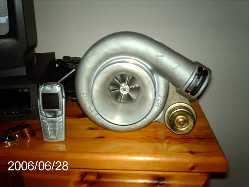

ah right not bad. Still....that's just a ratio, the wheel and housing are small. Take a look at a T3 from a cossie for example, the exhaust housing is a lot less restrictive, but they're quite laggy
I actually had a cossie t3 in my hands last night, bizarly.
The info I got on the turbo was its a GT2560r (GT28R) with a modified T3 .42 comp housing.
Now obviously a stock GT28R should flow 300bhp how ever with the smaller comp housing I'm not so sure.
So do you think a .86 hot side would give better results?
