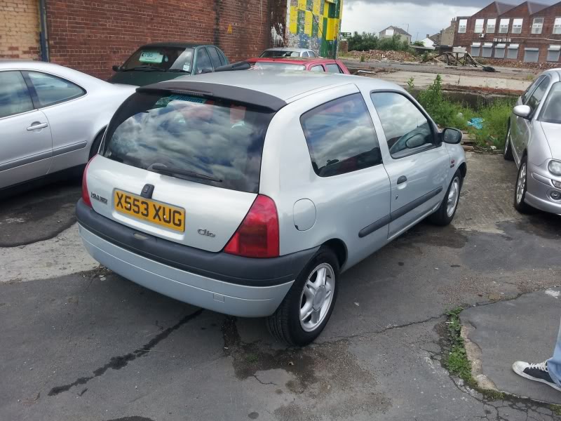

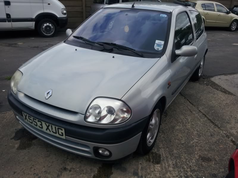

  2001 CLIO 1.9 DIESEL
The car in question. It is a really straight and honest little motor.

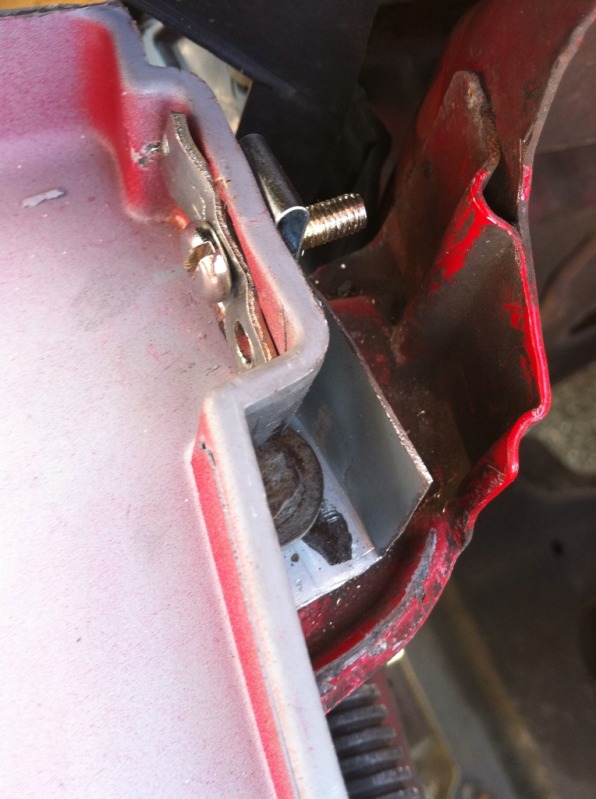

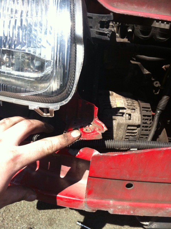

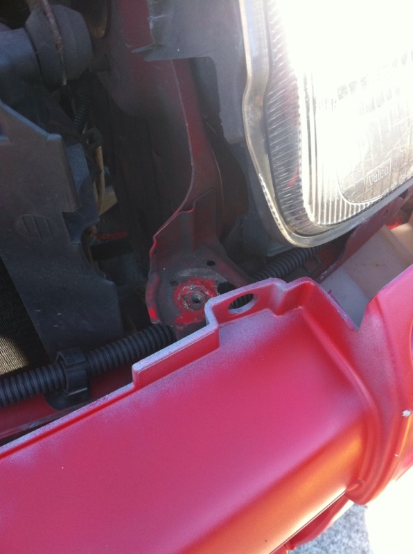

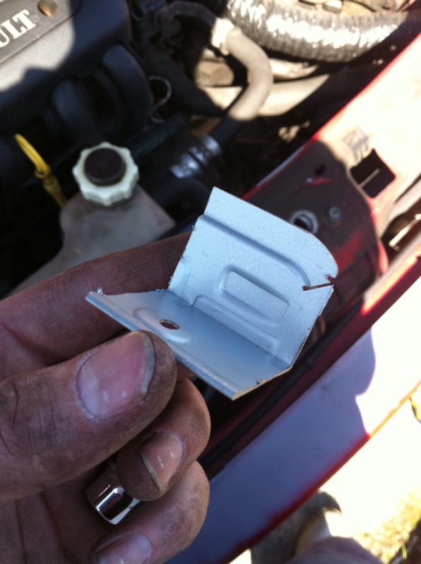

PH1 Sport Bonnets are exactly the same... Here's my PH1 sport rep (only mines 1.1 8v)
Just need a dual exhaust fitted and the side skirts to go on. The only thing that is different is on the front bumper where it fixes in the center under the center vent
Me and my dad made some brackets out of an old hard drive holder:
Rear bumper exactly the same as the standard one and obviously you will need the wings haha
Thats about it
Nick

Tbh, get a 172 sport rear bumper, rear ph2 lights, front ph1 sport lights (dual optics), and get a ph1 sport bumper for the front and job done :)
The car has some king of OE projector head lights already which look quite smart, well after a good wet sand they will.
The lights fitted to your car ARE Dual Optics. Addicted is just a little blind ;)
