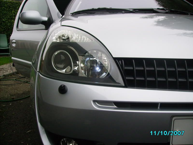

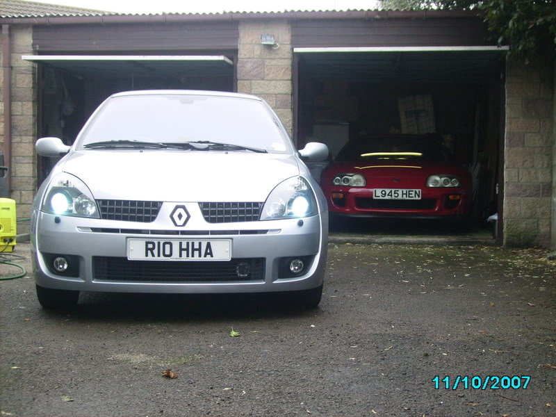

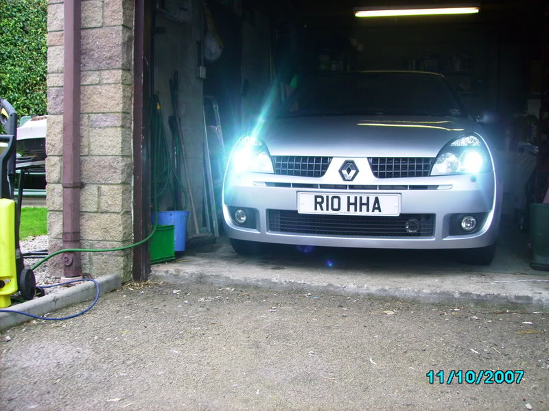

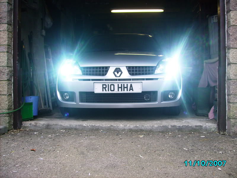

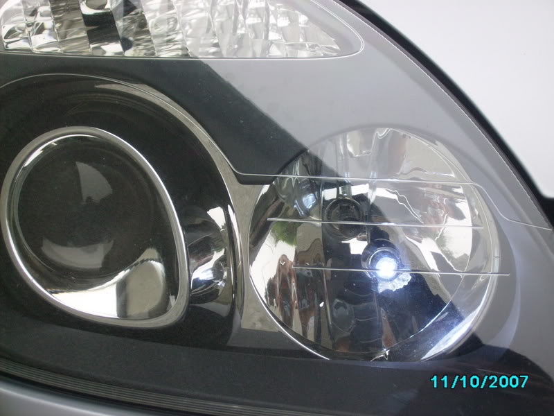

Any way heres a few pics of the 8000k Bulbs in the car (I badly need to get a Cup Splitter i think :().
I dunno if theres much difference over standard Hid Bulbs (I forgot to take photo before i changed them)

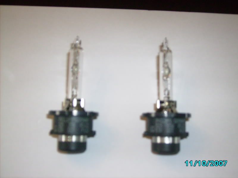

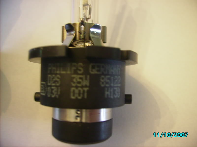

Here are the ones a removed
I also took a few pics of the Blue Led Sidelights i bought as well to try and match the Hid's. :)
They aint very Good and i can't really capture the Light the now as its too light :(
I'll get a few in the dark and post them up ;)
