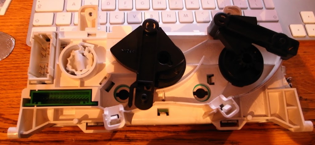

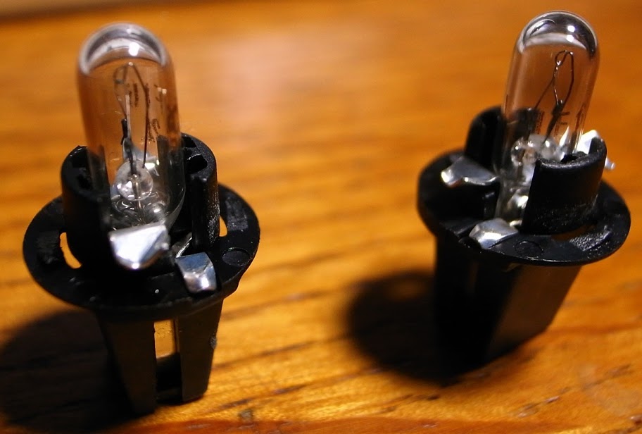

Ok, thats cool. I have taken out the heater control panel and checked both bulbs filaments and they are fine but am not sure what wires to check for, I even looked at the circuit board inside but can't see anything suspicious.
The bulb mounts themselves are strange because you can't actually see where they contact the circuit board- or am i wrong? Do the bulbs separate from the black casing?

Photos of bulbs (only 2?) and the back of the control panel- I did test each bulbs continuity with a multimeter, nothing, yet the filaments look OK, weird
