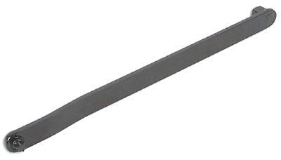

The 6mm Allen Key turns out to be a T50 and the adjuster tool is for a K4M/K4J.
The tool from Renault is MOT 1368
With a 1/2" on the other end it'll make those hard to reach parts easier in the bay.
I was suffering from belt squeal, so I've purchased this tool + new tensioner/pulley hoping this will solve my issue.
