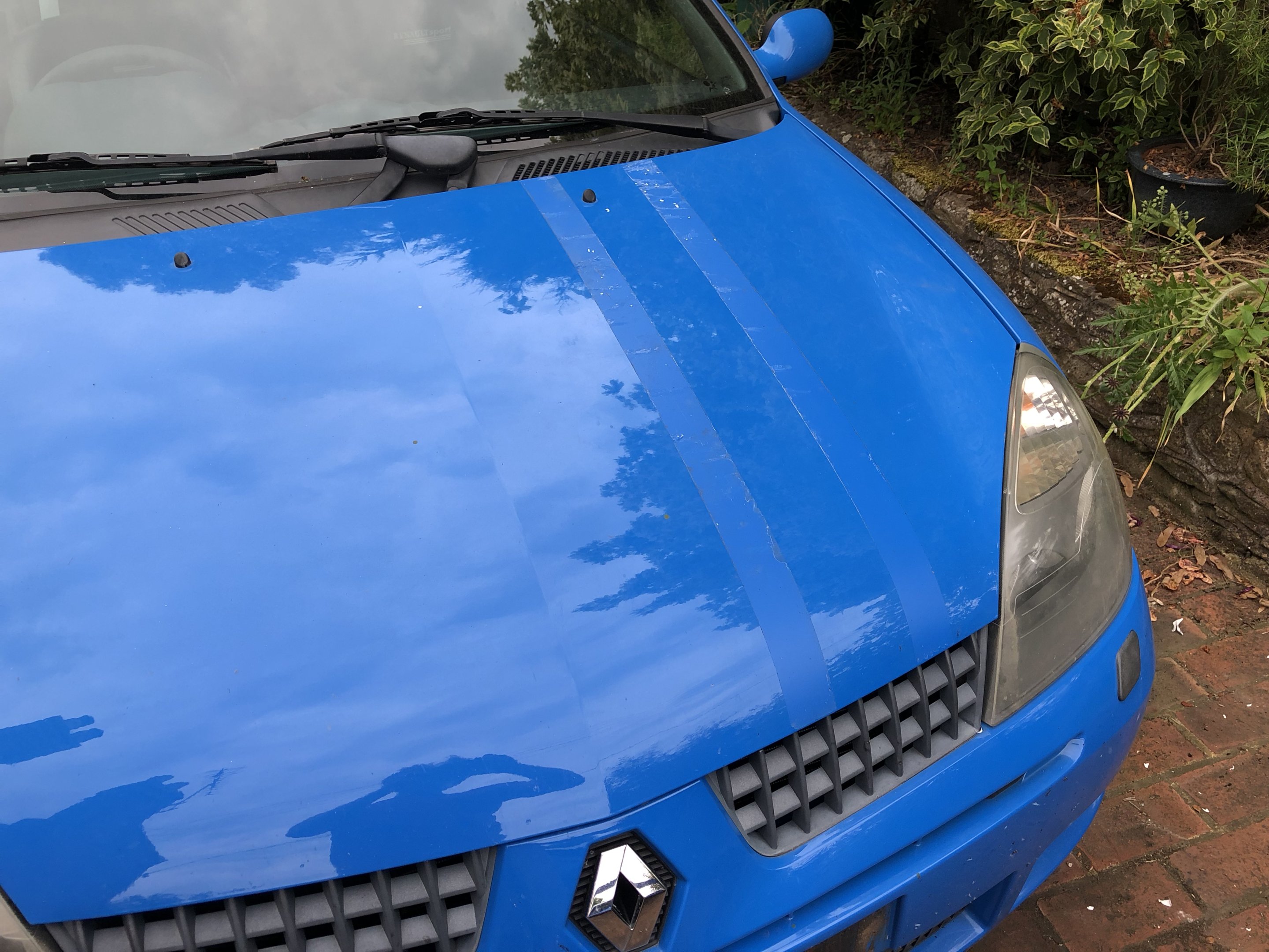

I've got it to use as a daily, but also a project to tweak and refresh and I'm sure it'll slowly become more track focused. It had the Gordini stripes from the factory, but they were very tired and cracked so that was my first job. Took about two hours to get them off the boot and bonnet with the roof still to go, with a hair dryer, old credit card and tar remover. As expected the paint discolouration is fairly obvious but I'm hoping this will detail out, otherwise I'll be putting a fresh set of stripes back on.

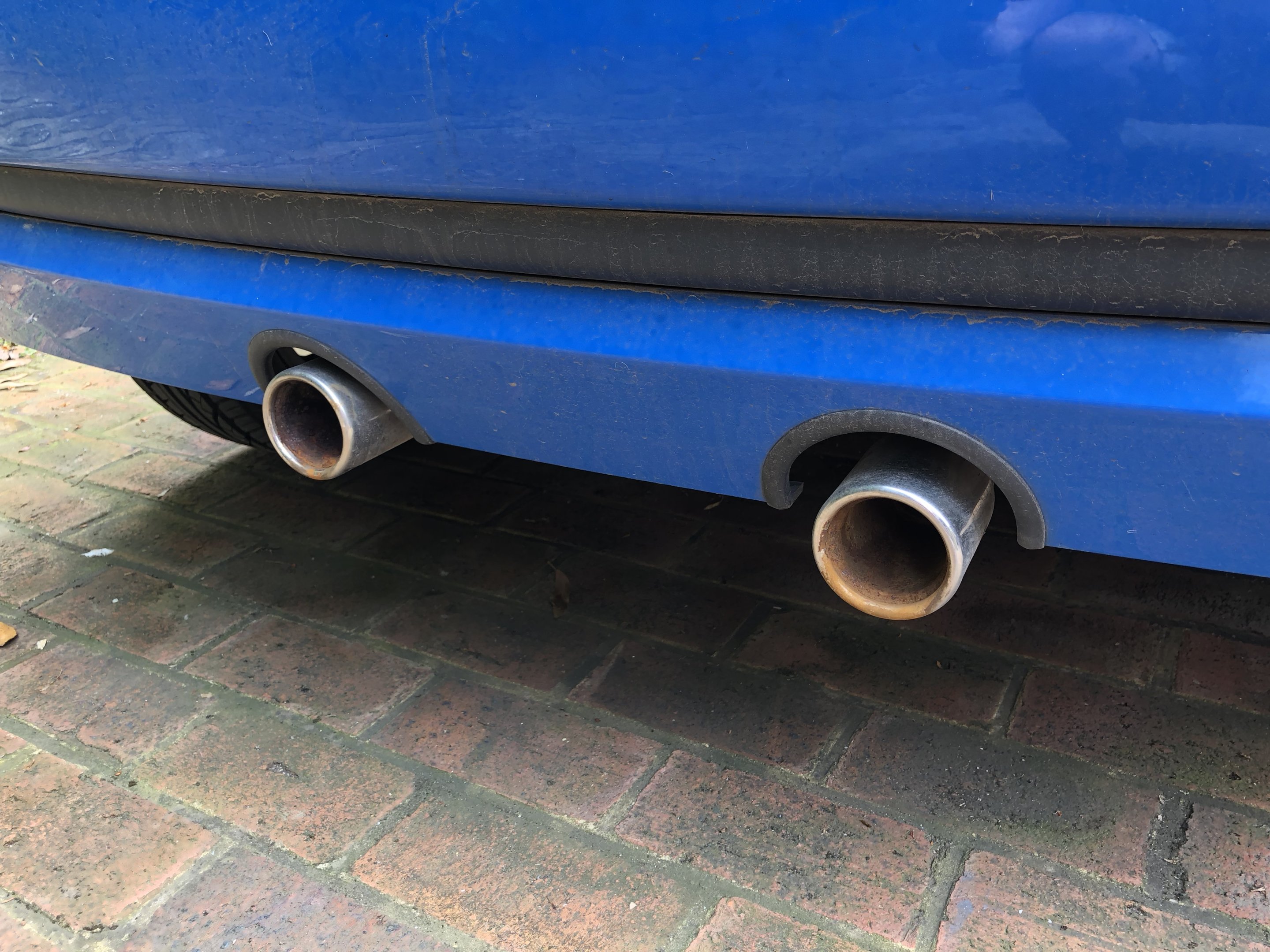

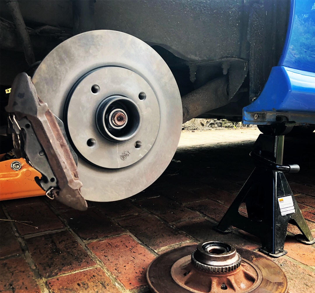

To start I've ordered new rear discs/pads as one of the rear bearings is quite noisy, new OEM suspension dampers, top mounts and Cooksport lowering springs. Amazingly it's still on the original exhaust which has cleaned up fairly well, although it's knackered as the internals have fallen apart and are rattling around like a piggy bank so that needs to go too.
Bit late with that first post (copied over from my Readers' Car thread on PH) so here's a bit more! Few photos from its first clean. I still haven't taken the stripes off the roof yet as they were so much hard work on the bonnet/boot. But after a snow foam, quick wash and spray of quick detailer, it was looking much better.

If anyone has any tips for detailing out the faded marks from the stripes I'd really appreciate it. Absolutely loving having this as a little project to tinker with when I have time, but still works perfectly for my daily too.

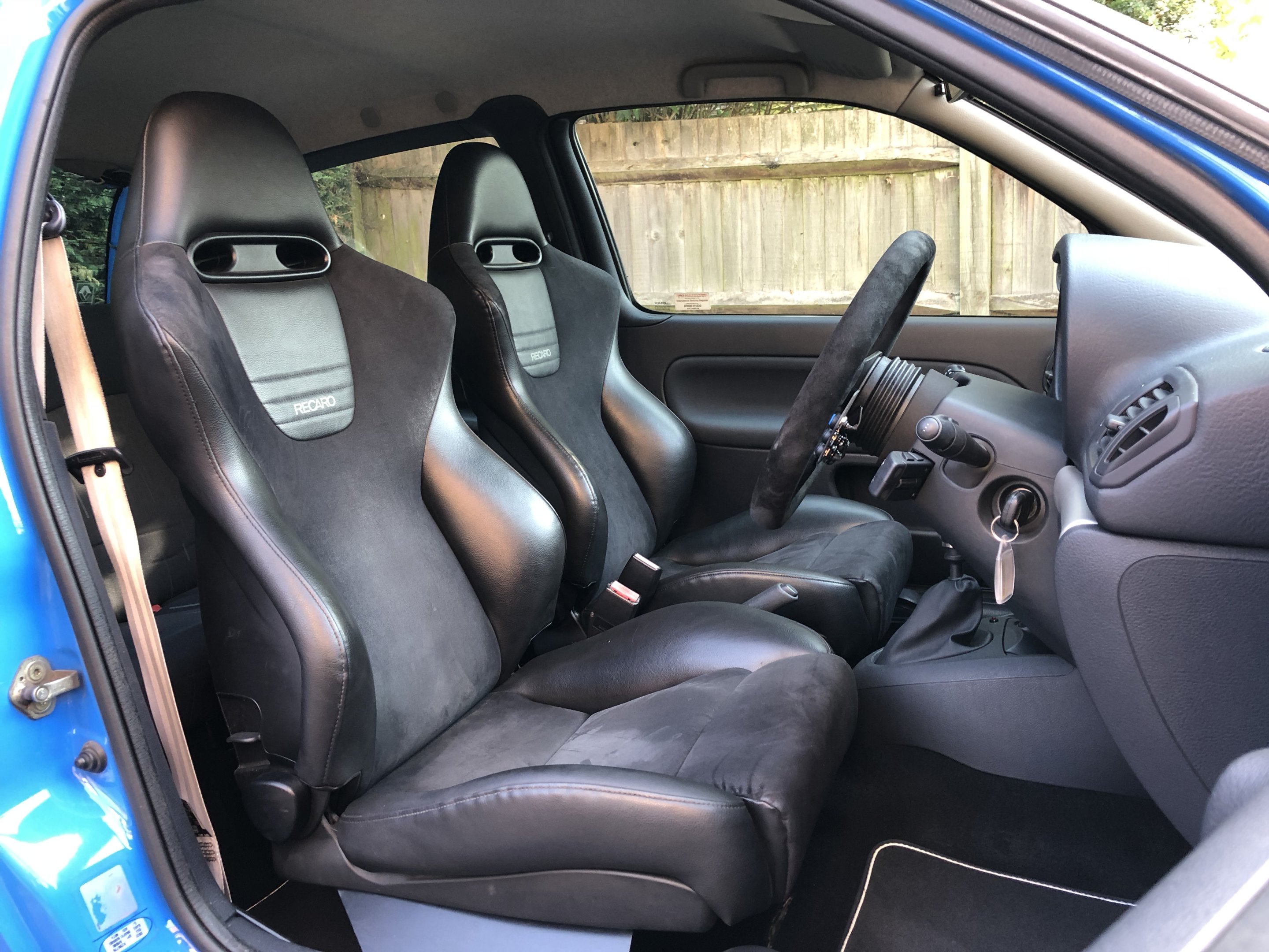

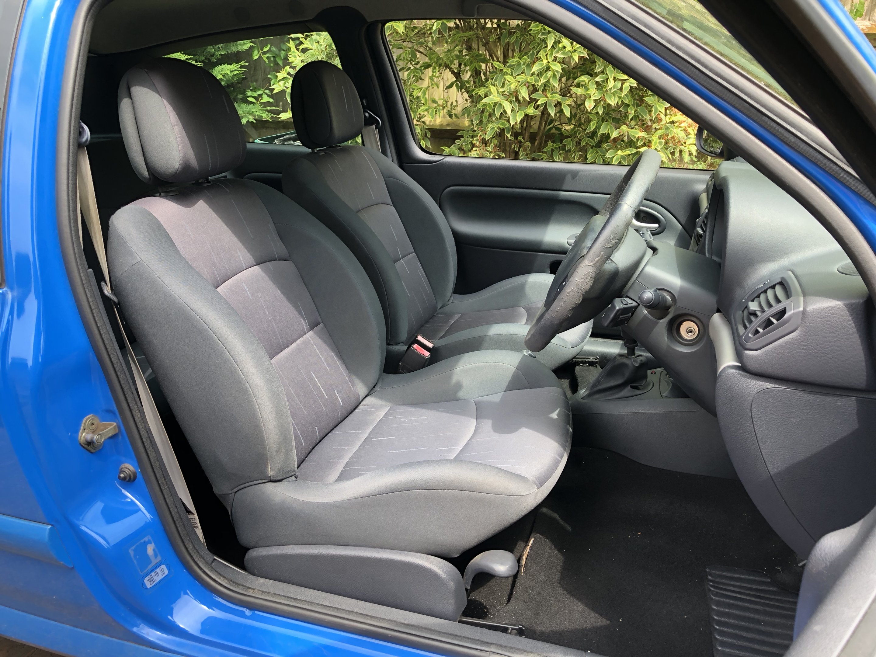

While the Cup seats are probably the comfiest out of the lot, I really wanted a set of Trendlines from when I had my Trophy. Picked up a set with leather/alcantara rears from a lad on here, so those are in now too. Another before and after! Much better, although I forgot how high these sit on standard subframes. New set of Renaultsport mats in too.

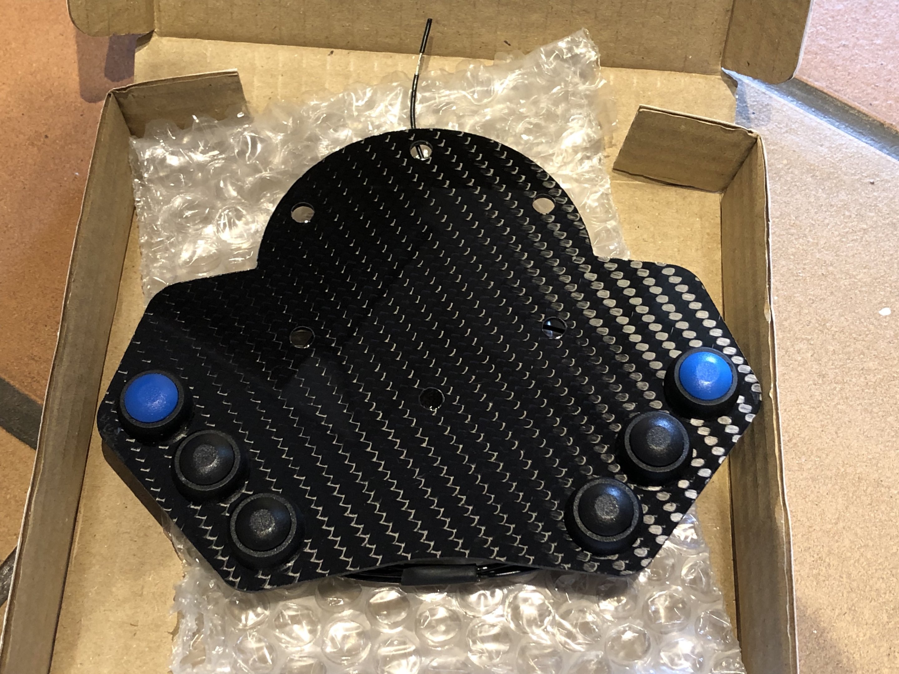

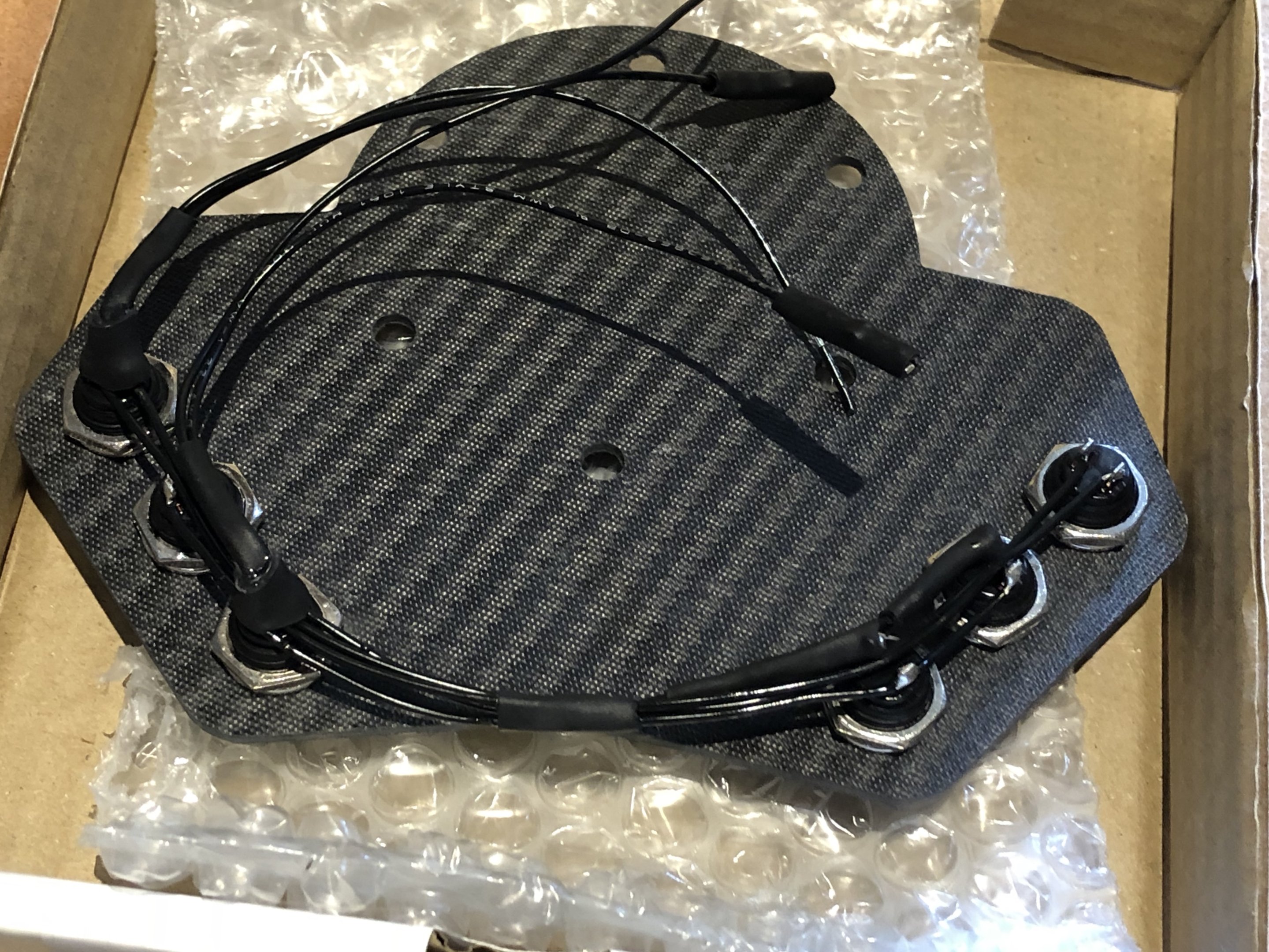

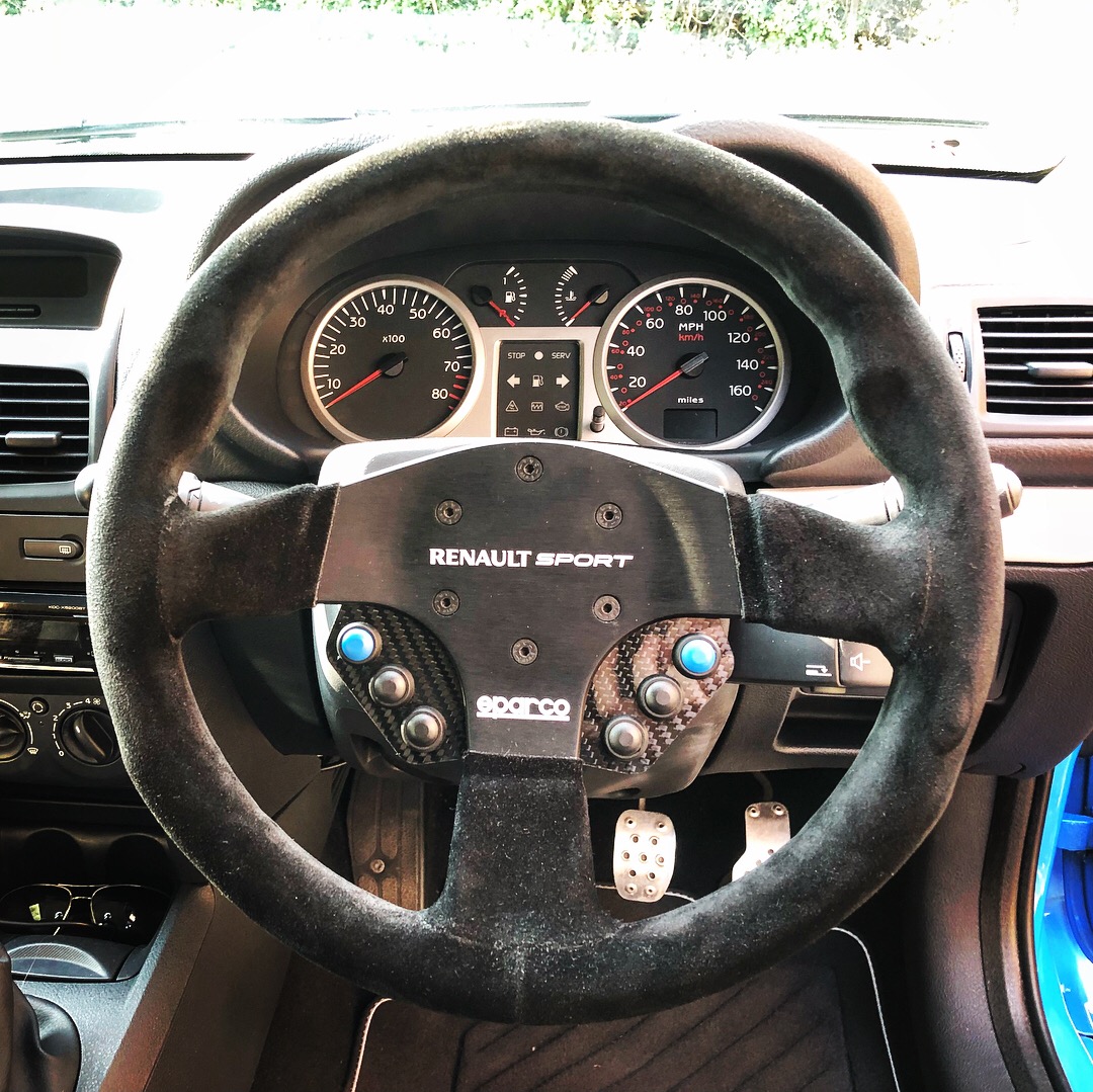

And finally, I snapped up an unused Renaultsport Sparco wheel off another lad on here and got Volantech to make me a carbon fibre cruise control panel. It's a thing of beauty and works like a dream! Blue buttons are for the horn so I could keep the standard stalk. I was going to attempt to make one myself, but for £60 it was a no brainer. Frustratingly bought an OMP boss to start with but the aperture is too small for the cruise control connector to fit through, so I had to send that back and replace it with a Momo boss instead.

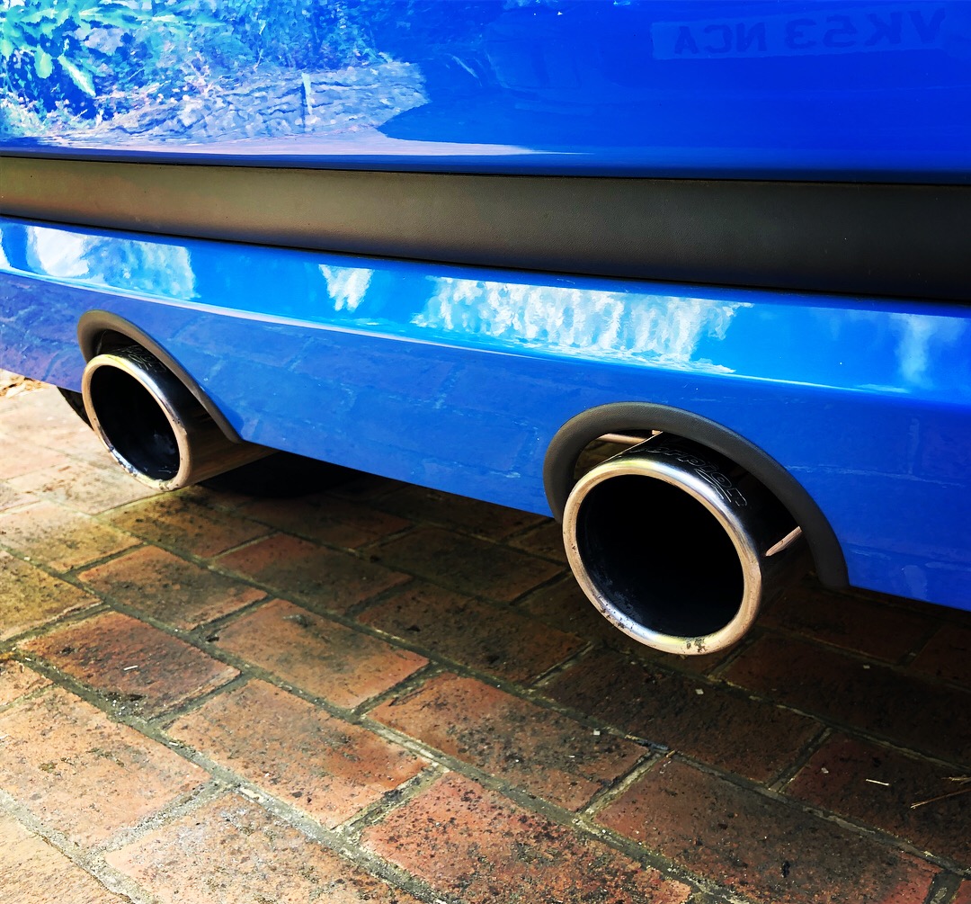

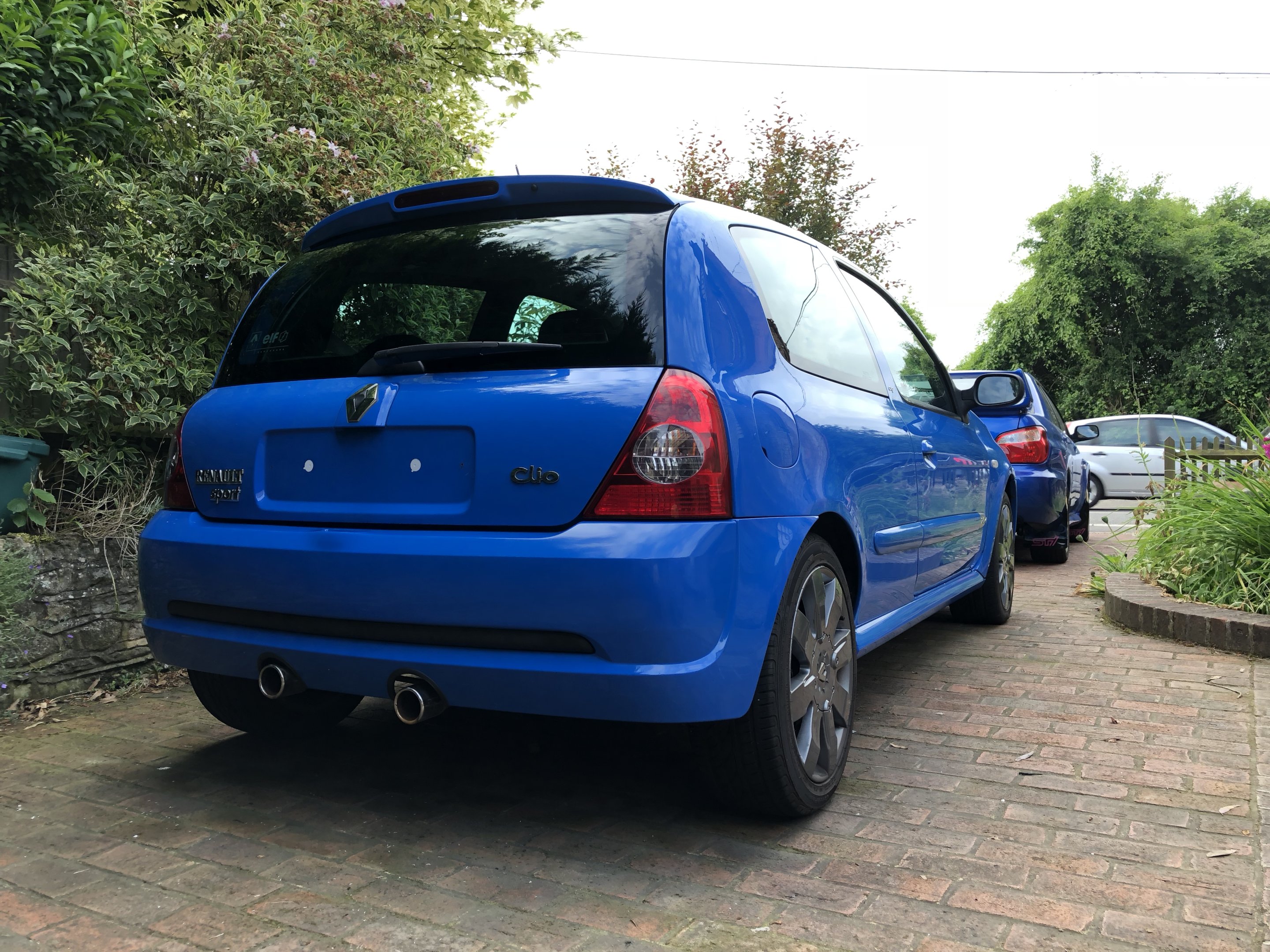

That can't be a scorpion exhaust, it's sat nearly perfect in the bumper! Rest is the car should come up great if that's the level of attention it's getting[emoji23][emoji106].
Haha thanks. The hangers are knackered so I got it near perfect with cable ties, but I've now got Powerflex mounts to go in so hopefully it'll still look good (and stop rattling!) once that's done.

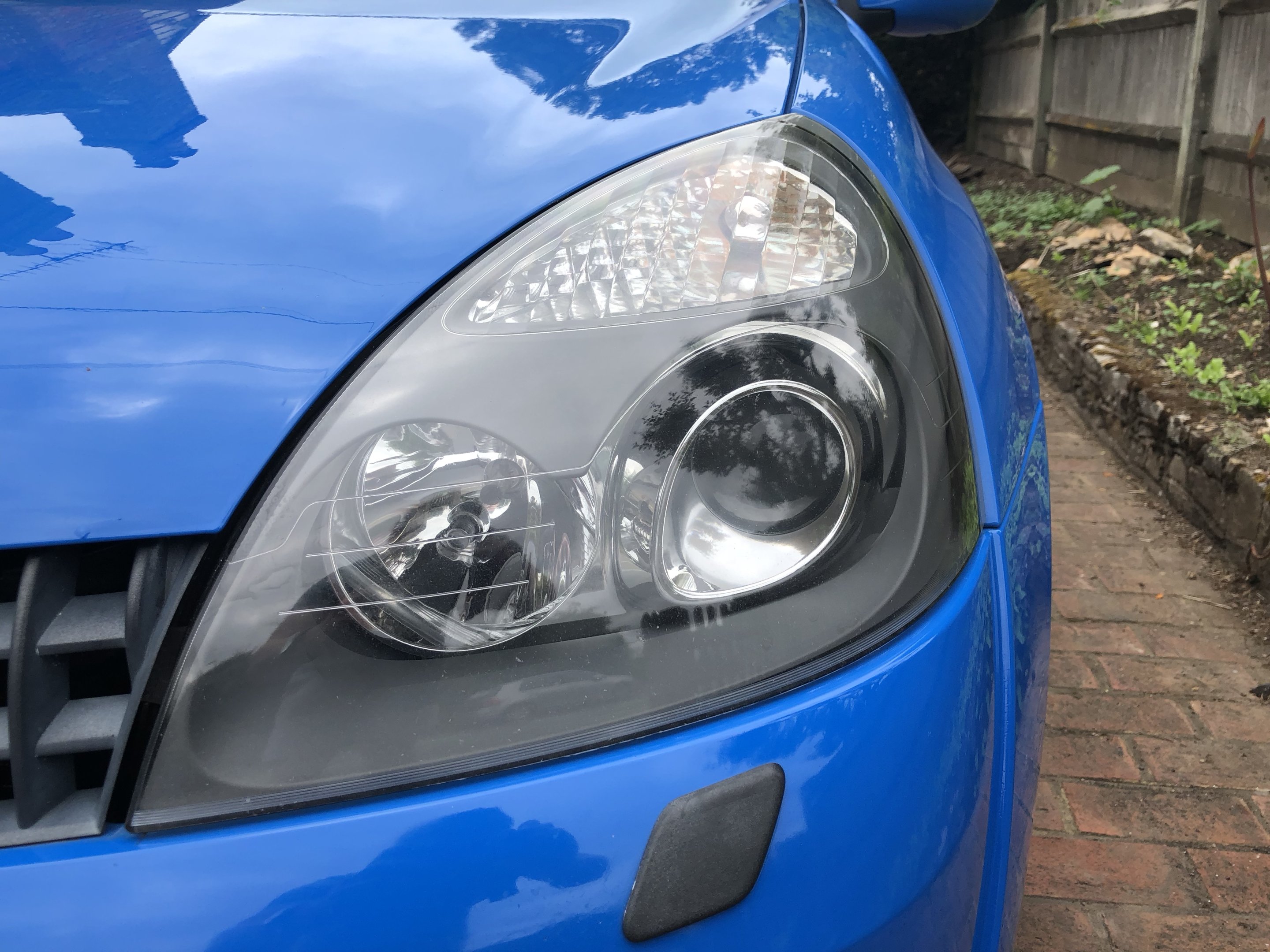

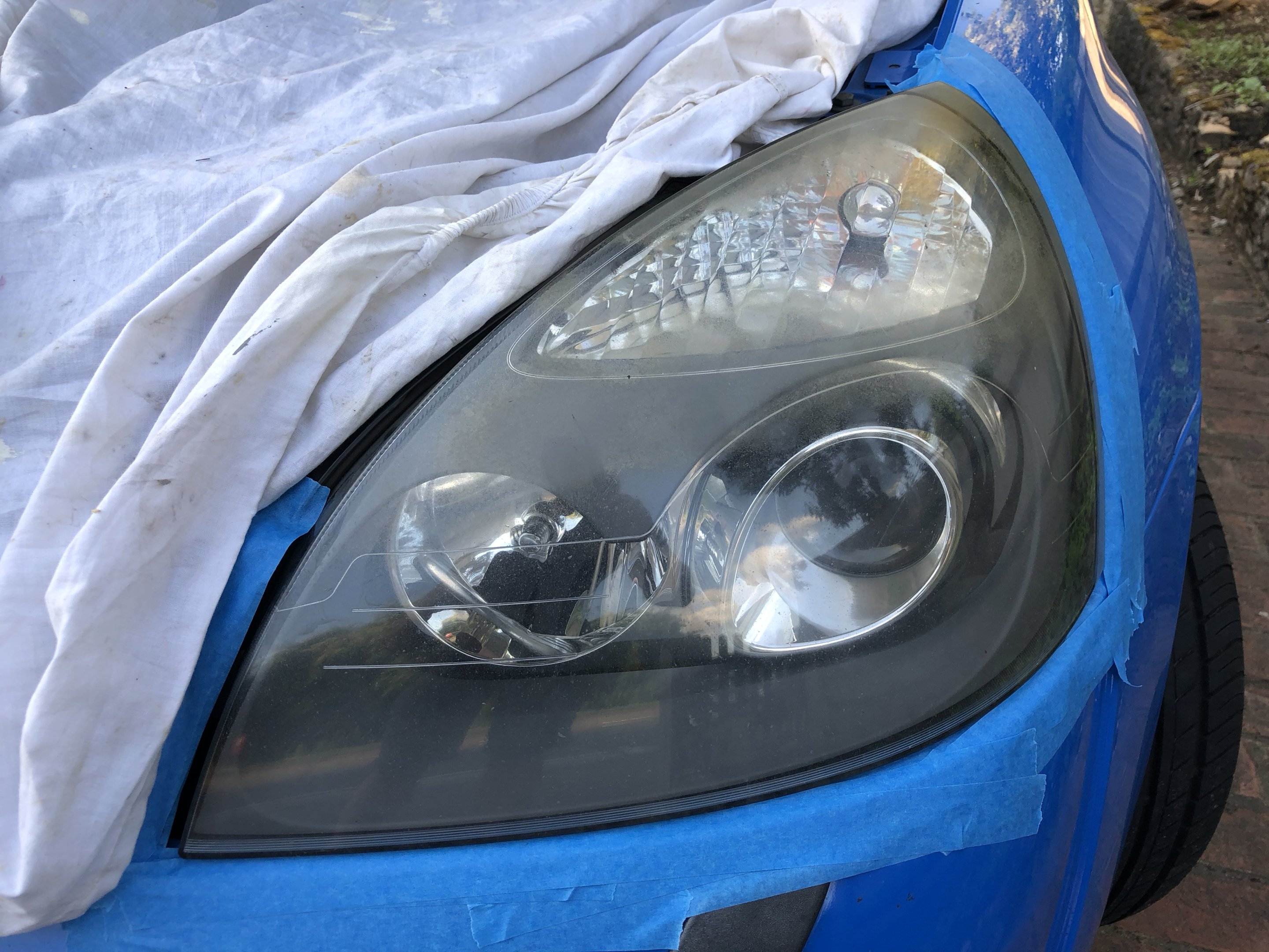

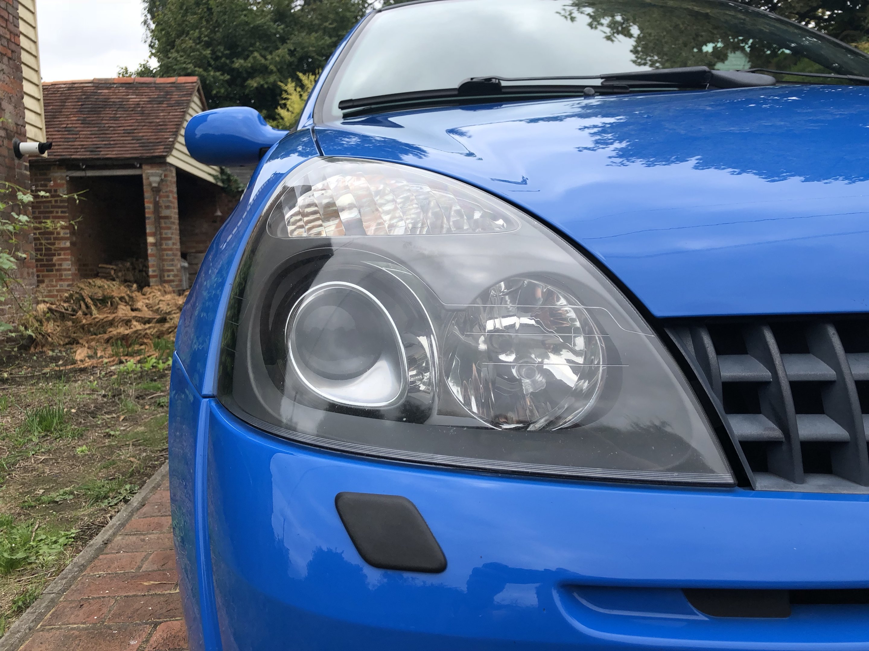

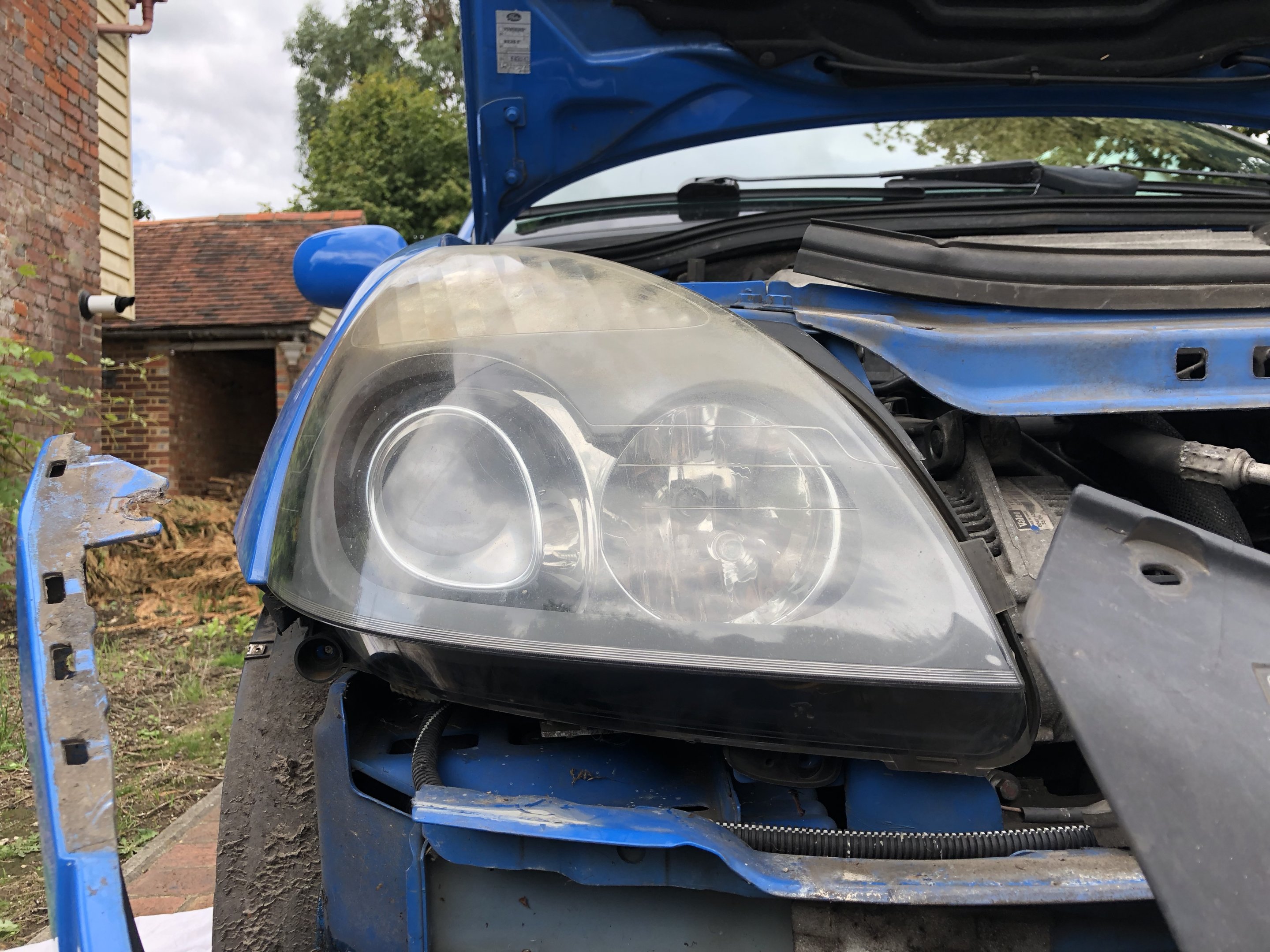

I picked up a broken set of Xenons off @H2MRK and fixed them for a fiver with the BMW adjusters. Another handy thread on here! Cleaned them up with the Autoglym headlight restorer kit – not perfect but pretty decent for a cordless drill job.

Xenons on a Cup! Sacrilege! ?
Normally I'd stick with the halogens, but as this is my daily and 'winter is coming', I'd rather not have to put up with candlelight when I'm driving in the dark! Plus I think with the new MOT regs you don't need headlight washers on anything pre-2008.

you cannot machine polish out faded lines & the lines arent faded - its the bonnet thats faded - needs painting..
