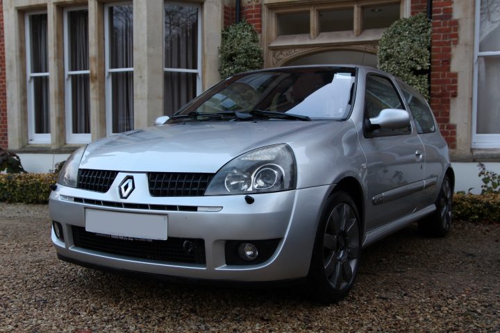

I've been after a 2nd car to run along side my Z4M for months, years probably. I've viewed a few over the last few months and none of them stood out. This one came up at a reasonable distance, price, mileage etc, so went for a viewing. An hour or so a deal was done and I am to collect in a few days time. Car to be serviced and MOT'd before collection, and I'm looking at local specialists to do the cambelt, dephaser & water pump.
The main point of this vehicle is to keep miles off the Z4, but I may as well throw it around a circuit every so often! The mileage on the Z is creeping up to 70k and I'd like to save it for more special drives, not to mention saving money on consumables! Z4M front disc (singular) £225, 182 £23. Z4M read tyre £210, 182 £50. You see what I'm getting at...
Anyway, once the car is collected and the cambelt service is done, I expect to get it on track ASAP for a bit of a shakedown and my first track run. As I'll be using this for generally pottering about and leaving at train stations etc, I don't want to throw money modding it, but that may all change when I get out on the track. Saying that, the first mod has been purchased already, a PH smiley sticker!

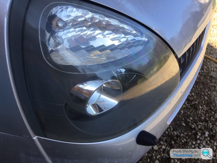

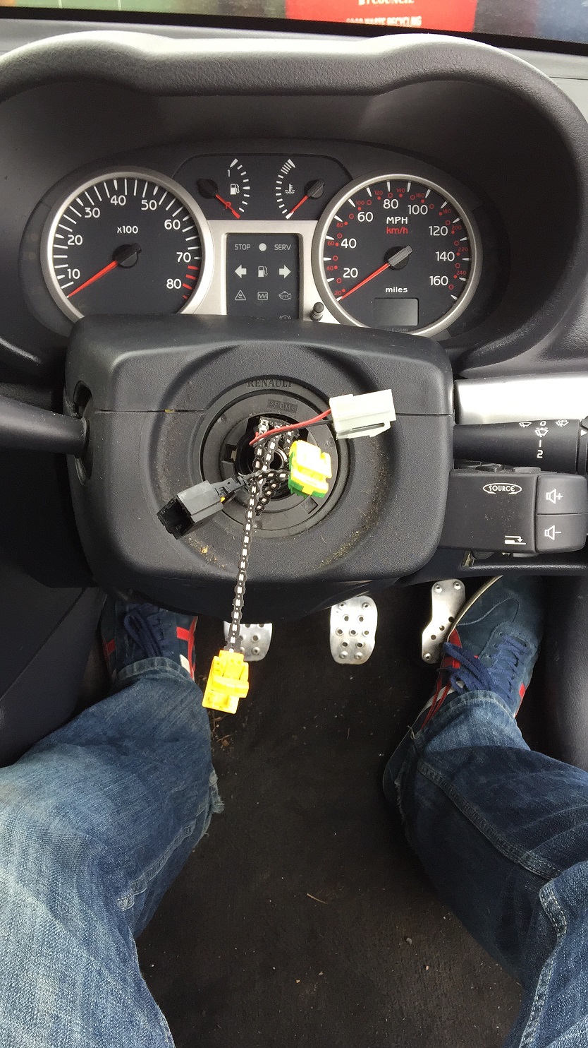

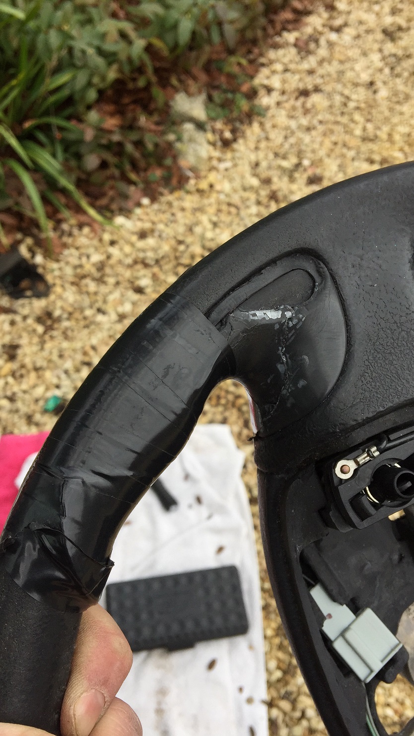

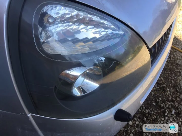

As with most of these, the steering wheel is worn out (and has a horrible cover on it), and the lights need a light sanding as they are cloudy. First items on the list. Anyway, some photos, and I'll be updating this thread with how it all goes. Lets hope I keep it on the black stuff!

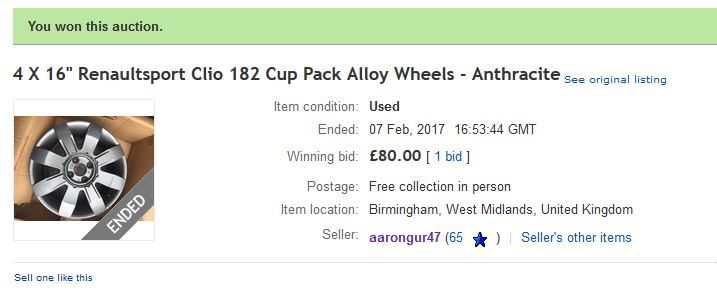

Wheels picked up, looks really good and 4 good centre caps. Apparently worth a good amount, so might make some money back on the wheels.

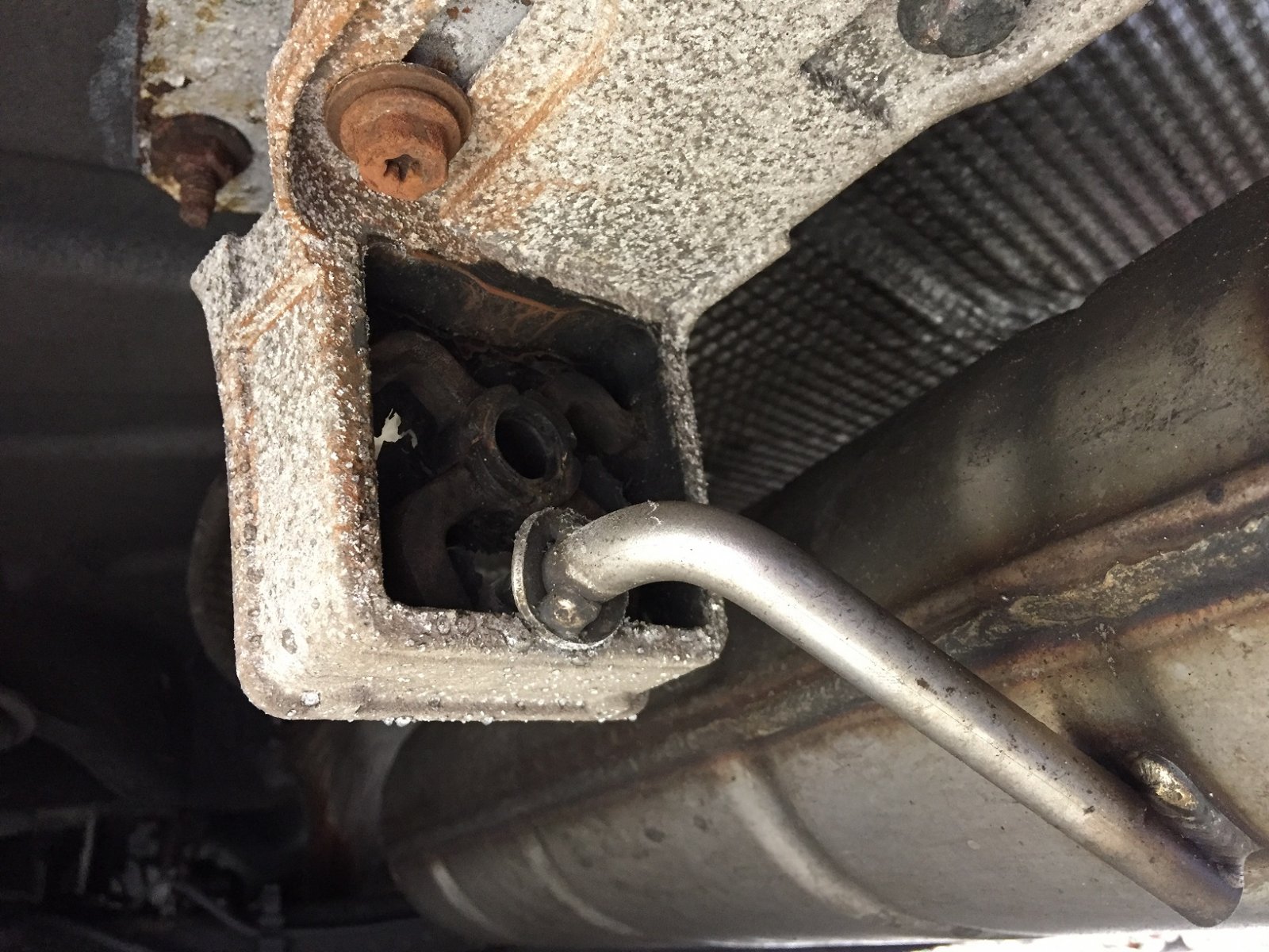

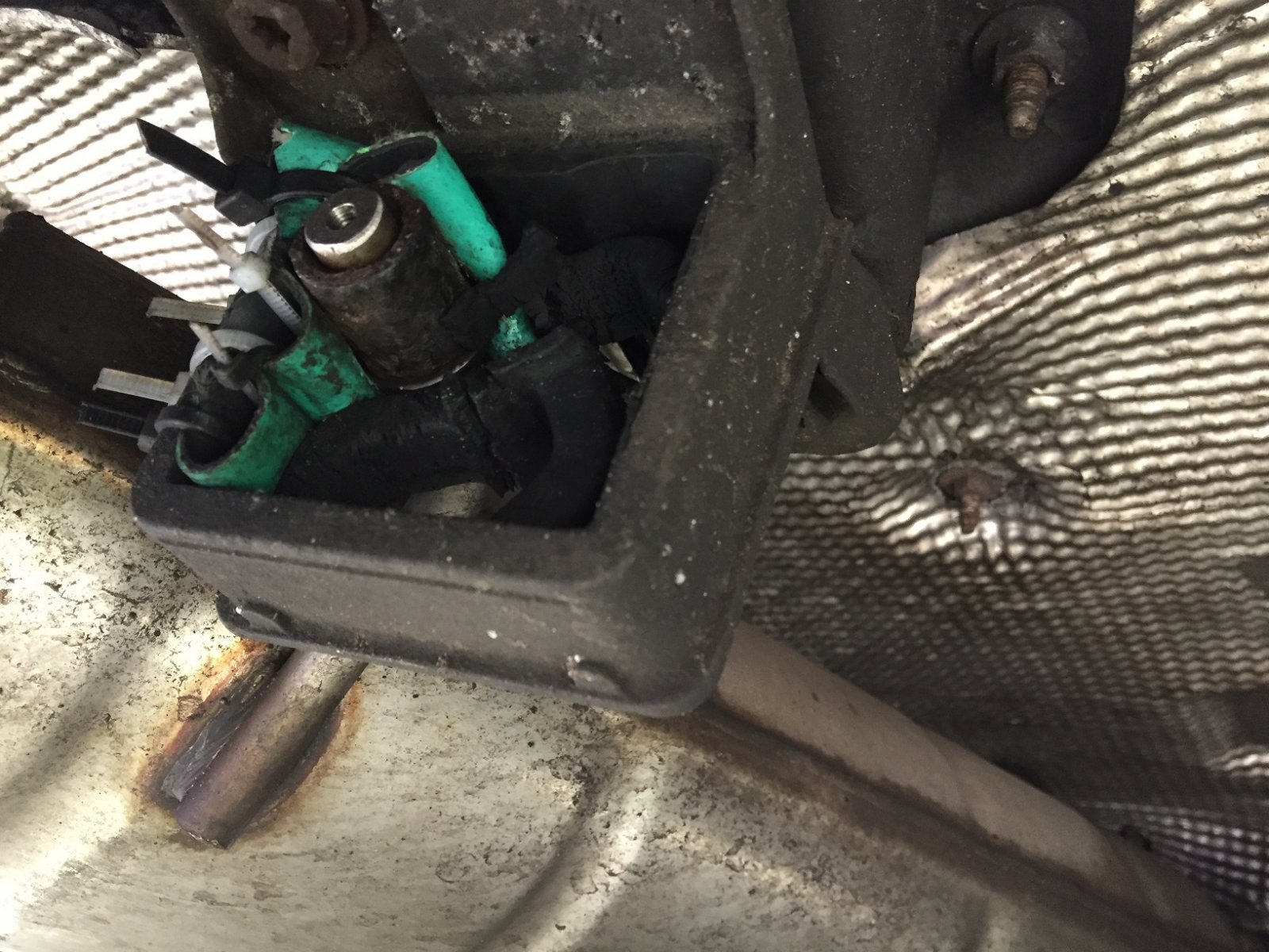

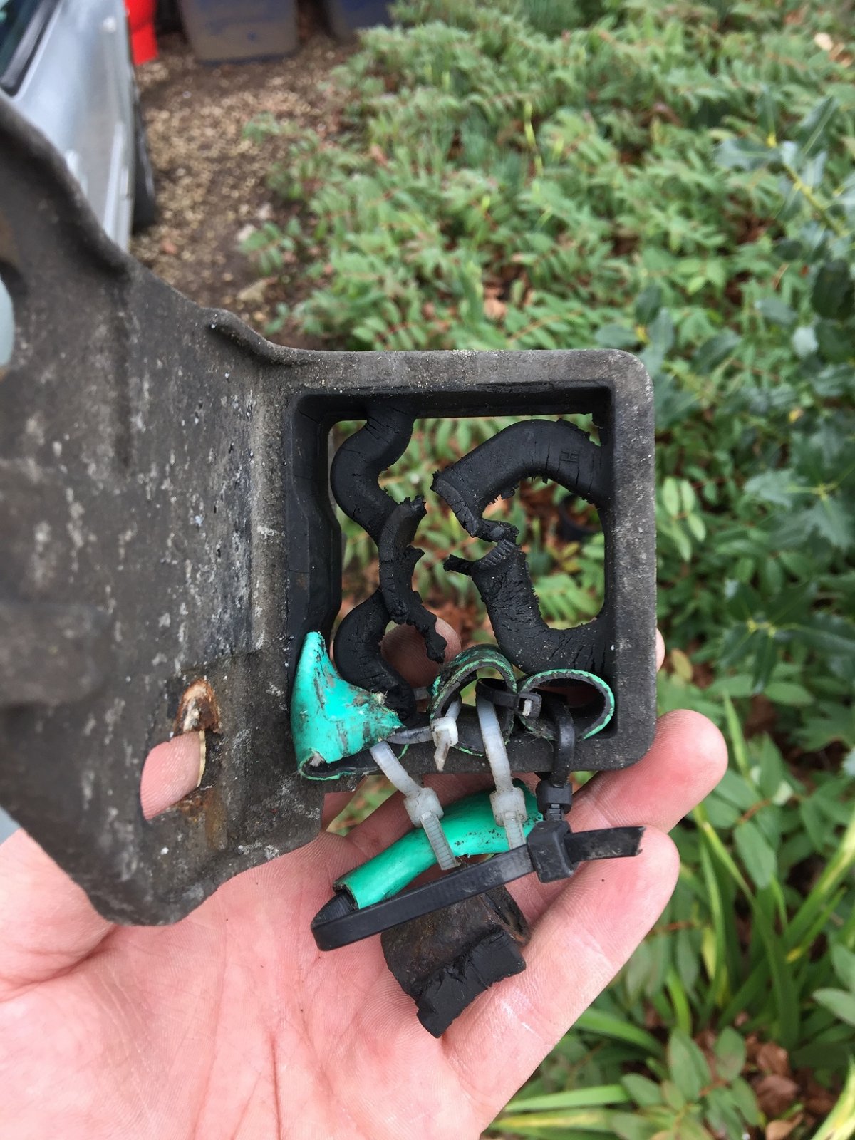

I've also ordered a replacement exhaust bracket, stubby aerial and new thumb grips. If I stop driving it long enough, I'll get them fitted!
Spent a bit of time today with the new parts. Some of the old stuff is shocking.

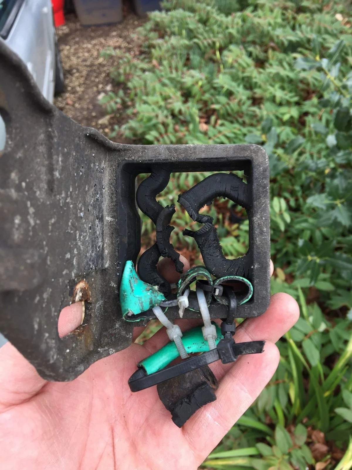

1 of the exhaust brackets was fine, just needed reseating, the other was a mess! One of the thumb grips was perfect under the tape too. The new ones are cheap rubbish, but it's so much better with this already.

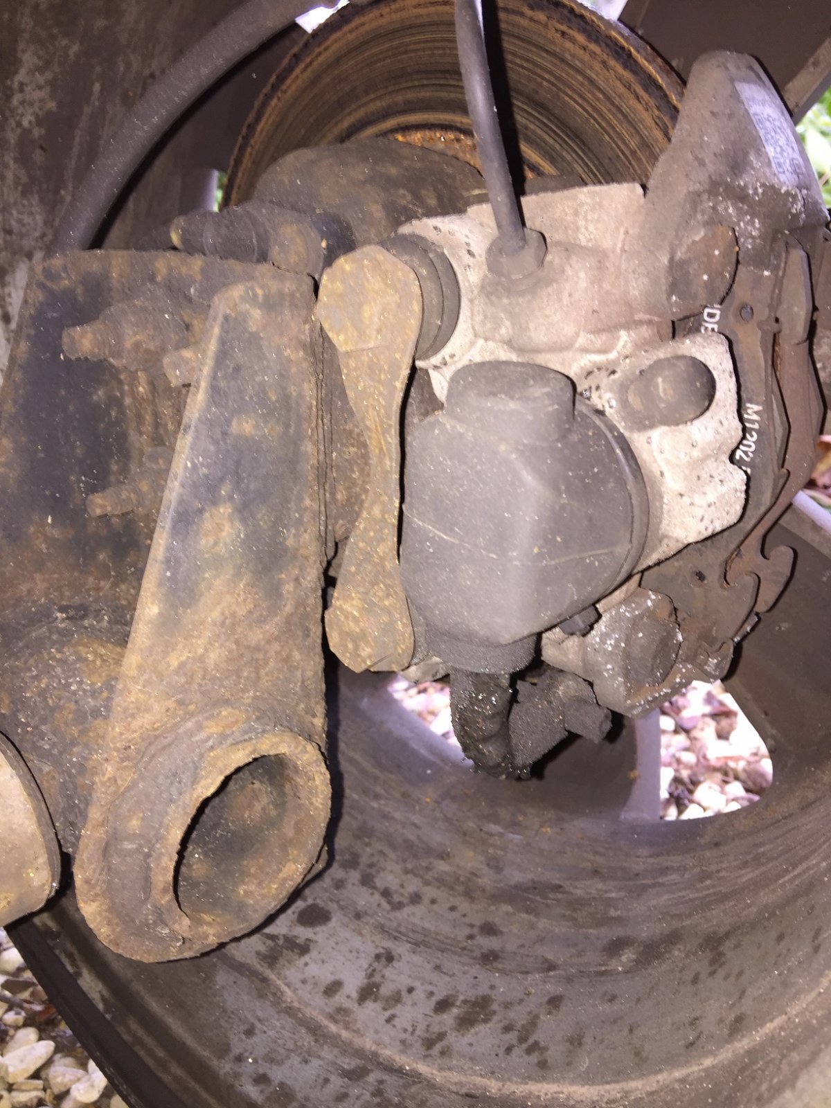

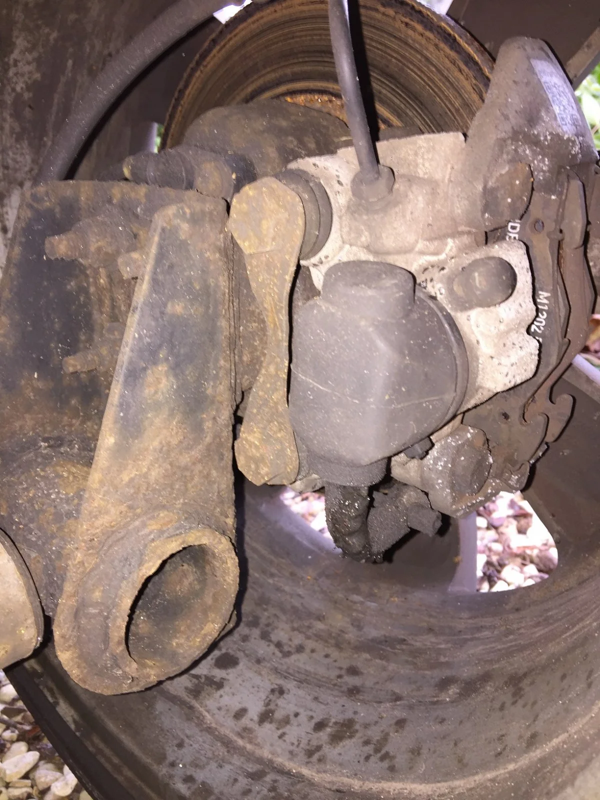

Turns out there is also a leak from the handbrake(?) on the offside rear...

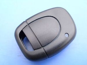

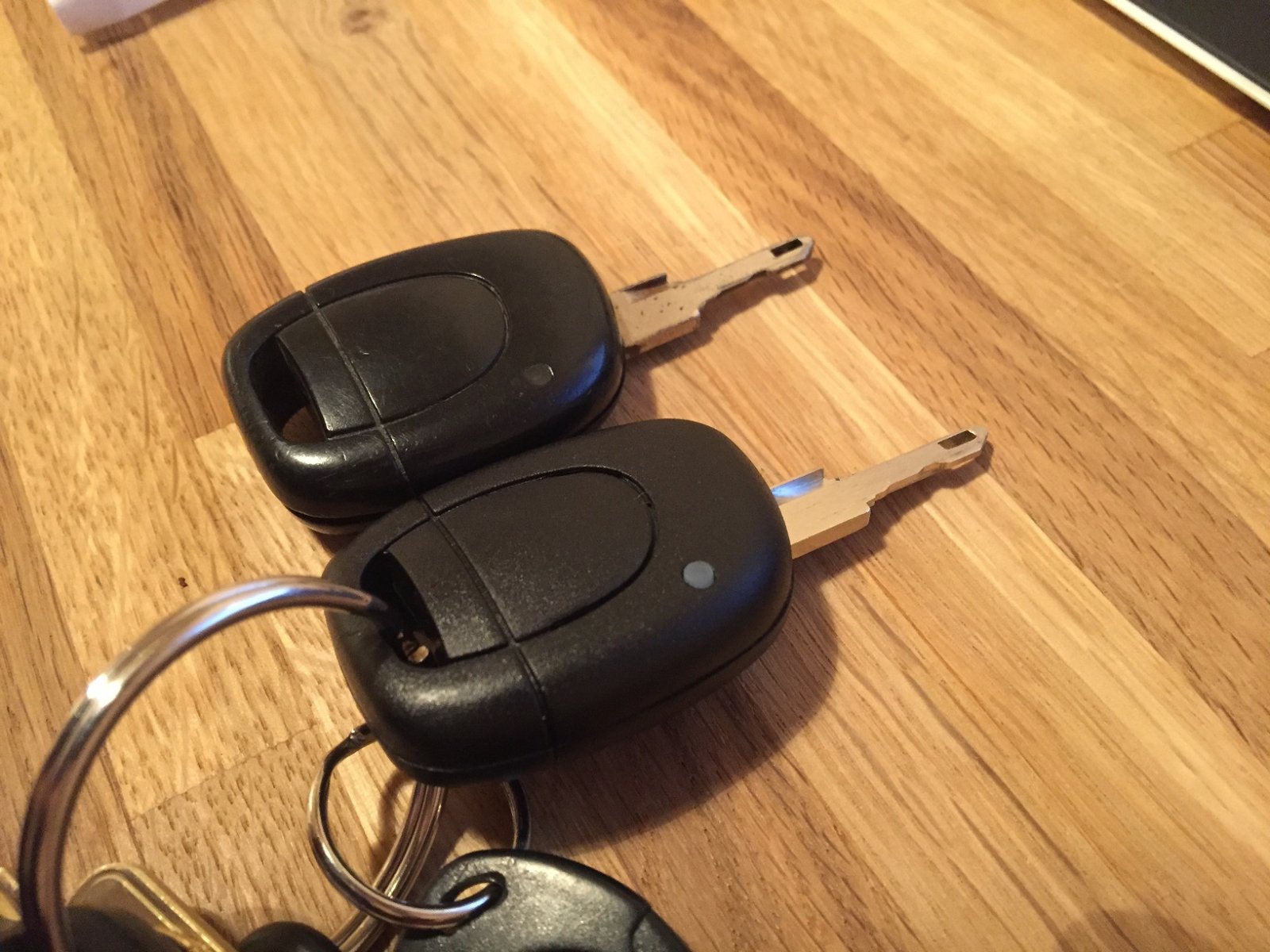

Car won't start now, probably just a drain on the battery. Or just an old one. Need to do some checking tonight.
Connectors clean and fog light flashing has gone!
Battery issue was actually an immobiliser issue, I swapped the key housing over and must have done something. The light wasn't staying on though, so didn't think that was the problem. Anyway, held the unlock button with the key in the ignition for 10 seconds, locked, unlocked and it worked.

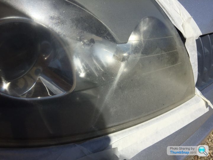

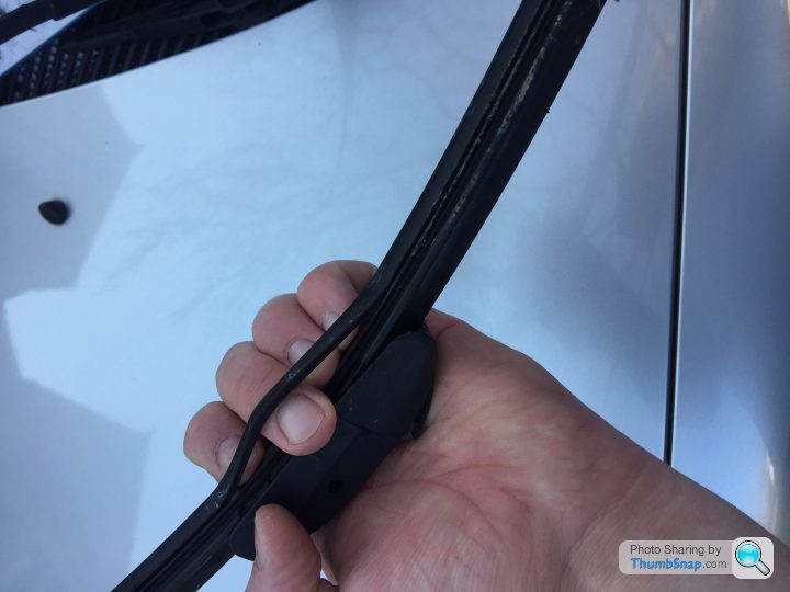

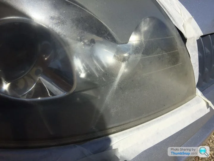

Over 2,500 miles done and not missed a beat. Really enjoy driving it, a bit of a shame that I've not got had any more track days. I plan on doing the brakes over Easter. braided hoses, discs, pads and replace that leaking caliper. Sticky tyres (Federal 595RSR's) are on back order too. Anyway, treated the Clio to all this today. Done the headlights as they were poor, but most focus was on the Z today. So you get pic's of both!

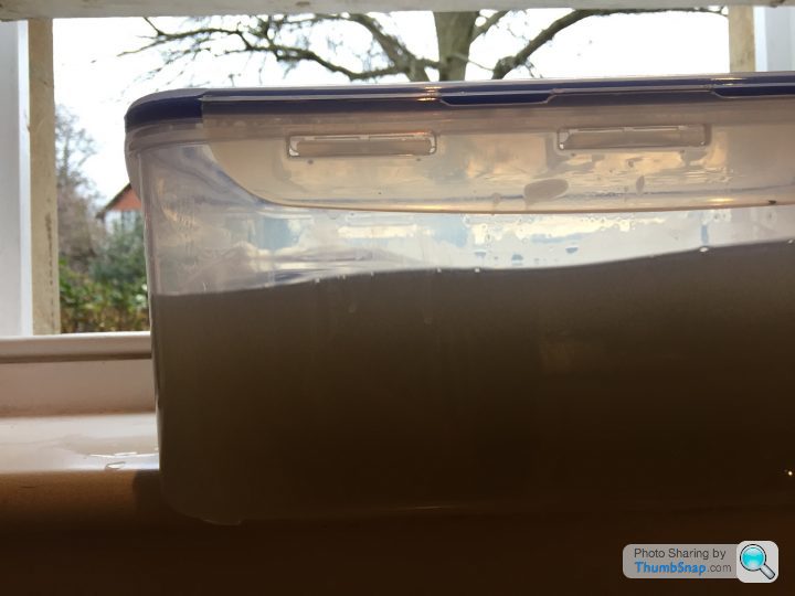

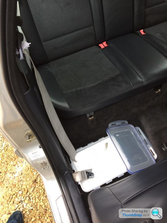

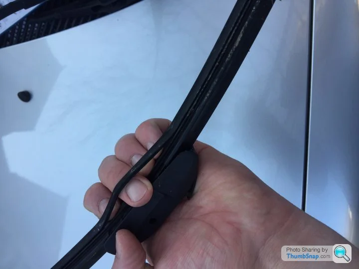

Weird one, but I cleaned the belts recently. they were filthy! Black obviously hides it well. Unravel and wedge some paper in, voila!
That water is from 1 of them.

Following on from the last (but one) post, my exhaust keeps dropping, and making a racket! May have to shell out for good brackets, they run £60 each
So Yodel did mess up, they arrived last Tuesday, so I had to get it all fitted this weekend. I probably spend 12 hours over 3 days doing the work. From sorting out the stones on my drive (for the load spreading wood) to having to drill out the disc retainer bolts. 3 trips to Halfords/diy shop to buy a grinder amongst other stuff. Unfortunately due to the amount of time and dirt on my hands I didn't do any photos for this bit...
I started off working on the offside front, purely as it was closest to my tools. Everything took a bit of grunt to get cracked, the long handled torque wrench helped. Fairly easy sailing on both the front, but ended up with discs I couldn't spin. Carried on regardless with the braided hoses (queue lots of brake fluid on my pebbled drive) a fairly easy job, on the fronts at least! Redone the caliper mounting, incase I'd screwed up and still nothing, so gave up and headed to the rear of the car.
At this point I realised how much better off I'd have been getting 2 more axle stands. When you bleed, it is done in NSR OSR NSF OSF order, so basically zagging across the car, meaning many jacks and moving axle stands!
The rear was easy enough, 1st one took a while as I'd never done one on the clio, 2nd flew by and both discs have movement. Rear hoses were a bit trickier as they are under the car, so on your back with 2 spanners and trying to stop brake fluid either getting in your face or on the floor, I failed at both (I honestly can't see why they are even there, it's 4 inches of hose in-between 2 metal hoses, on a non-moving part of the car!)
Stupidly on the rear, I had started on NSR then onto OSR, so had to swap the axle stands AGAIN to start the bleeding process. Move back to the fronts. A chat with a mate and either both had seized at the same time, or I wasn't getting the piston back enough. My 4th trip out saw me buying a G Clamp to get some welly behind pushing them back. I reassembled them for the 4th time and had free spinning disks! Turns out I'm not strong enough with a pair of small pliers to push the pistons all the way back in.
I then bled the fronts checked every bolt again, fitted the wheels and I was done. A quick forward/backwards to check the car wasn't going to fall over and it'd stop, and away I went. Obviously it wasn't going to be straight froward, and as I inspected my work, 1 of the fronts was quite warm from my little 30mph drive. So, it all came back off and I pushed the piston in more (somehow), but it seems to have worked. I've bedded them in on some quiet roads and since taken it out twice. No difference around town, but use the pedal with some force on the twisties and it'll give you whiplash!
