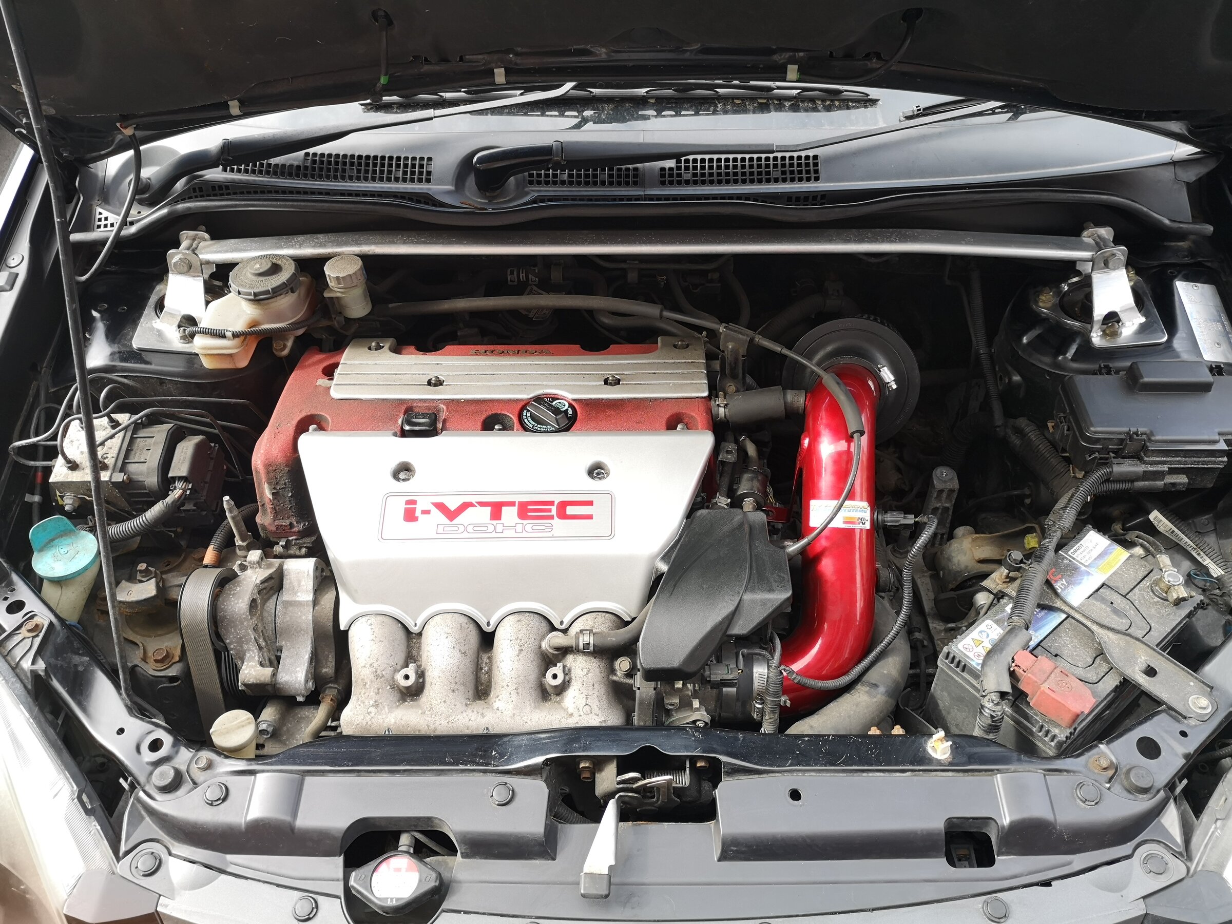

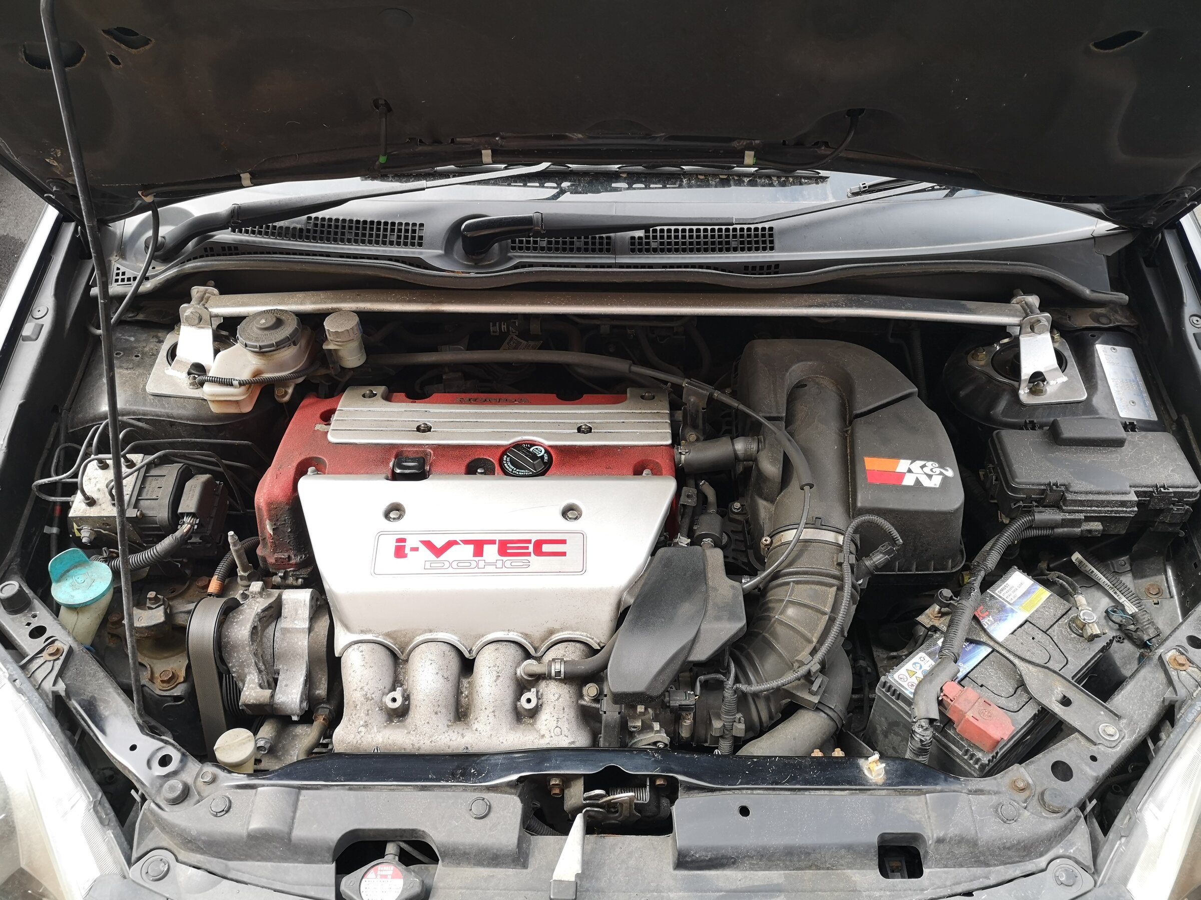

First up whilst browsing eBay for parts I didn't need, I came across a used K&N Typhoon going for £65. This jumped out at me as I know these are £200+ brand new (although ECP have them discounted atm), so I took a punt. It didn't come with some of the fittings but a quick trip to Screwfix for some hose clamps and bolts and jobs a good one.
Before:
After:
First thing you'll notice is how grubby the engine bay is, I've never really given it any loving however this should be changing soon. Also, the real stand out is the rocker cover (you can see the state of it on the lower left), I'm going to be sourcing a used cover soon and refurbishing it myself to replace this one.
Regarding the K&N, it's not the top choice for induction kits for EP3s, any Honda snobs will pretty much sneeze the words 'Gruppe M' at any mention but these are very expensive and I saw this as a good short term buy. It sounds fantastic over 5-6k, the VTEC really does sing, however the downside is they do suffer from heatsoak due to the positioning of the filter, especially on hot summer days in standing traffic (doesn't bother me).

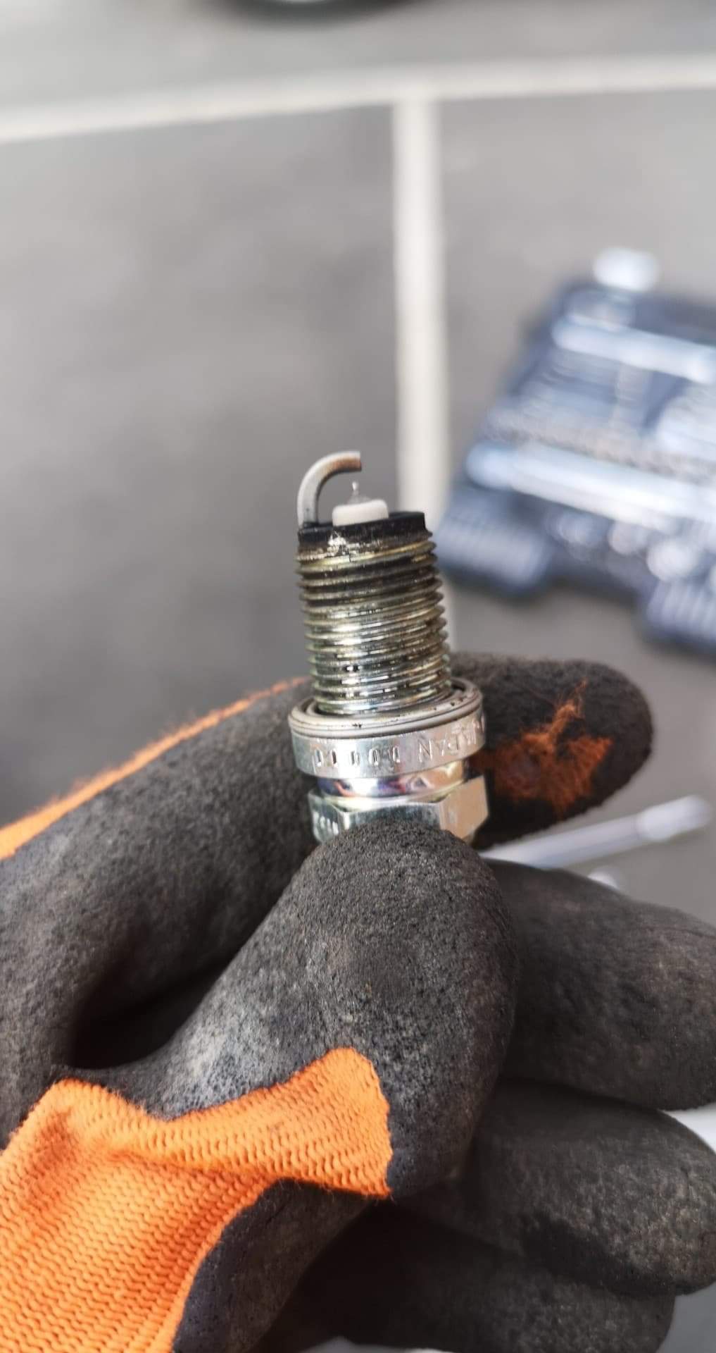

Next up were the plugs, never touched in my ownership so whipped them out and they looked pretty alright:
I did have a set of NGK plugs at the ready so I swapped them over anyway just as a full refresh. The K20A suffers from something called the 'K20A sneeze' where it makes a pretty loud crunching noise upon startup, since I changed the plugs it's never done it (touch wood!), any folks know if this is just a coincidence?

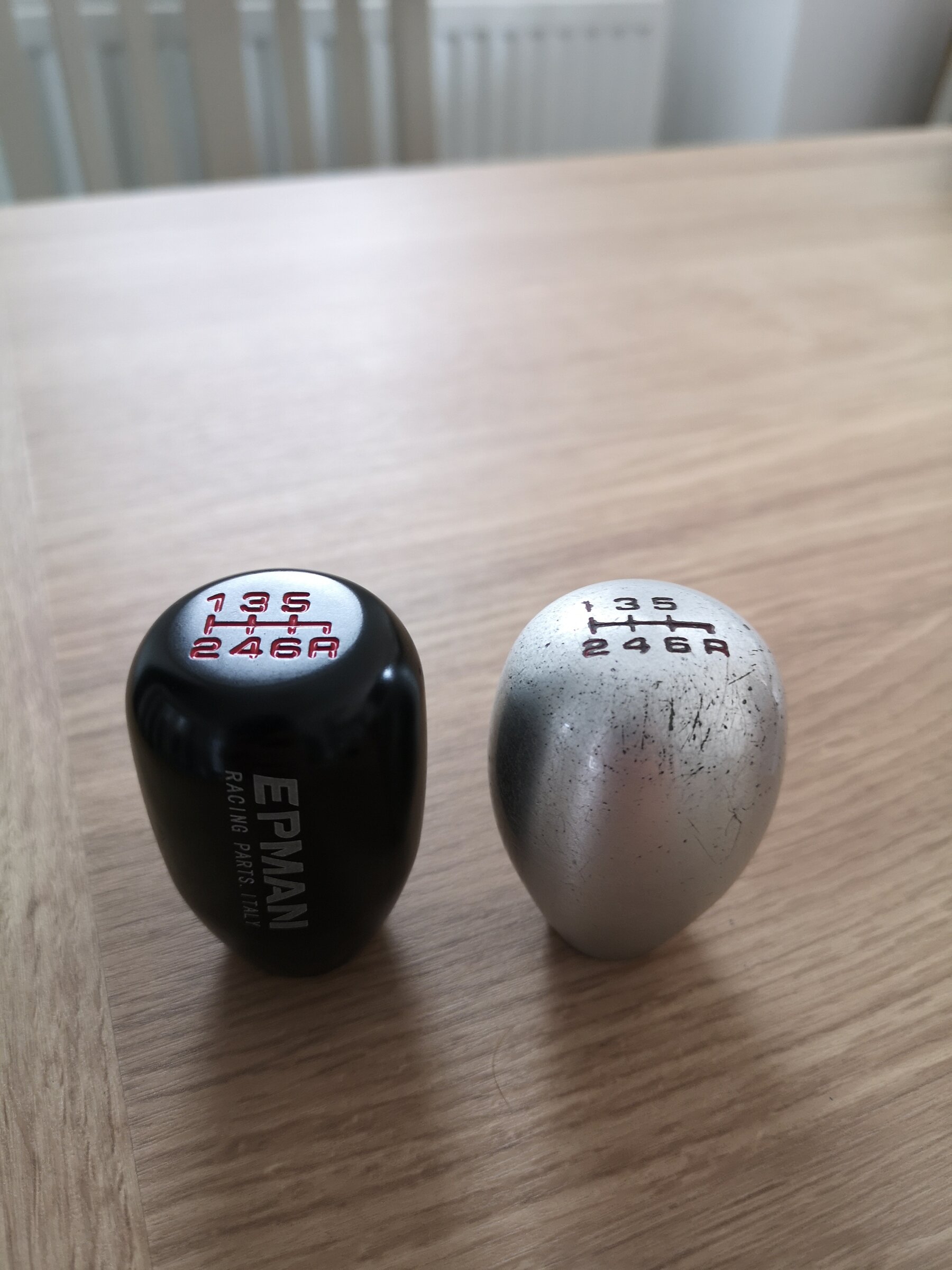

Next up was the gear knob, the factory knob has seen better days so I decided to swap it out with a cheap Epman option, at £17 it's a bargain especially compared to the Skunk2 or original items which are going for £60-70 nowadays. This is purely temporary, as I'm going to look at polishing the original knob up when I have time - however the Epman item is suprisingly weighty and does the job just fine.

My EP3 and DC5 used to suffer from the odd k20 sneeze. Nothing to worry about ☺️
Yeah it's the starter motor that makes the noise.

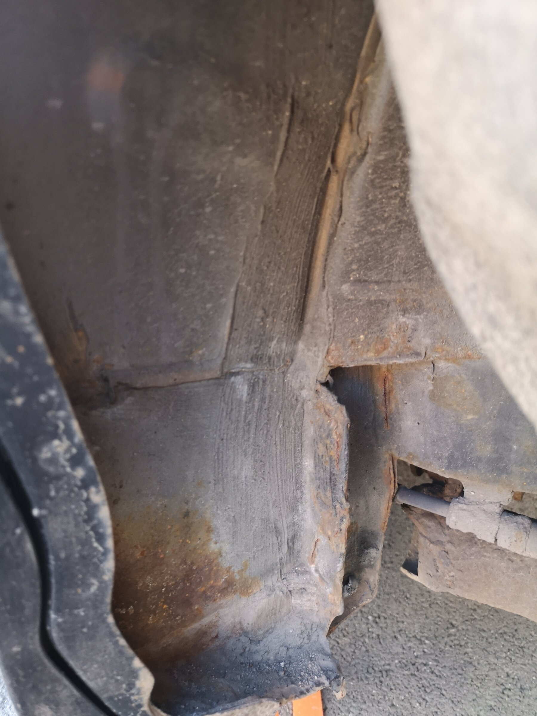

Small little update, wanted to get the rear arch liners off to see how the rear arches looked as these are the prime spot on these for rust, I've seen some horrific looking arches so safe to say I was a bit anxious about them.
Unfortunately being a complete newbie mekanic I bought a jack that didn't get the car high enough to get the jack stands under :LOL: - luckily @leeds2592 lives 3 doors down so came round with his to help a neighbour out.
Also, unfortunate as it was one of the arch liner bolts was completely rusted and wouldn't budge, but managed to peel the liners back to have a bit of an inspection to see what we're dealing with.
Safe to say, it's one of the good ones, same on both sides(y)
I'll pick up a new jack shortly and get this wire brushed down, then will treat with Kurust, primed and waxoyl'd.

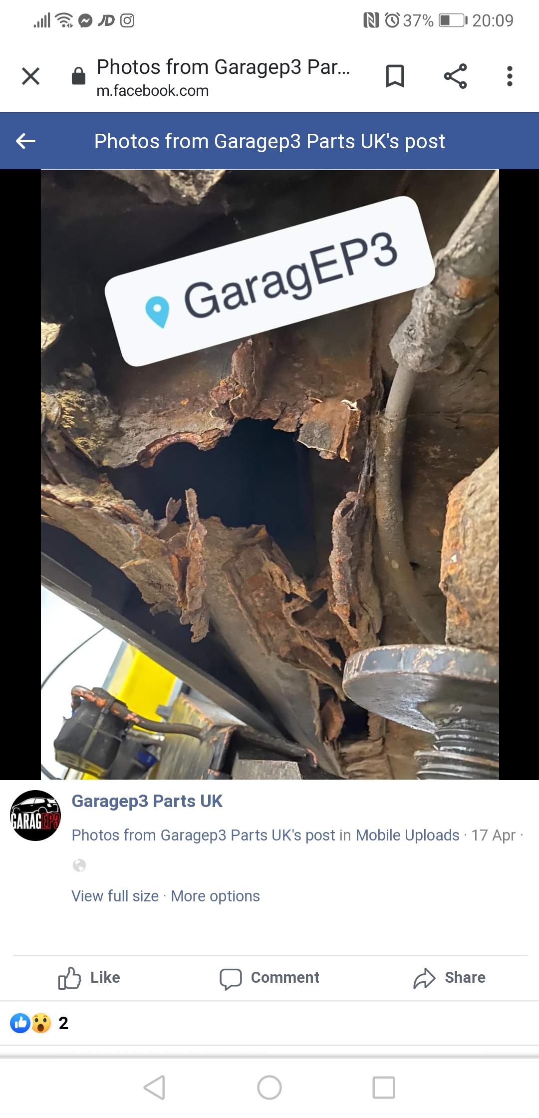

If anybody is curious as to how bad the rear arches and sills can get, this is one of the recent posts by an EP3 broker 🤣

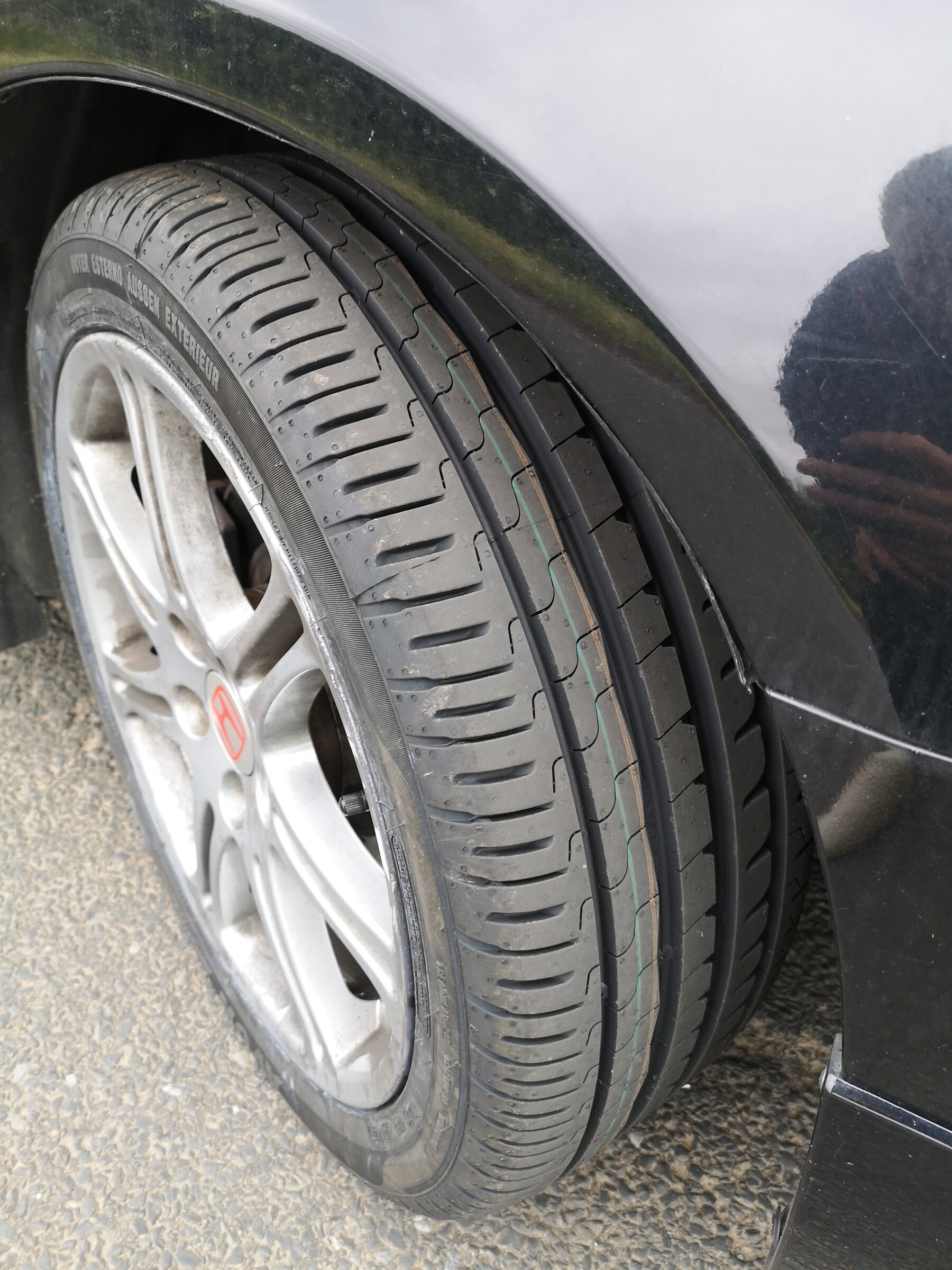

New rubber on today, decided on a set of Avon ZV7s as I deemed them as a suitable option for daily use.
The Bridgestones I had on were cracked between the tread, and I noticed the fronts kept sagging all of the time which did my head in. I checked the date code and they were fitted in 2015 so were definitely past their peak. Also, I've noticed alot of road noise whilst driving so did add this into my considerations, the ZV7s are highly rated for reduced road noise, quiet as can be!
Get the rear speakers out and put some kurust down there. they're bad around there to rust from inside out.
