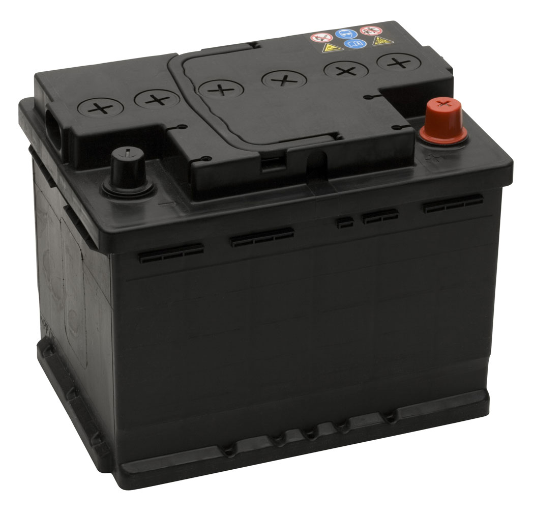

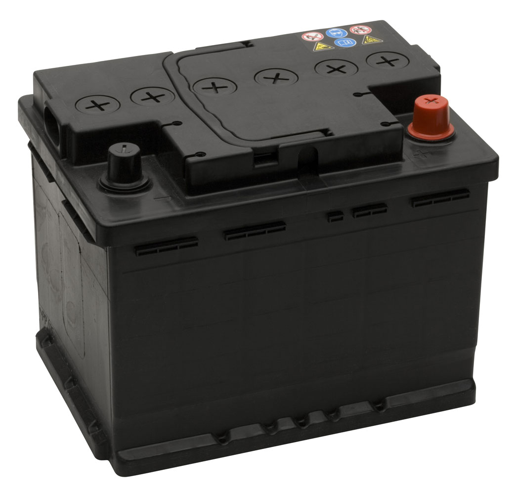

Best place to start is battery. You can remove the plastic cell covers using a coin (they look like small circles with crosses on). Remove all the covers, look into the cells using a torch and get somebody to turn the ignition. If the battery is duff you should see small bubbles emerging from one or more cells.

For reference, these are what the cell covers look like:
