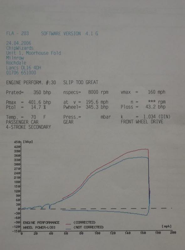

The MK1 I have been researching owned by Flan had a K04 with the standard Audi TT injectors, AGU block, EVO IC, emerald and made 279bhp / 280lb/ft @only 10psi !!
