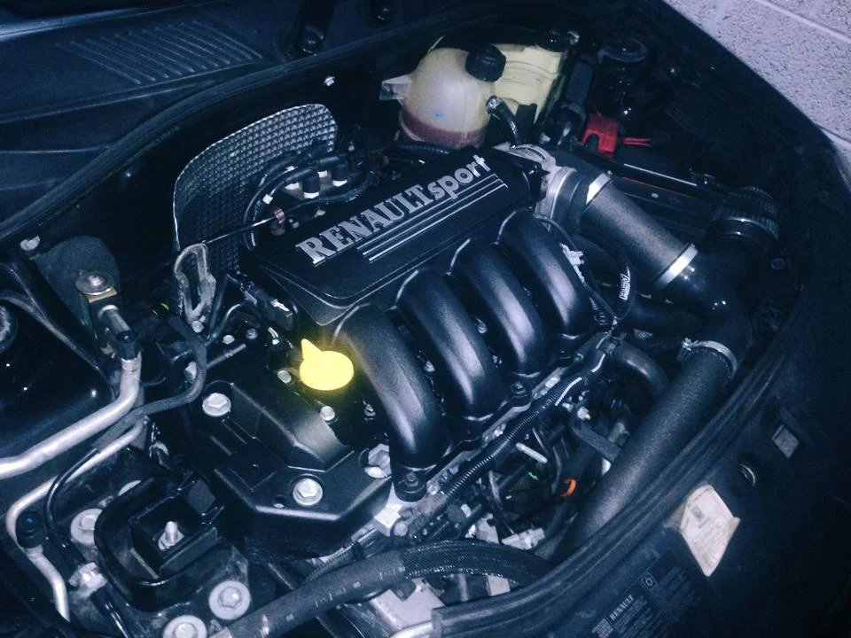

3k isn't that bad for a drive in drive out full turbo conversion either imho. Heres a snap of a 182t they done last week...
