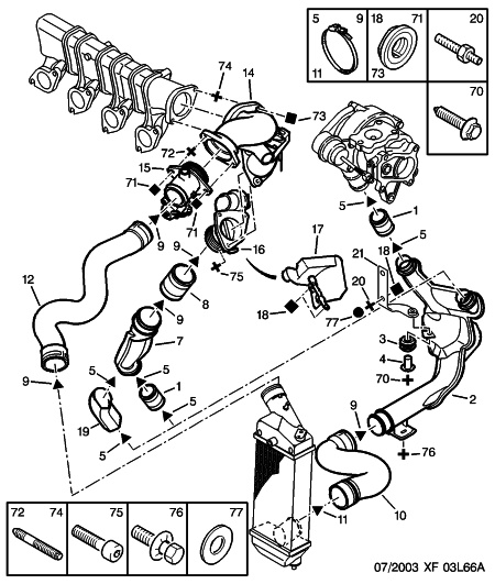

Theres your pipework.
The S bend coming off the intercooler is a common pipe to split, may be worth checking that one.
Also, Number 1 on the diagram can sometimes be at fault, the little sleeve hose.

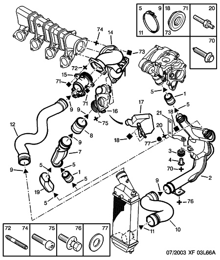

Hi I have a pug 307 and I've had a good look at the car and the pic you posted I suspect number 1 in the pic is at fault is there any way I can fix it ? As looks to me like I have to drop the engine ?
