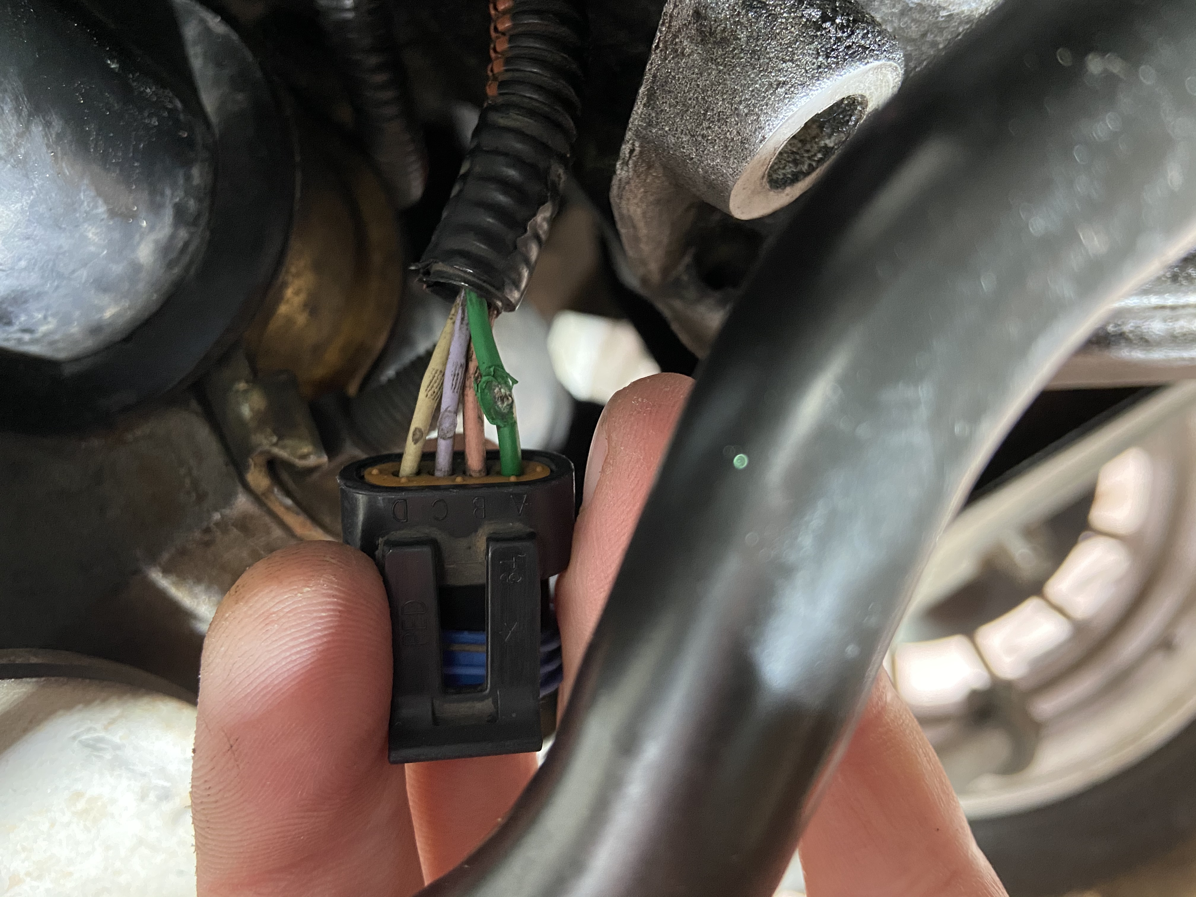

Can't get the car to start checked all earths & checked for bare wires ect. I found that the second lamba sencor had burnt onto the exhaust manifold. Striped wires back. & Insulation taped them. Can't find anything out of place. The relays tick under the bonnet & blow the fuse.

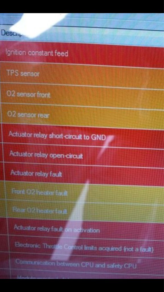

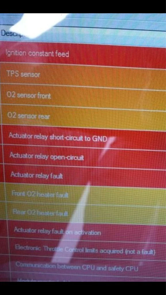

  CLIO 182 CUP
This is what my Rs tuner is comming up with
Any 1 who could help me urgently because need my car
Many thanks Adam

It was shorting out on the main lum that connects to the second lamba. It just keeps blowing the fuse as soon as I turn the ignition. The relays keep clicking under the bonnet mate

  CLIO 182 CUP
I only have the front lamba connected because the second 1 Is not connected I don't use it because have a home made decat lol. I've had a really good look will I need to change the wiring loom. Do you think you could give them a nudge to see what they think.
Cheers mate
  CLIO 182 CUP
Followed the lamba right into the loom & all the wires were all shorting out further up. so all sorted now. Thanks for your help.
  Clio 172
This seems to be a pretty common issue, it’s been raised on a few threads. I had the same issue with the 30 amp fuse intermittently blowing. Good thing I searched it on here and found exactly what to look for! Melted wires on the loom side of the lambda / oxygen sensor. Cliosport for the win, you people are great!
