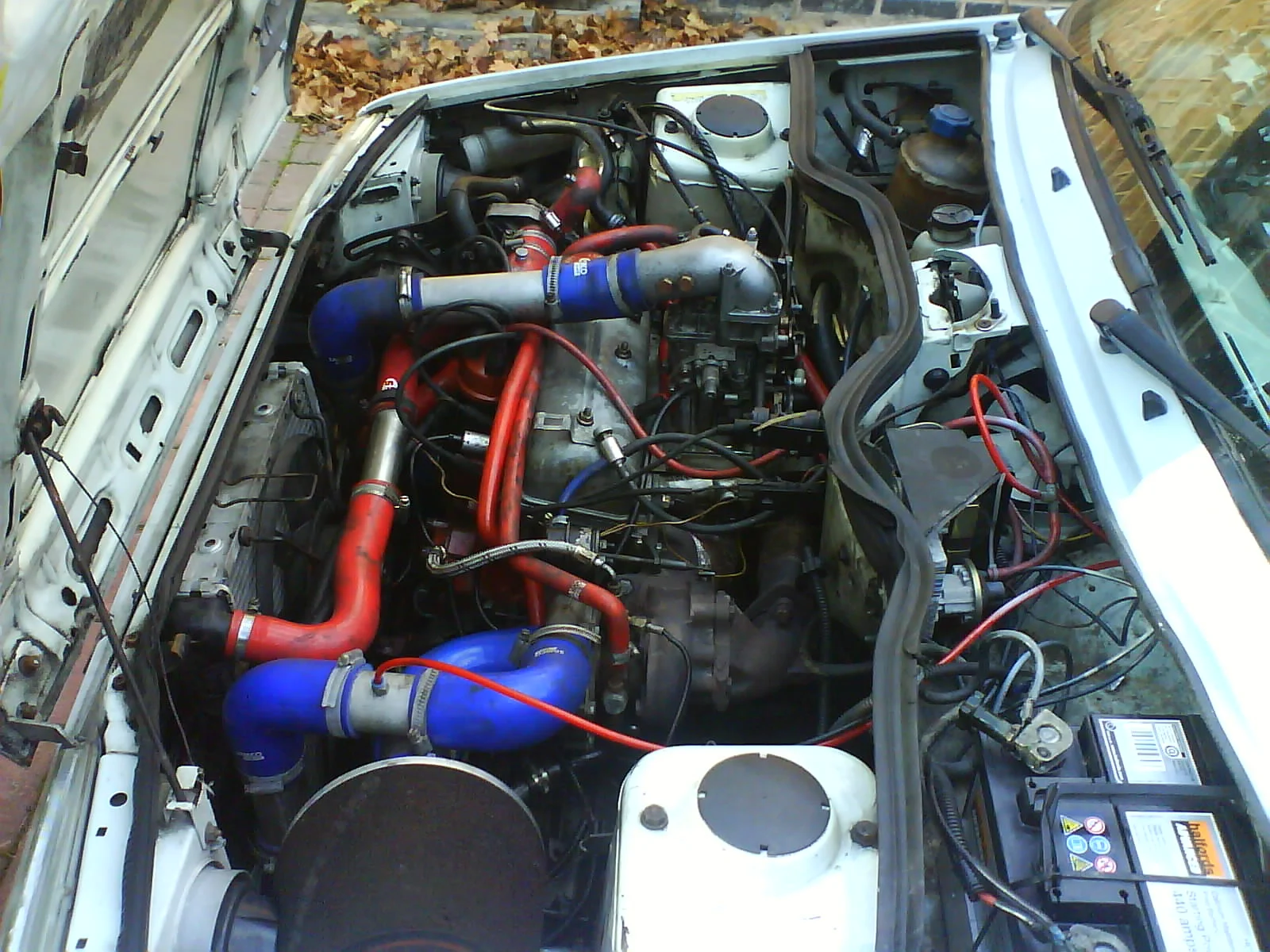

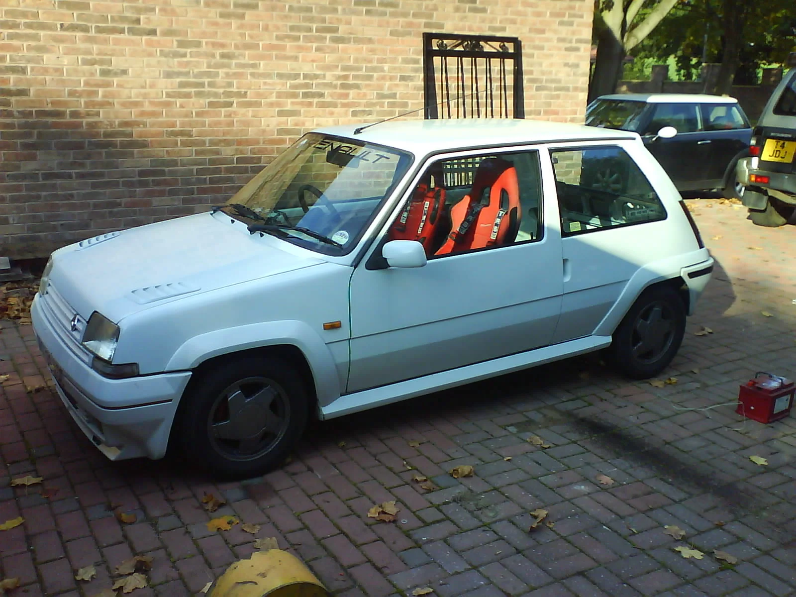

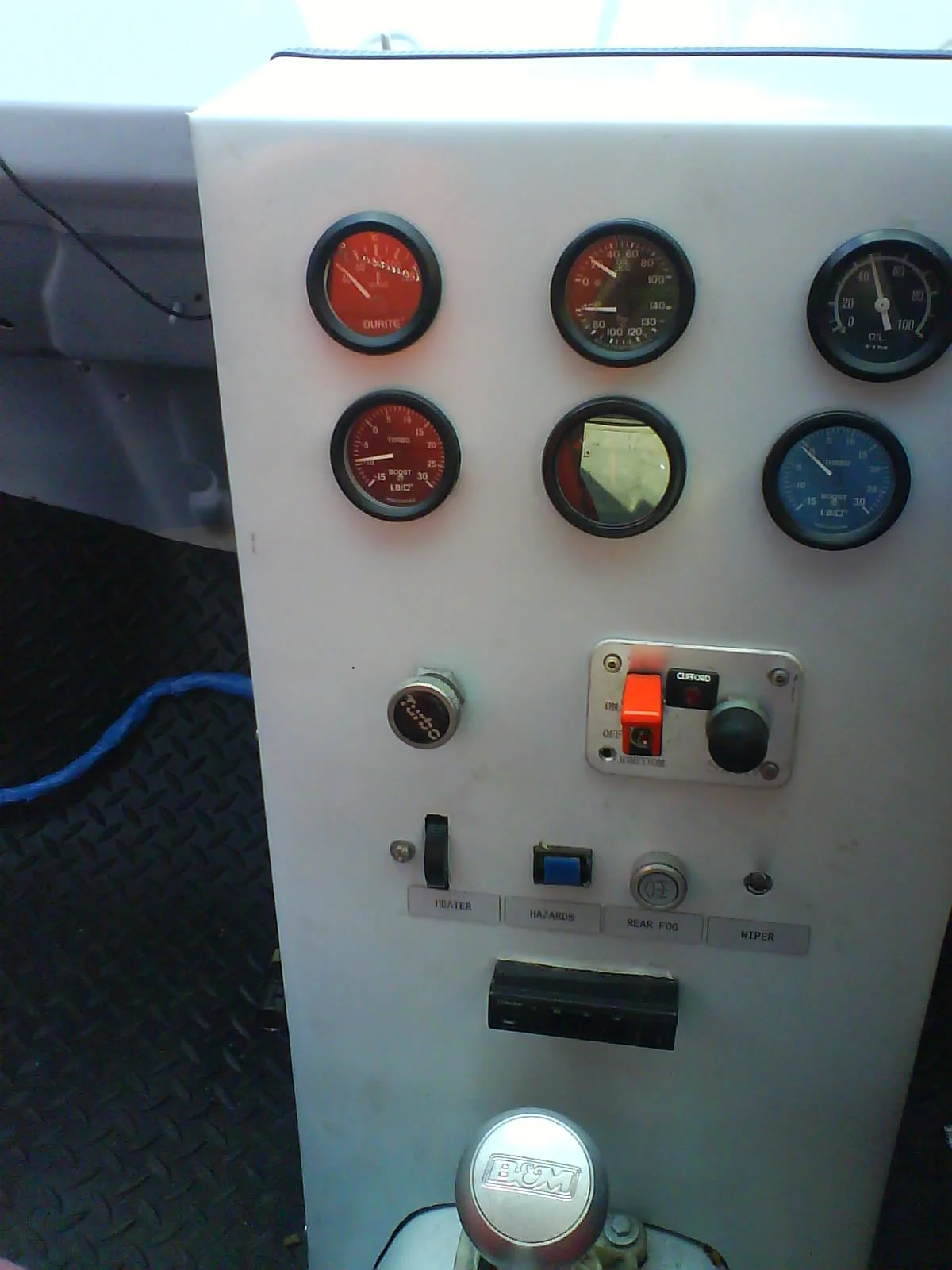

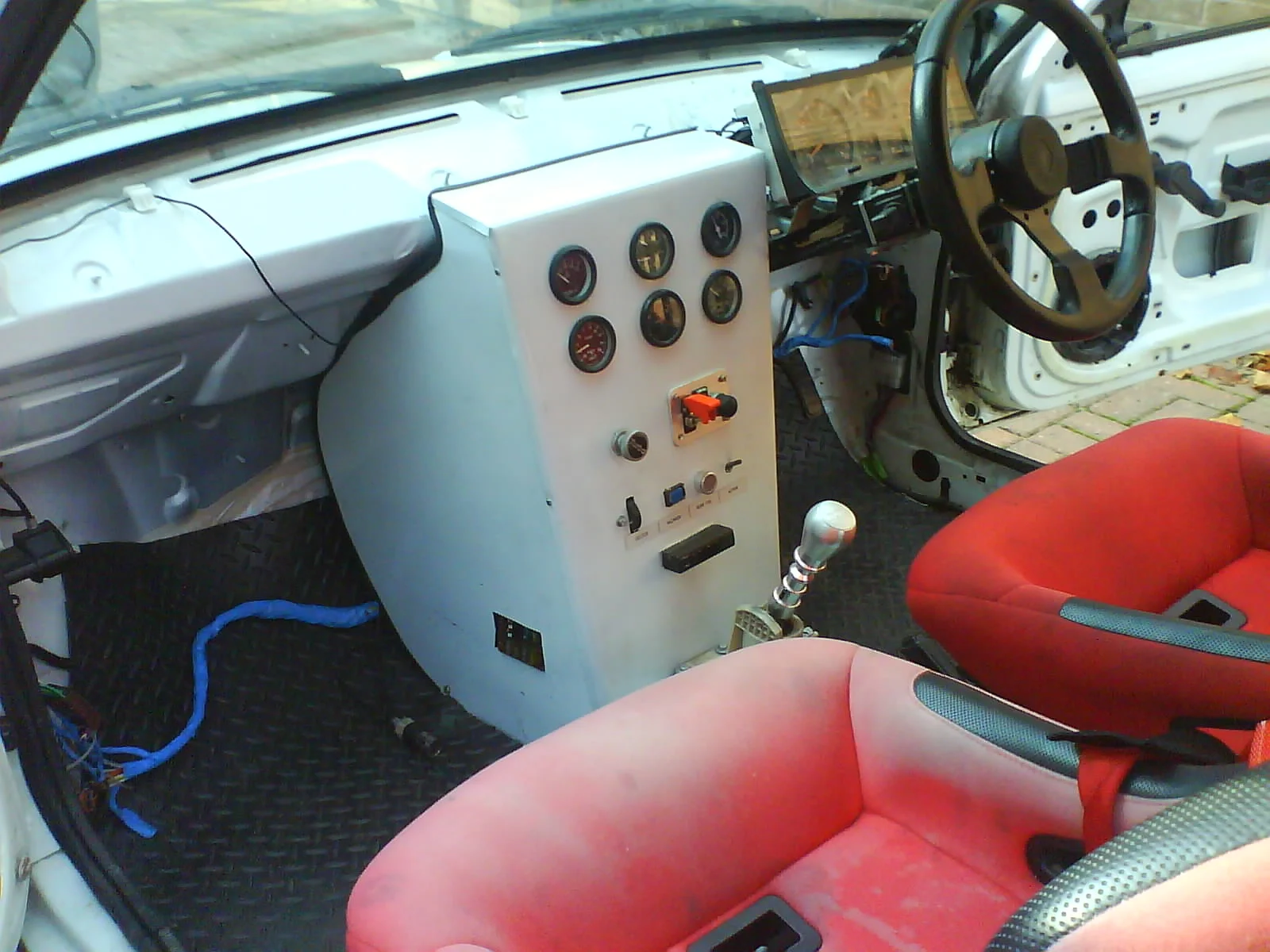

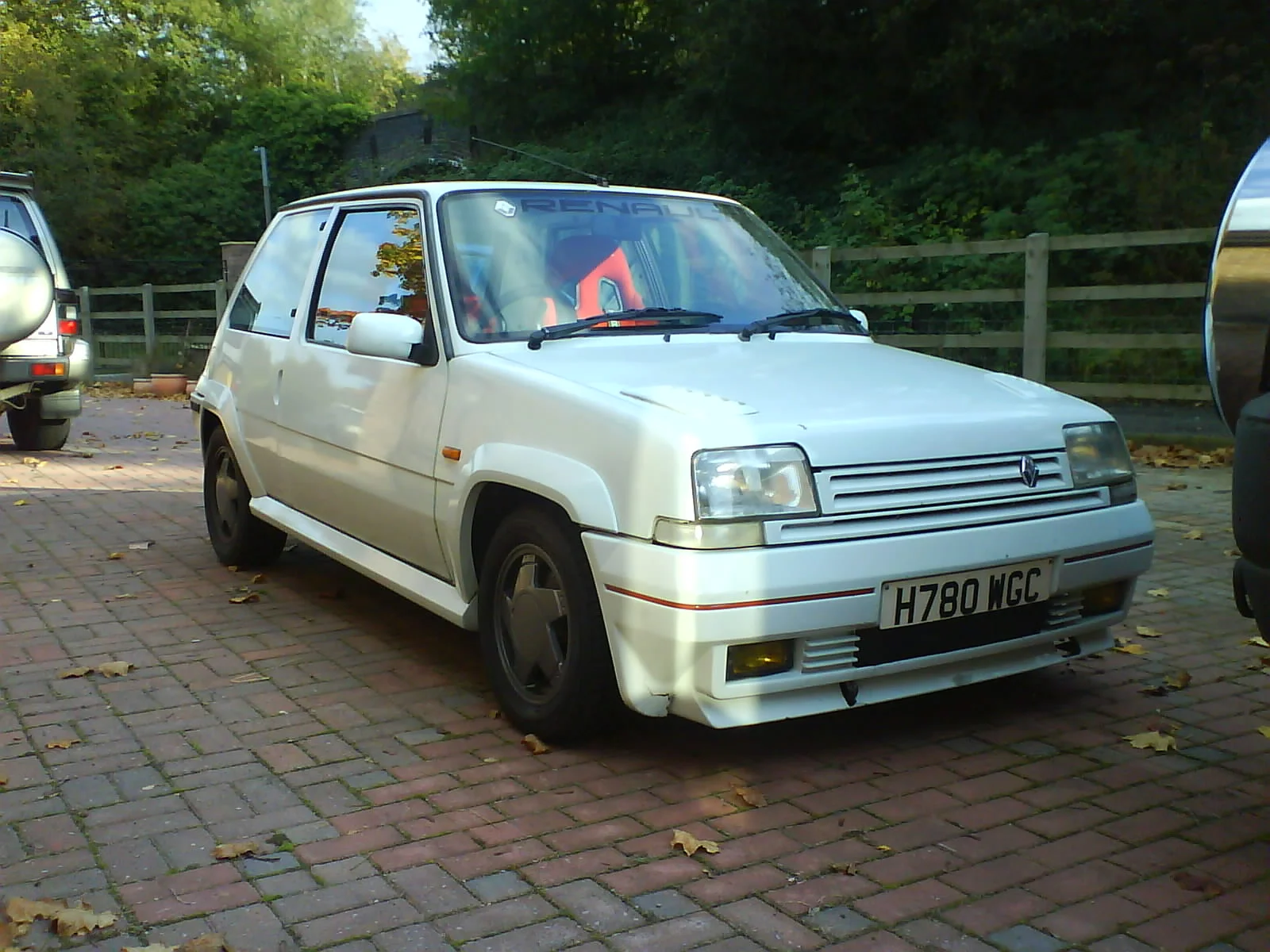

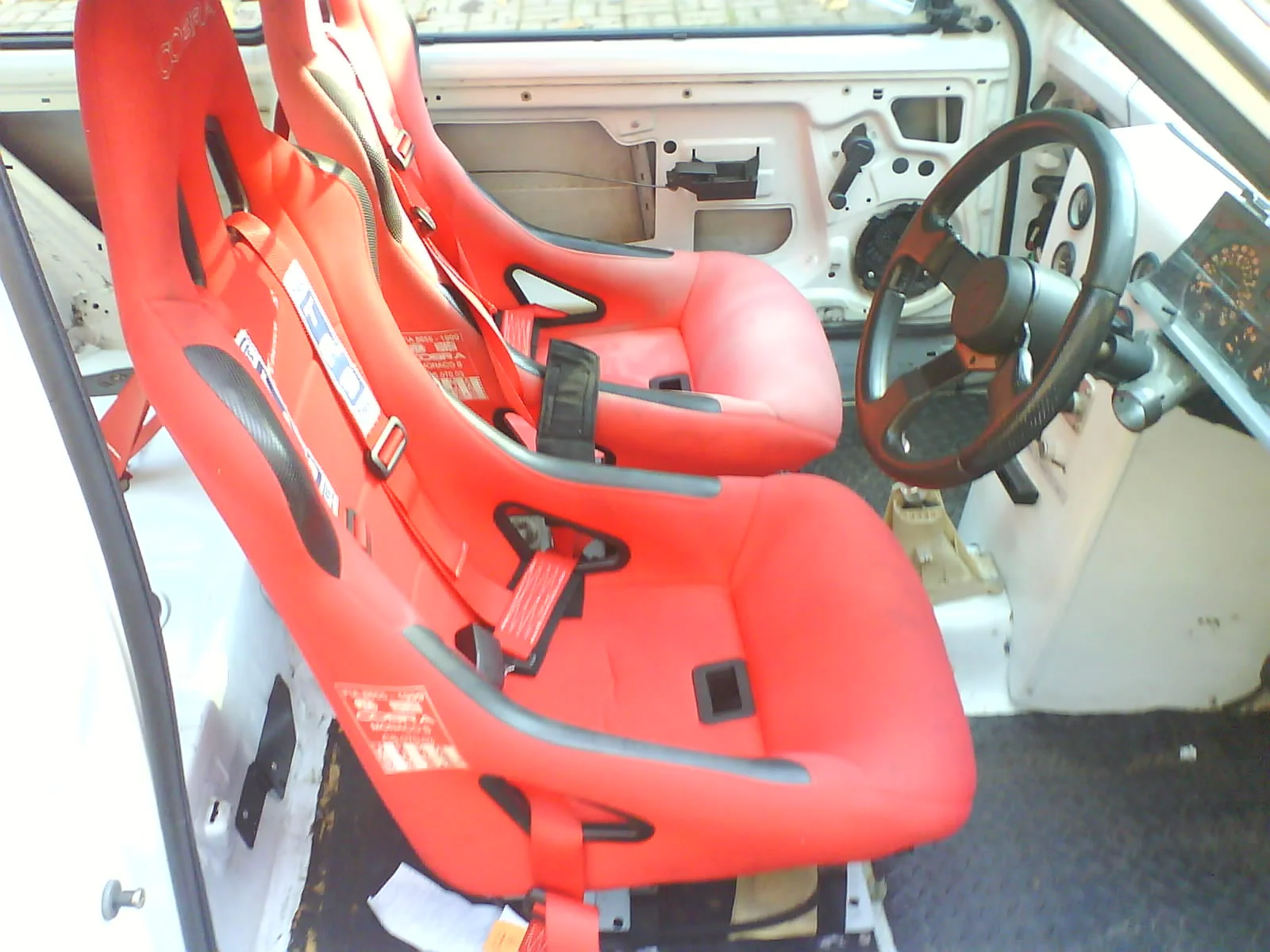

Someone (cant remember who) wanted pix of my make shift dash in my 5, anywya here's a few pix for you guy an gals... It'll be goin round donnington on the 20th Oct!
Spec is:
Just been rebuilt with standard pistons, rings, liners
T25/T28 hybrid turbo
Piper cam
modded carb
Lightened and balenced fly
Polished ports
Up-rated head gasket and head bolts
Up-rated valve springs with stem seals removed
Pipercross air filter
K-tec side exit exhaust
Loads of gauges all neccessary!
Koni fully adjustable shocks and koni springs
Polly bushes
B&M quick shifter
Fully Stripped
Green stuff pads - braided lines goin on next weekend
Running approx 180bhp @15psi boost variable between 15-18psi

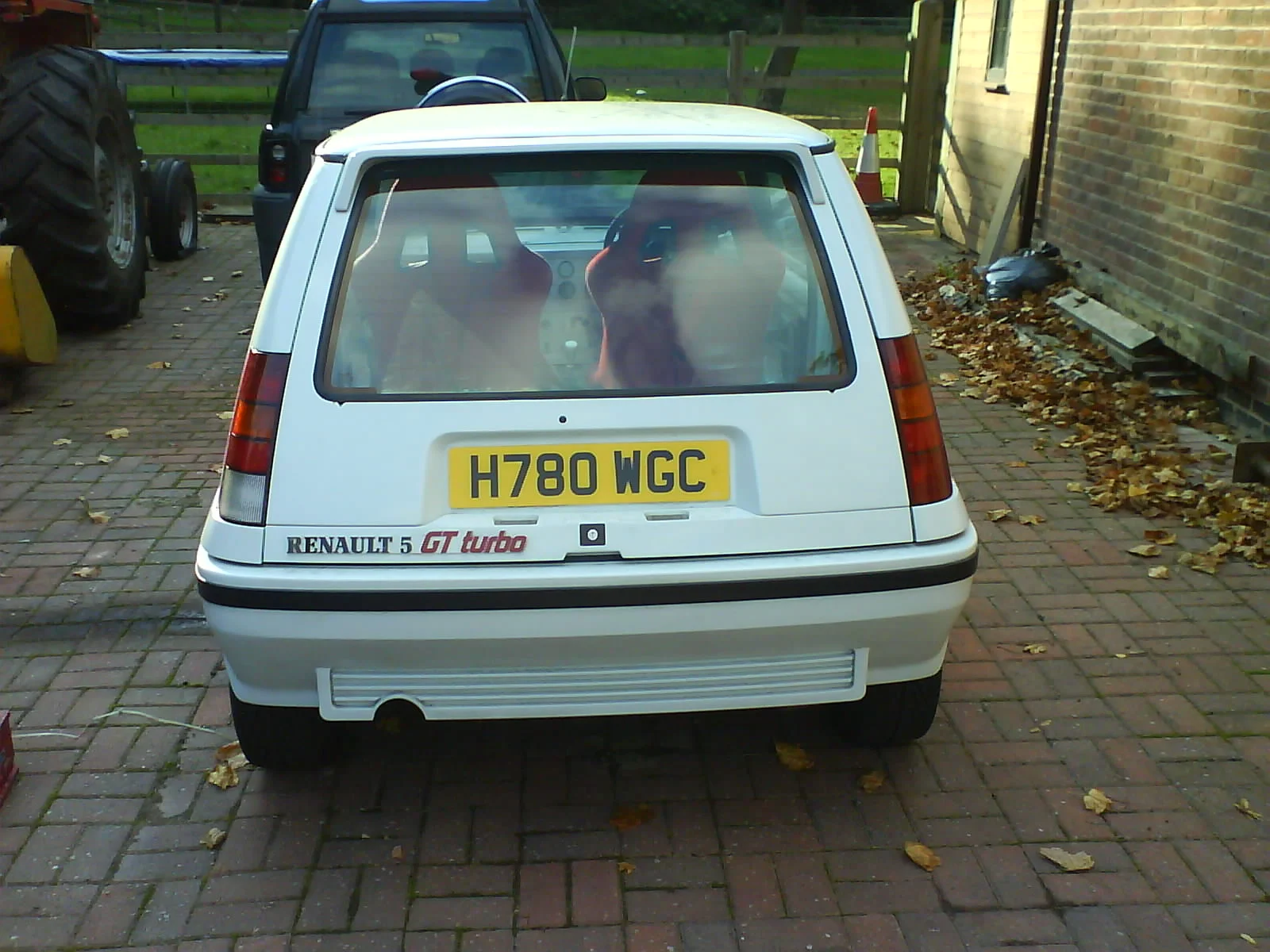

Got a standard cup and there is no question which is quicker mate. The 5 is somethin else. If your gunna do it, do it proper lol. The cup will have the same treatment after i sell the 5 for another motorbike... So any reasonable offers on the 5 maybe accepted!
Couple more pix and forgot to mention - running a Sierra Cosworth intercooler, and a Greddy turbo timer
