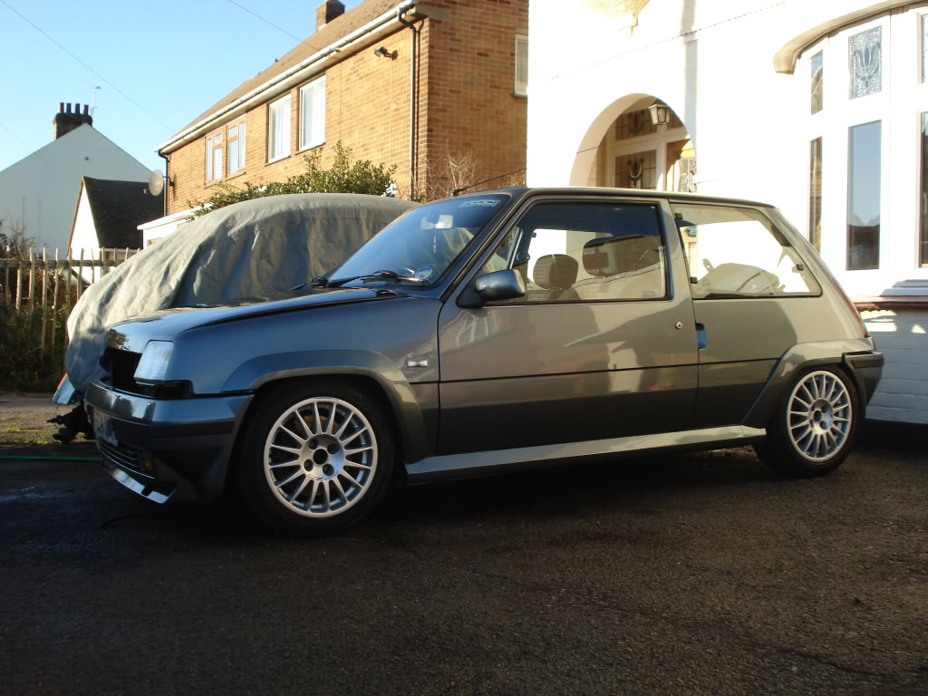

I hadn't really touched the grey since I bought it and it just sat on my drive looking like this for months.
My plans where to fit a 180-200bhp Renault 5 GT Turbo engine that I had and turn into a reliable track car. That then went out of the window when I was offered a complete F7P Turbo converted Renault 5 GT Turbo. It had only done about 1200 miles since the re build and had receipts adding up too thousands, so I bought it ! :)

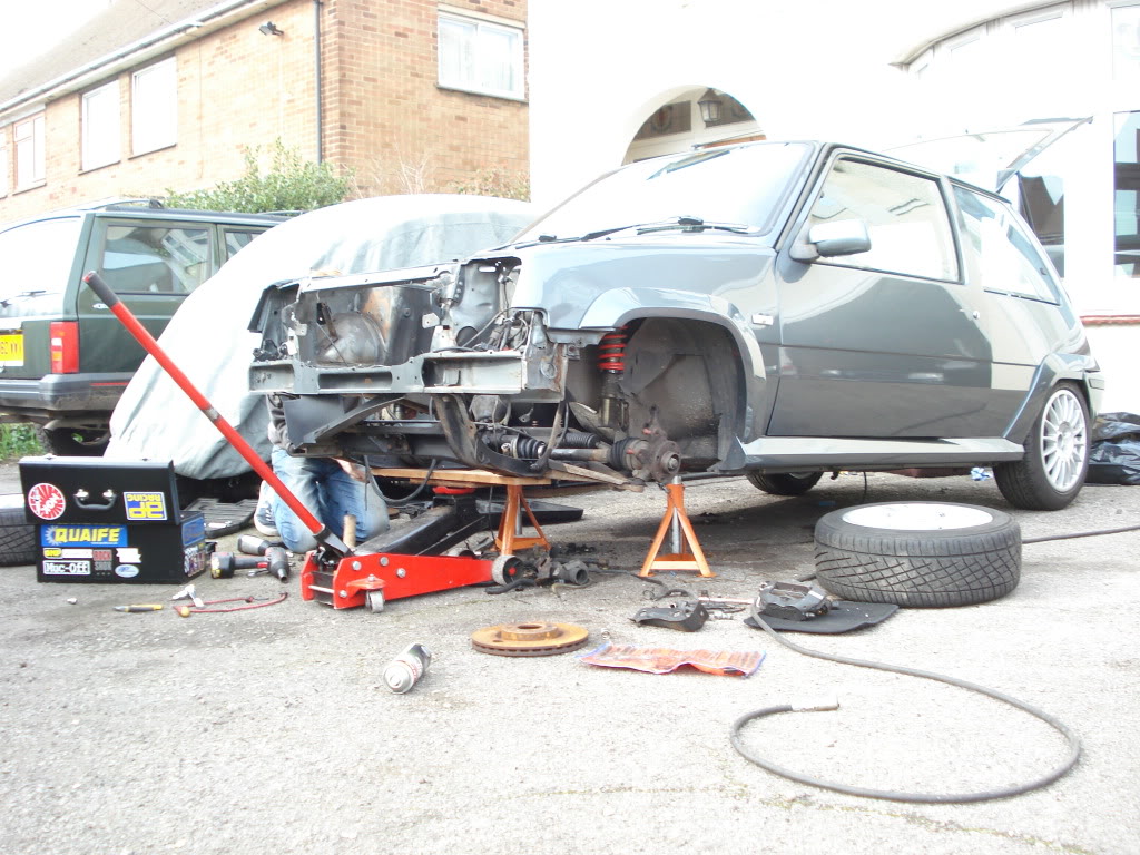

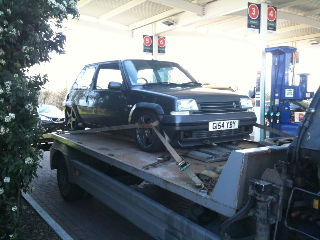

One on the way back from picking it up, notice the extra ramps I had to put on under the car as it was so low to getting on the truck.

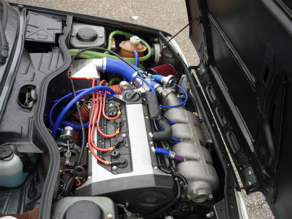

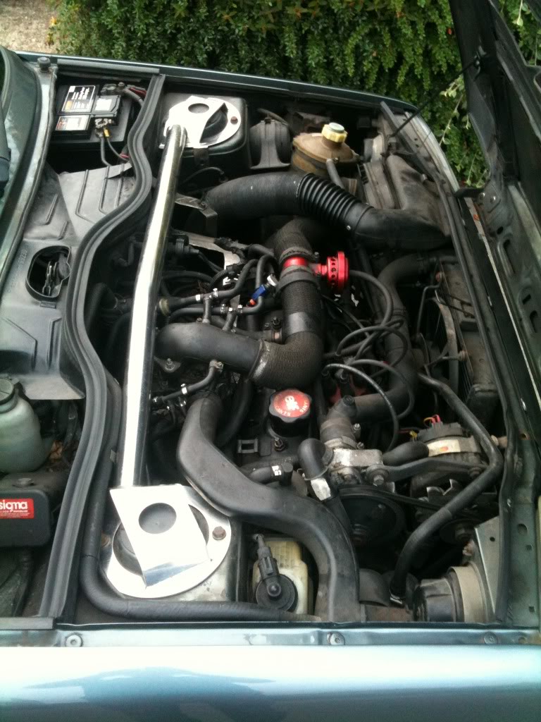

The engine

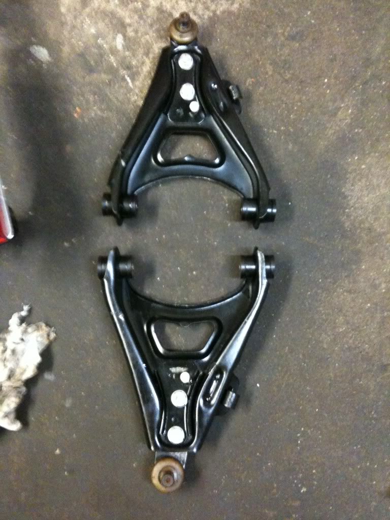

Over the last 6 months I have been collecting some parts though, also cleaning up some others bits that I already had.

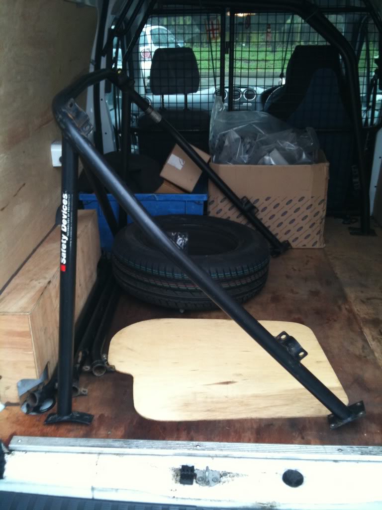

Safety Devices 6 point roll cage

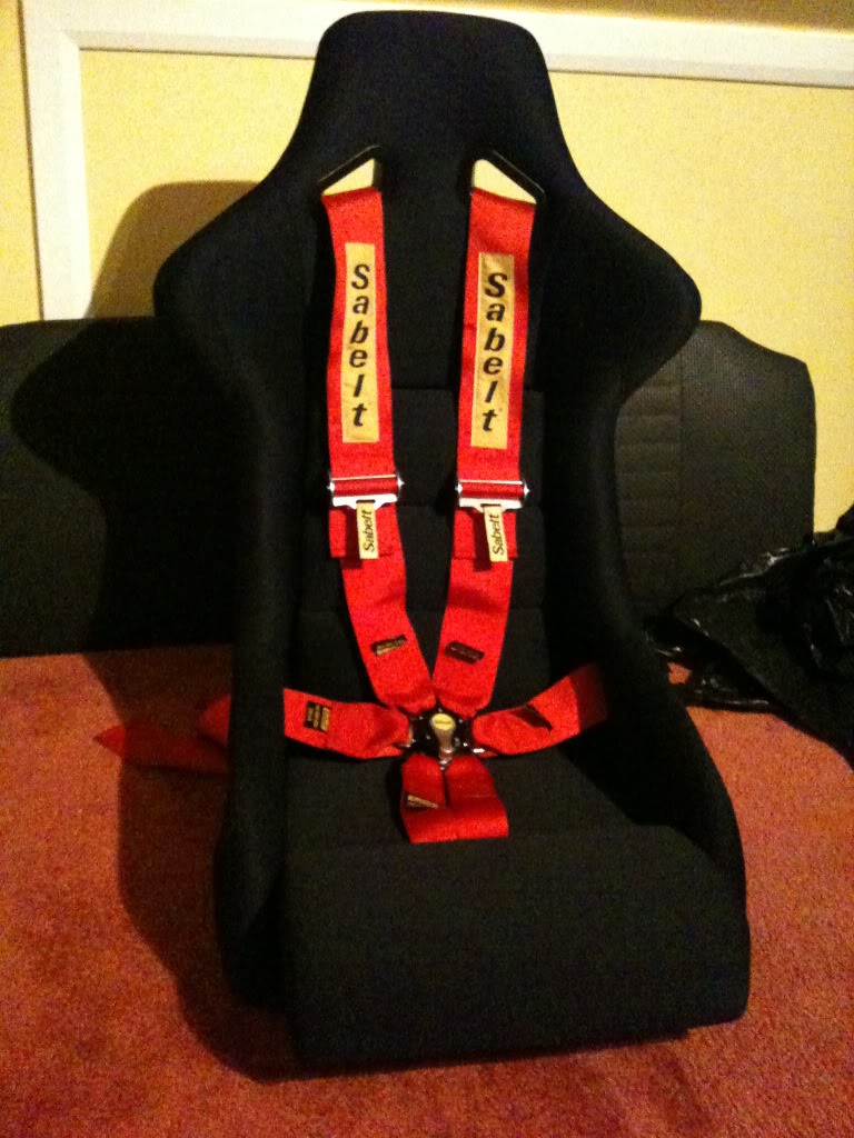

Sabelt 6 point harness and seat
Willwood 4 pots

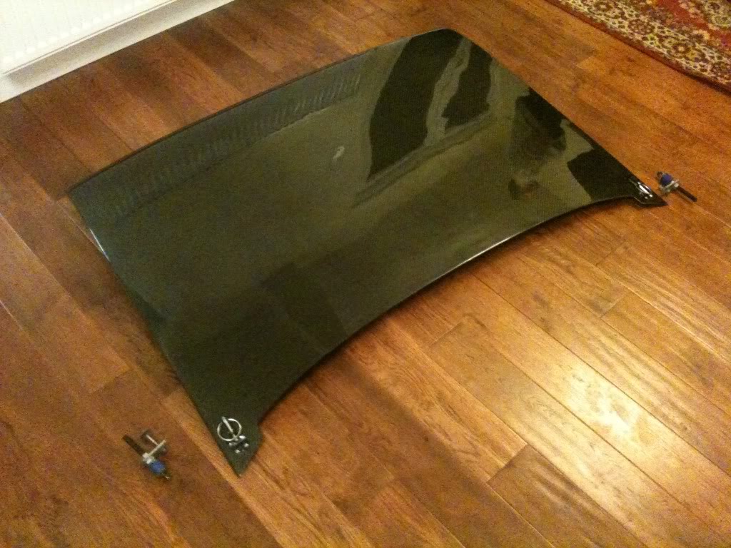

Carbon fibre bonnet
15" Oz super turismo wheels

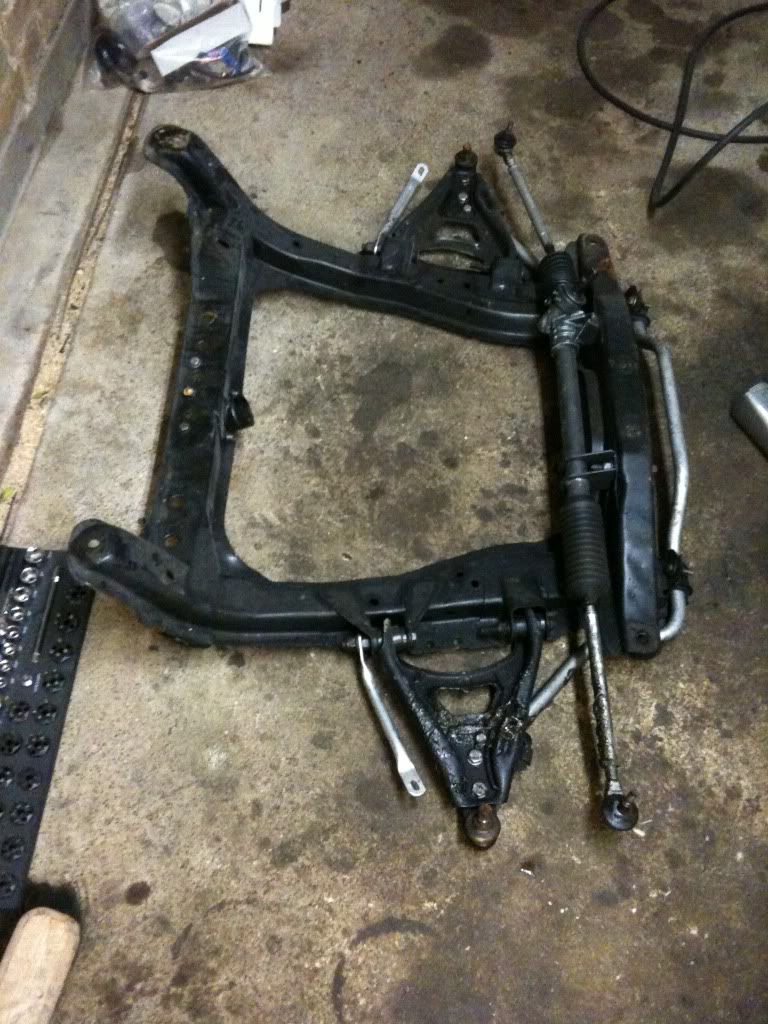

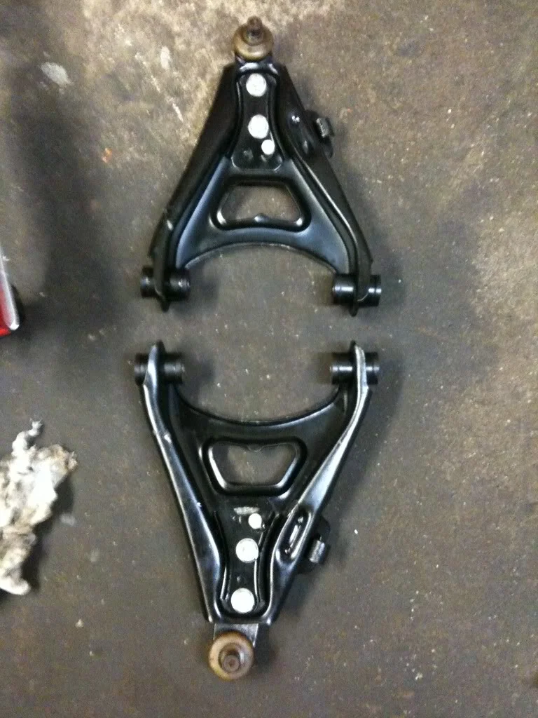

Poly bushed sub frame with new ball joints and track rod ends.
New wish bones

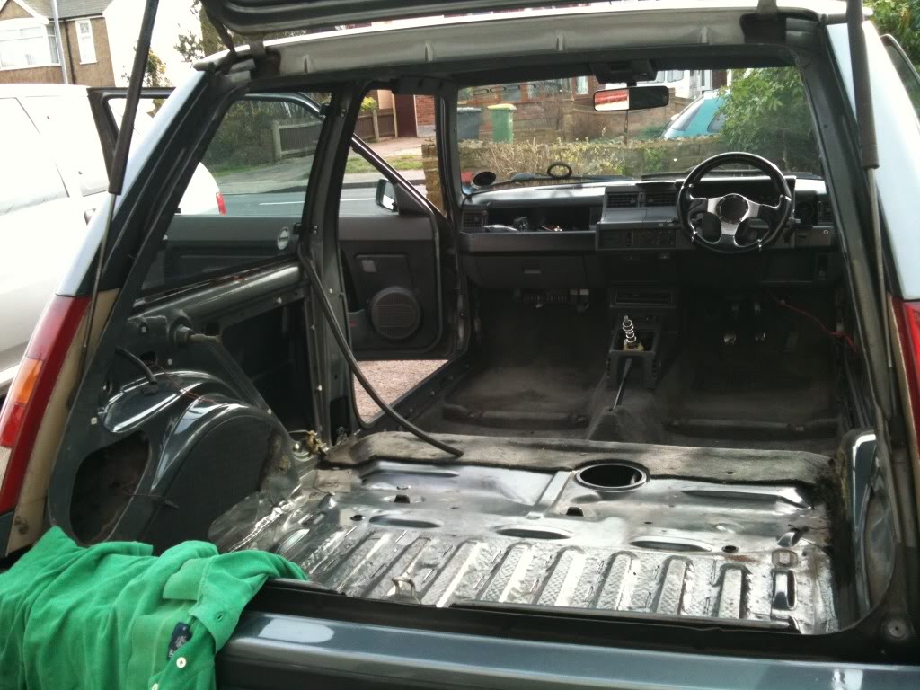

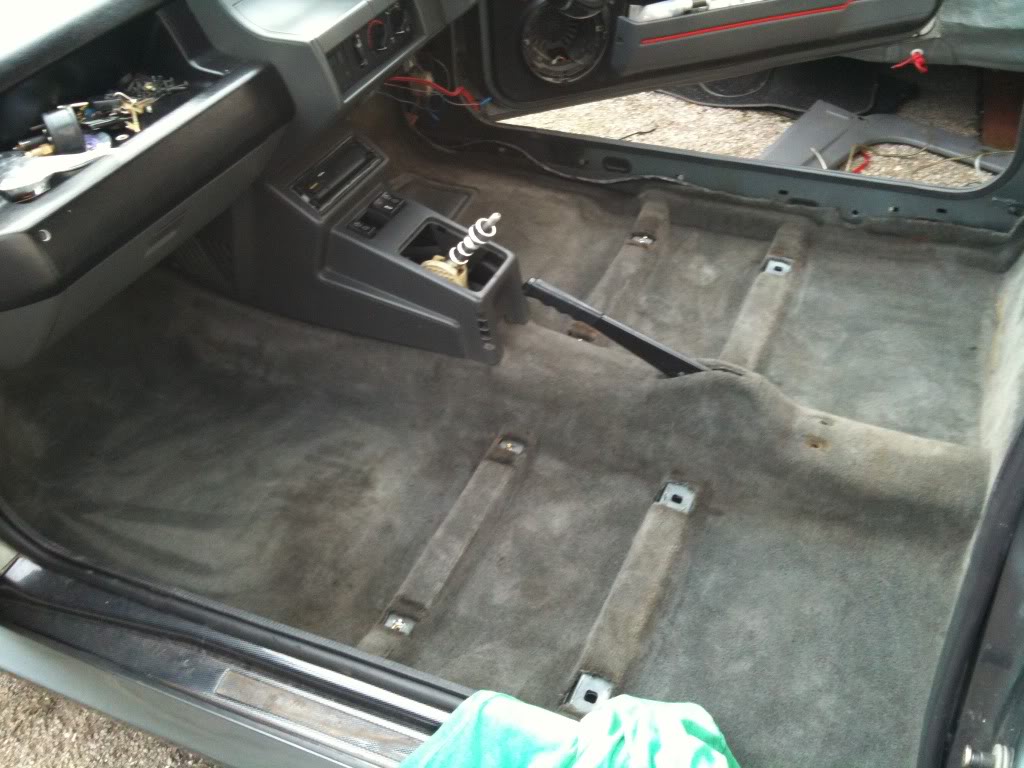

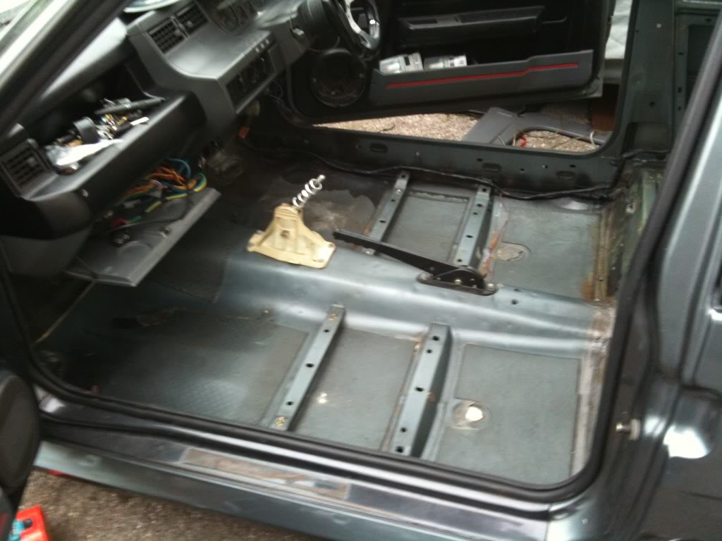

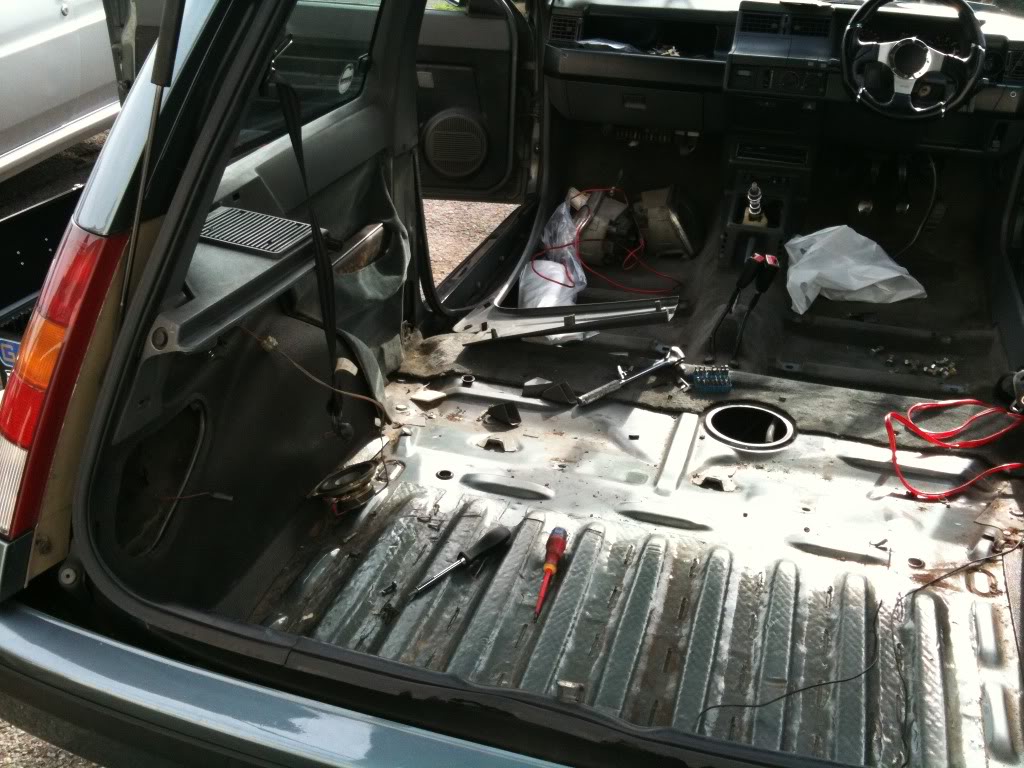

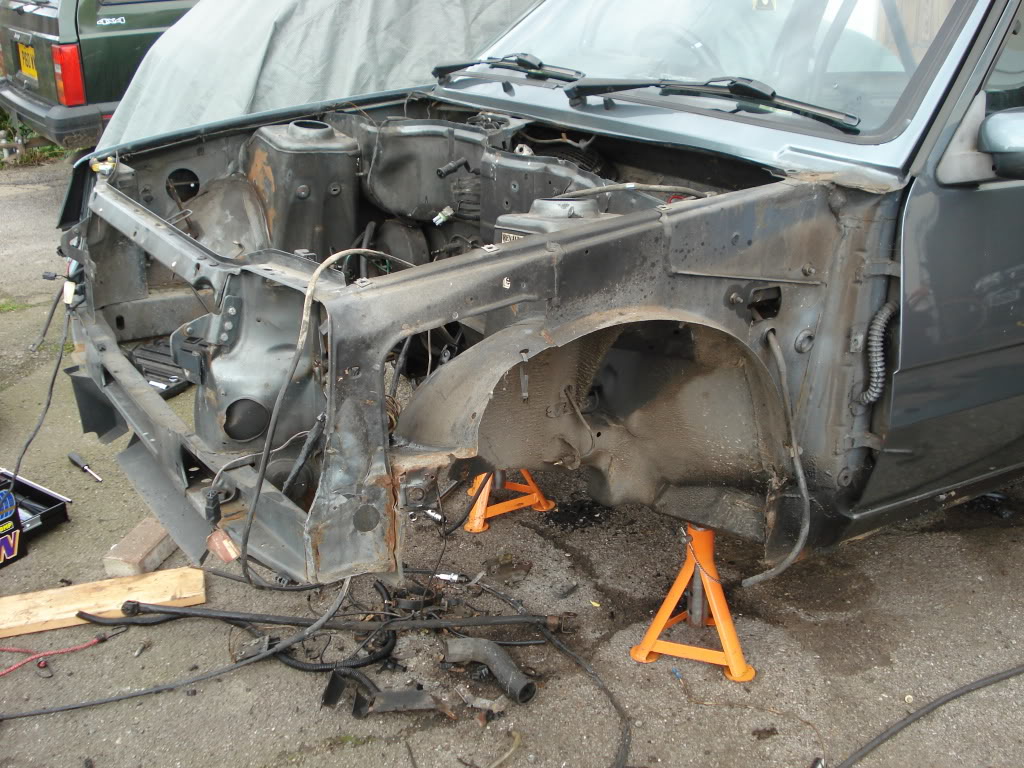

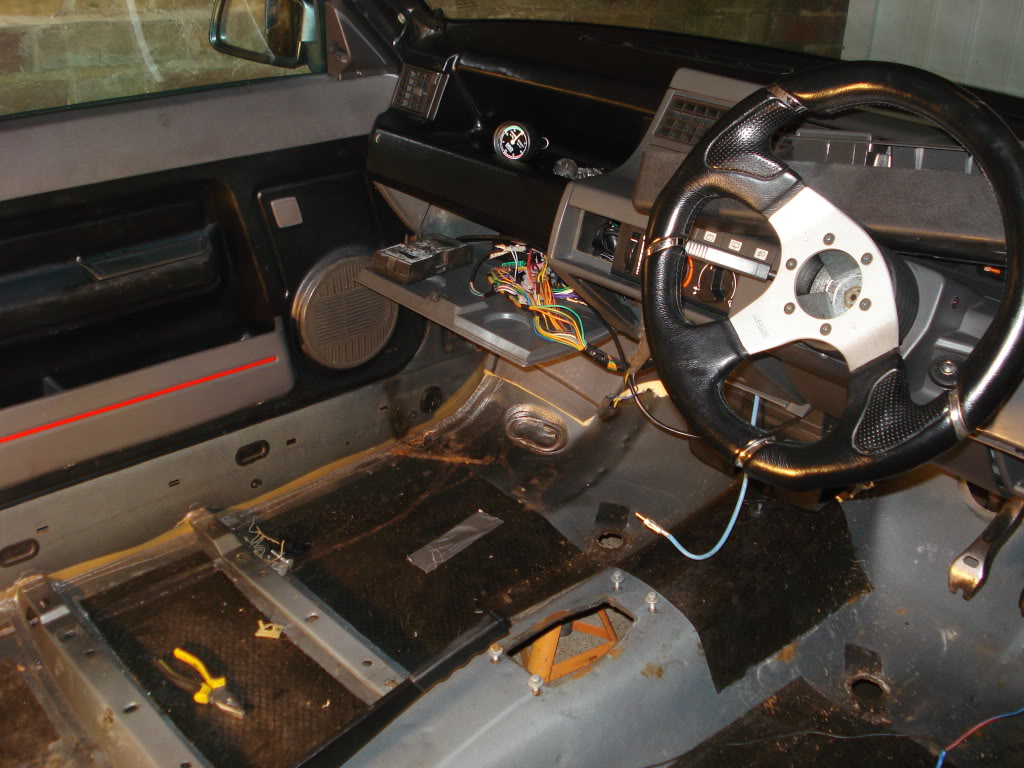

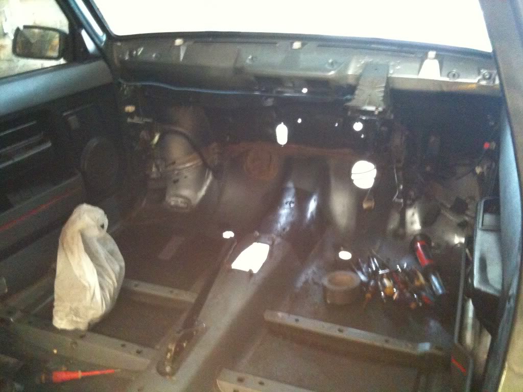

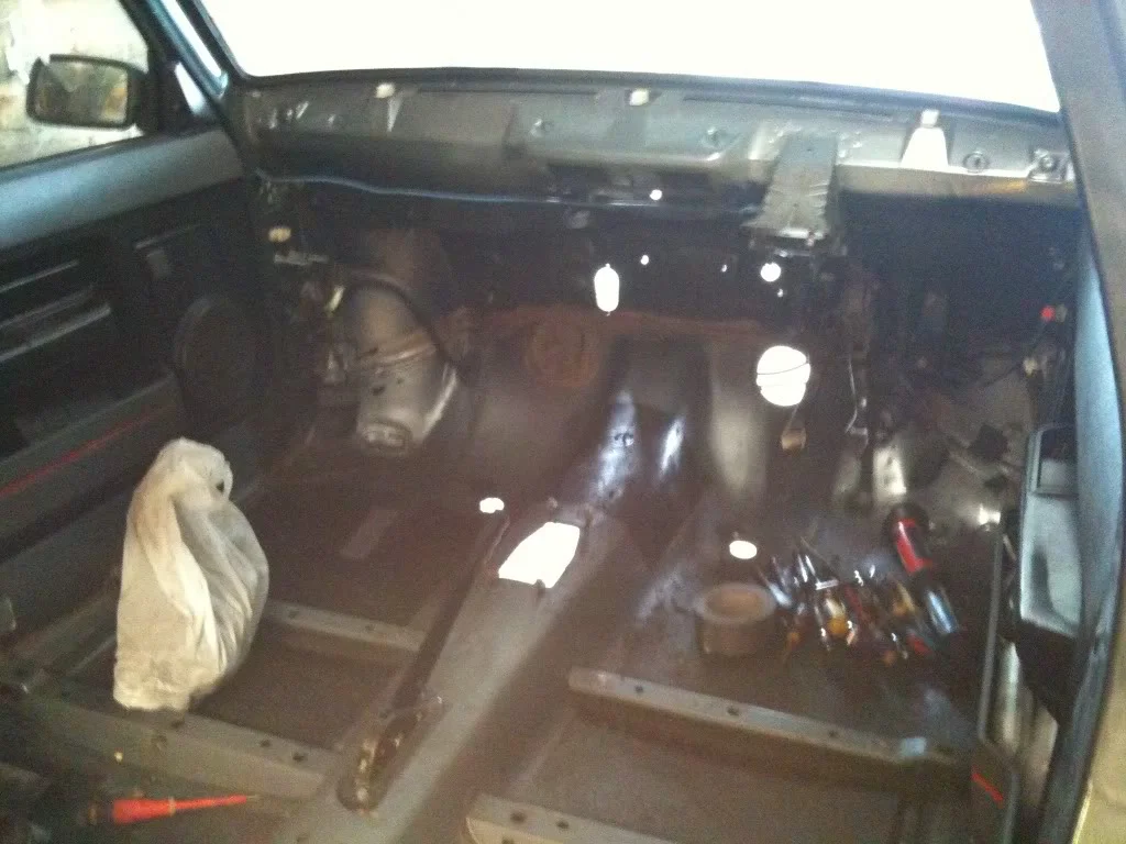

Day one - Interior out

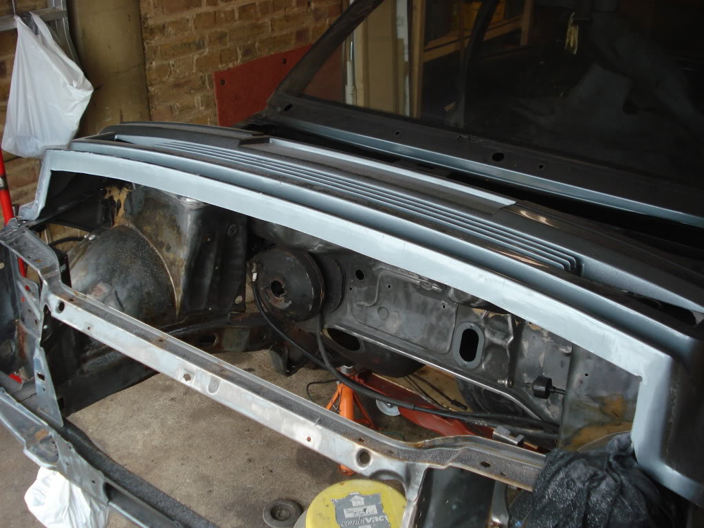

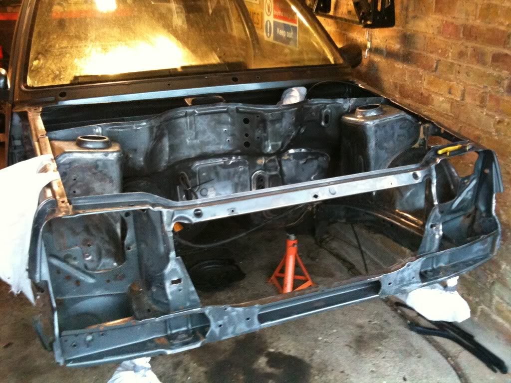

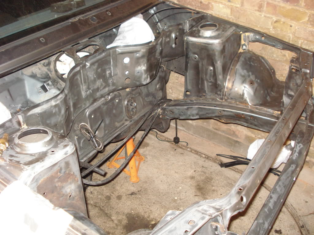

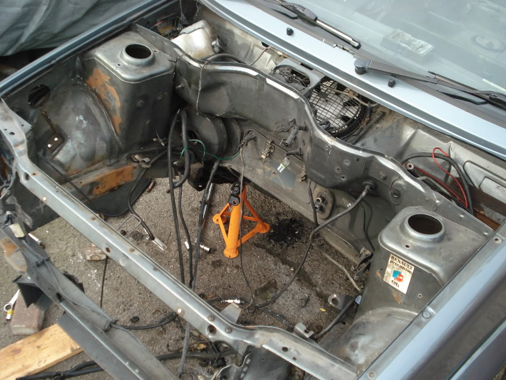

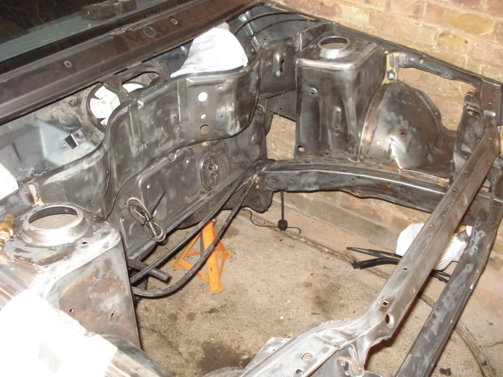

Day two - Engine bay

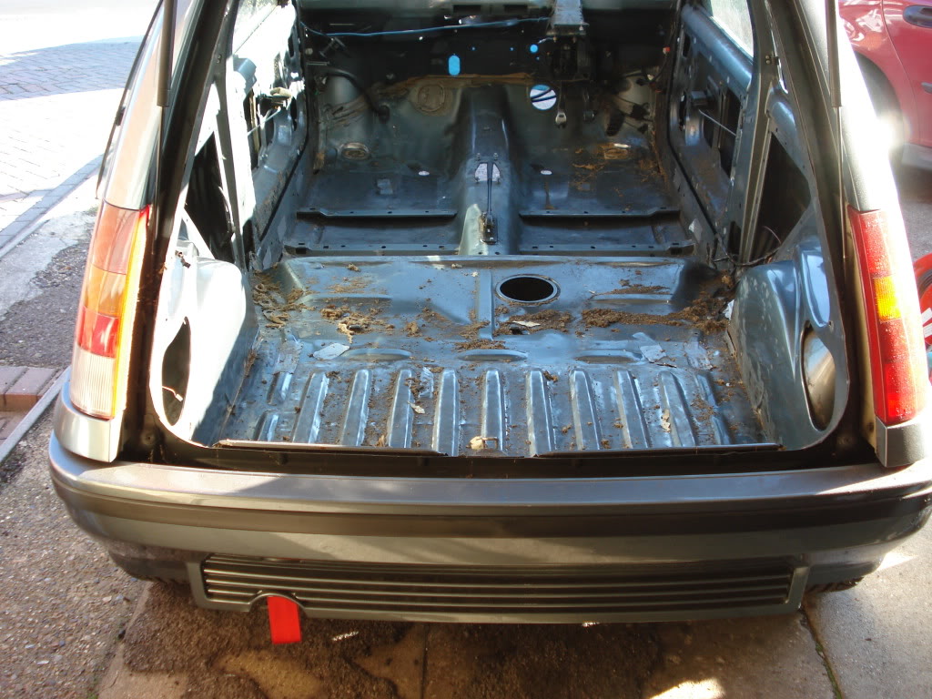

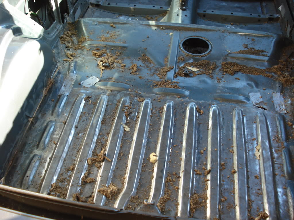

Day three - Got In the garage now and I managed to remove most of the seam sealer.

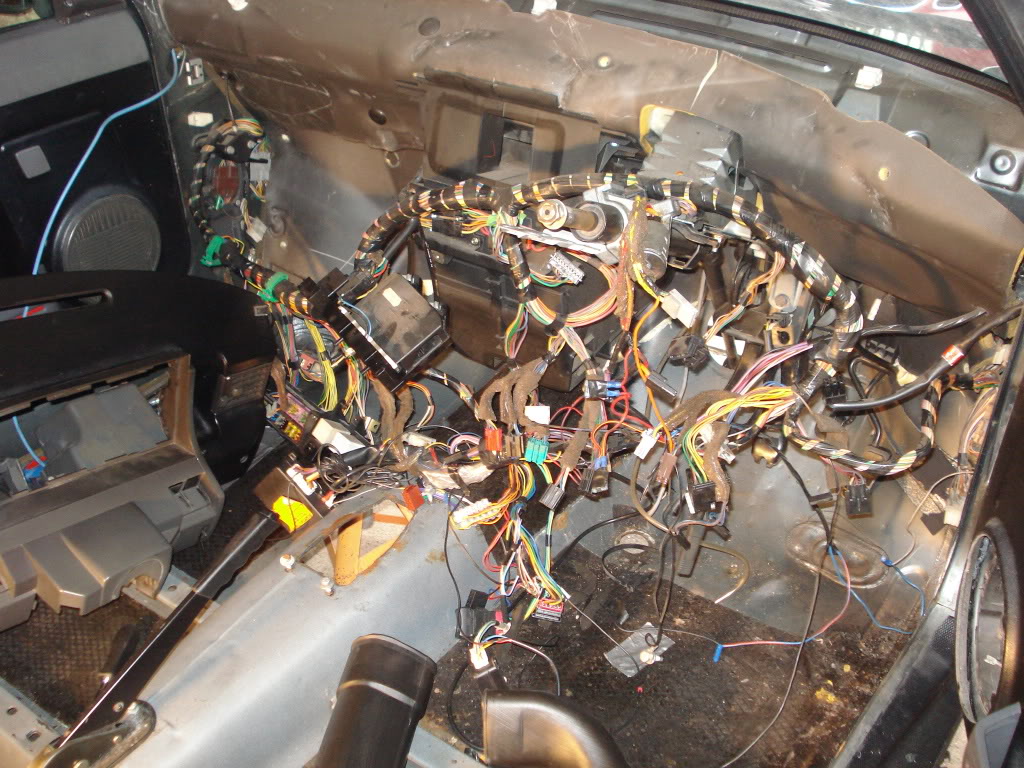

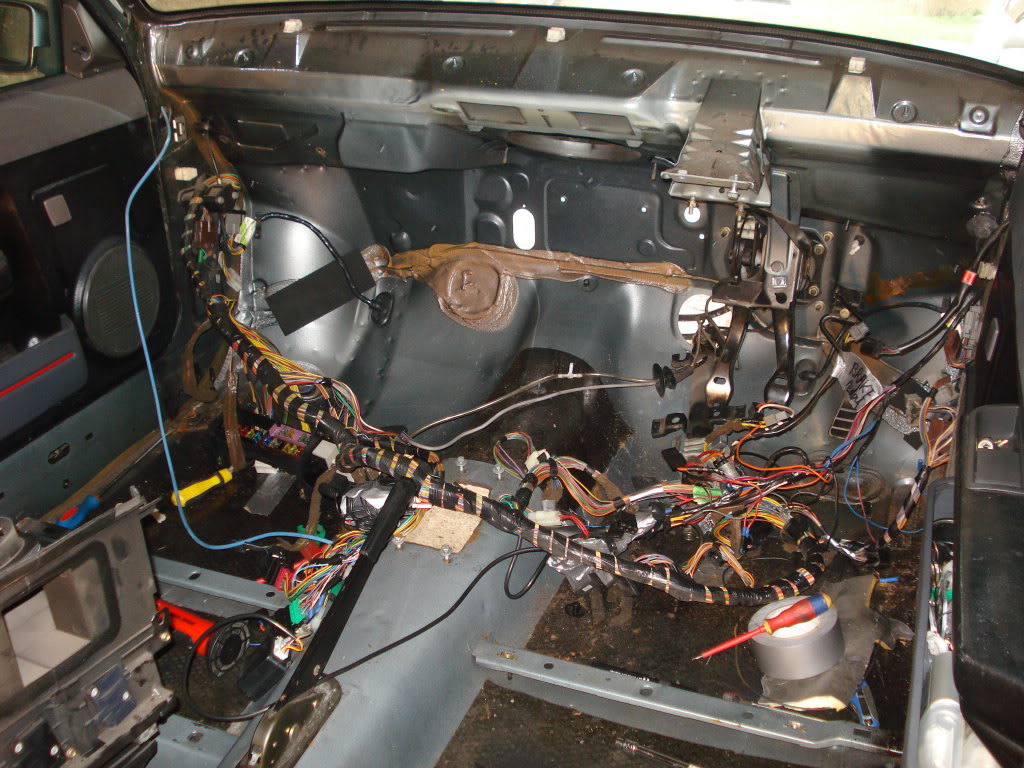

Day four - Carried on with the interior, Dash, loom and heater out.
Some help from Daisy.
So that's it so far, I've missed loads of bit's out like the 4 hours I spent scraping sound deading off one night, other panels, side skirts but all of those pictures are on my camera, as you can see these one are just the s**t ones of my iPhone.

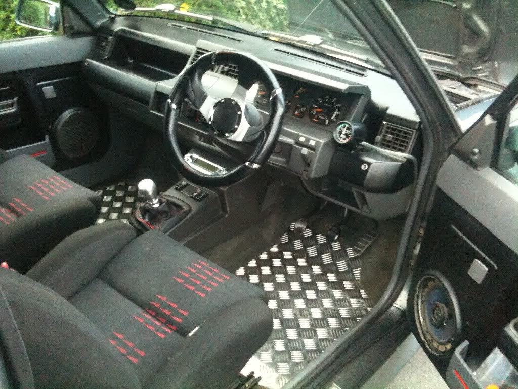

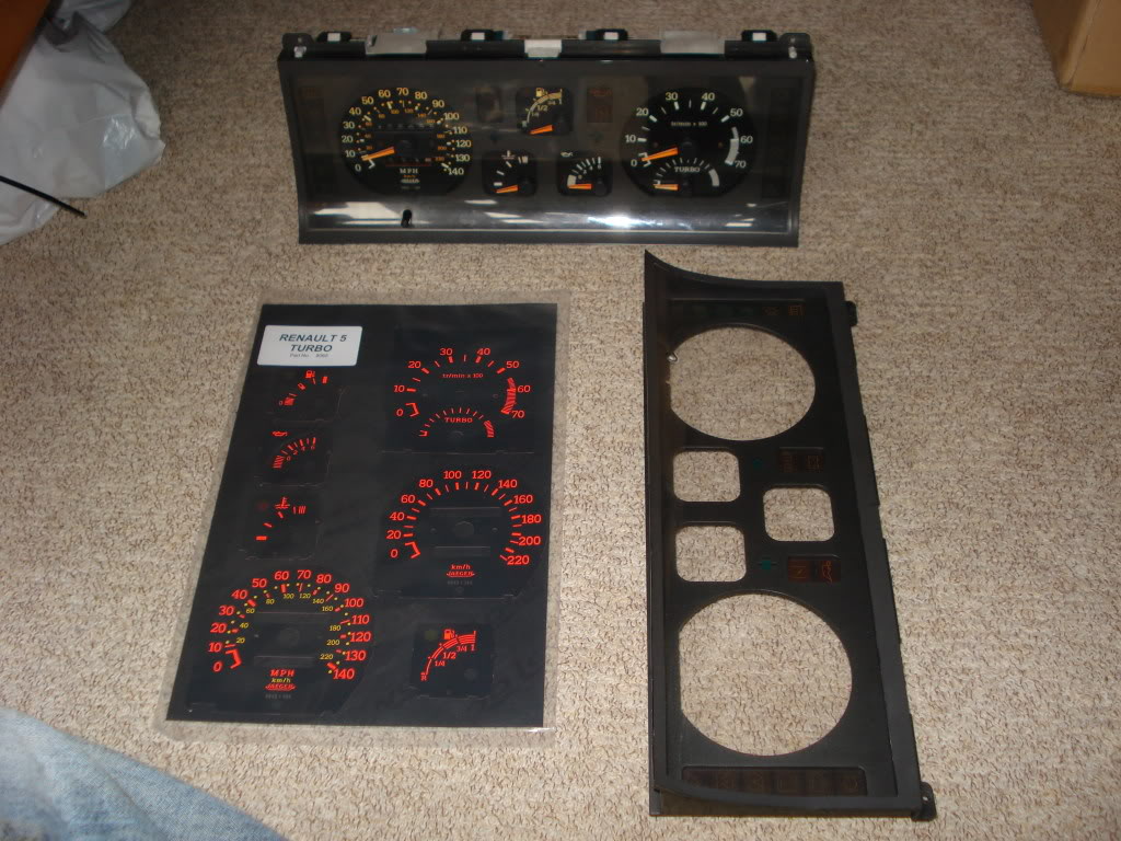

I bought some OE replica dails as it's really common for the faces to fade, especially after 20 years as you can see. Also a new clear plastic front as mine had a crack in it.

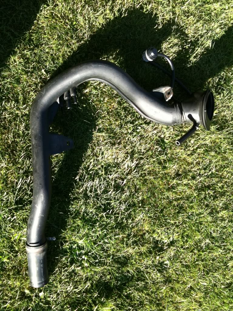

Bought a filler neck of a Renault 5 Campus to replace the second fuel tank found on the GT Turbo.

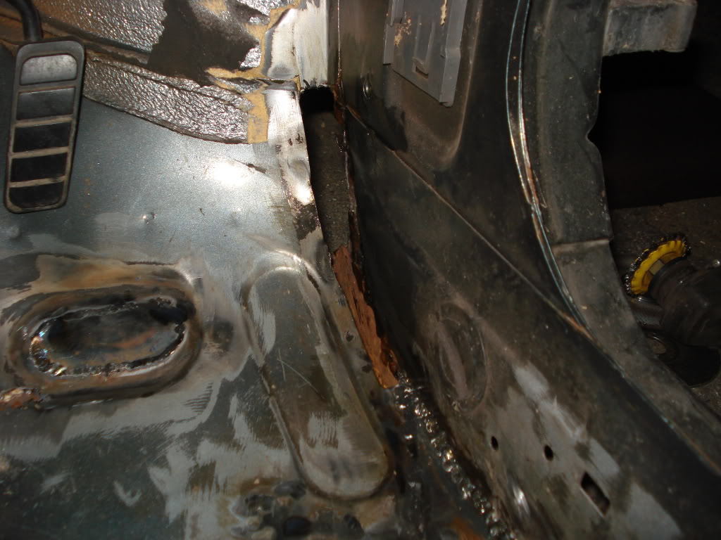

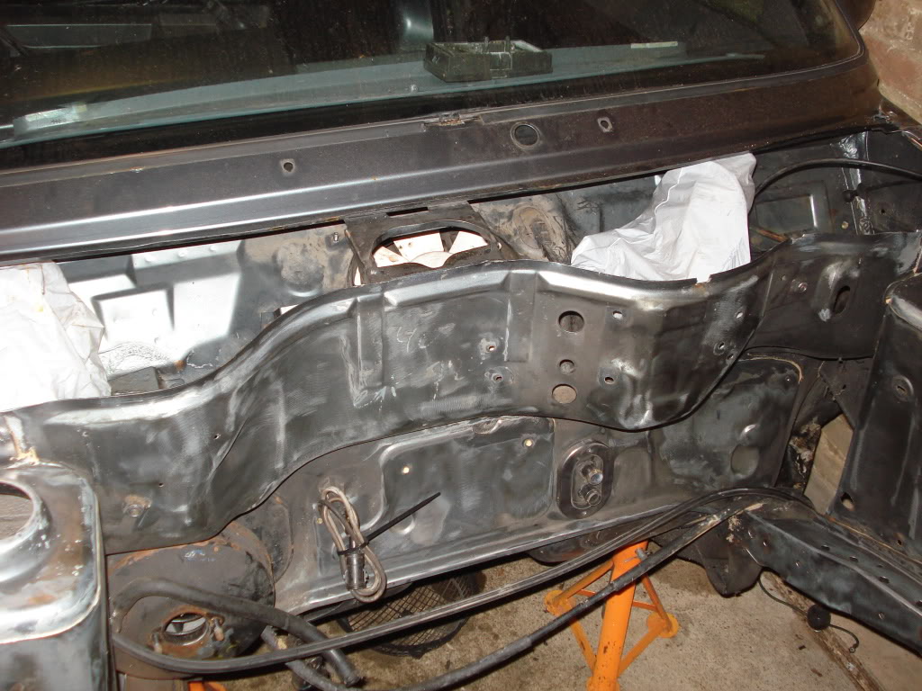

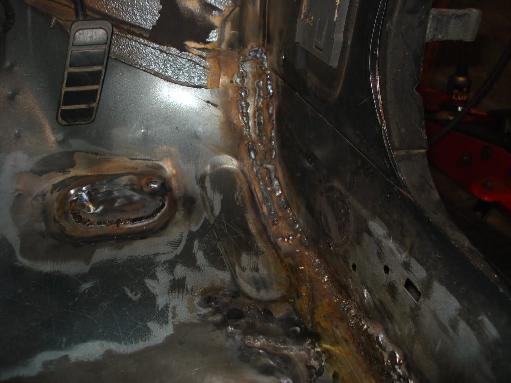

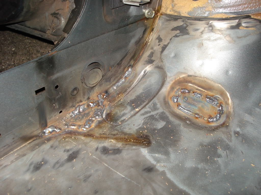

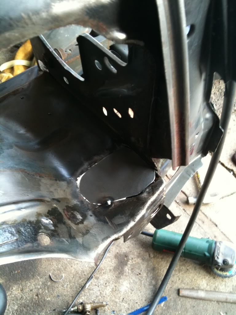

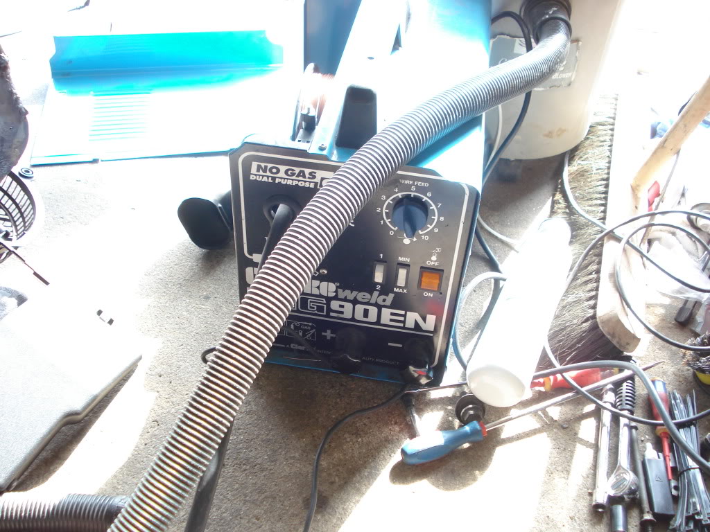

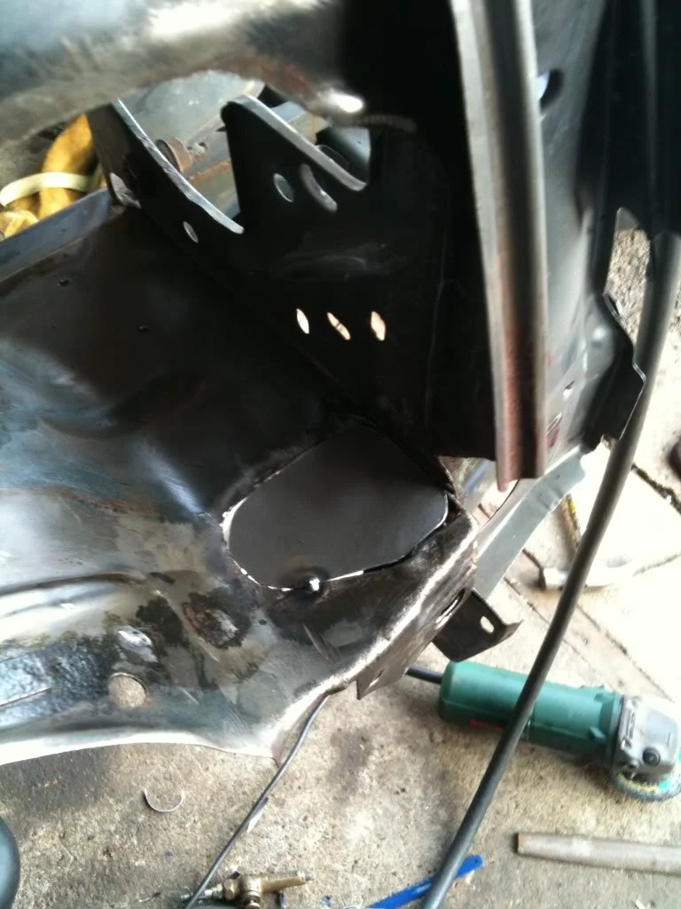

I borrowed a welder to patch up a few bits, Lovely gas less MIG. Not ! hardest thing I have ever used. That's why it looks like this :p
Carried on though and done a patch in the engine bay after using Kurust on it.

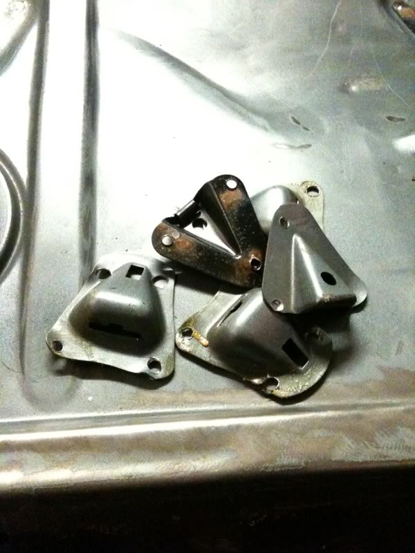

Also lost the last of the seat brackets.

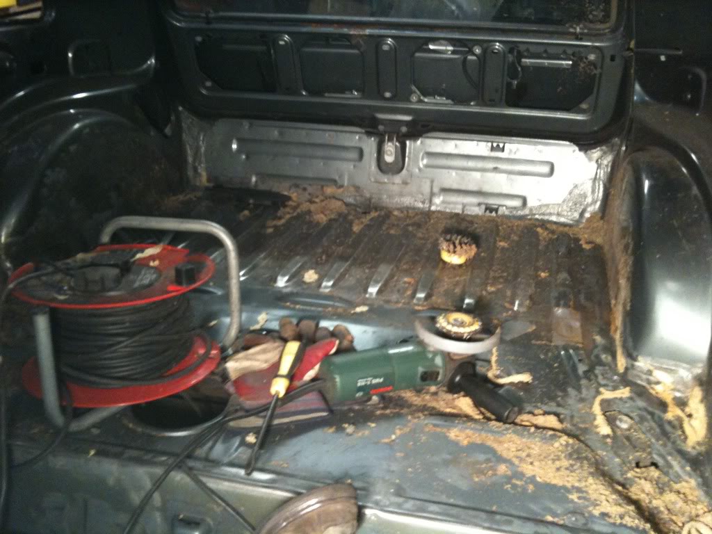

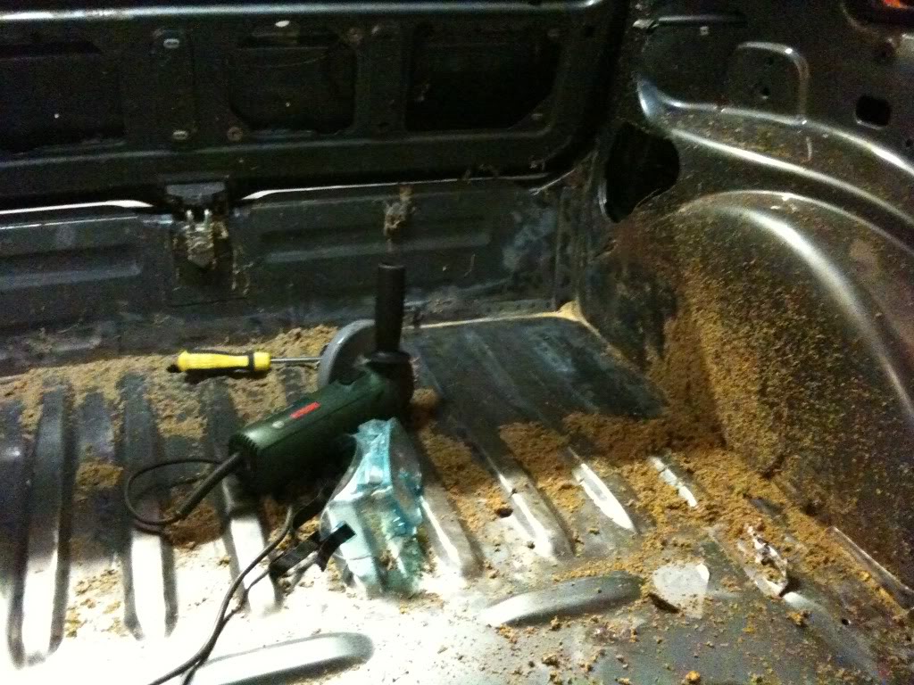

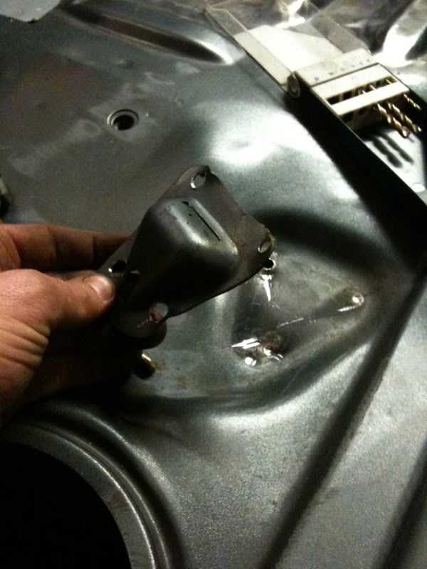

Finally moved onto removing more of the seam sealer.
This stuff makes such a mess and get's everywhere.
And that was my weekend, again missed so much out but I will try and get the camera pictures up soon.

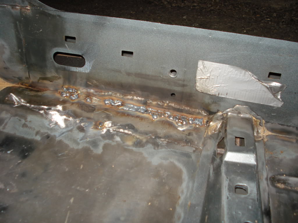

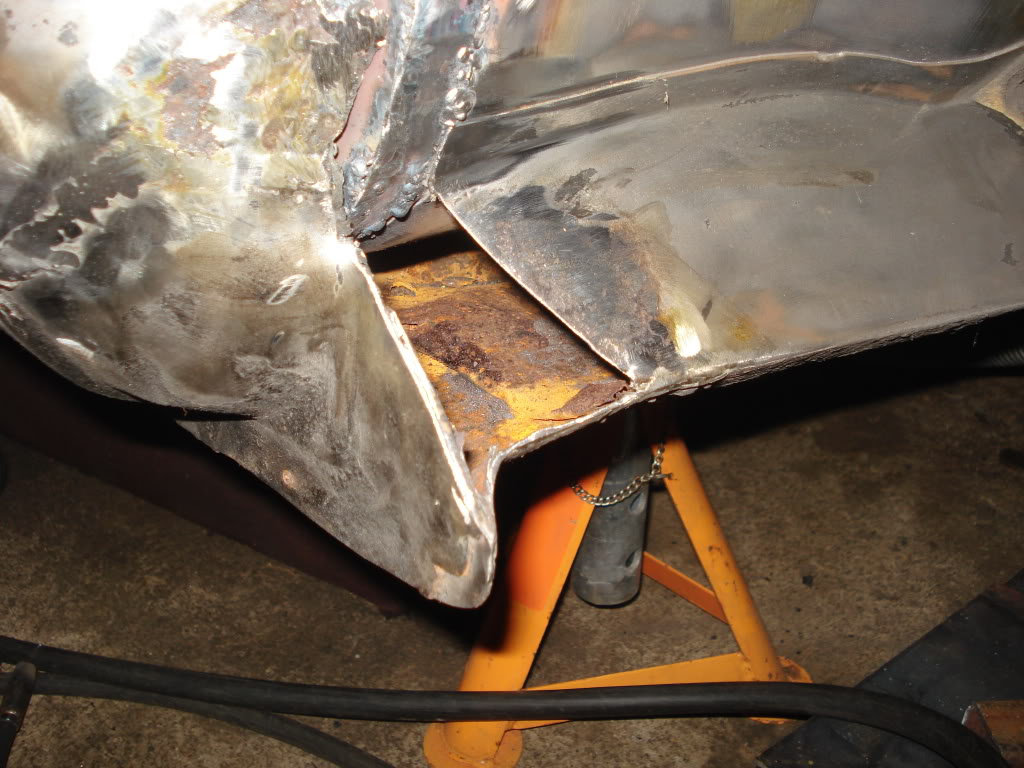

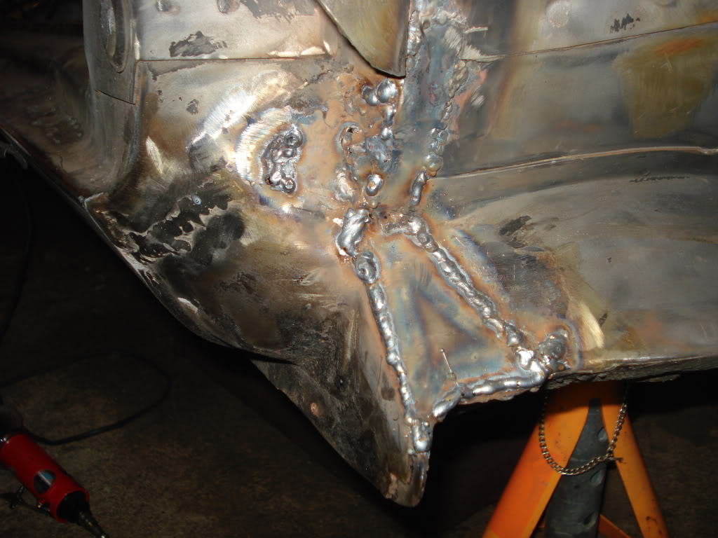

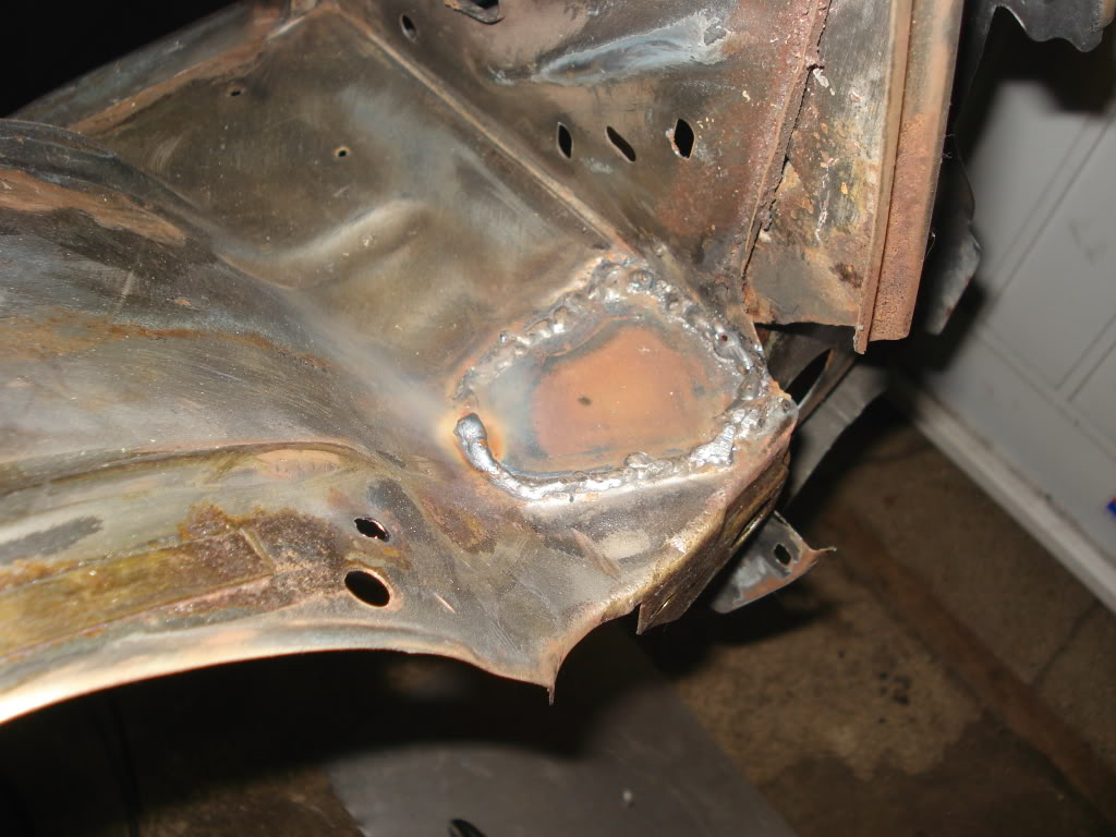

Done some more welding with the worlds worst welder I borrowed.
The weldings not the best, But I will be grinding most of it back.

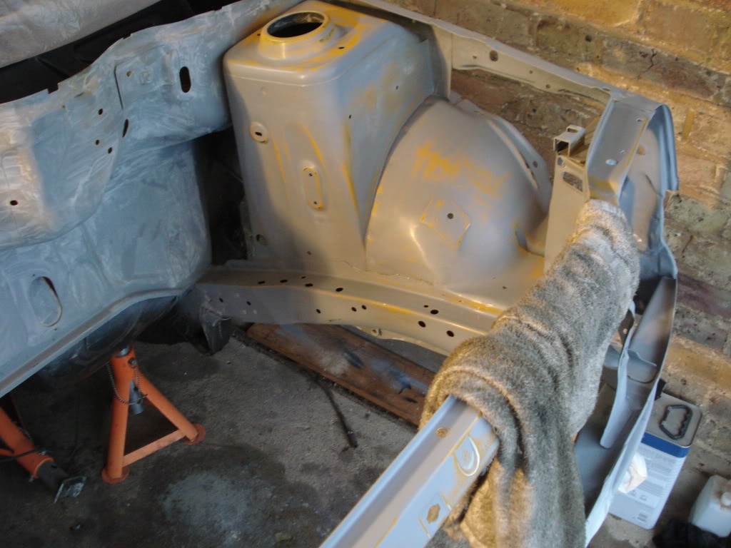

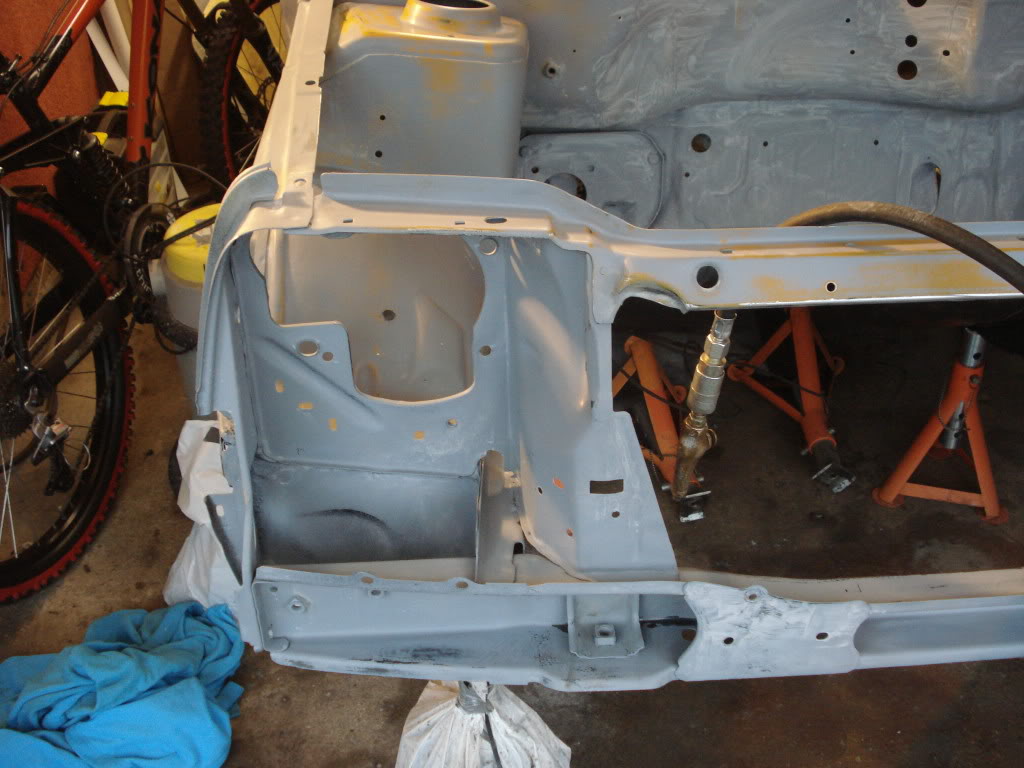

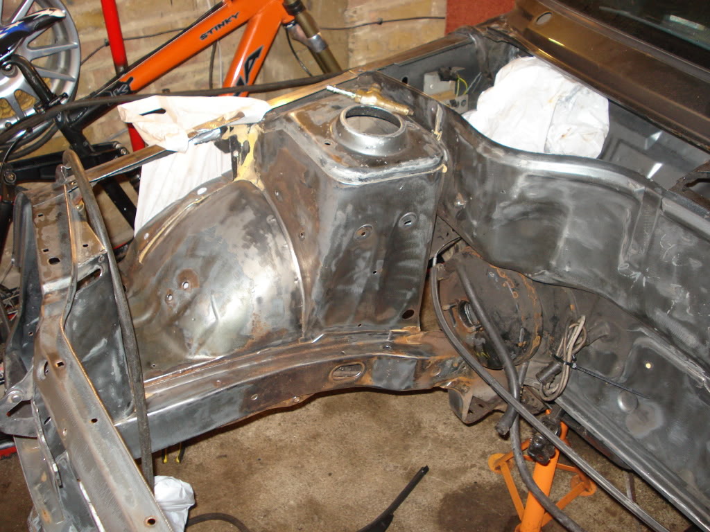

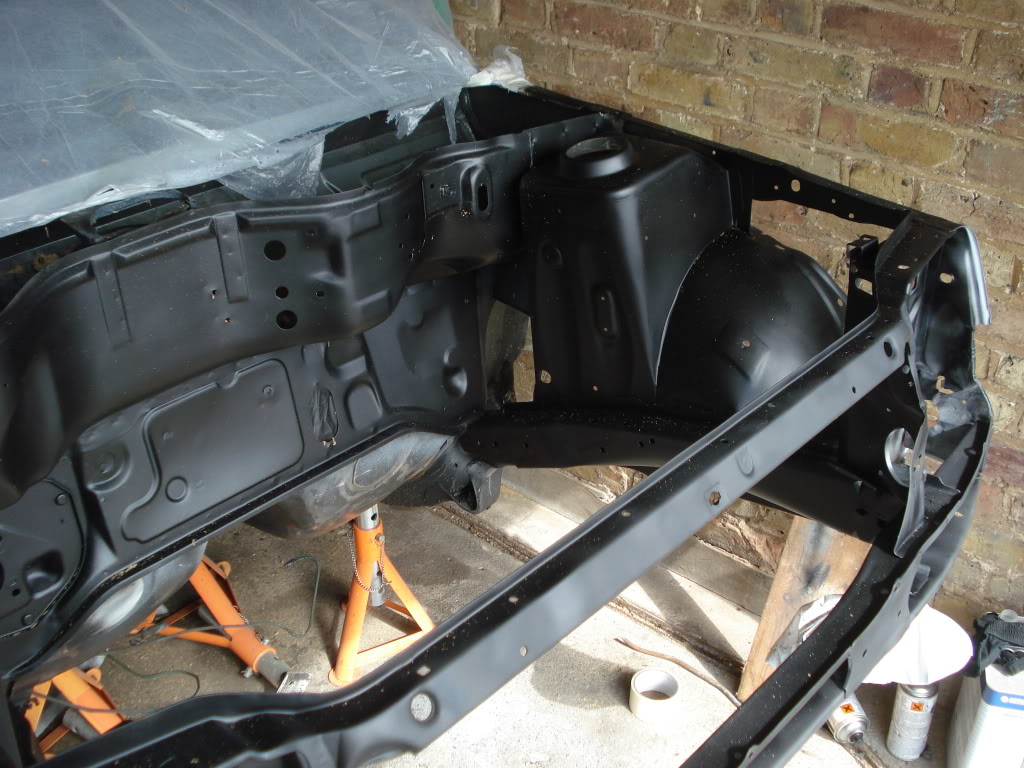

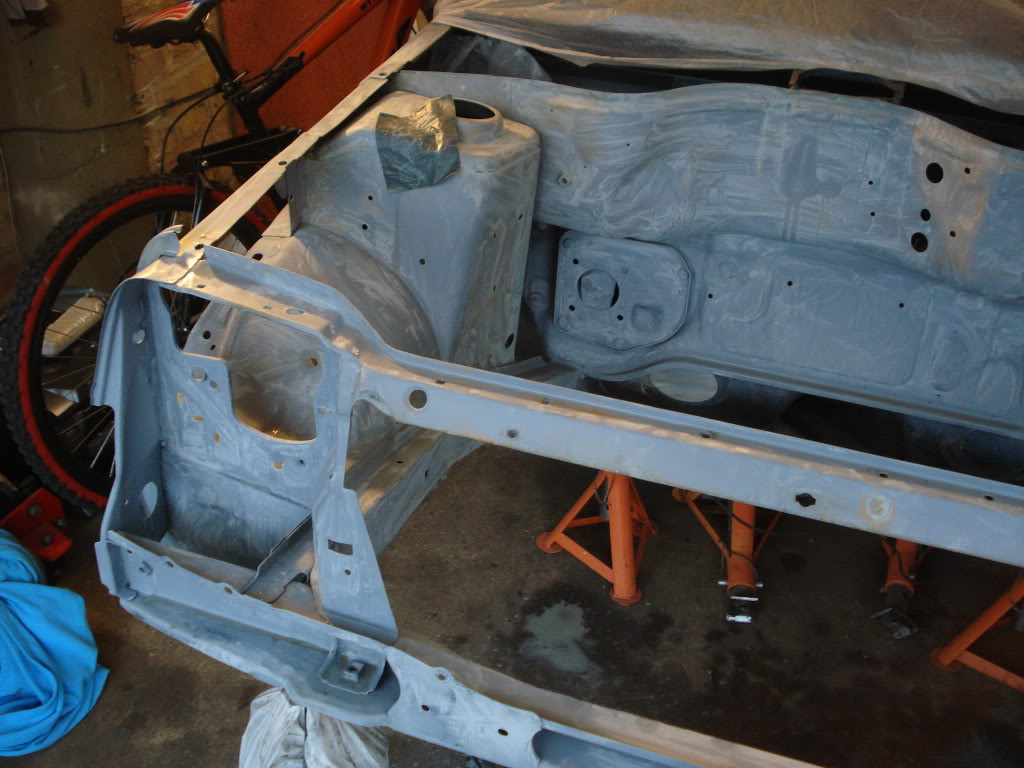

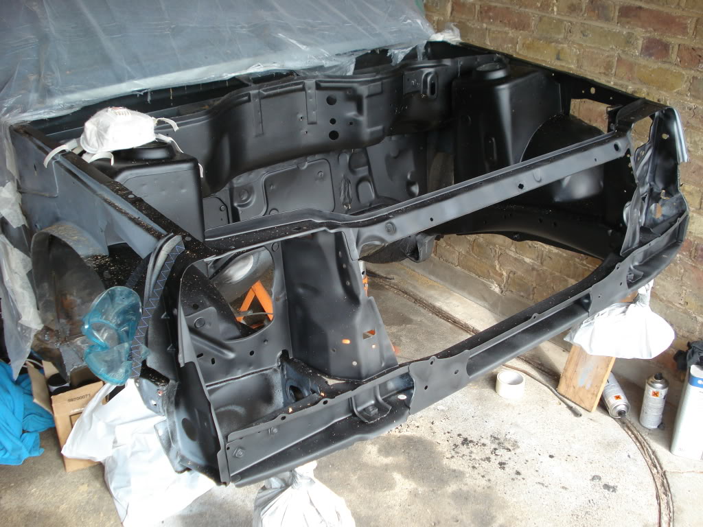

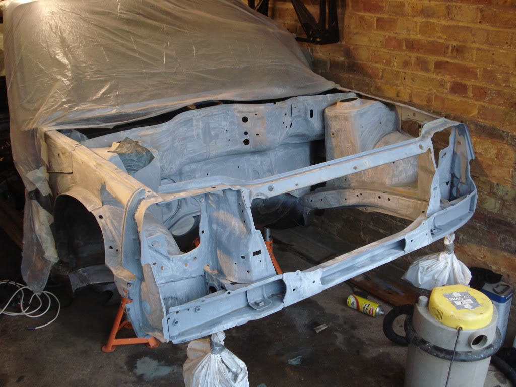

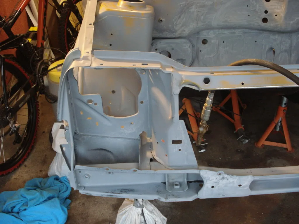

Got the most of the front end in paint now. It was going to go to the body shop to have the inside and engine bay painted gloss black, but time is tight before Mallory Park so I decieded to do it myself. I was given 6 can's of Ford matt black for free so thought why not, It was only meant to be a quick job to protect it from surface rust, but you can't seem to ever do a quick job on this car. :rolleyes:
The yellow stuff is filler primer, then hi build primer on top.
1200 grit wet n' dry

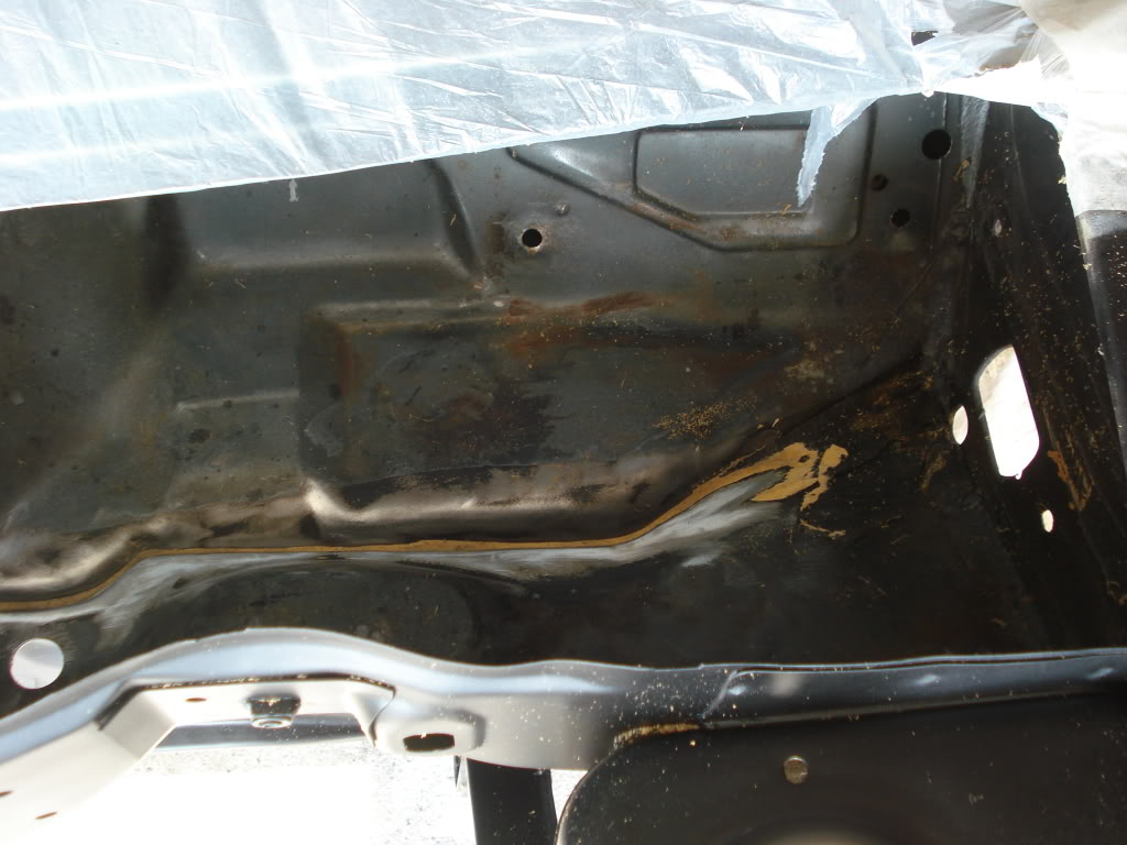

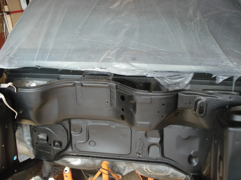

Cleaned down the surface with some panel wipe

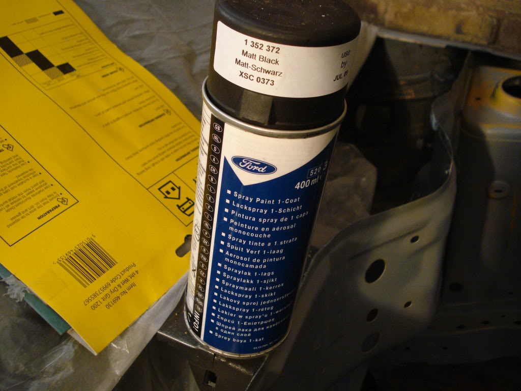

Matt blacking, the bits little bit you see are seam sealer that flicked up as I took the pictures later in the day.

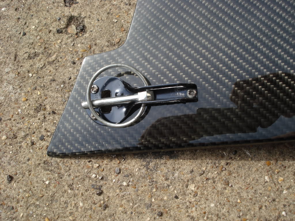

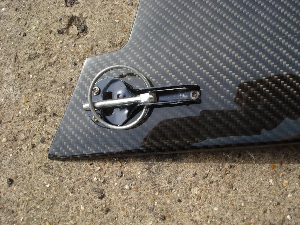

As I'm running bonnet pins on the carbon bonnet I cut away the catch.

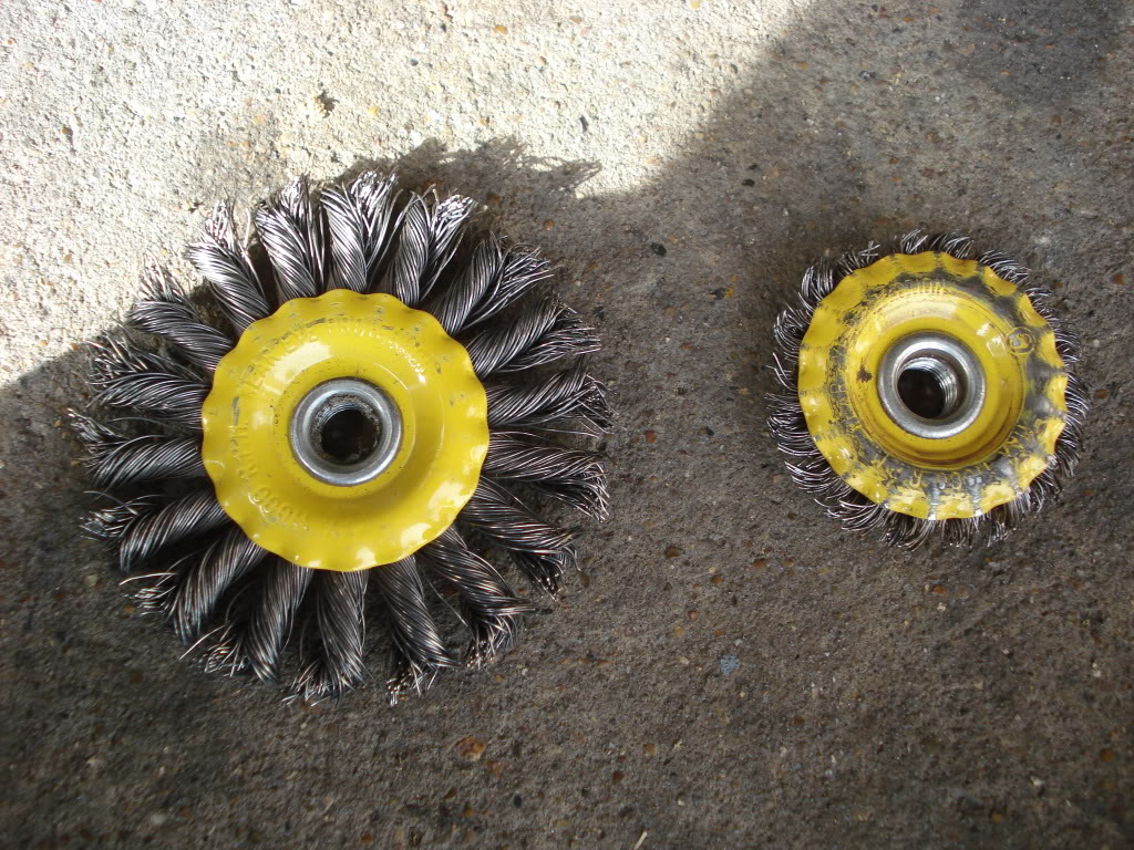

Wire wheel disc after about 6 hours use :p

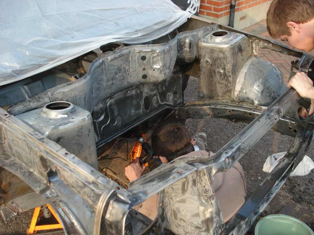

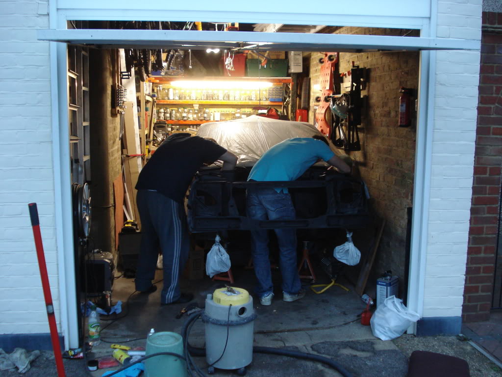

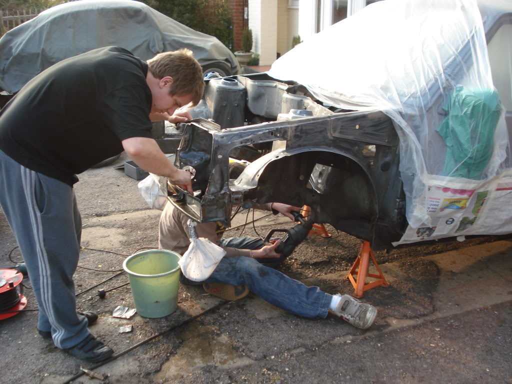

Mates turned up so got them to sanding and scraping on evan more seam sealer.

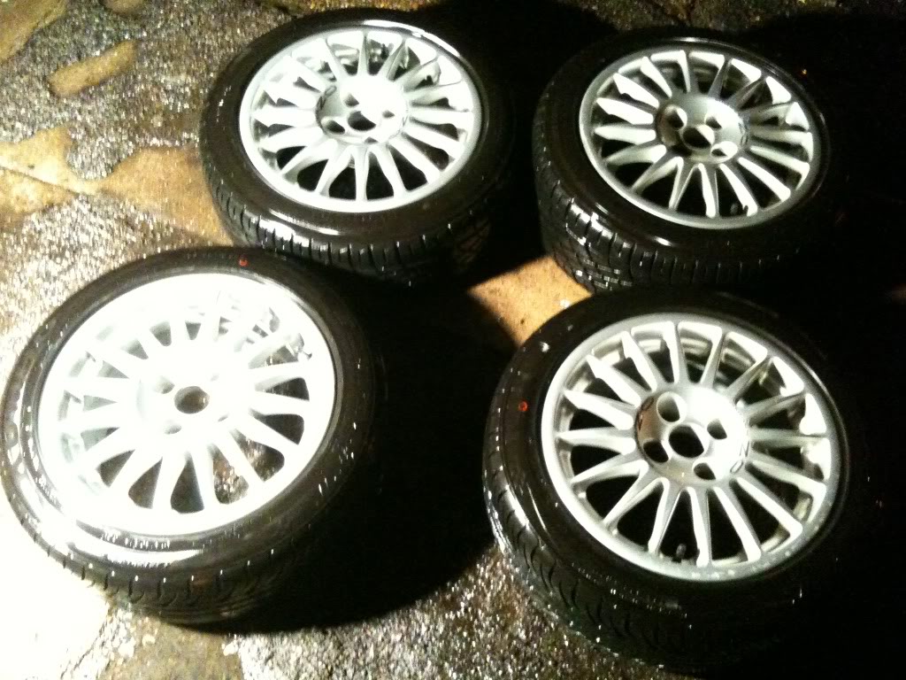

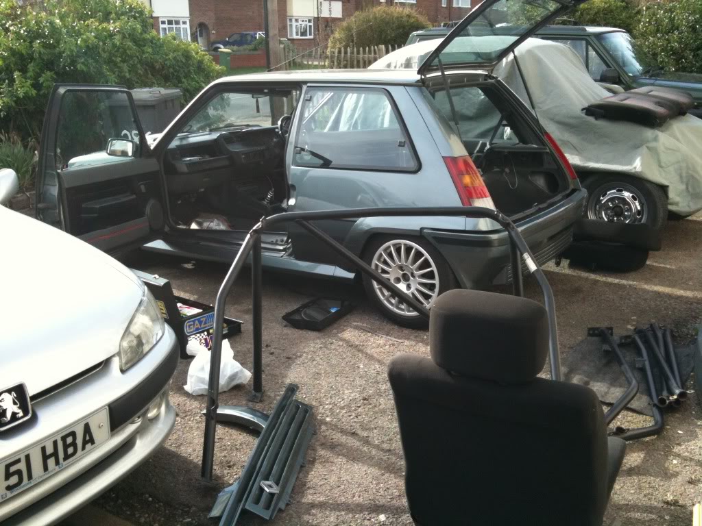

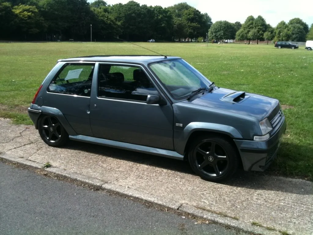

I got bored at this point, So I put my 15" OZ wheels and my mates Clio 182, Coilovers want winding down now though.

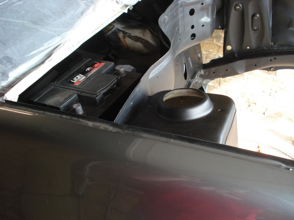

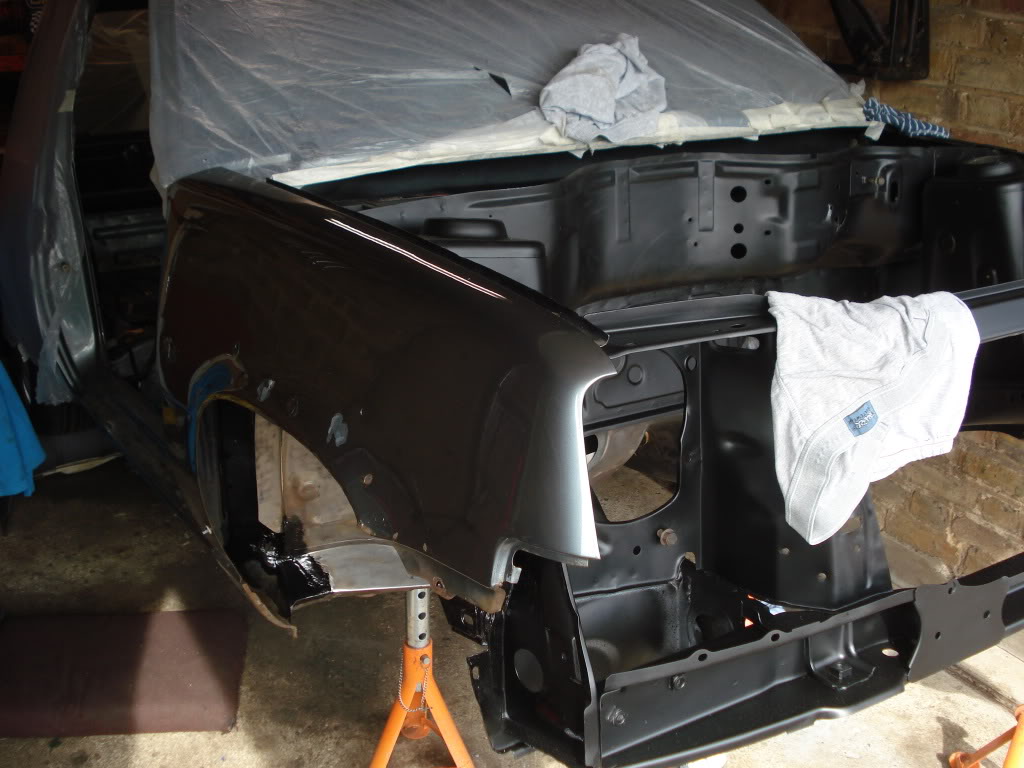

Painted most of the front end now and trail fitted the front wing.
Then gave the bonnet a clay, polish and cleaned the catches.

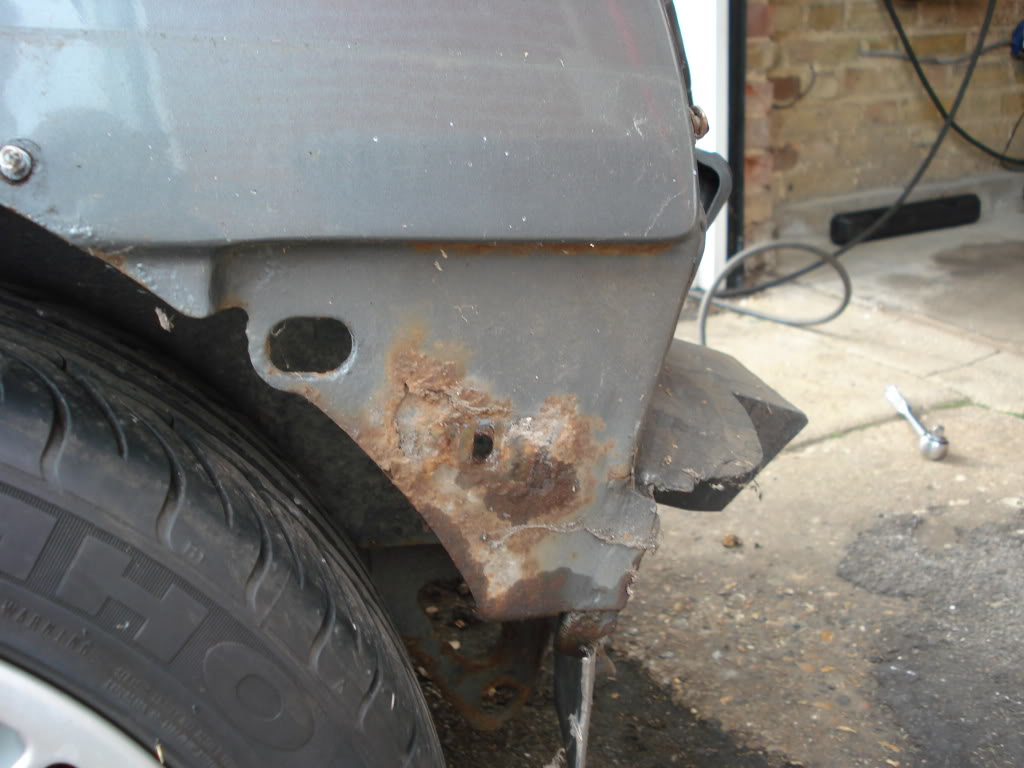

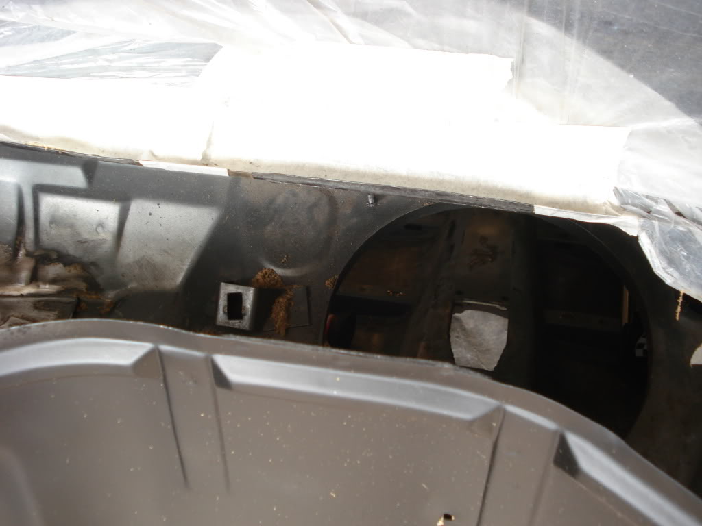

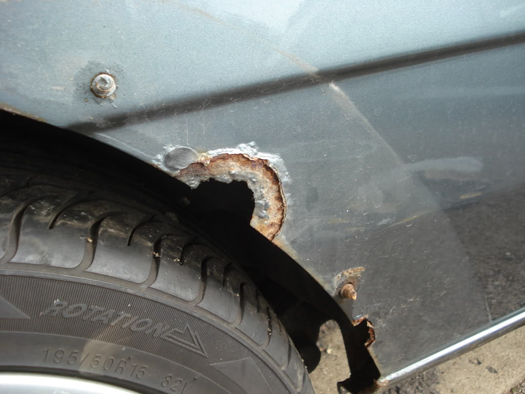

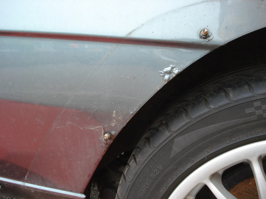

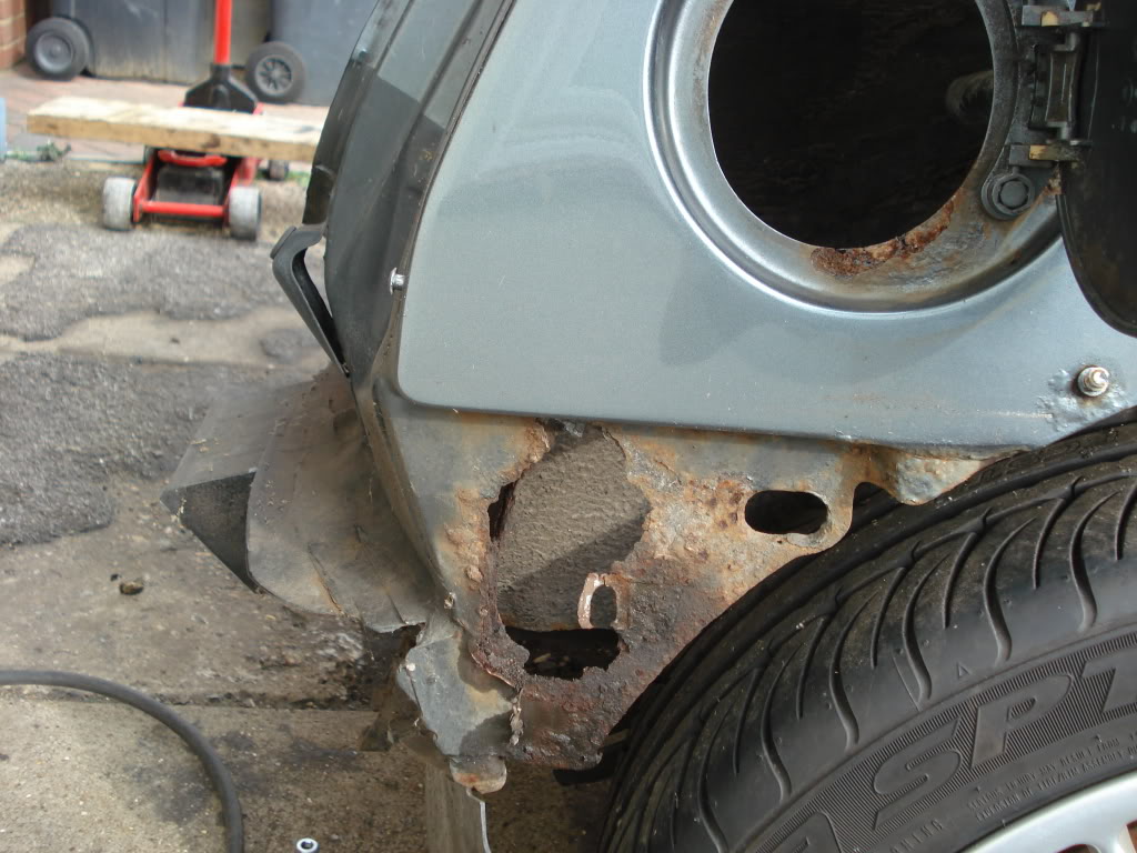

Had some pleasant surprises when I took the rear bumper and arches off though :crap:
Wasn't happy at the weekend and really wanted to through the towel in with the whole project, it's just turning into such a big job ! Wished I had just bought a newer car something like clio 182.

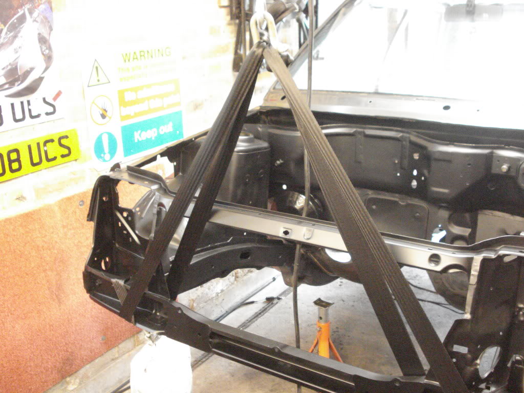

Next day I got the car back out and winched up the front end ready to do the underside.
And that's how it still stands. :)

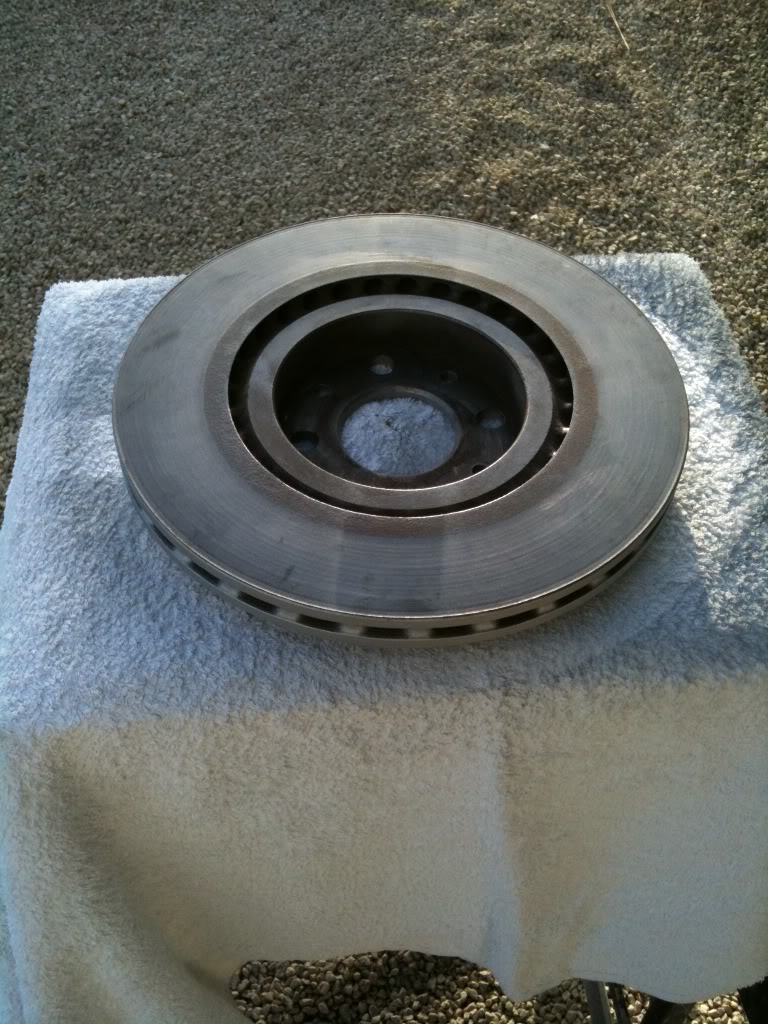

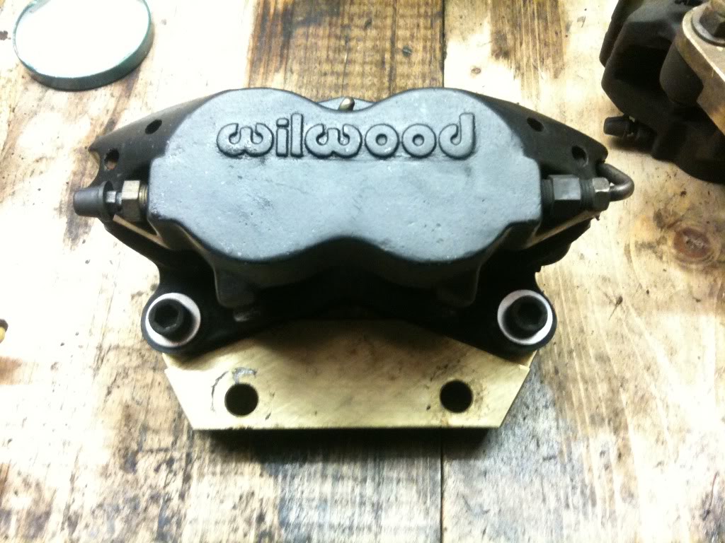

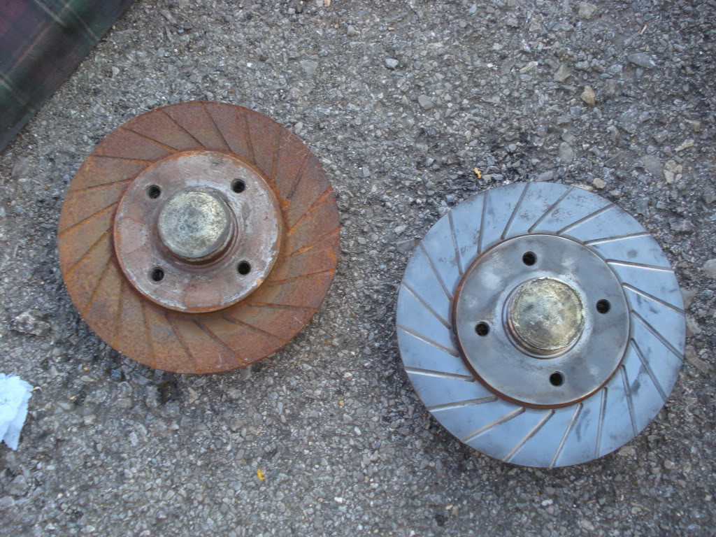

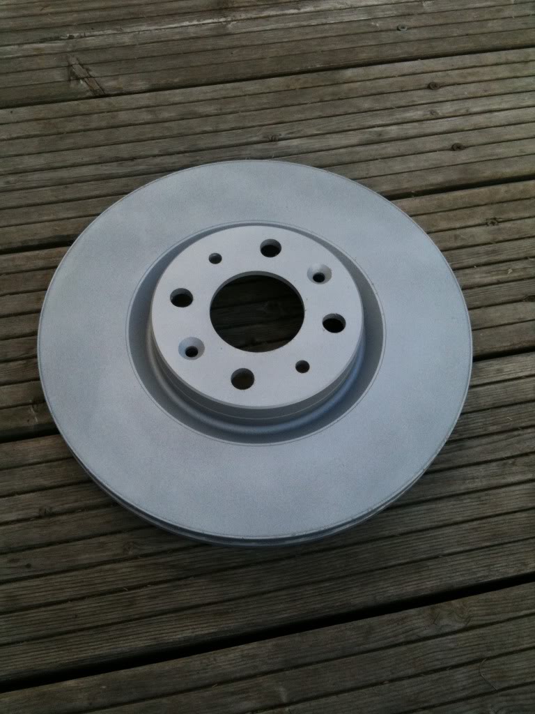

I did get my willwood disc's painted though, as they have been sitting around the attracted some surface rust, and rusty disc's do look **** !
Rubbed them down lightly with the angle grinder wire wheel, then gave them a light coat of very high temp paint (the pads will just wear off the paint on the face)

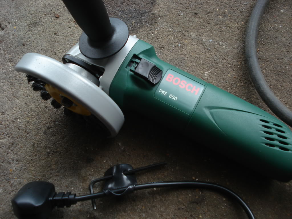

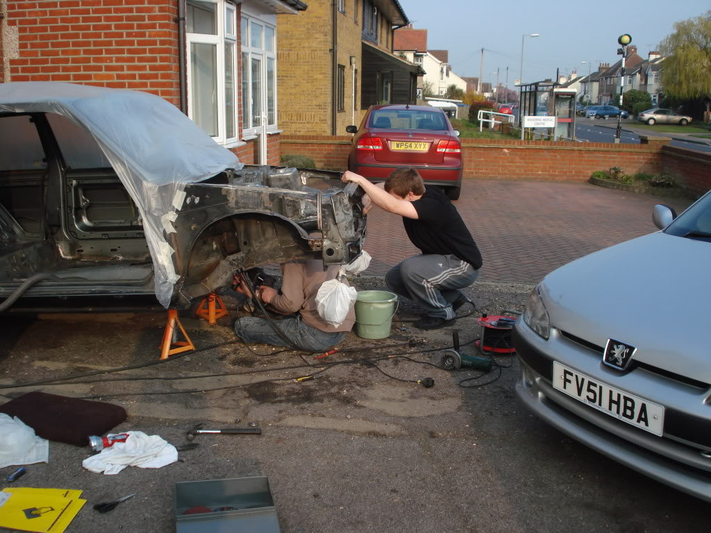

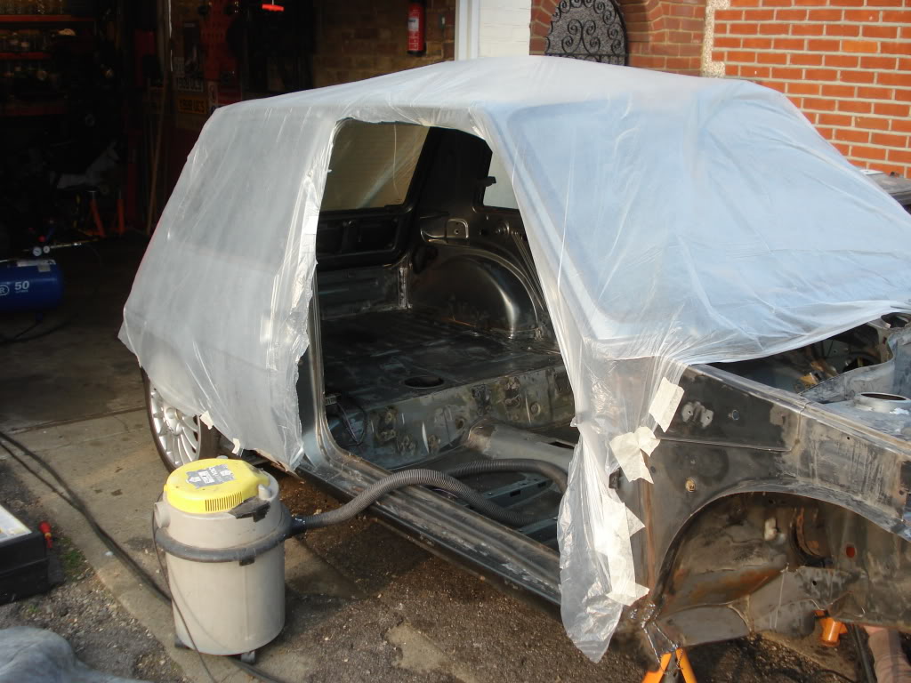

Stared the job today I have been putting off for the last week, wire wheeling the underside of the car ready for underseal !
I had to go and buy a new grinder first as I killed the last one.
http://i910.photobucket.com/albums/ac305/LewisCunningham_badass/Grey%20Renault%205%20GT%20Turbo/DSC03708.jpg[/IMG
Holding the grinder in the air for any length of time kills your arms, so kept stopping and done some other jobs

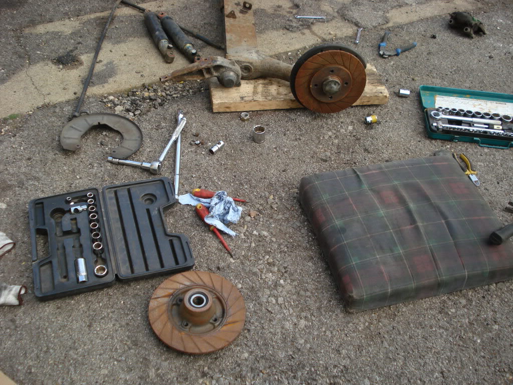

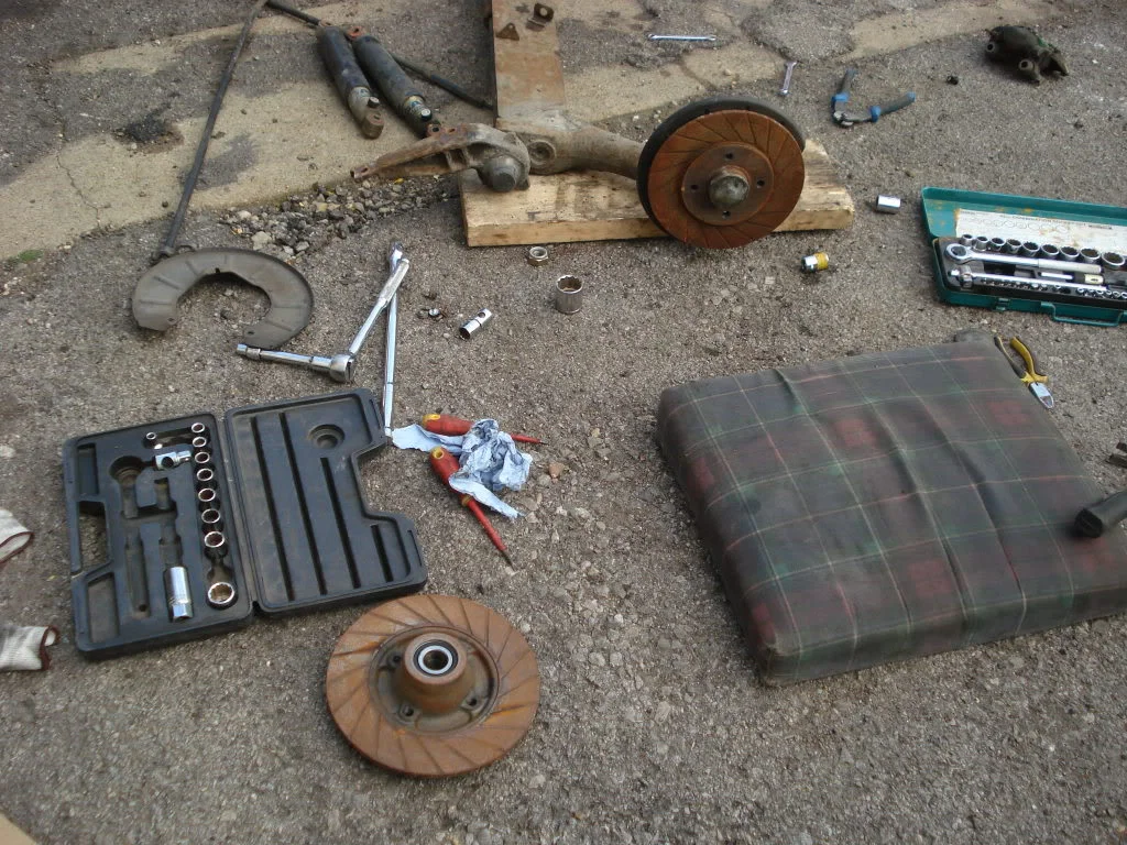

Stripped down the rear beam

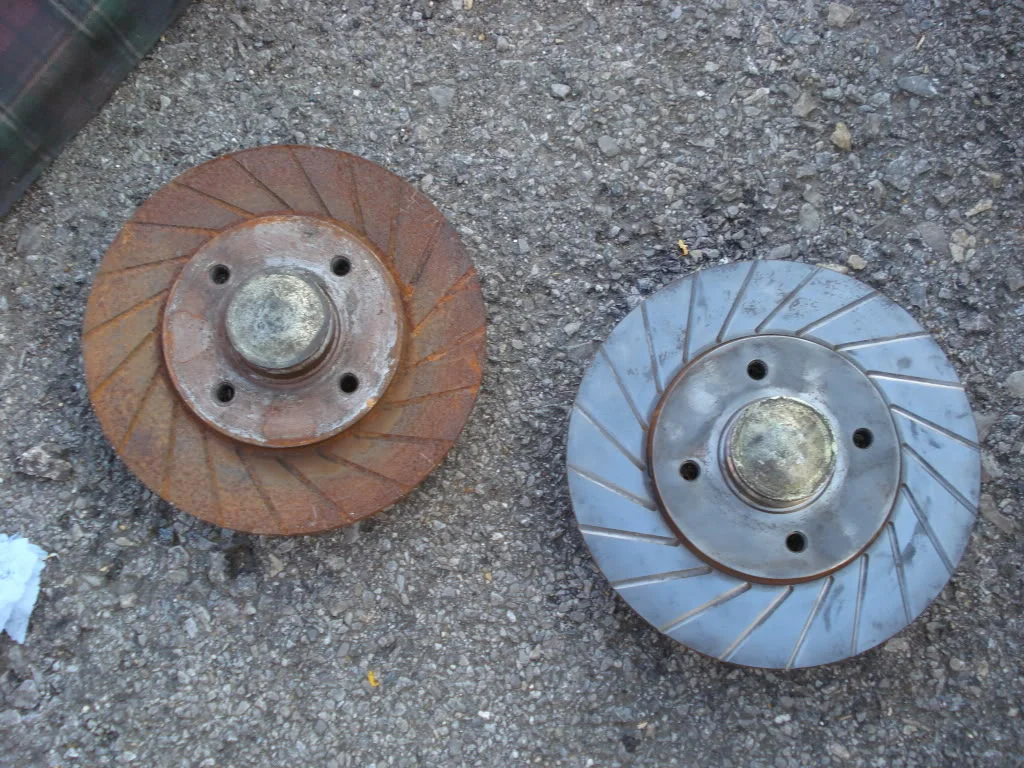

Cleaned up the rear disc's ready for painting like the front ones, They look s**t and eat through pad with the grooves In, but I might as well get some use from them before getting new ones.

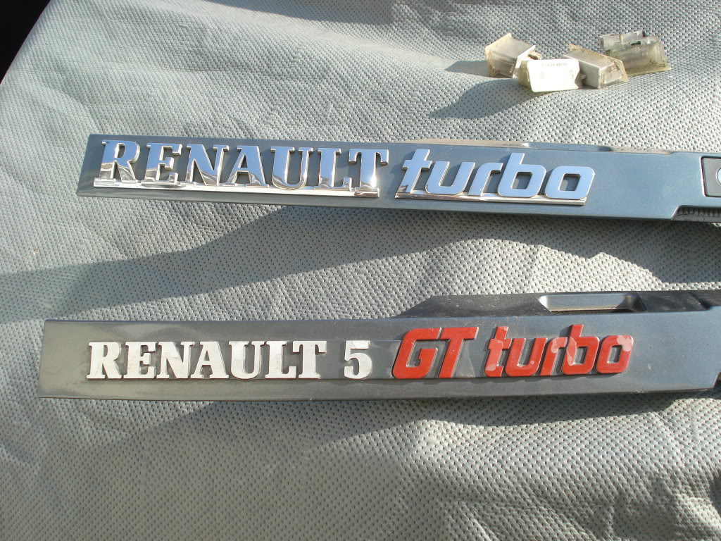

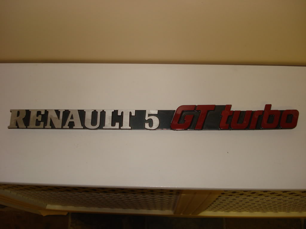

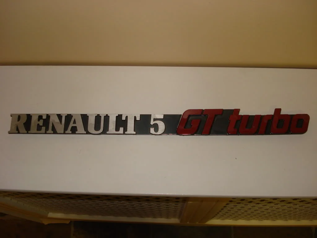

Also took the bottom of the boot lid off as I wanted to change the badges over to an original one I had on my other car, the cars are different shades so I can't just clip the other strip back in.
[ATTACH=full]786660[/ATTACH]
It does have some laquar peal but I'm not sure what I'm going to do with it yet, as I don't really want to paint it.
[ATTACH=full]786661[/ATTACH]
I made a right mess taking the old badge of as it was all bonded on. It's going to be to visible with the new smaller badge fitted, so I't really needs re-painting. The problem Is, the paint is a non OE paint and a mix of a few different colors so will be really hard to match. I think I'm just going to do it gloss black for now or get it carbon wraped to kinda match the dark black bonnet. :/

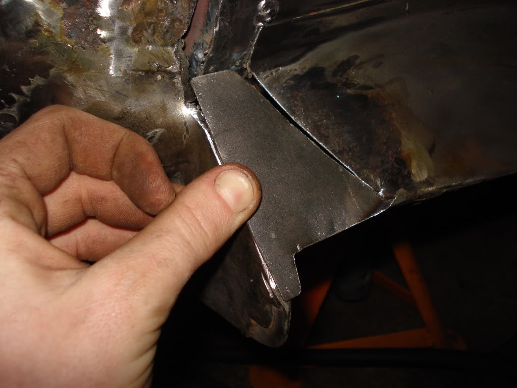

Then Cut away some more unneeded weight, also the rear compensator bracket andd spare wheels cage hangers.

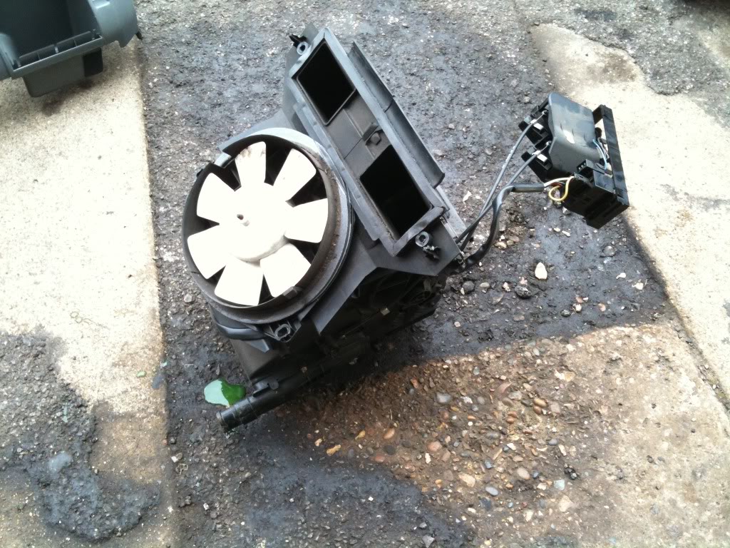

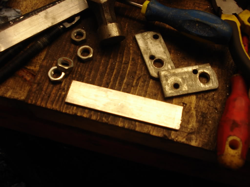

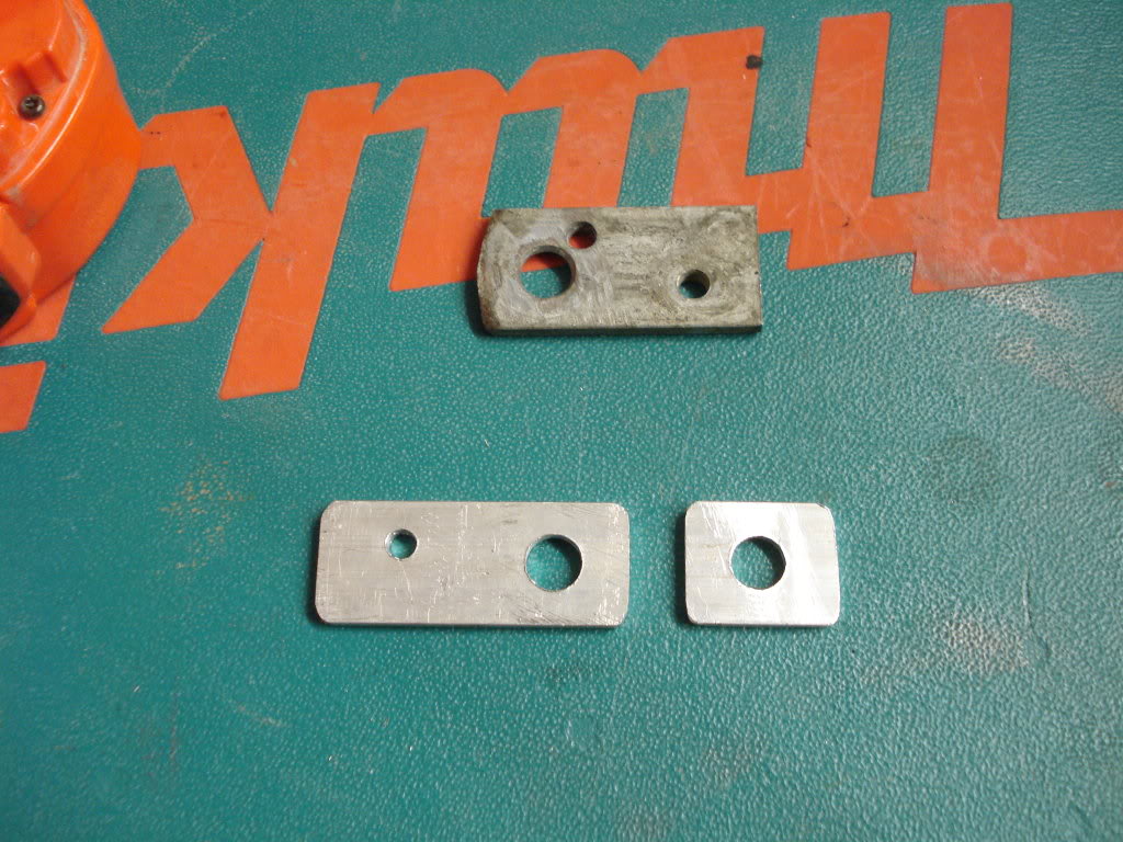

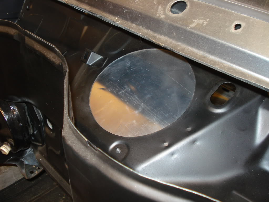

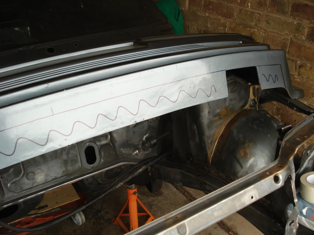

As I wont be running a heater, I filled in the hole's for the fan and heater matrix will some thin aluminum sheet.

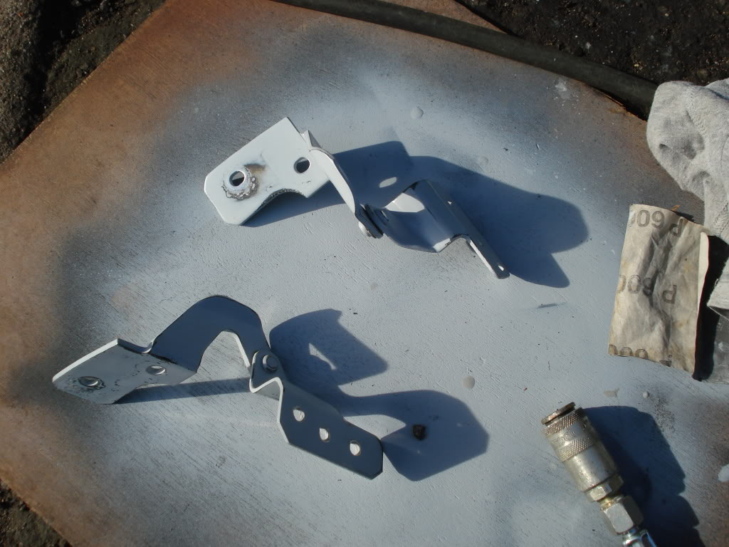

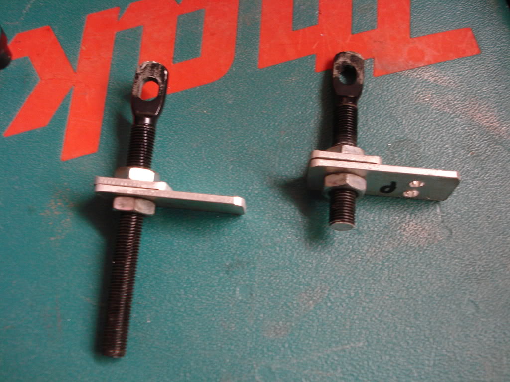

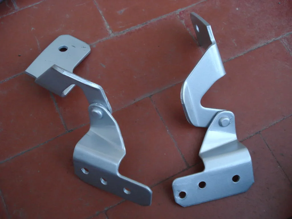

I also made some new mounts for the bonnet pins, Again out off some aluminum strip.

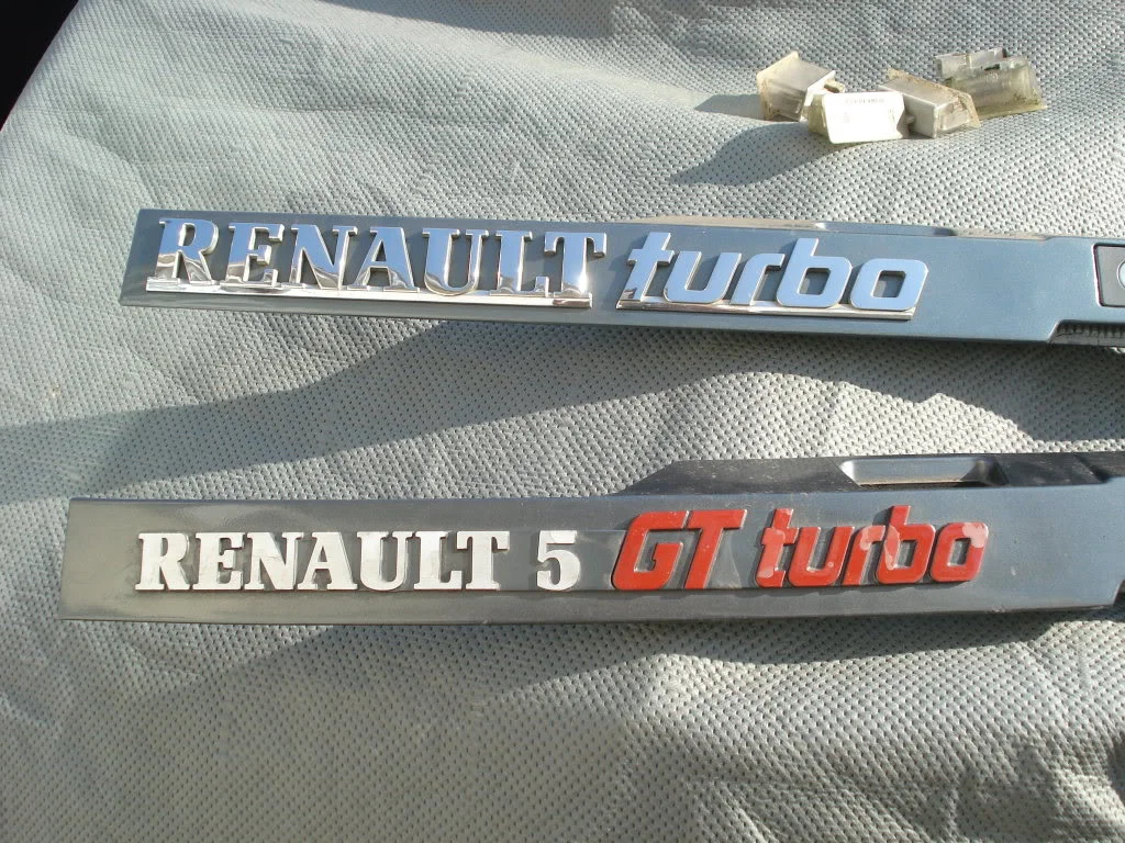

Mk 1 vs Mk 2
Finished, Cut away unwanted thread as well.

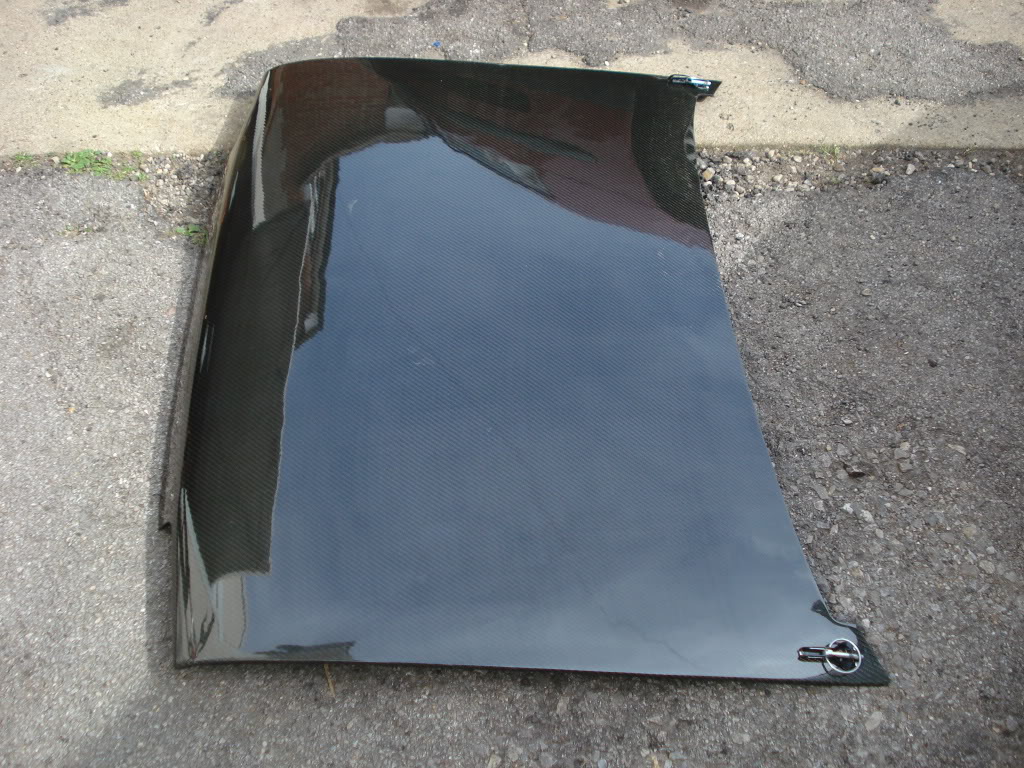

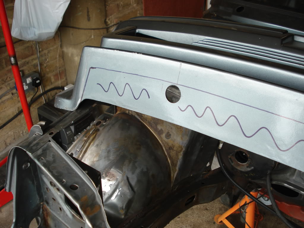

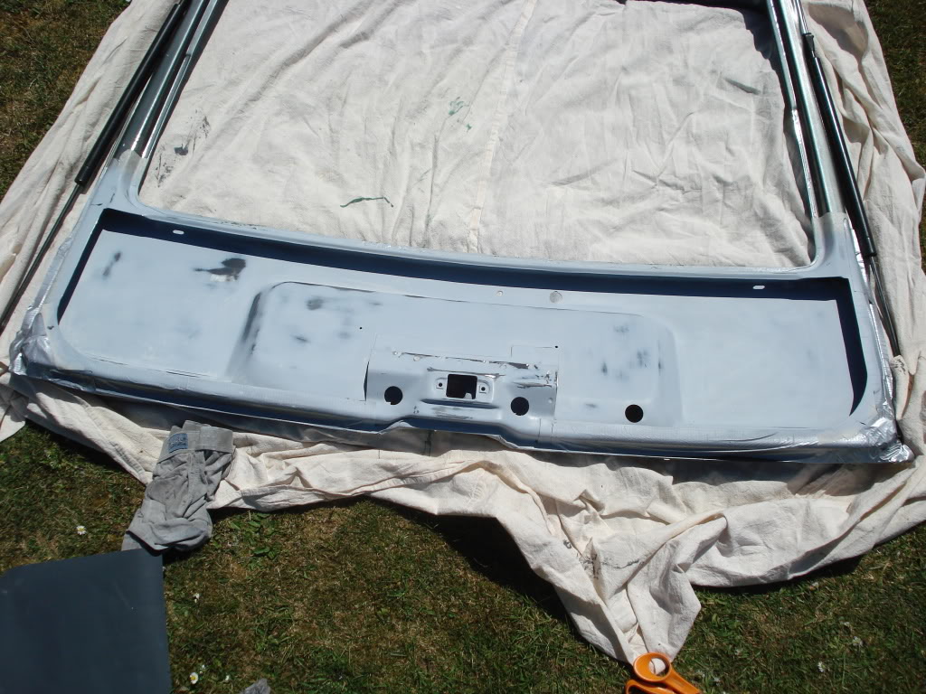

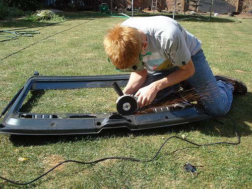

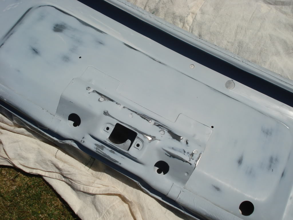

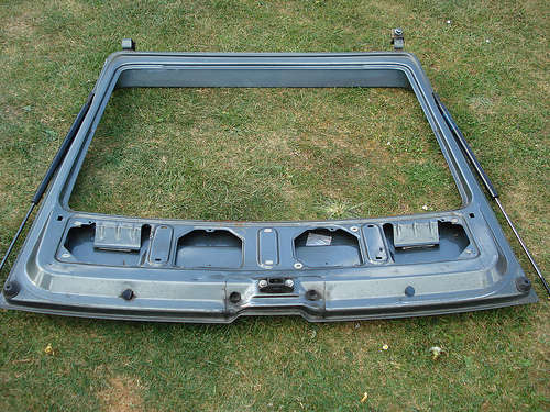

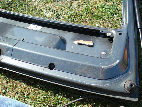

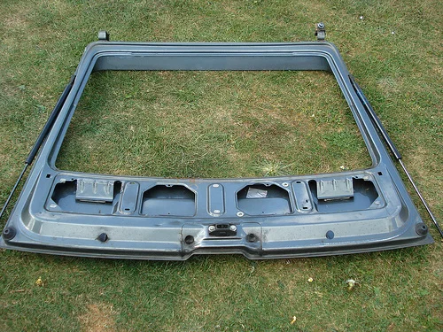

Done some work on the boot lid at the weekend, mainly weight saving and just cleaning it up.

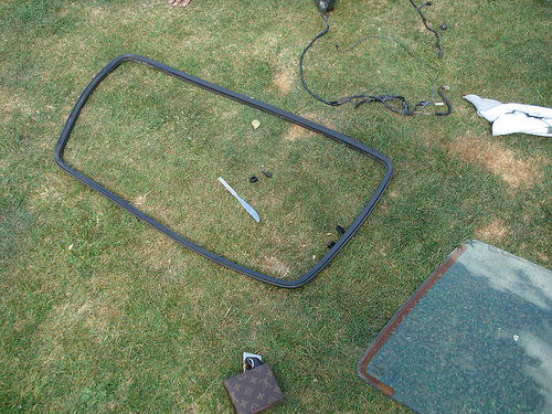

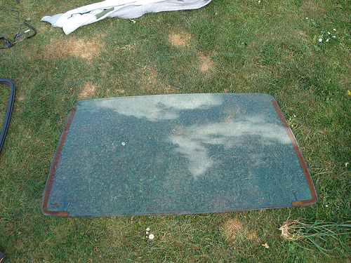

Firstly removed the glass as I'm going to use perspex windows and the glass had a big scratch on it.
A lot easier than I thought.
I had all ready taken out the wiper motor and arm then worked out what I was going to cut off.
Cut away the cables for the motor and heated screen.
Forgot to get a finished picture.

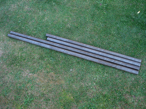

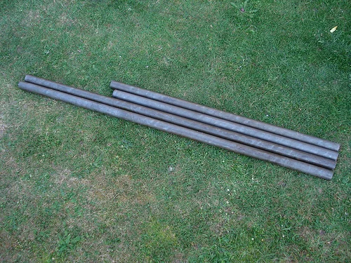

Also bought a couple of meters of CDS as I'm going to ad a few bars onto my roll cage.

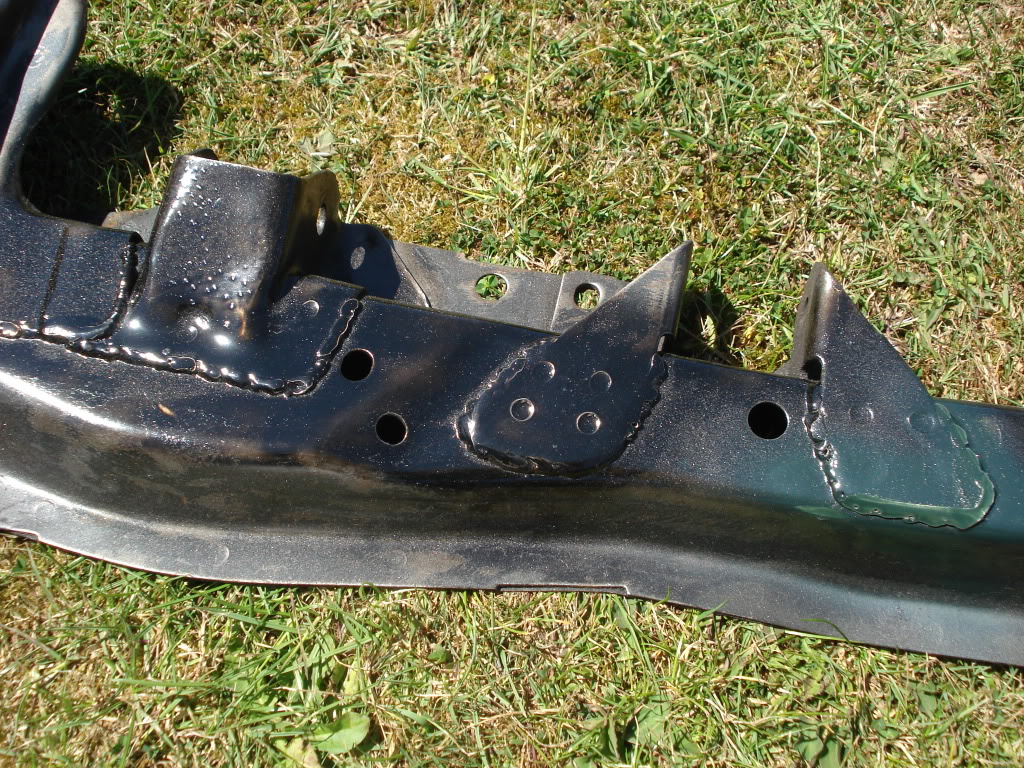

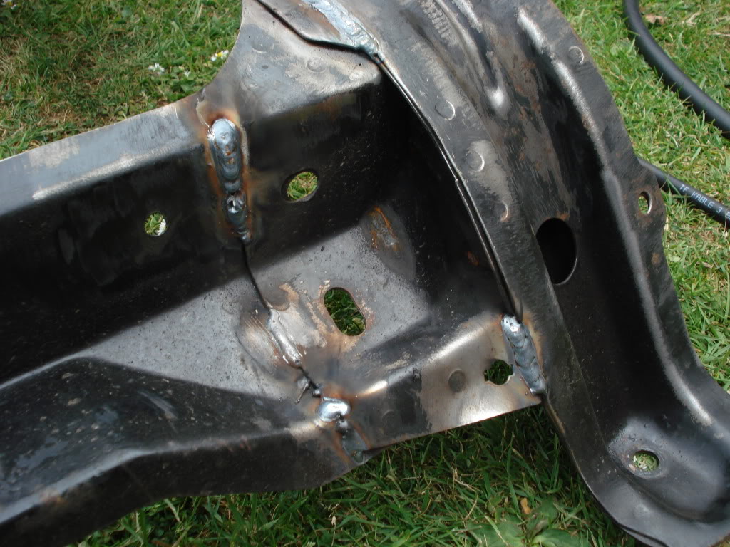

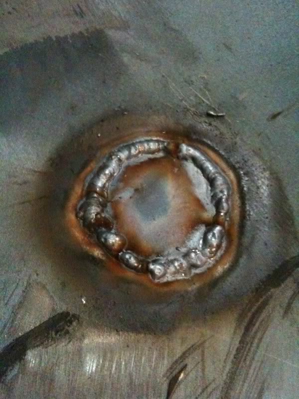

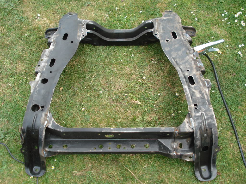

Pretty much finished seam welding the spare sum frame, Welding looks s**t but I just been practicing with the new welder.
Just need to get it powder coated now when I send the VW Beetle floor pan off.

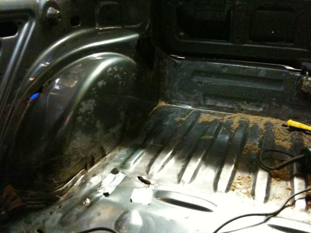

Decided I'm going to paint the inside of the boot matt black like I'm doing the rest of the inside so it doesn't look to out of place.
So started some of the prep work.
Don't really have a target, just removing all the unnecessary stuff.

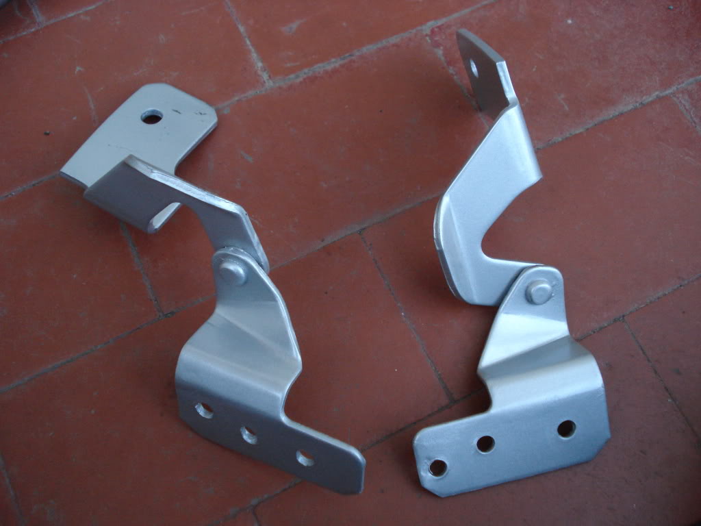

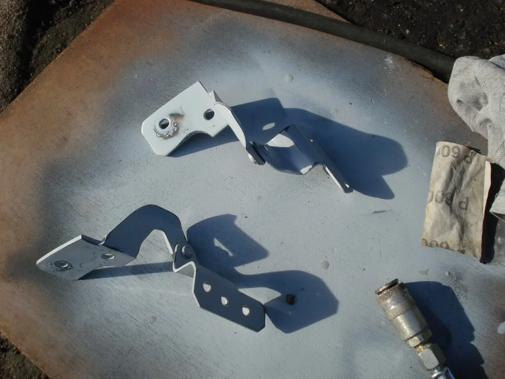

Painted the bonnet hinges.

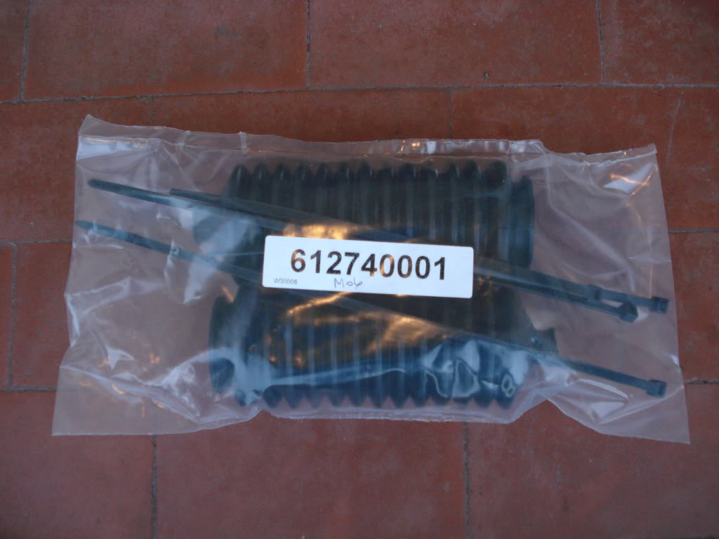

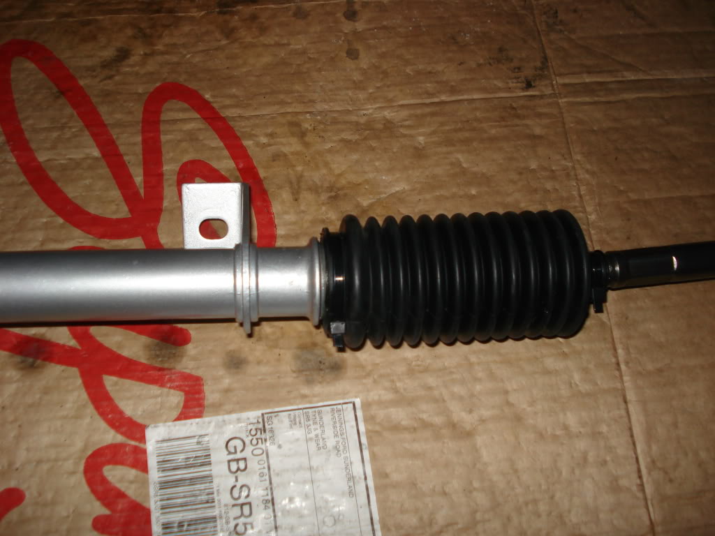

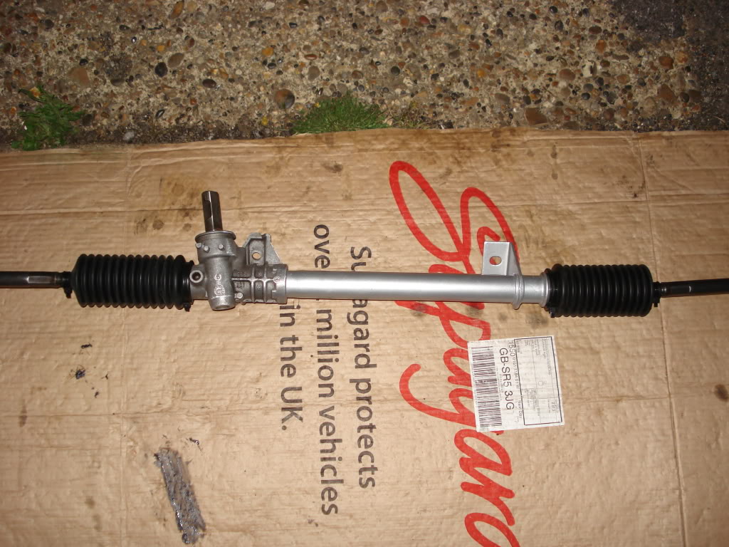

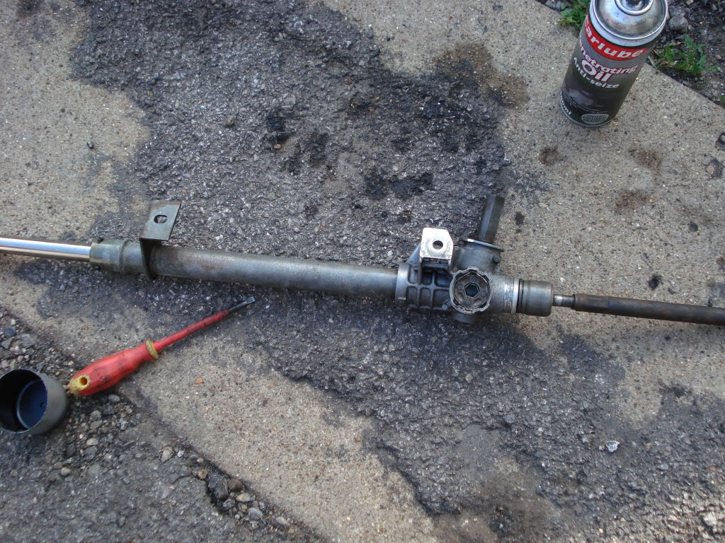

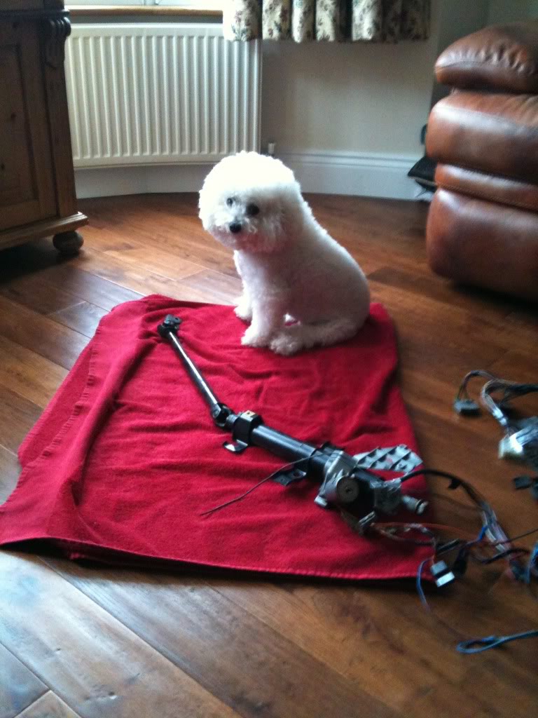

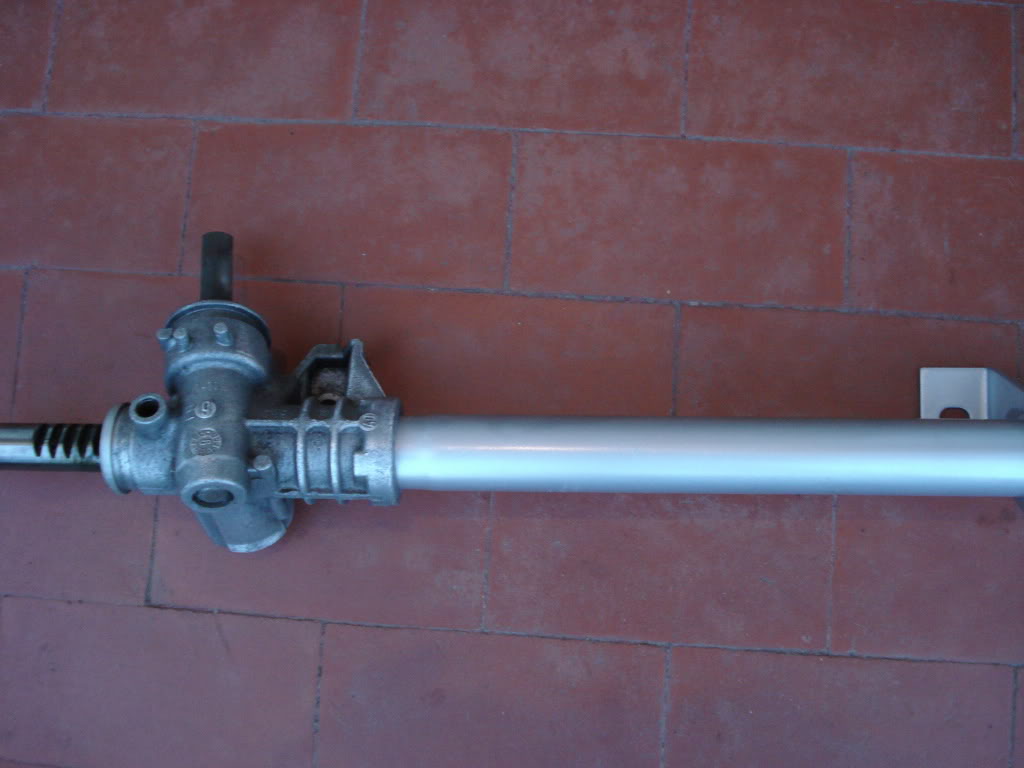

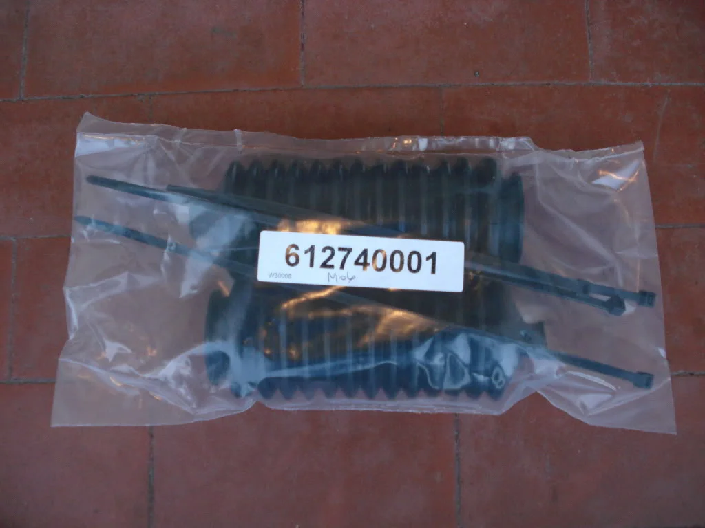

Also finished the steering rack tonight as I got the new gaiters this afternoon.

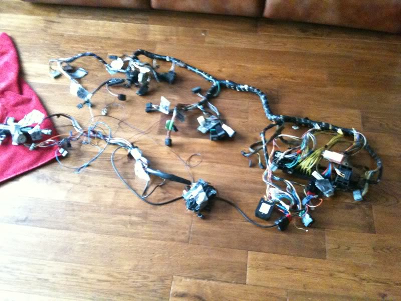

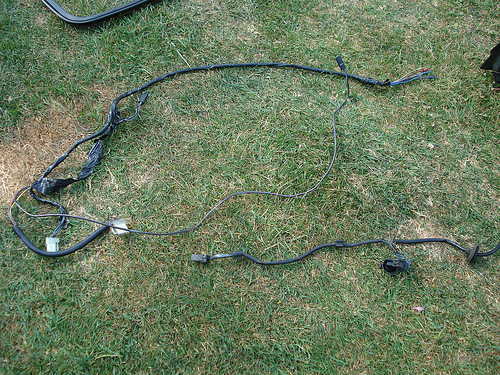

Spent this evening putting a spare interior loom in and got the engine turning over. I'm going to do things a bit different to what I originally planned, so watch this space.
