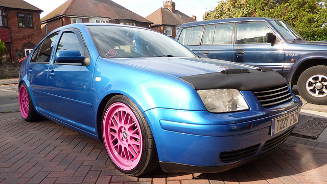

Some befores:
P1060434 by RussZS, on Flickr
P1060437 by RussZS, on Flickr
P1060438 by RussZS, on Flickr

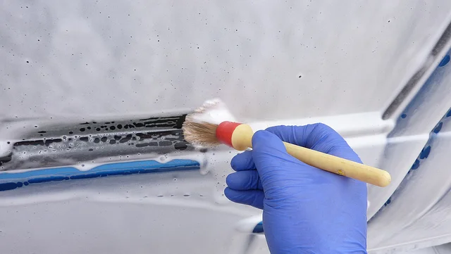

Next up, I degreased the front end of the car with Auto Finesse Citrus Power:
P1060440 by RussZS, on Flickr

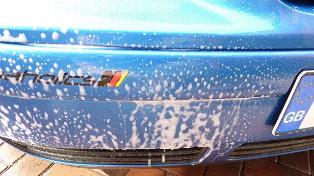

Then snow foamed with Auto Brite Magi Foam:
P1060441 by RussZS, on Flickr
P1060442 by RussZS, on Flickr

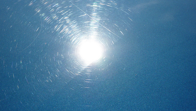

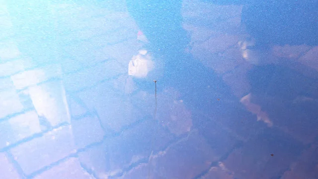

During wahsing, I'd noticed it was pretty bad, but look at this...
P1060462 by RussZS, on Flickr
P1060464 by RussZS, on Flickr
11 years worth of poor washing... and some of these were DEEP.

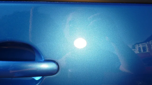

I whipped out the Megs MF System (5" Cutting Disc and D300) and cockily started correcting the bonnet assuming that it'd be perfect after a single set and I could get the bonnet corrected pretty quickly - remember I only had this car for 5 hours, but that bonnet I was determined to sort properly, then pick and choose the worst bits from the rest of the car, in the time I had left.
However, after a set with D300, I'd say it was correcting 60% at best... this paint was HARD! I tried another set, which improved things further, but still only about 70% corrected or so!
This had become personal, and I was getting very conscious of the rising temps, so didn't want to start using foam on Rotary. So, out came the "big guns"!!

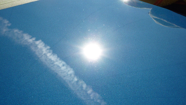

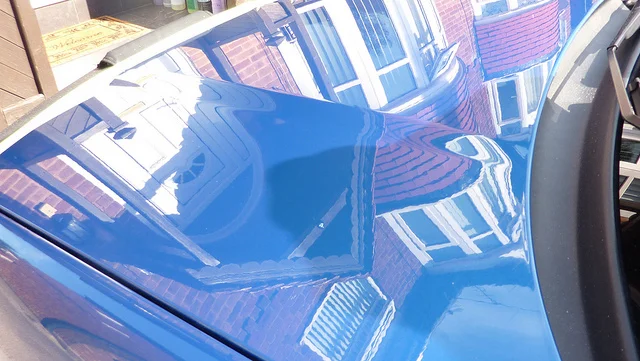

MUCH better! It needed some refining still, but I was getting happier with the finish.
P1060473 by RussZS, on Flickr
After refining with S17+:
P1060466 by RussZS, on Flickr
Not 100%... but not bad, given how hard the paint was!

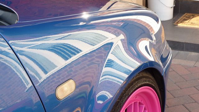

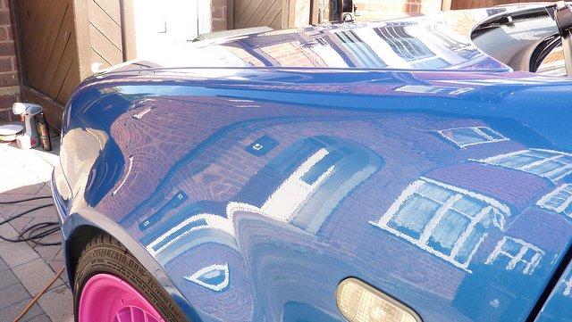

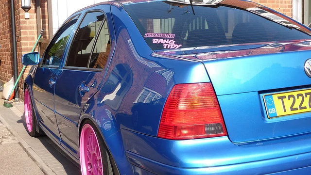

Here are the afters...
P1060485 by RussZS, on Flickr
P1060486 by RussZS, on Flickr
P1060490 by RussZS, on Flickr
P1060500 by RussZS, on Flickr
P1060502 by RussZS, on Flickr
P1060503 by RussZS, on Flickr
P1060508 by RussZS, on Flickr
P1060509 by RussZS, on Flickr
P1060510 by RussZS, on Flickr
P1060515 by RussZS, on Flickr
I still need to sort the headlights, which REALLY need a polish, and the roof is a swirl and RDS frenzy, but I simply ran out of time to do any more :(
Not bad though for 5 hours I thought!
