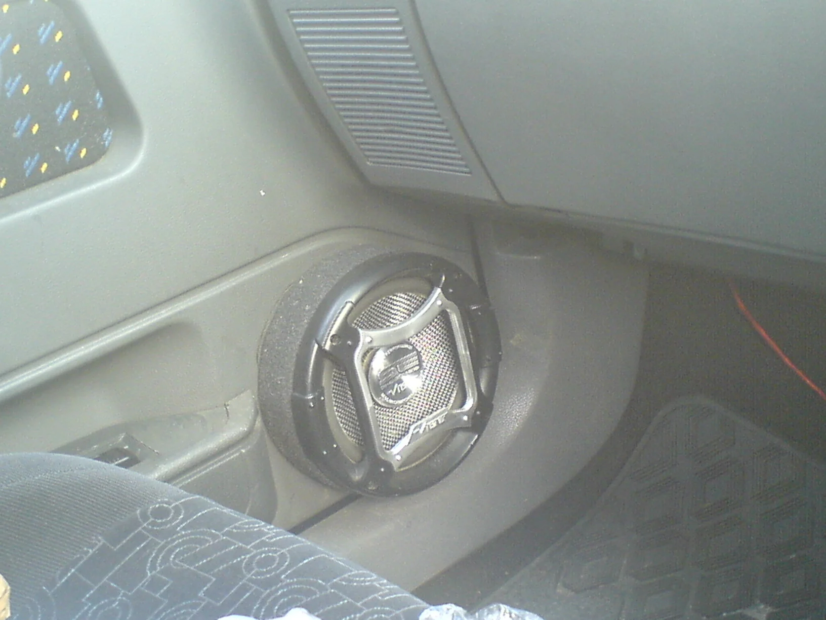

I done it just made a small mdf ring that would fix onto the orginal mountain points cut as much of the middle out as i could then made up some mdf speakers rings that fitted the biger speakers glue and screwed it all together carpeted it and this is what i ended up with :D

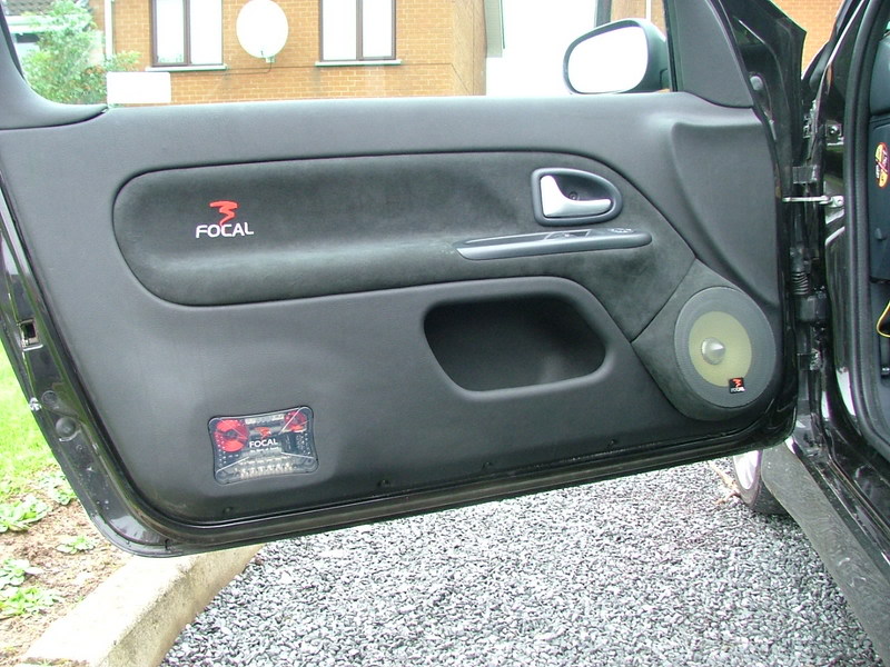

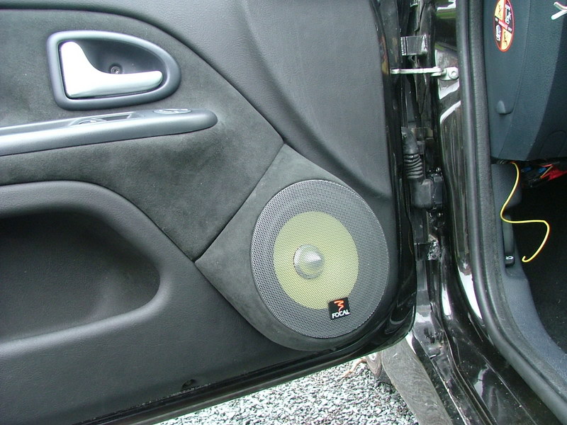

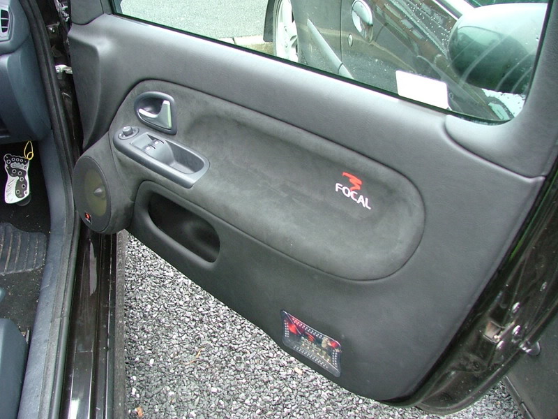

Here's mine so-far, not quite finished as I needed the car back for work;

I just got it finished off yesterday - the tweeters are mounted in the A-pillars to "lift" and improve the soundstage (further enhancing an awesome set of comps)
The Focal gear is excellent - never dissapointed yet :approve:
My doors don't even rattle now as the pods are holding the bass better - in my books that IS an achievement for a Clio :clown:

Wow. Very nice install there!!
Who did the work?? How much?? Looks like that could be £250 fitting ??
I was tempted by this recently.. Do the bass drivers have MDF enclosures?? As this was what was planned for mine. With the offset from the door, does it get in the way of your leg ???

£250 :rofl: - I wish!
The doorcards are retrimed in black vinyl & cloth part done in charcoal alcantara - soon to have the rear cards & dash done to match :approve:
Speaker pods are fibreglassed over an MDF ring
The offset doesn't get in the way when the door is closed
Audio Advice did the work - they are in N.Ireland and are winning competitions all over Europe with their Reno 19 16v :star:
www.audioadvice.co.uk

Not exactly sure what labour & materials would be to be honest - a few things need tidying up on the front still

Thanks for the info on the focals Tigger, just out of interest how much of of an offset have you put on these? Did this have a big effect getting these more on axis than the standard fit.
Sorry to ask so many questions but I have got the ICE bug back after 5 years after having built the last system and having just bought a 172 exclusive so its the perfect time to get going again.
  "Navy" N17 TWO
I'm not sure what measurements were used to be honest as I din't do the fabrication myself, I can try & find out though
