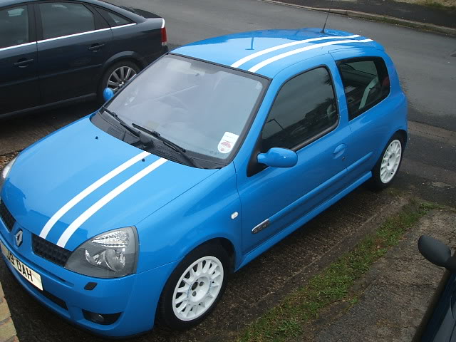

I bought my RB Clio 3 years ago now and have been using it as my daily car for this time; I now have a company scheme car so this can now be my toy.

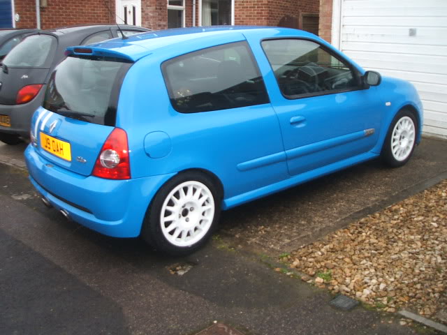

Anyway, this is what the Clio looked like for the first two years:
Shocking photo...
Spec at this point was fairly standard, only some GAZ coilovers fitted and a panel filter.
I then decided to replace the 182 alloys with some 2118’s:

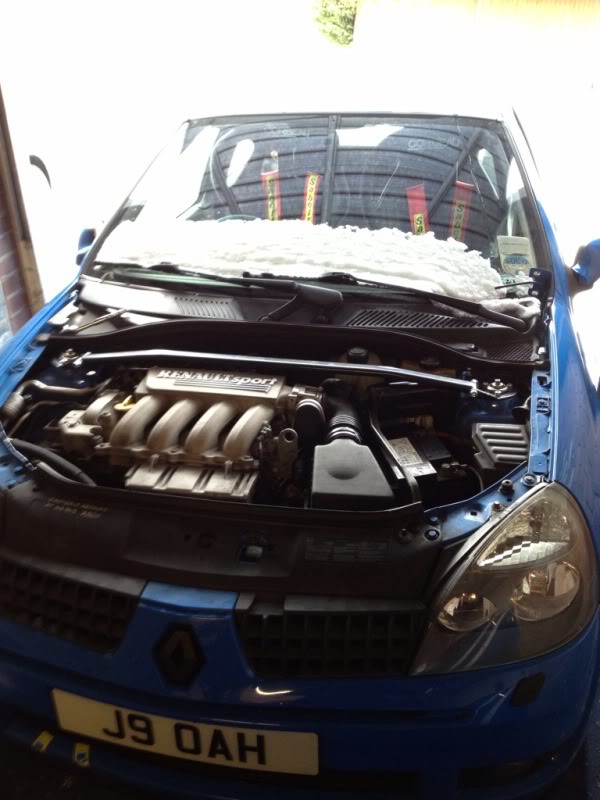

That then brings me up to the start of this year, where I have now spent a bit of money on it:

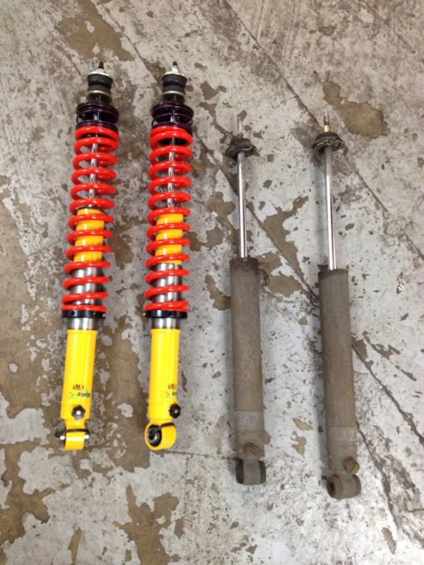

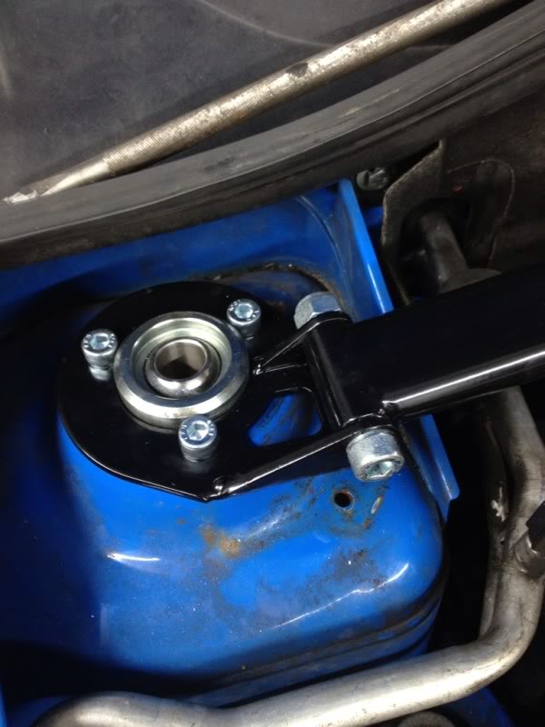

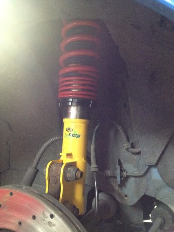

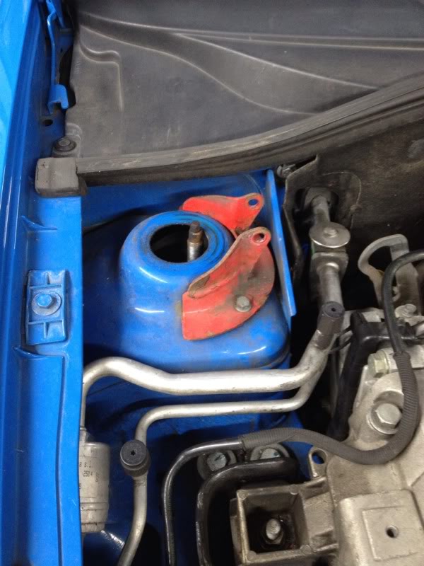

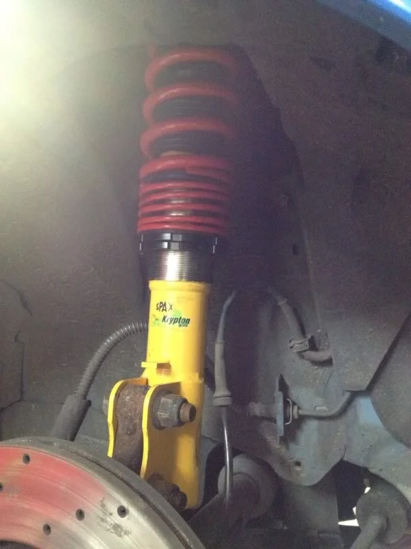

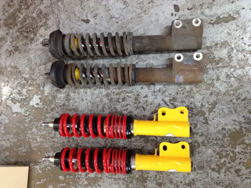

Firstly, I wanted to replace the crashy Gaz coilovers for something better, and at the time Danny had a good GB price on the Spax RSX coilovers, I liked the look of the combined rear damper/spring setup so opted for them, also at a similar point in time I purchased the Pure Motorsport top mounts and strut brace:
Previously had an OMP brace on there:
So out with the old and in with the new.
Then for the Spax:
Old vs new:
Really impressed so far with the spax, much more comfortable on the road than the Gaz, yet to test on track how they perform but I would imagine they will be good due to the level of adjustment in them.

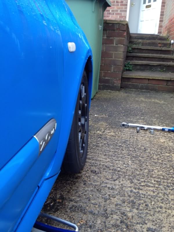

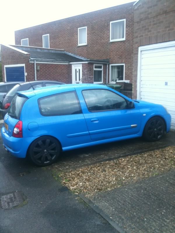

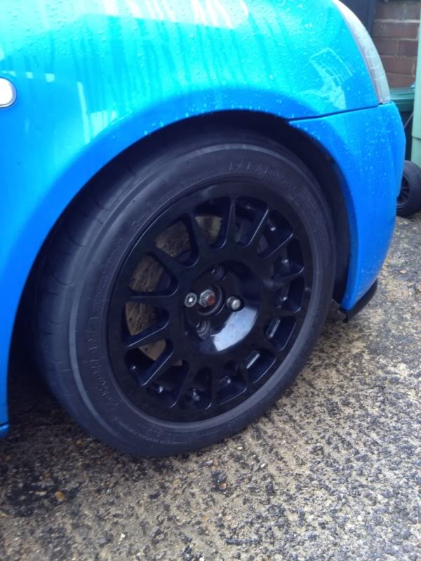

I also picked up another set of 2118’s in black this time, with some spec2 tyres on them, so fitted these and setup the ride heights:
The white 2118s will have some worn RS2’s which I had in the garage soon, kept them for track days.

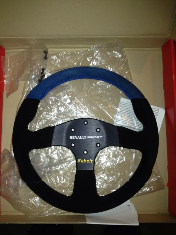

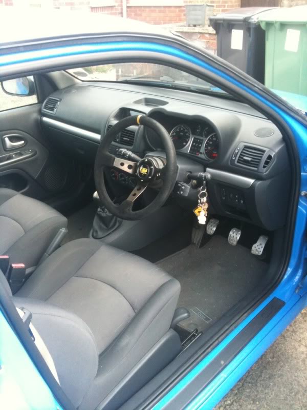

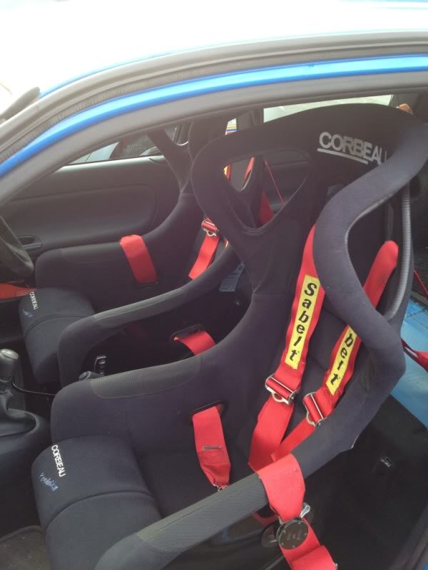

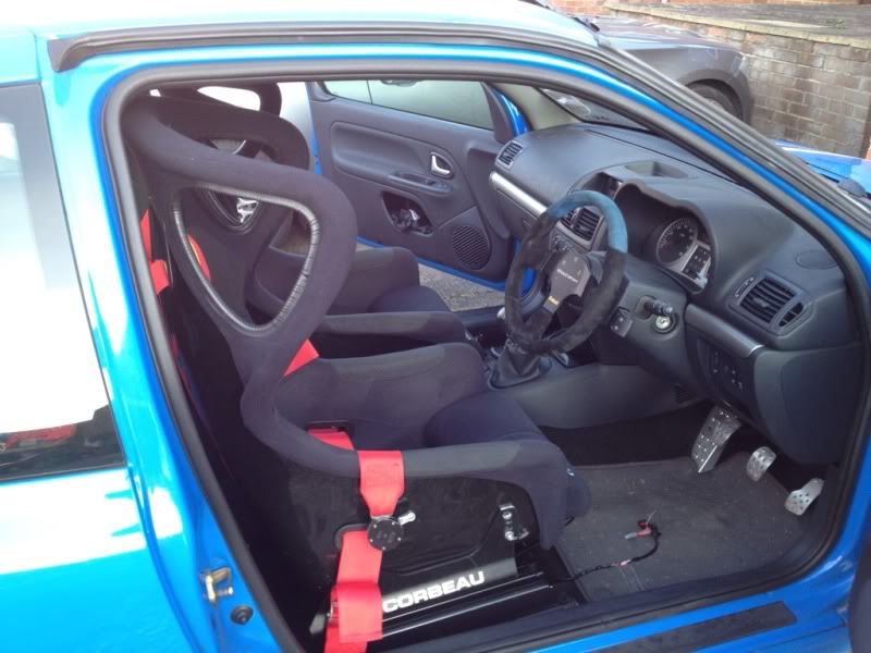

A few weekends ago I managed to finally get my corbeau seats in the car (have been sitting in the garage for 2 years!):
You can see I also replaced the dished wheel with a Sabelt one :approve:

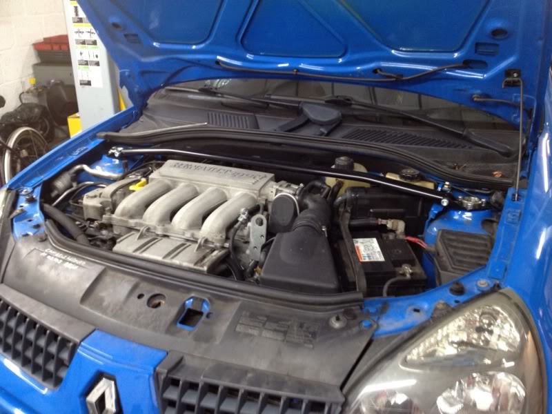

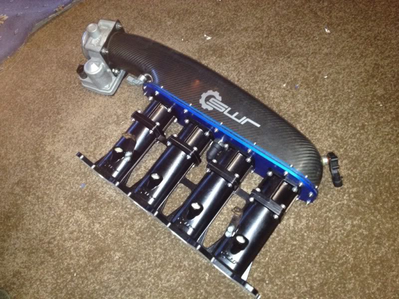

Finally to bring it up to date, I purchased Nick172Cup’s RS2 Xtra manifold last year, and this has been sitting in the garage as I have been collecting the necessary parts to be able to fit it, which I now think I have the majority, so firstly I fitted the new carbon bonnet I picked up from Chris205 on here, purchased because I needed aero catches fitted to get the manifold to fit:
That brings me up to how it stands now, hopefully this weekend I will be removing the slam panel, fitting the new rad/fan setup and the RS2 manifold, I’ll try and keep this up to date.

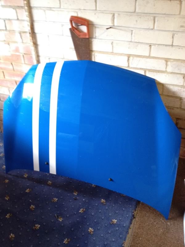

6. Front bumper needs a repair/respray where I clipped a kerb (hense the mr.Bump plasters in the last photo ;)) and may get the bonnet resprayed at the same time.

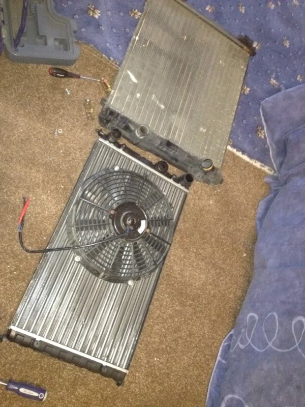

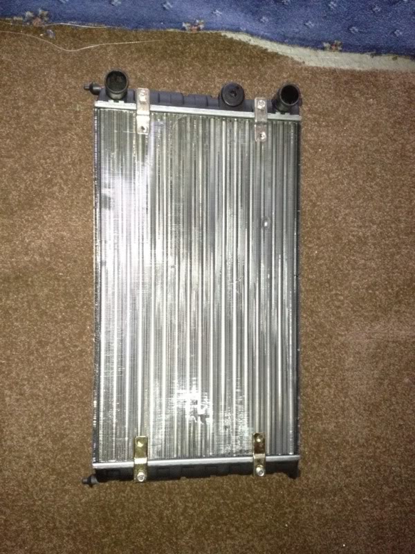

This evening quickly stuck the fan on the new
Showing the old against the new, rad is the polo one the itb boys fit, should give me plenty of room for the future :)
Next a cheeky shot of the rs2 just waiting to go on :

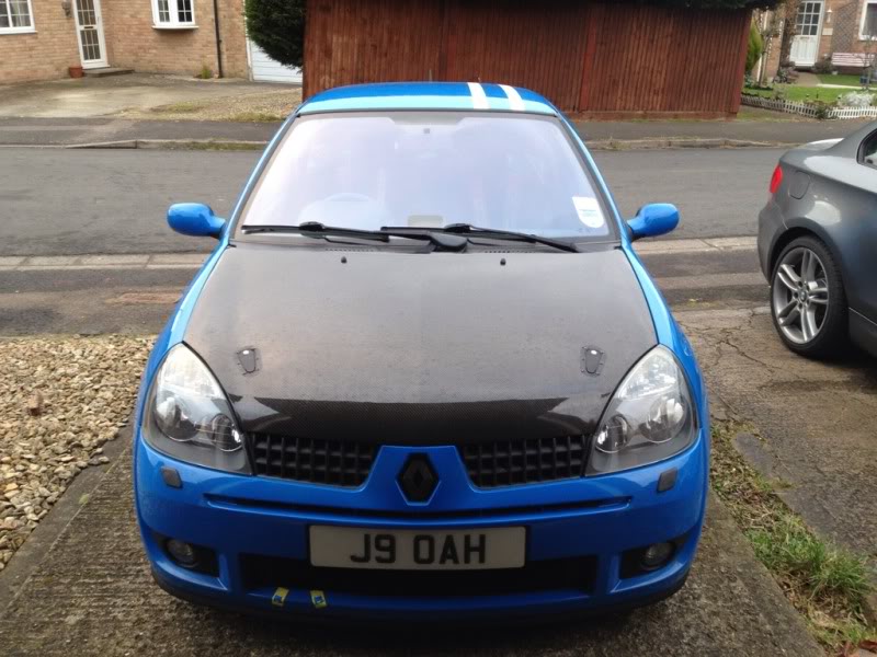

Nice looking car- really like your seats. Are you thinking about spraying the bonnet the same colour as the car?
Jekyll
Awesome :) Got some nice progress going on. Carbon bonnet and black 2118's look good but i dont think the stripes suit it now. I say keep it carbon, not painted.
RS2 is a nice addition. The more i look at them the more i want one. I also keep looking at the spax setup. Have you got a more detailed view on them and in comparison to the gaz's as i was originally looking to get the gaz's but keep looking at the spax kit too.
  DON'T SEND ME PM'S!!
Looks good Joe :)
got a set on the shelf that's waiting to go back on my own car, what are you interested in seeing? I'll take some pics, or better still you're only down the road, just come and have a look

Good progress mate always wanted to no what a RB looked like with a carbon bonnet as been thinking of one for my RB and it suits it well in my opinion.
Yup the stripes are going to be removed along with the renault sport badge, the stipes are peeling badly so was always my intention to remove them. Not sure whether to paint the bonnet or not but will be staying carbon for a while as I cant afford to get them sprayed yet.
As danny said, best to go take a look at them, but so far they ride much better than the Gaz ones on the road, and I would imagine they would be far greater on the track. The Gaz were good for lowz y0 but not much else...

The Gordini stripes need removed or replaced with black ones.
Its a cracking looking motor!
  182 track, Mk7 ST
I love the look of this and the plans sound great, didn't think too much of RB with black previously but with the 2118's and the other little details I think you've really pulled it off!
If I were you I'd leave the stripes off completely once removed tbh, a mate of mine removed them on his and had anthracite 2118's and looked perfect IMO.

Bonnet looks good as it is. I wouldn't spray it. :-/
Cheers, I think I know the one you mean and yes it looked great, stripes will be coming off :)

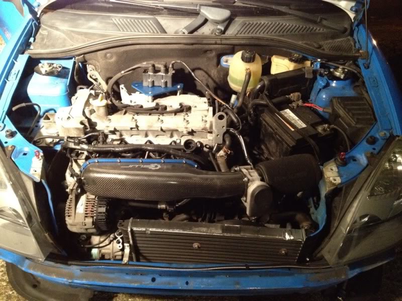

Got the car prepped ready to fit the manifold today hopefully.

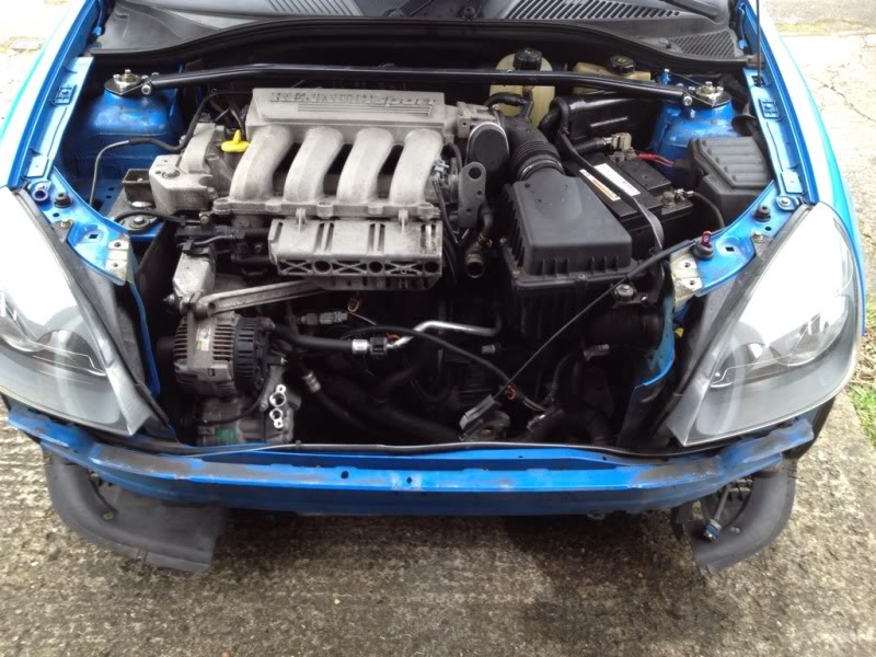

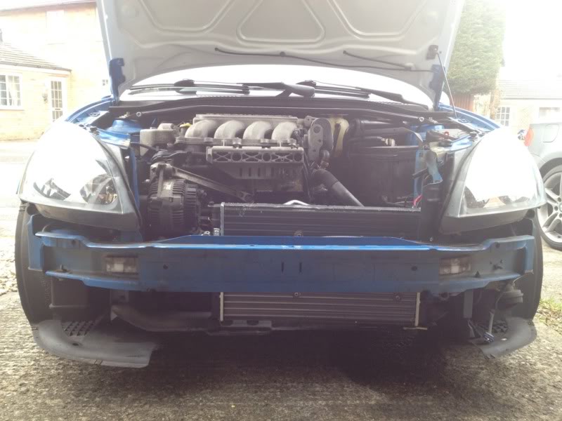

Last night I removed the bumper/slam panel, along with the aircon rad and pipework. also drained the coolant and removed the old rad. I dont work friday afternoons so got this time to get the new rad and RS2 on, cutting it fine as the MOT is booked in for tomorrow morning! oops.
So Friday I started with this:

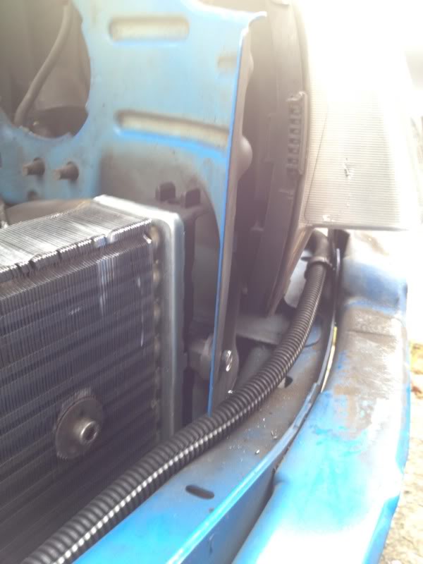

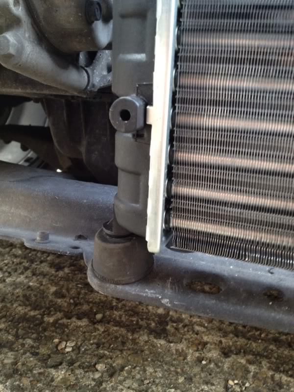

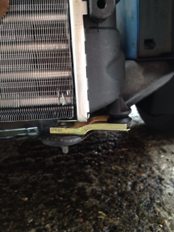

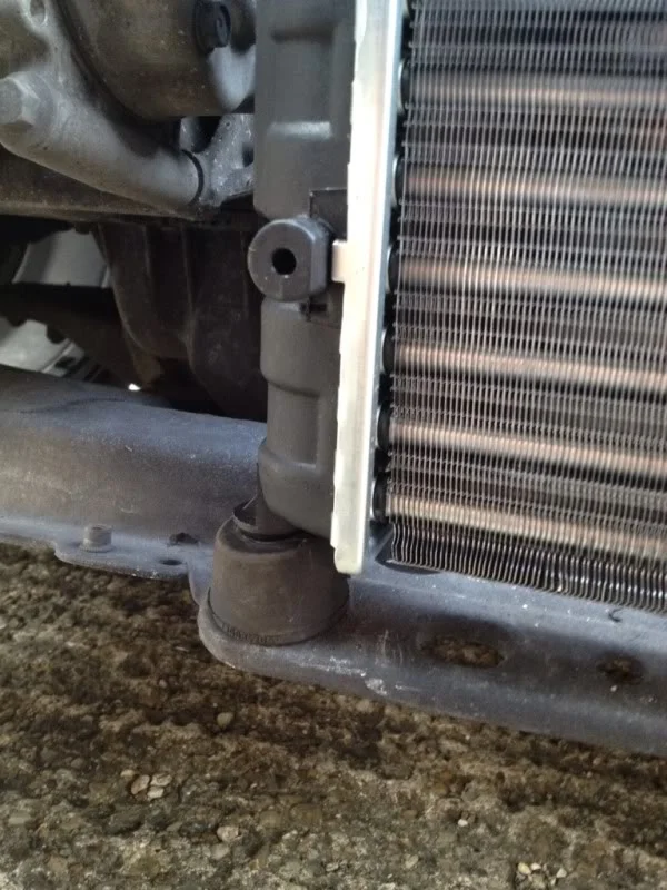

Firstly I set about fitting the new polo rad and fan, had to just create one new bottom mount:
Then created a top mount for the left hand side:
And attached the right hand side to the chassis but used a rubber washer:
And rad fitted.

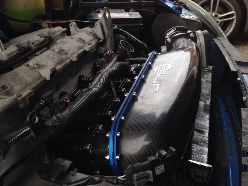

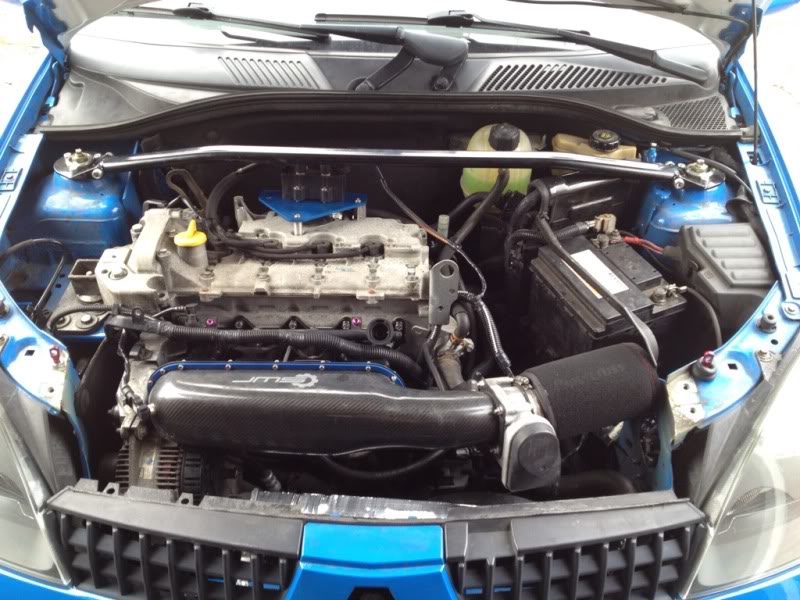

So with that I then started the RS2 manifold, after cutting every knuckle I finally got it fitted:
Fitted the rest of the parts:
Started her up and it just revved to 3k and sounded like there was a leak, couldn't figure it out, spoke to James from stone automotive (thanks mate!), straight away he said I had missed the brake servo hose! Doh! Attached that and whey hey!
Refitted the bumper and other parts ready for it's mot this morning:
Oh and it passed the mot no problems!
Having only driven a few miles it sounds awesome and seems to pull much better pre 5k, power feels really smooth. Will have to test even more soon!

Carbon bonnet looks a bit out of place though. Guess it'll look better once you remove the white stripes.

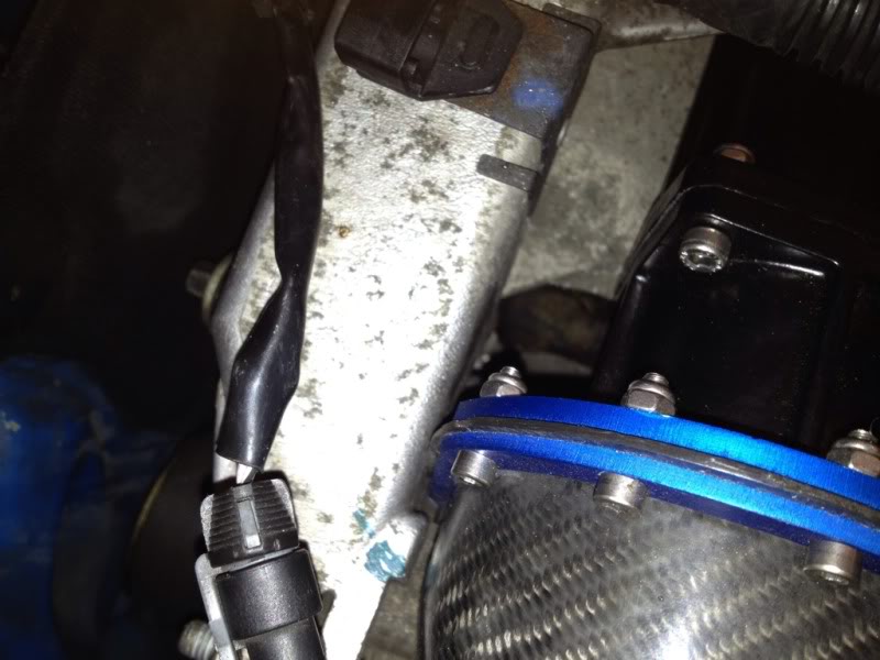

Good update matey, make sure to use the silicon pipe between the throttle body and filter as that extra bit of length on the induction setup will make a difference! ;)
Nick
Yeah I need to do this, but comes off at a funny angle and fouls the front chassis, will have a look at your photos and see what you have done?

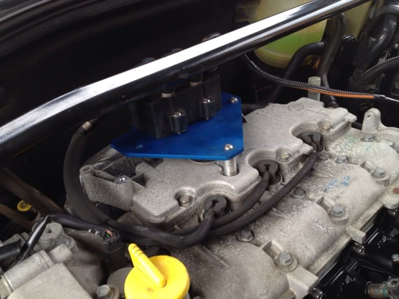

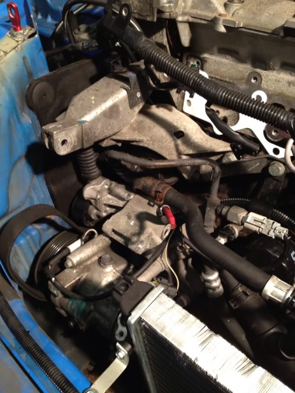

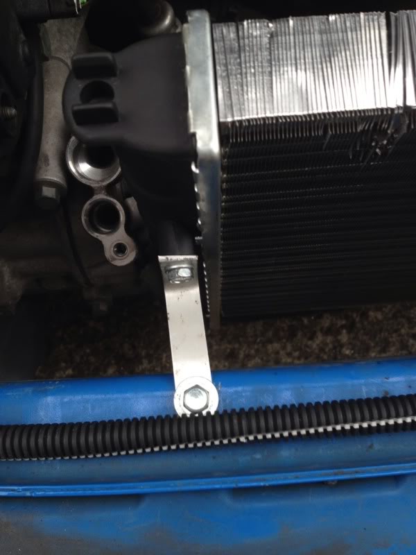

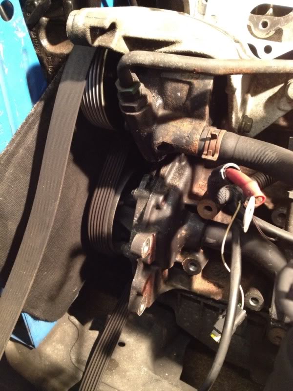

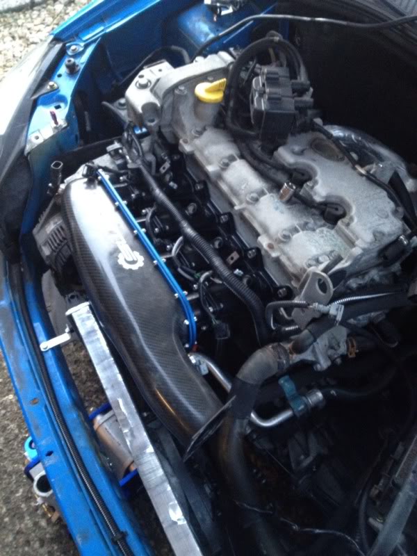

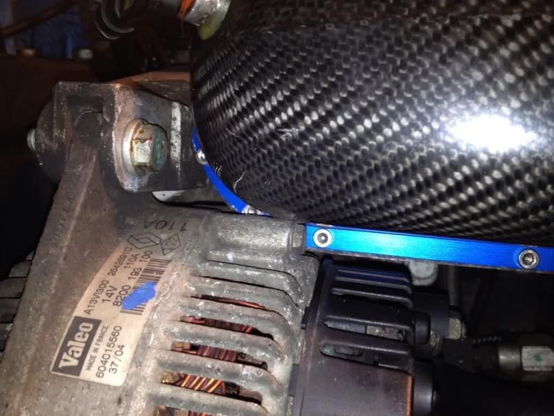

Having a look at clearance between the RS2 and the alternator I was not happy with the amount of space between the two as they were pretty much touching as you can see here:

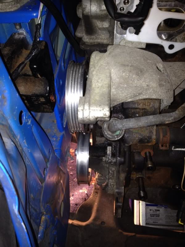

So I decided to fit my pure motorsport AC delete now rather than later, and so off comes the manifold again...then the alternator:
Removed AC compressor:

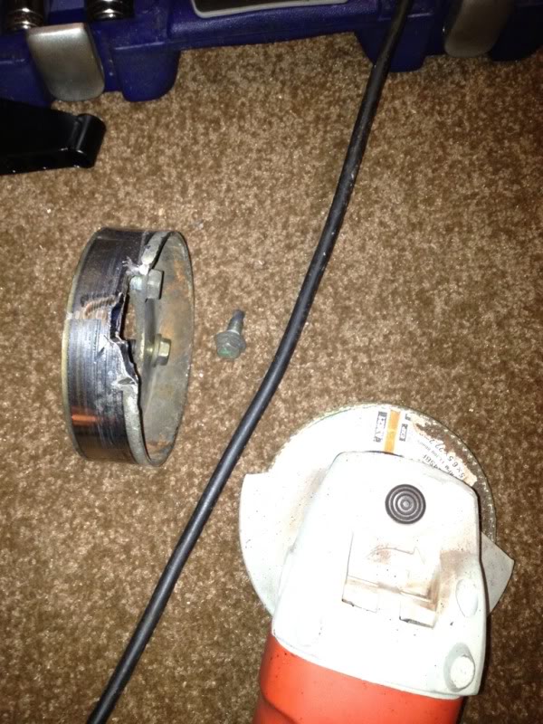

Only issue I have run into was I couldnt get the old pully off the water pump due to the amount of space between the block and the body, after alot of swearing and bashing I gave in and out came the grinder....
No issues getting the new one on as its much thinner:
This is where I got to last night, need to take the alternator to the garage to get the old pulley impact gunned off, and the new pulley on, then its a reassemble job.

Joah,
Glad you got it all fitted okay in the end! :)
As Nick has mentioned, running with out the silicone pipe causes a loss in torque & horse power so worth getting it on, when the office is running next week I'll upload some pictures of mine when it has the extra fitted,
As you have found out, the extra does not work with the standard aircon set-up this was one of the reason we decided to stop developing the kit!

That will be a great help, as the silicone pipe is kinked if I try and fit it at the moment, I could get a bend to go round the bit of body that it fouls (where the orignal airbox feed pipe clips in) but that defeats the point really.
