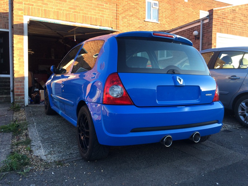

So a very long time since the last update: things have changed.
With family and dog requirements the need for a bigger car was imminent and looked like I would sell the clio but happy to say I havent had too.
It has now been taken off the road for good to become a dedicated track day car - having owned this car now since 2009 its easily the longest I have owned a car and having spent its time as standard since the last updates it was time to give it a new lease of life:

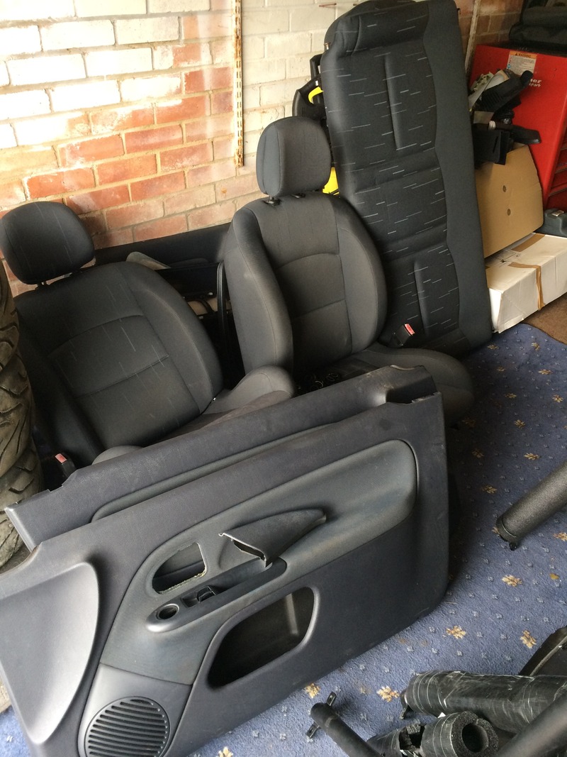

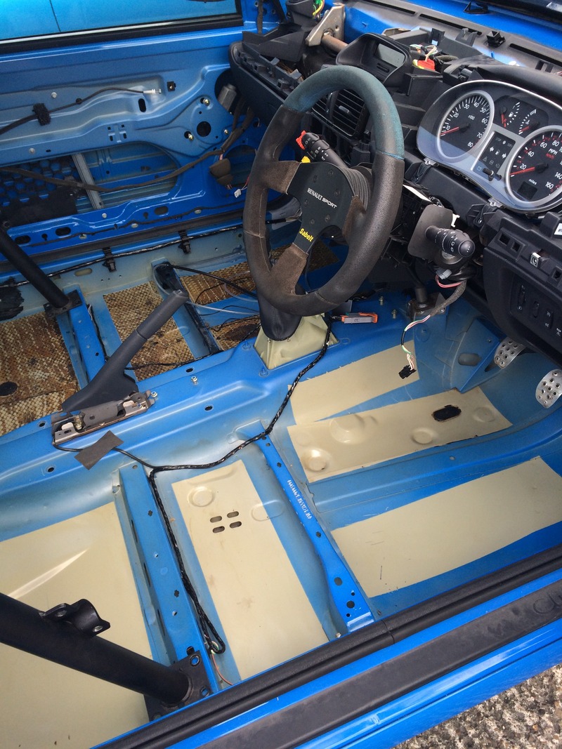

First thing to do was to strip the cars interior while sourcing other parts - all interior removed as usual and found some good techniques on here to remove the tar as seen below.

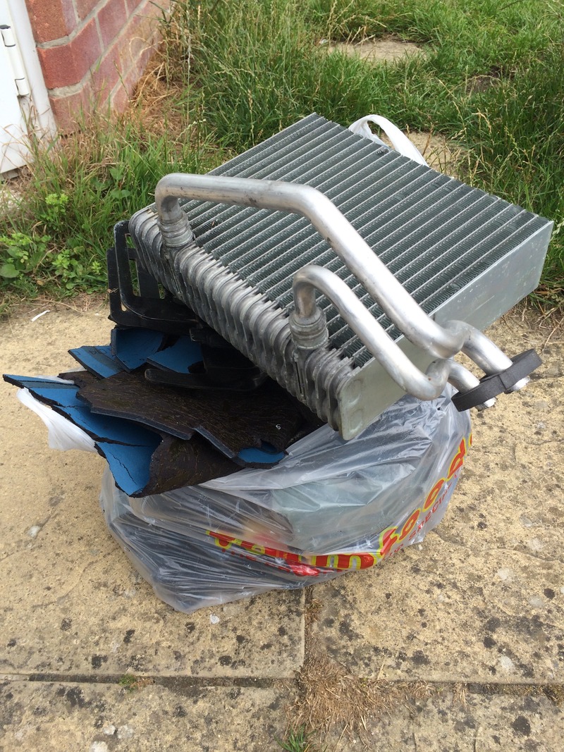

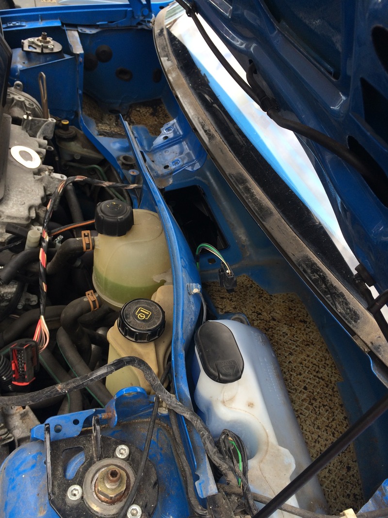

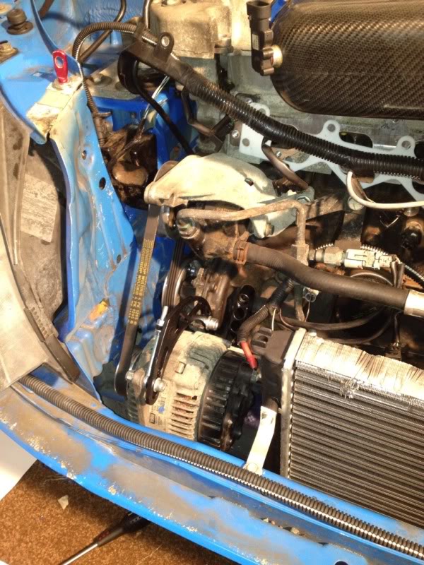

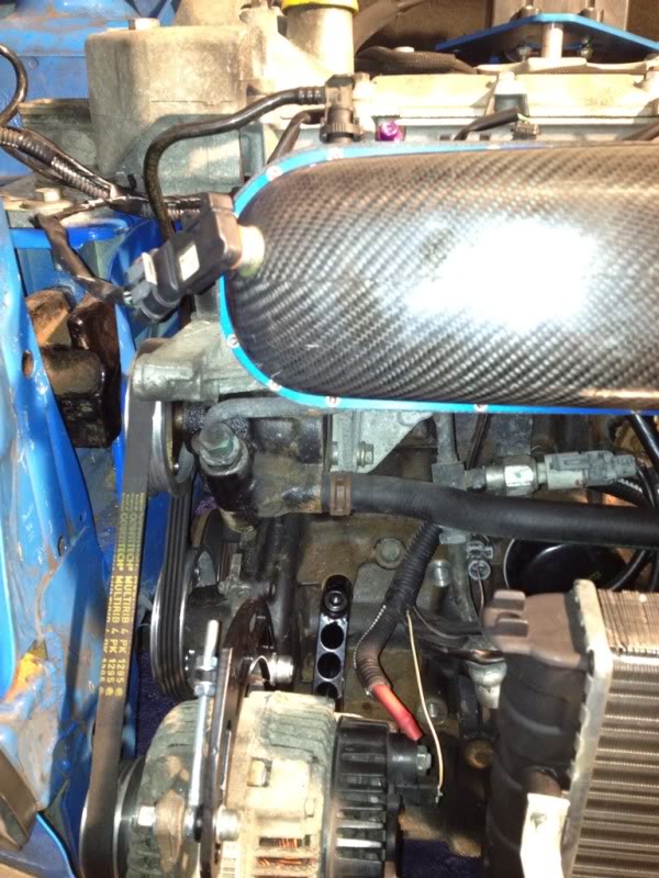

Also whilst I had the scuttle off removed the rest of the aircon which I couldnt be bothered to do at the time of fitted in the PMS aircon delete some many months ago! Supprising about of weight..

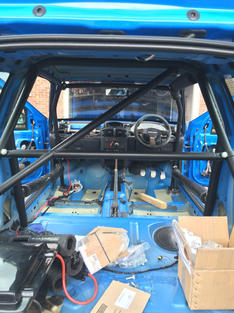

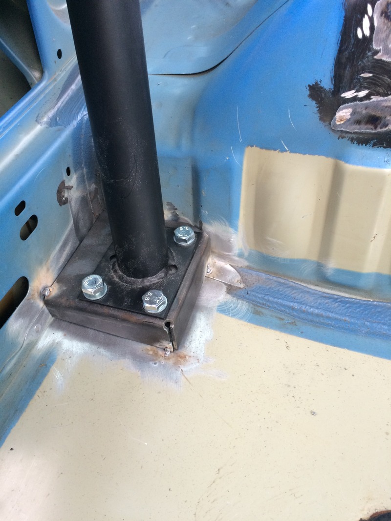

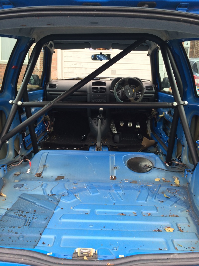

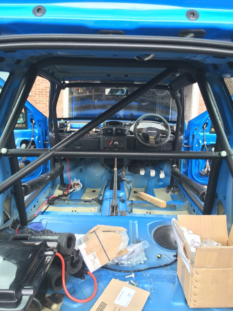

A second hand safety devices cage was sourced along with some F1's & R888's.

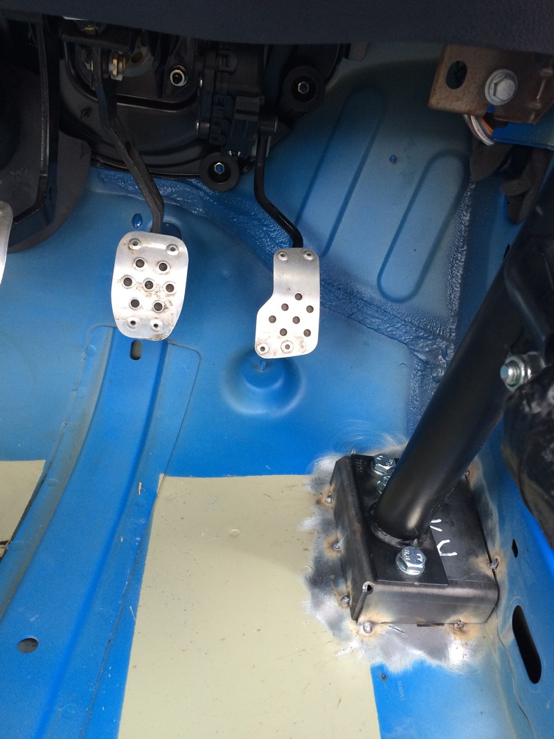

Ordered the fixing kit direct from saftey devices and cracked on tacking the feet in and getting it all bolted up.
After much in out in out I got it all welded up and seem sealed and painted the mouting points - full interior respray maybe in the future but for now just painted the feet in satin black to keep it looking ok

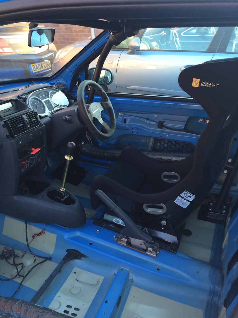

Cage in losely now as waiting to get the top dash flocked before its all tighten down - sourced some nice ex-cup racer seats from Nick on here a while ago bolted to x-low subframes so fitted the drivers one so I could move the car around - the hot seat:

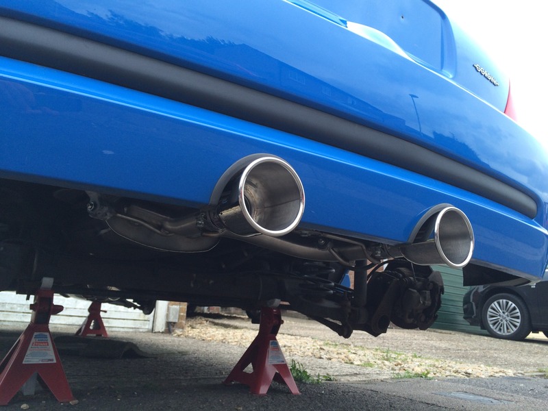

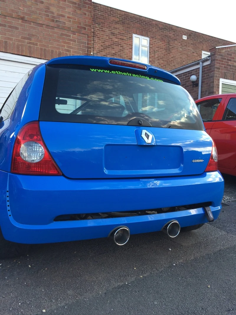

Also after a spening spree with PMS - PMS shifter (as seen above) & 182 exhaust system were ordered - both a work of art!
All fitted and looking/sounding epic!

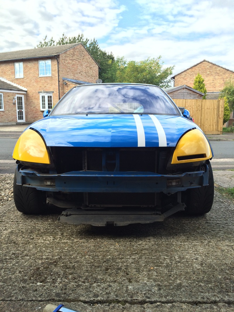

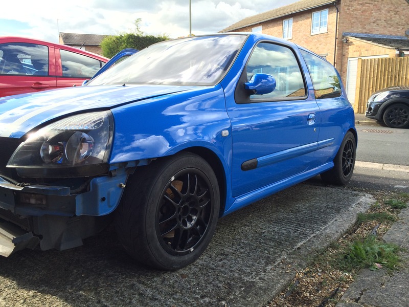

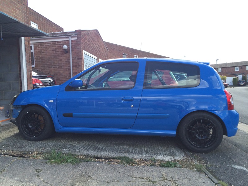

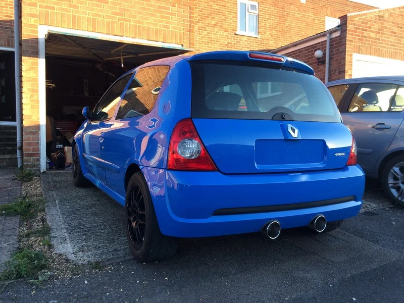

And this is where it now stands:

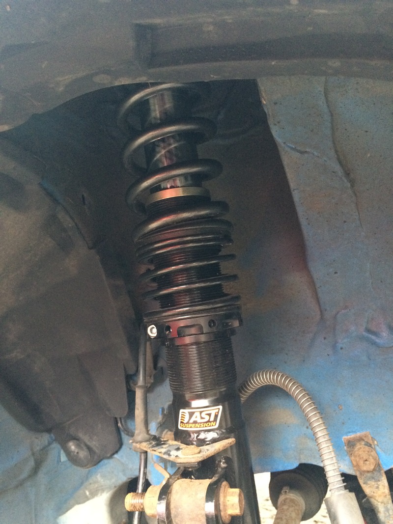

I have purchased some AST's from -DAN- on here and picking them up this week, then the next few months will be spent replacing bushes and normal things which have not been done.
