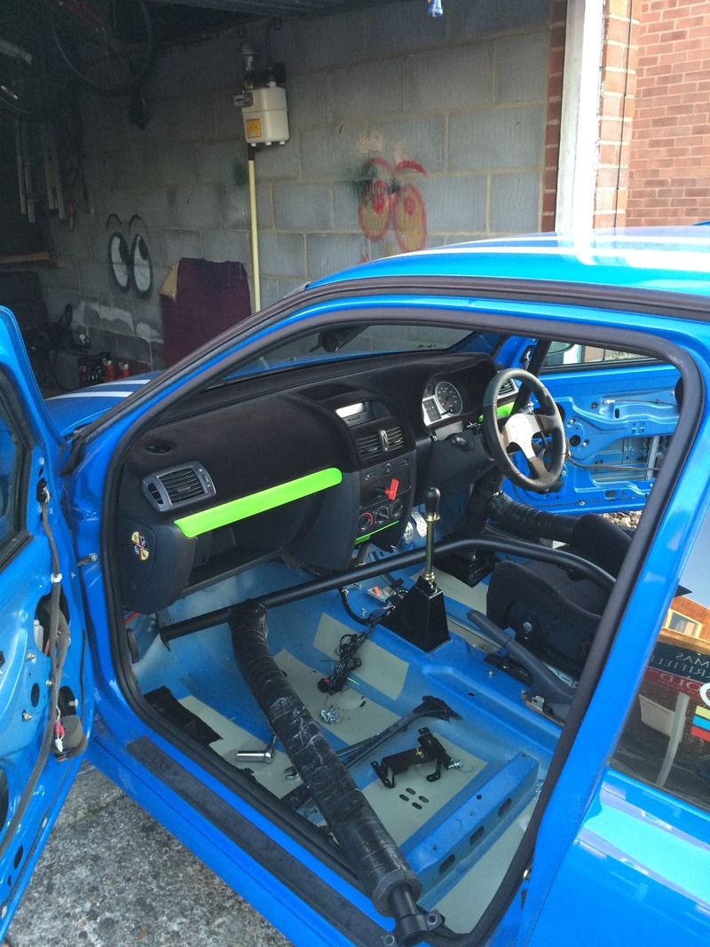

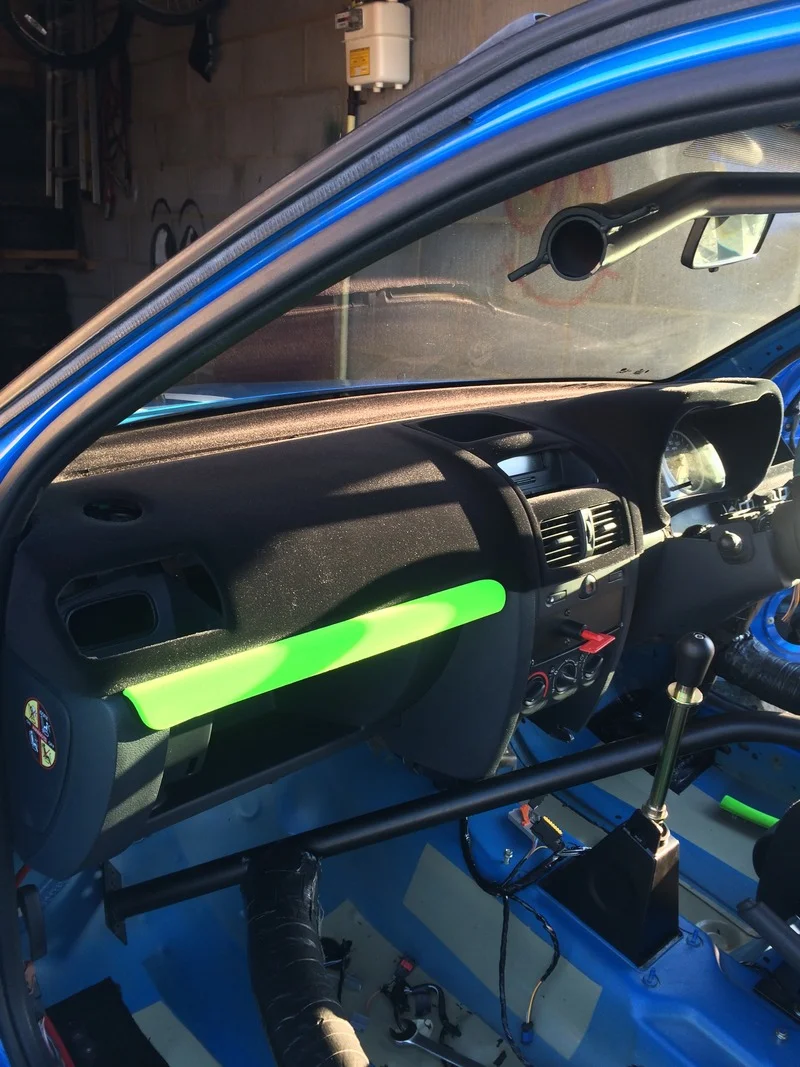

Top dash back from the flockers. And some little green highlights also.

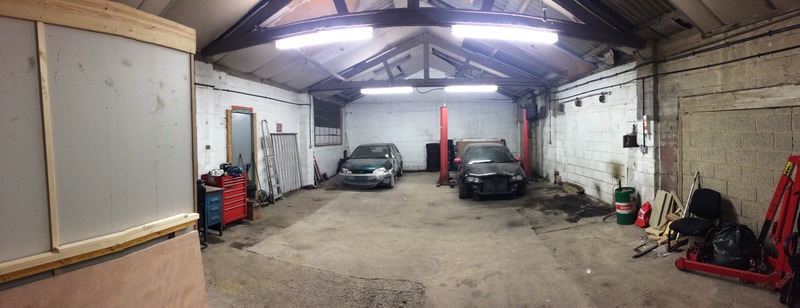

December, me and 3 friends have now rented a workshop space for our project / race cars. So I have spent the last month clearing out and repairing the building, rewireing the entire shop and installing 3 phase ramp, just a few more benches and other equipment to move in now and then the cars will be moved in - this weekend should see the clio in its new home and will have much more ability to progress further - I will post up some photos of the new workspace after the weekend!
Sadly not mate as it's part of the race team my friend has setup. If one becomes available I'll keep you in mind as your only up the road ;-)
If you could mate, I'm dying for some indoor space for the next part of the project!

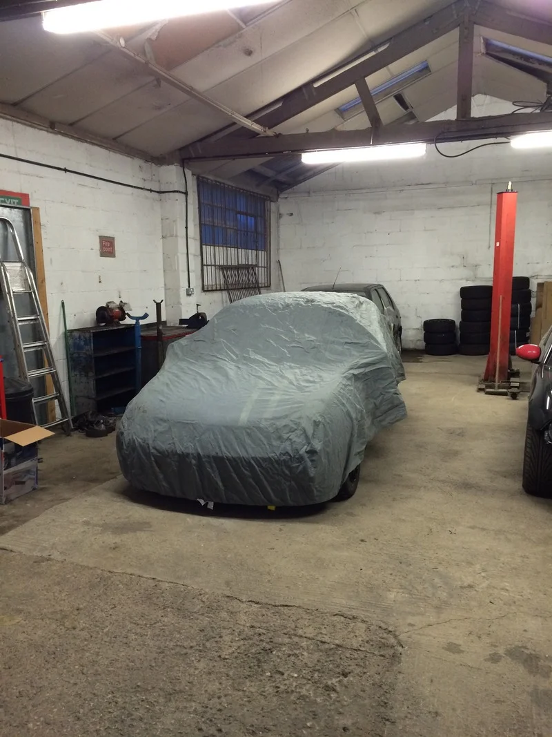

So last weekend saw the Clio make it to its new storage.

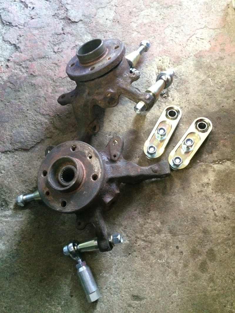

Now the battle to get it finally finished for some track action, been collecting more and more parts recently to bring the chassis and suspension right up to date, bought ready to go on:
Vibra engine and gearbox mount
Evolve engineering dog bone
Power flex arb and steering rack bushes
PMS wishbone bearings and strengthening
PMS rear beam bearings
PMS rear spacers and front 5mm spacers
ABS Delete (full cup master cylinder setup)
Aero catches for front bumper

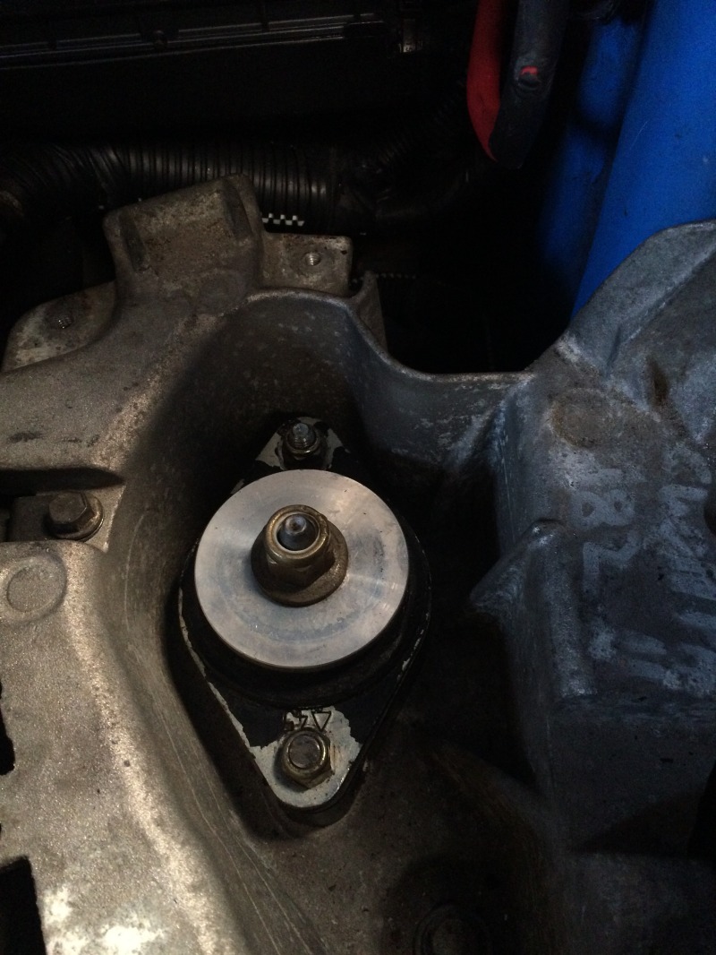

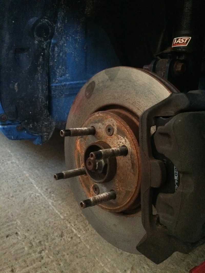

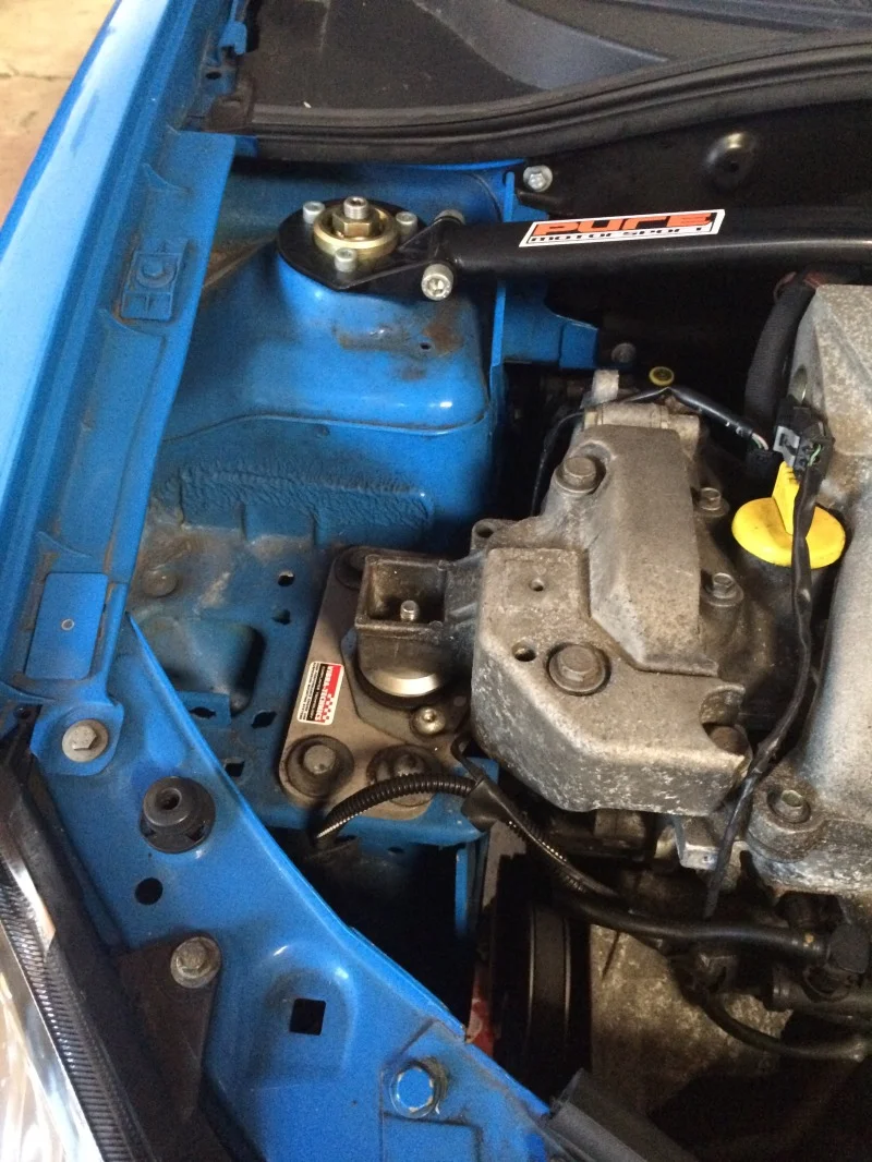

Managed to fit the new engine and gearbox top mounts this evening, next on the list is the wheel studs and fixing the rear cage feet. No photos as boring really!

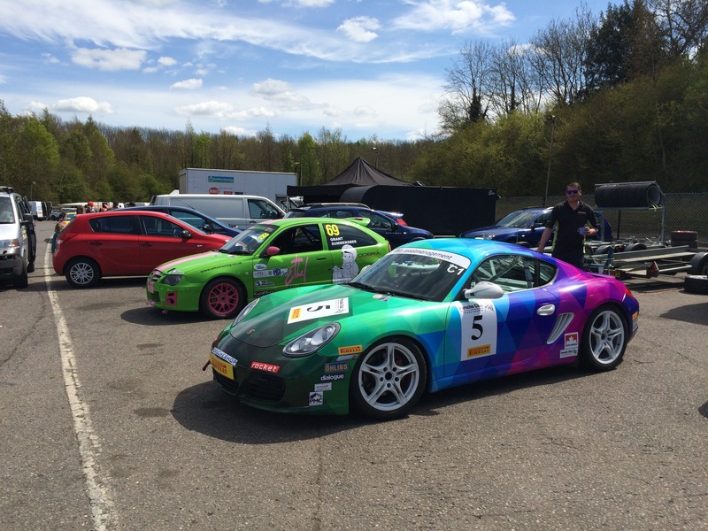

So it’s been a while since I lasted posted, been busy with other things recently, had the opportunity to help support with a Porsche in the GB Porsche cup championship this year, and had the first meeting of the year a couple of weeks back @ Brands. All went well with an 8th place finish in the second race for Nathalie McGloin Racing!
Also supporting a friend in the MG championship too, few issues in race 1 for him with the PAS fluid pissing out of the rack, but solved for race two and went very well with some very respectable lap times and a decent finish in class:

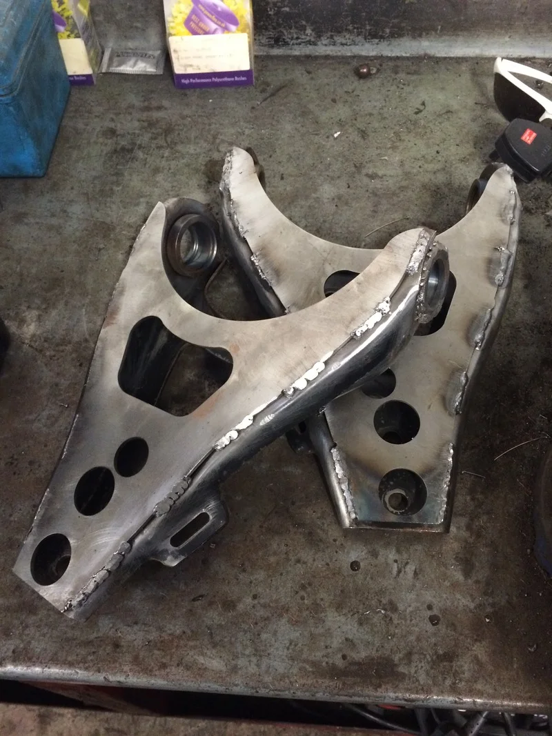

I have nearly completed my PMS front wishbone upgrades, just a lick of paint to go and press the bearings in.

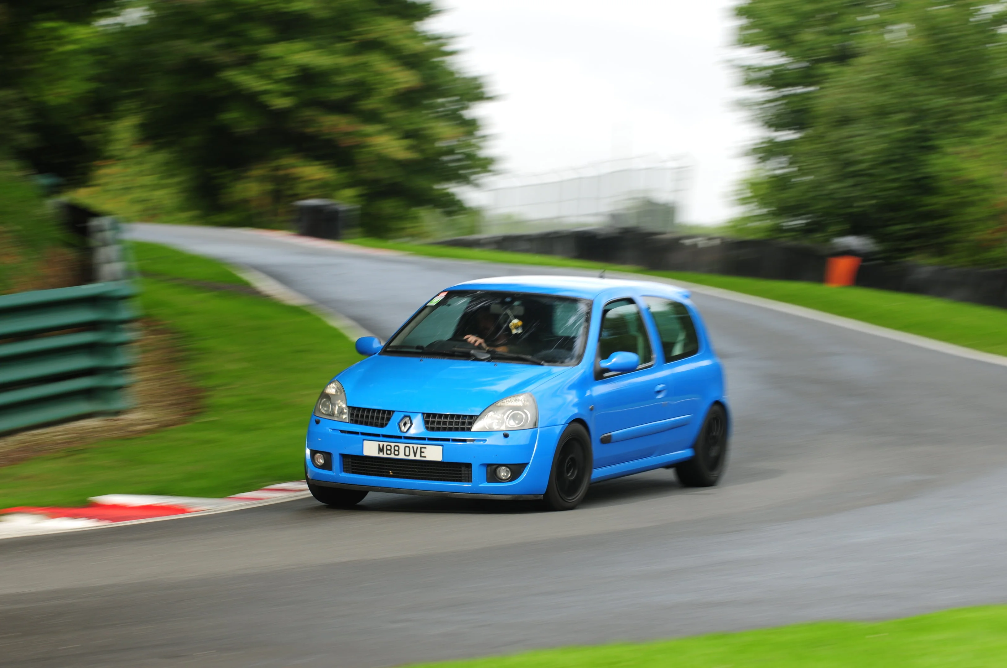

hope you get it done finally matey and on track! :) here's mine at Cadwell for inspiriaton!
did you ever get the RS2 mapped before you sold it all those years ago?
And jealous of those sills, they are immaculate!
Never got it mapped mate, just ran it as is, there was always plans... never came off. The usual thing.
Thanks for the inspiration! Looks great!
