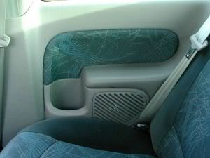

yea i surpose, the problem is i have 2 subs wich drown out all the mid range and focals, recently the 6x9 soubd really s**t due to all the base going through the rarcel shelf so really want some componants in the back, what watts are the normal speakers in the back as i dont have then connected. would the 6x9s fit in there?

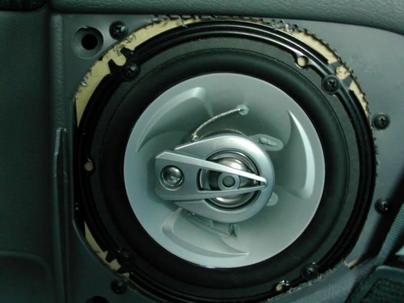

The standards are probably about 2 watts rms!! No 6x9s wouldn't fit. If your up for some cutting you can get 16cms in like so
Hidden behind teh standard grill (old old pic!) 172 interior in just now, till sunday :(
Personally Id amp the focals if you havent and set it up properly so the bass isnt drowning out the mid and high range. Fit a bass controller if you want to have teh bass up loud occasionally but fo rgood sq the rest of the time.
