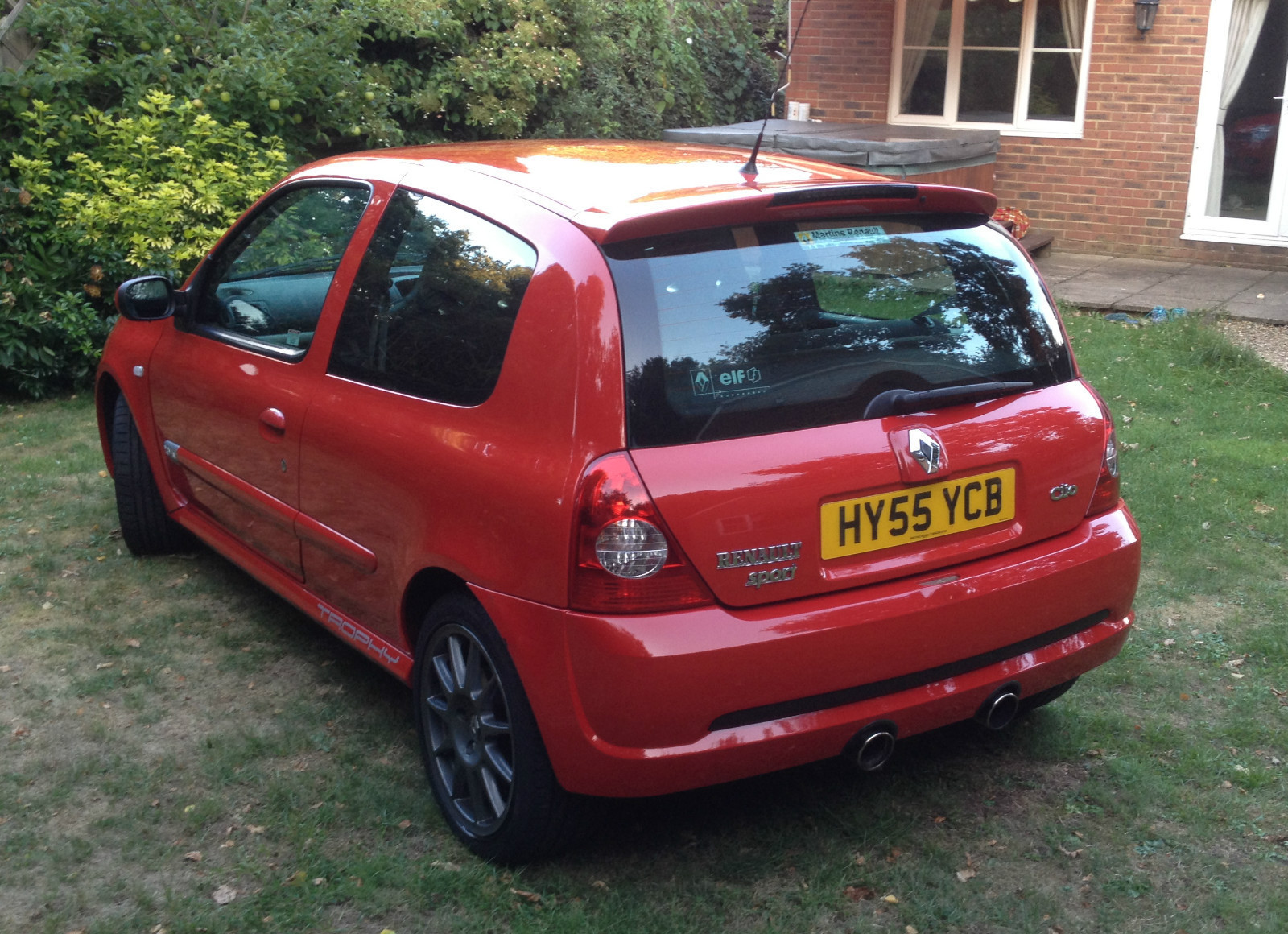

Hey,
well this is my second clio My first one was a 1.2 extreme 3. I had always loved clios the is just something about them. I had done a few bits to it like 172 alloys, RS grill, Stereo and stumpy arial but it never had enough power.
So here it is Number 198 Trophy It needs a little work done to it but is in prity good shape.

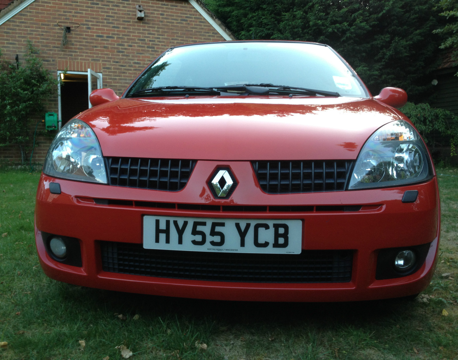

Looks very tidy!
What's up with the O/S fog light or is it just the photo?

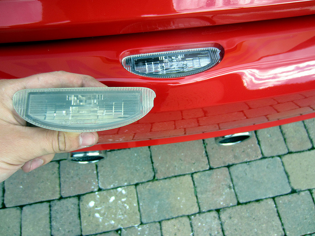

I just changed the rear number plate light on mine, it has made a big difference for £7 so well worth it...
IMG_0246 by tommo1991, on Flickr
Little update i have fitted a new number plate light and wow it makes a big difference.

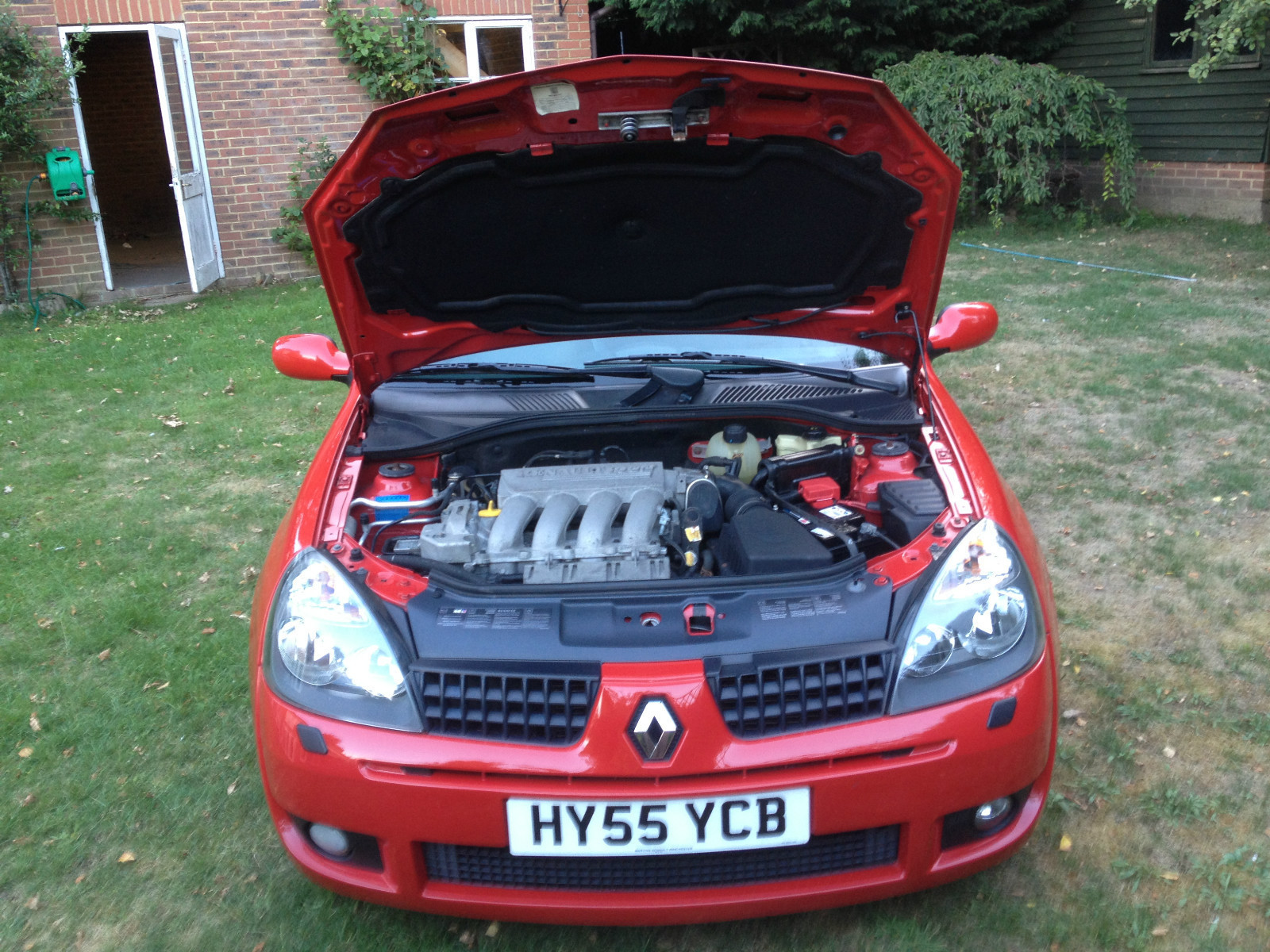

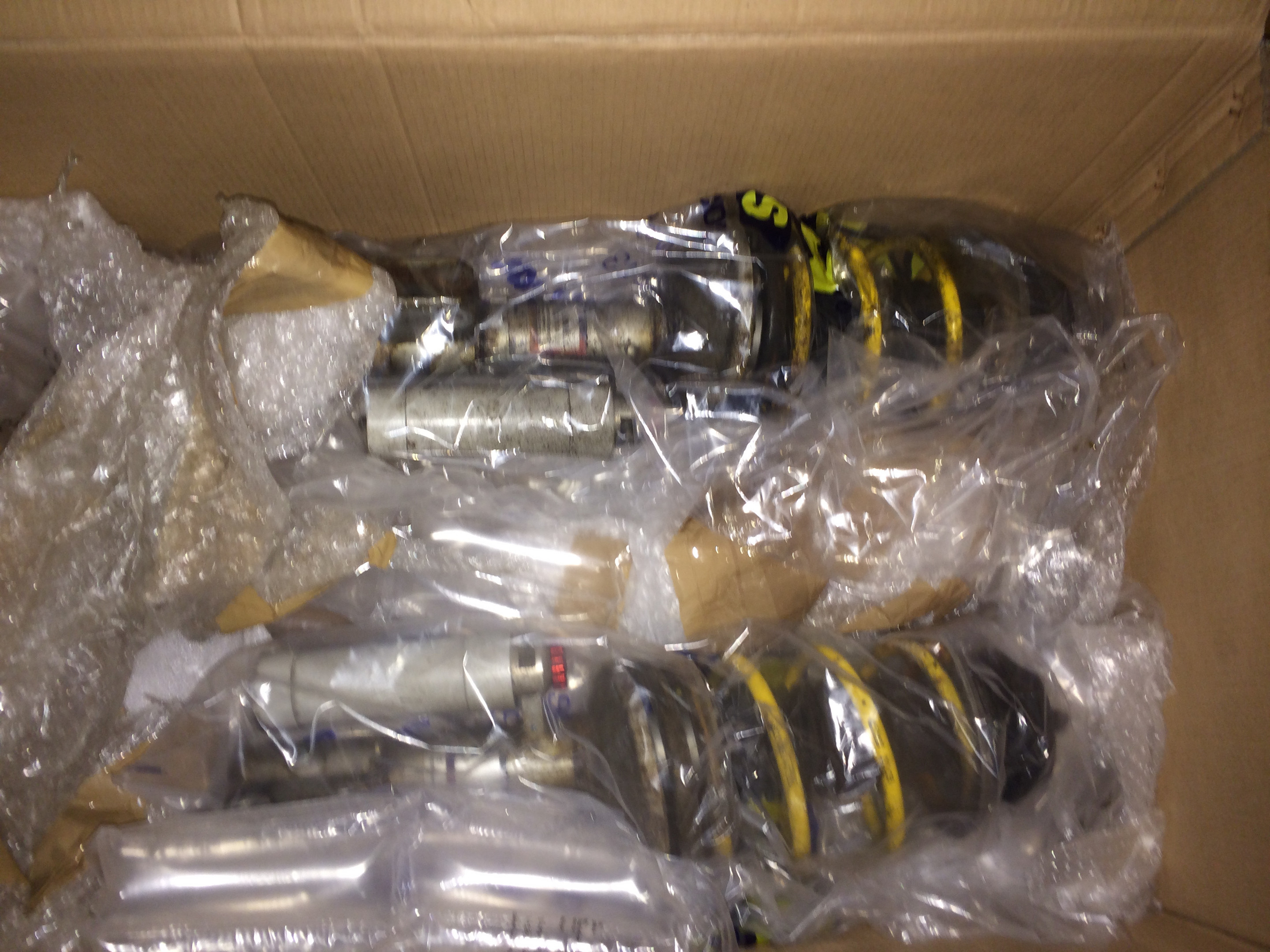

Been a busy few weeks. I serviced my car oil filter, oil change, air filter, brake fluid, plugs and leads and a few other bits. When it was up in the air I noticed a load of oil in the front offside damper :( so that was it off they came and straight to BG Motorsport for a nice rebuild.
I also got some new tires for the front (Handkook V12s) I also did all the exhaust mounts. There was also a bit of a rough idle so I had a look and the throttle body was dirty so gave that a clean and replaced the map sensor.
One day I was driving to work and the car went into limp mode. I plugged her in and it was a fault with the throttle body and the throttle pedal. So I thought that could just be the wires between it so I unplugged the throttle pedal and there it was dirty connectors so cleaned them up and she was back :)

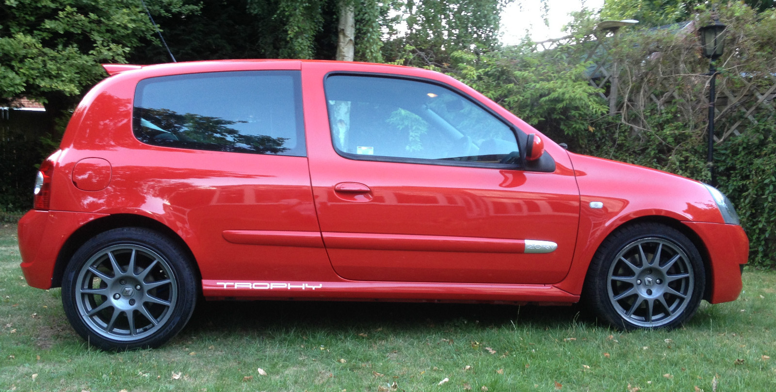

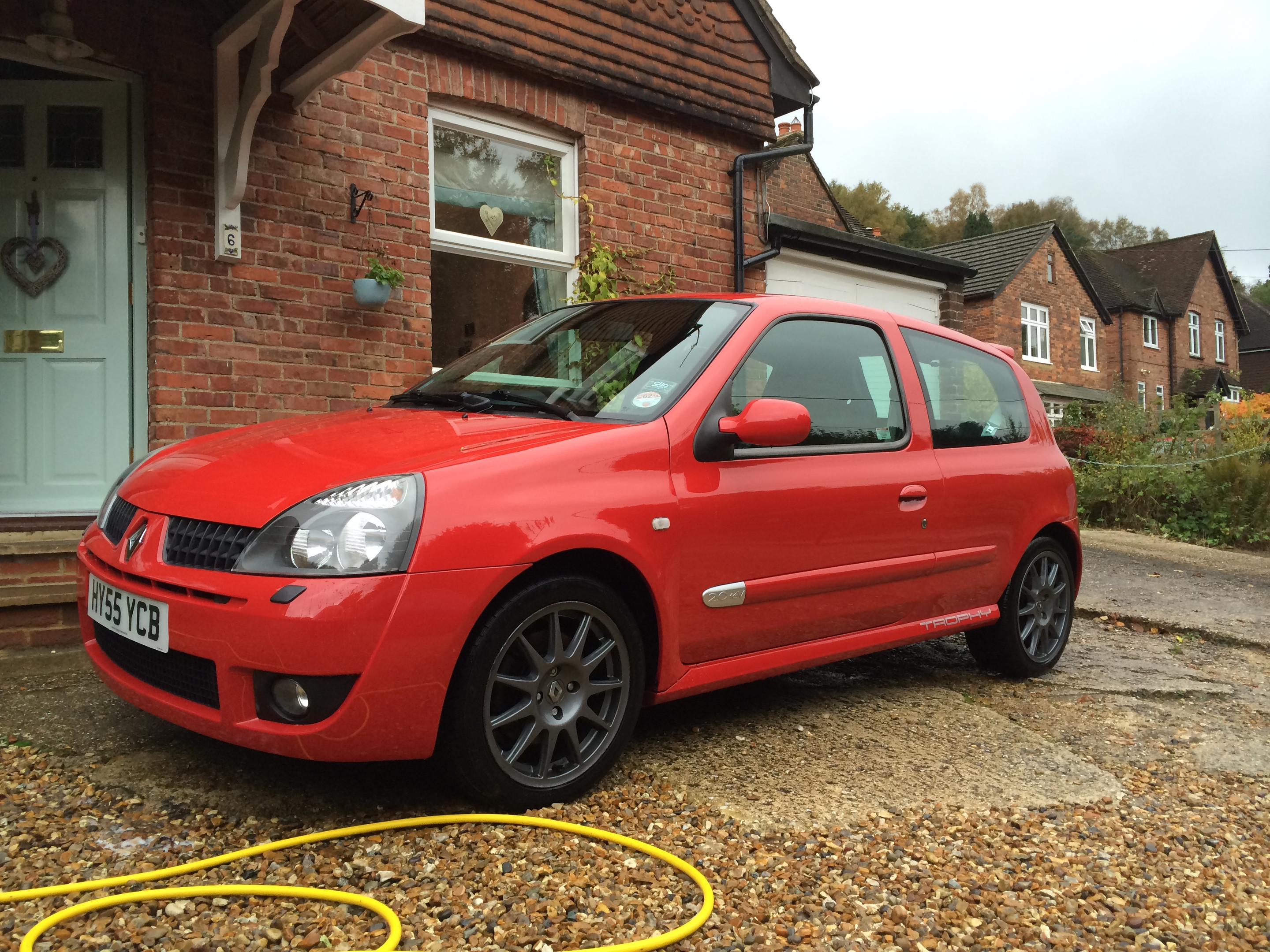

A few pics of here after a good wash
  Clio Trophy

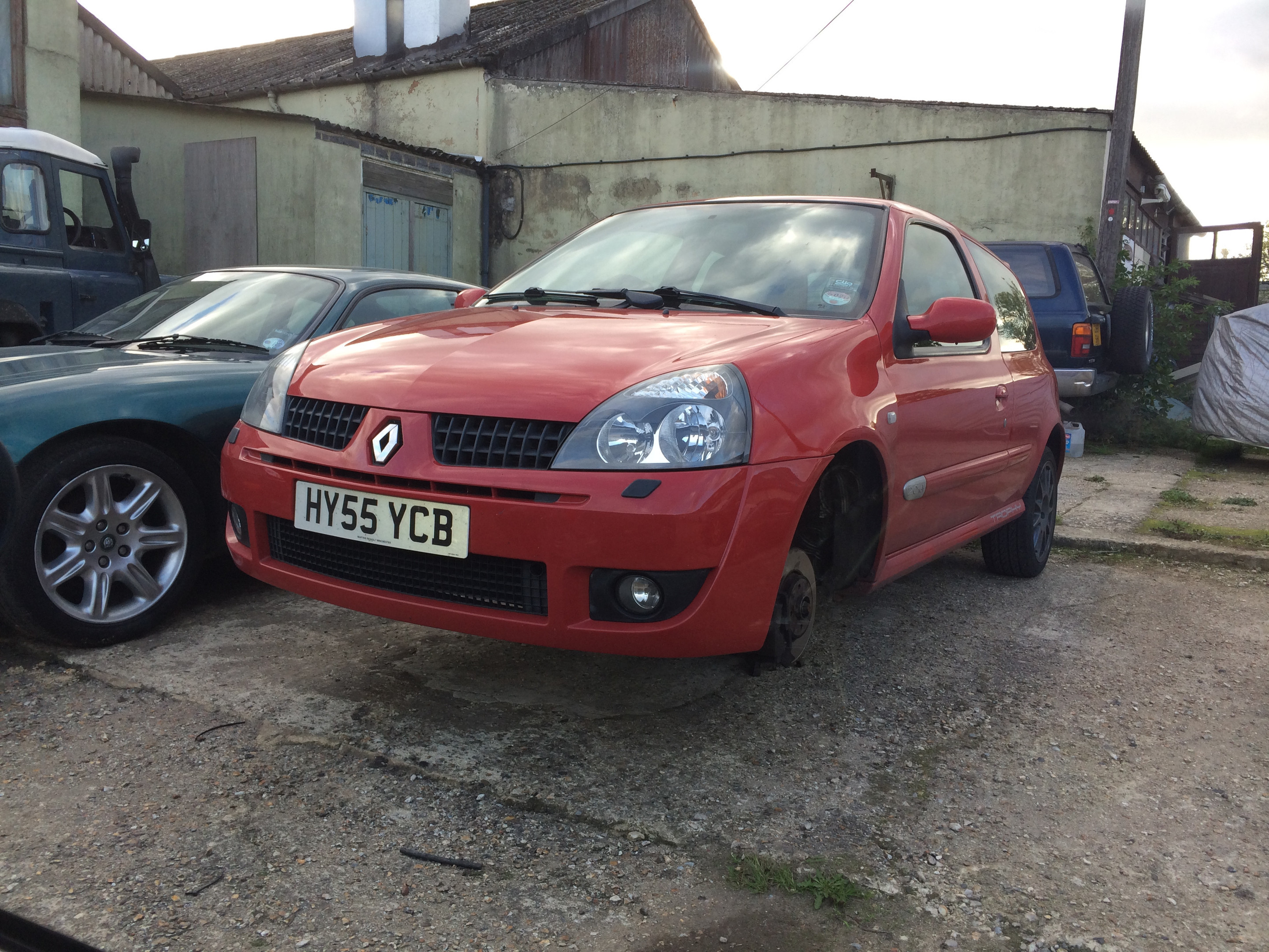

my poor trophy has been thru some troubles lately :( found out the dephaser was dead so that was it aux belt, tensioner, cam belt and dephaser all done now :)
