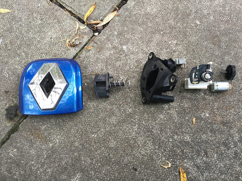

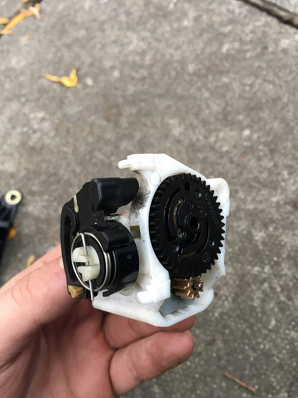

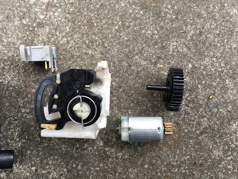

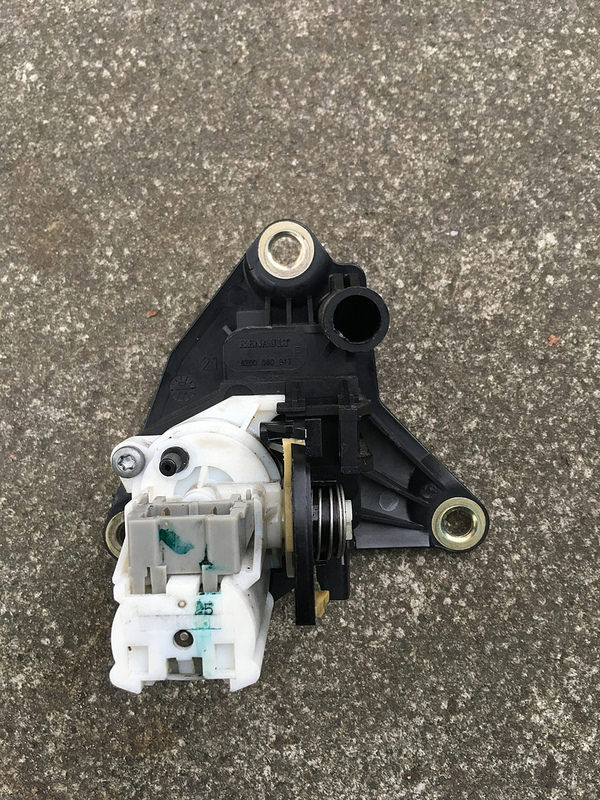

Boot lock, I took it all apart, thought I'd grab some pictures as I thought it might be useful to someone one day.
So yeah, in my case, the little grey motor is shagged. I locked the boot with it all exposed, lovely little puff of smoke from it, so it's goosed. I'm hoping to sort a new motor for it, as opposed to buying a whole replacement lock, maybe I'm just a cheap b*****d, but meh.

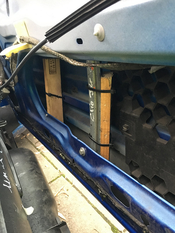

Drivers window wasn't going all the way down, it was hitting something very firm, seemed odd. The reason was, very, very odd:
I don't even. The wood was blocking the window from going down, I don't know why because the window functions perfectly fine. Needless to say, I've removed that crap.

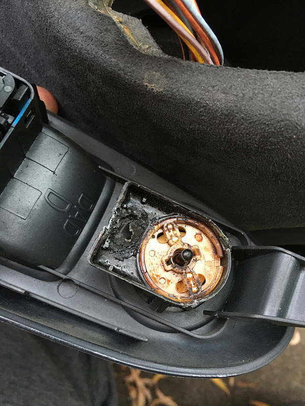

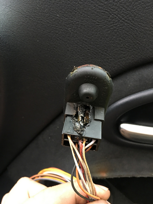

Slightly more concerning was the reason why my mirrors weren't adjusting:
So that's definitely been on fire at some point. No idea what's happened, it's short circuited obviously. I'll get a new connector block, and solder that on, and sort out new adjuster knob thing, no rush really, but it'll annoy me if I don't sort it.

What on earth is that wood?!?!?!
That switch I'm guessing is the victim of Renault's great design where if you open the window when your car is wet, it all drips onto the window and mirror switches.

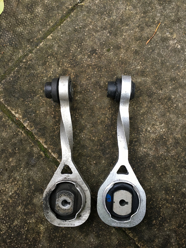

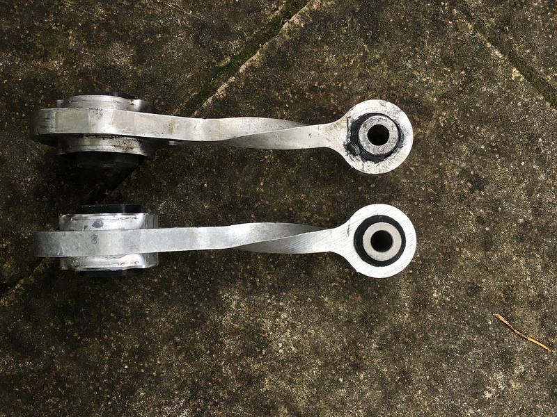

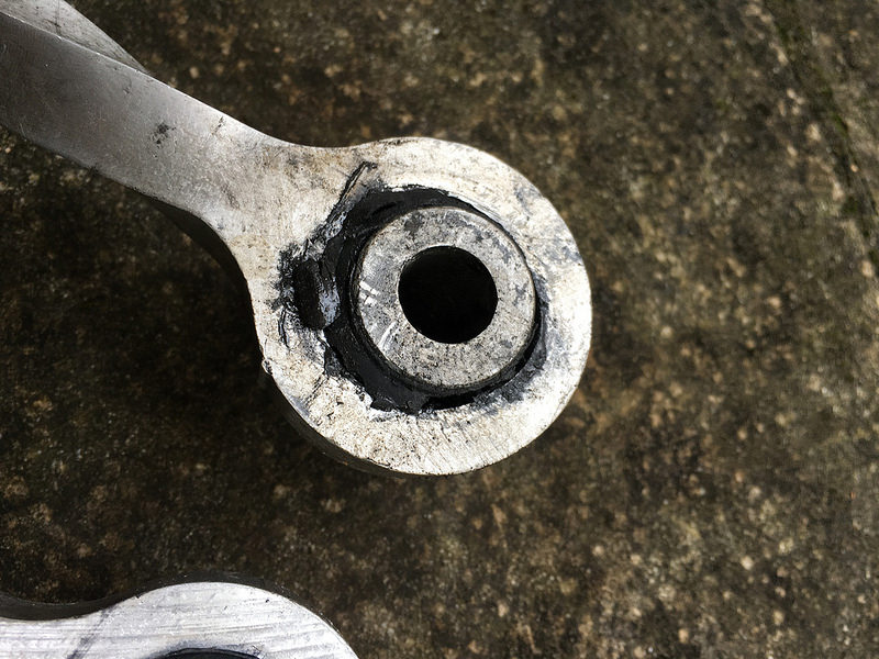

Old dogbone was shagged, so hopefully that's sorted. Still want an OEM engine mount though.
Boot lock is sorted now, new solenoid fixed it.

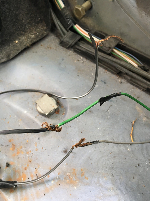

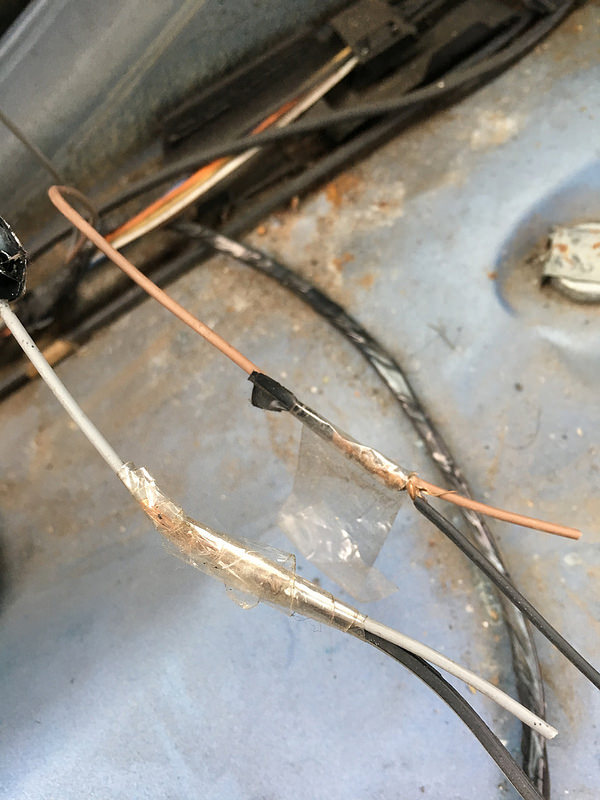

Unfortunately I did find more examples of bodgery:
Evidentally not that bothered about wiring. I didn't have my soldering kit on me, so couldn't sort it, but I'll put it back to how it should be in the fullness of time.

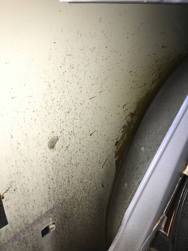

I did notice this however:
I can only assume the seal has gone between the inner arch and the body? No signs of corrosion or anything like that, but not really ideal.

It's had aftermarket speakers in the past, so the audio cables are a bit... improvised.
