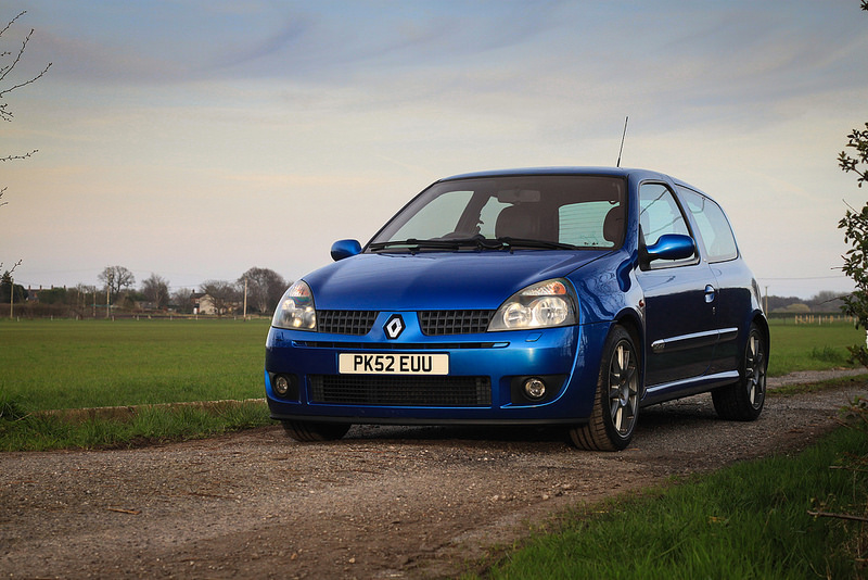

So this weekend myself and Chris spent all day Saturday detailing the Cup and his 200.
No in progress shots, as I'm far too lazy, but I took it for a drive this evening and grabbed some shots.

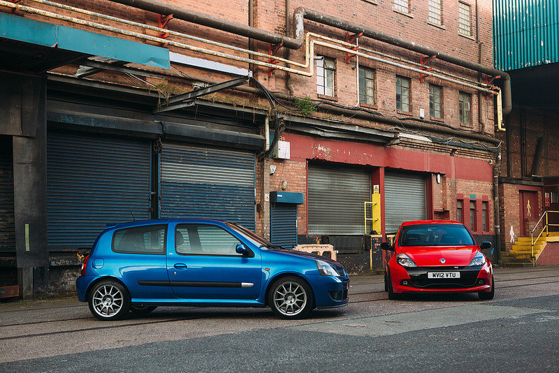

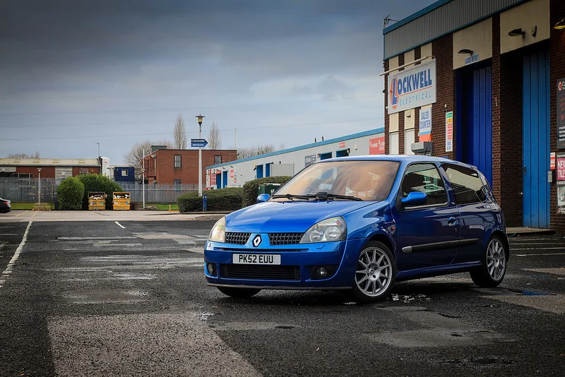

The very talented @Niall got some photos of the Cup with @Christopher a few weeks back, was a good laugh as well as nice to have some photos done.
They're all fantastic as always, but here's a favorite of mine:
Hopefully a full wheel refurb will be on the cards soon, I'll be going back to silver, with an OEM Cup very much in my mind.

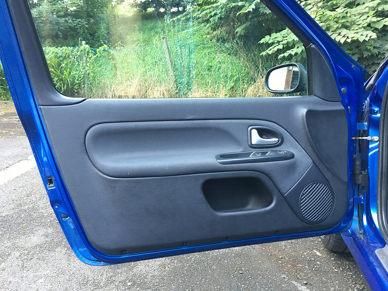

Some decent progress, I've sorted the leak. Seemingly the doors are supposed to allow a certain amount of water through them (more than I expected though) based on the fact that 3 different doors have now done exactly the same thing. The door card has a seal on it, like a sticky substance (lol) that doesn't dry hard or anything and prevents any splashed water from making its way into the car.
So, replacement door cards are now on the car, with a ludicrous amount of sealant, which appears to have sorted the water getting into the cabin issue.

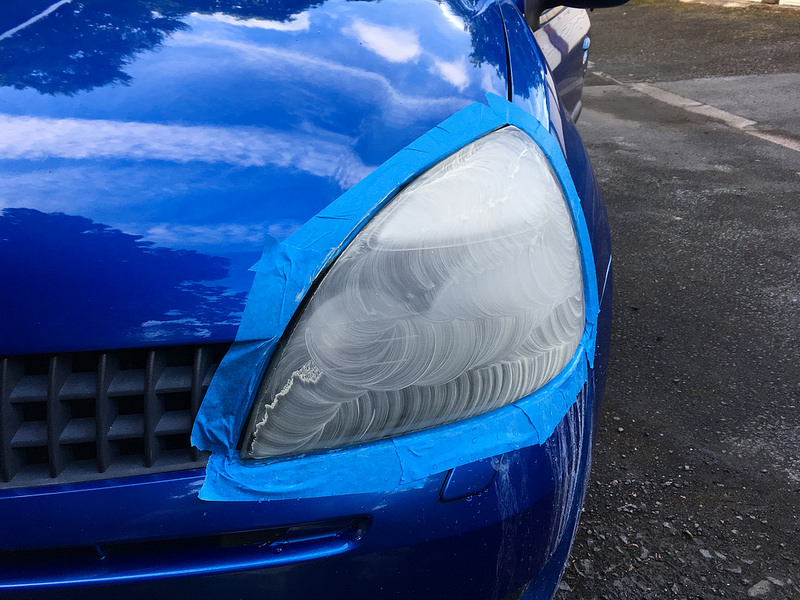

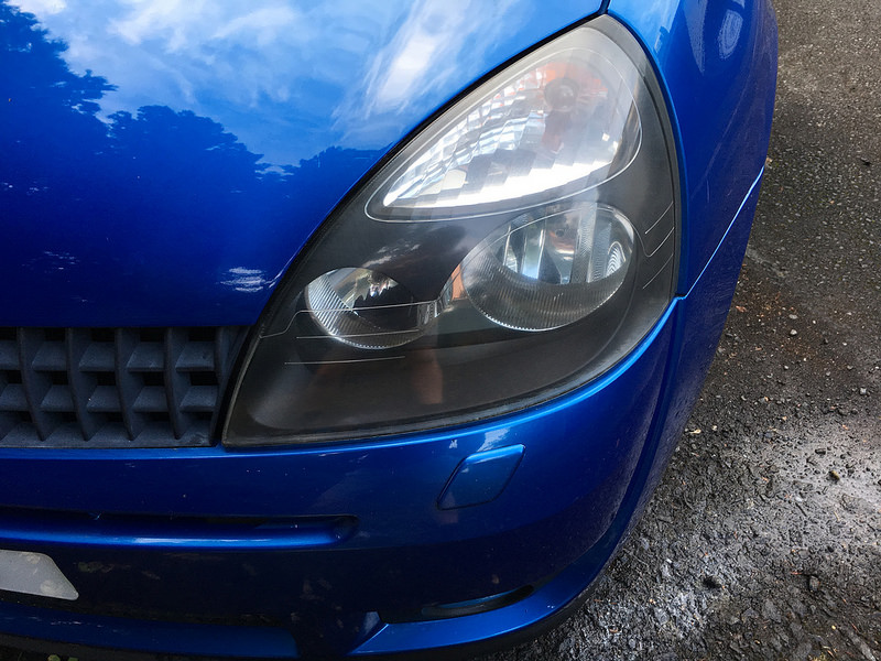

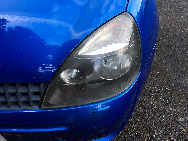

Also gave the headlights a polish, not perfect but they're much better.
Needs a DA to finish it I think, but the 3M kit is good still.

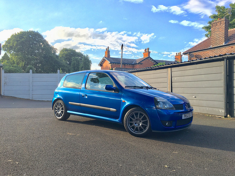

Most notably I had the wheels refurbished in the end, look so so much better in silver. Coated in Gyeon Rim, they should stay looking fresh for winter, they'll get some love again in the summer.
Serviced the car, nothing of any interest there, the sparks looked fine and the oil was nothing out of the ordinary, so that's all good. I've got some refurbed injectors on the way, so I'll get those fitted next week. OEM engine mount is so much nicer than the Powerflex one, each to their own and all that but I don't know why anyone fits them to their car.

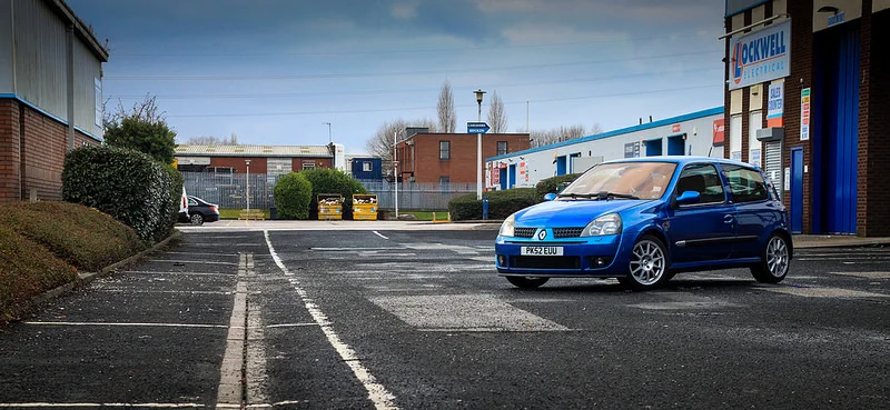

Grabbed some photos of it this afternoon, still liking the black door strips, but might go back to blue in the summer, once I've had my original ones resprayed.
