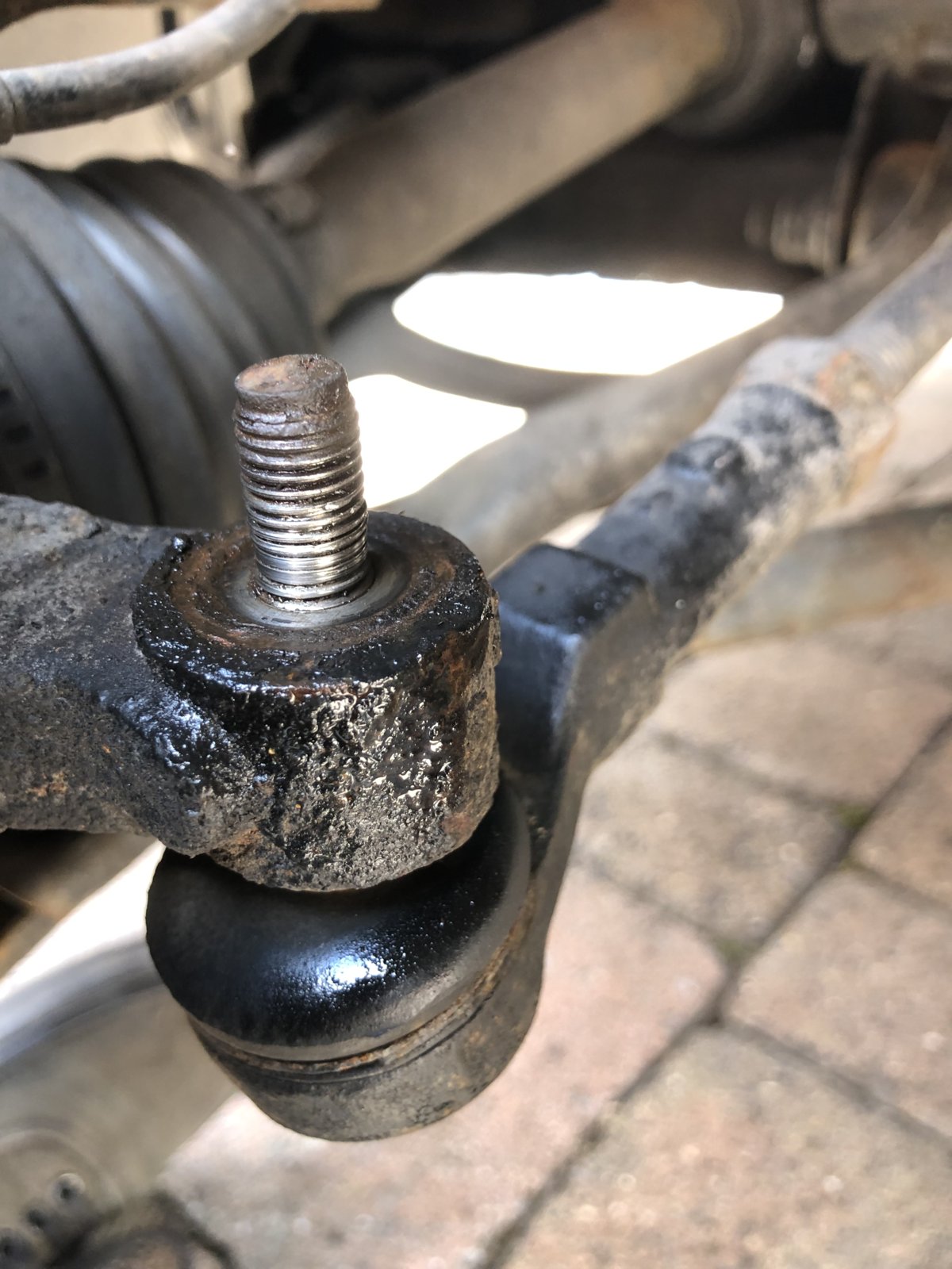

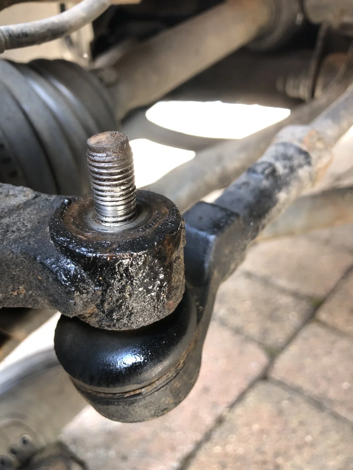

Had a bit of a knock when at low speed going over big bumps so decided to take a look today. Both front wheels off the ground I've got some play in the passenger side wheel in the 9-3 position.
I checked all of the relevant bolts and bushings around that area and all seems tight. I removed the bolt from the Track rod end to find the threads had been completely stripped. Like its been overtightened!
I couldn’t easily get the TRE out to inspect it and didn’t want to mess with it as I needed to limp the car home after. Obviously this needs replacing anyway but is this likely the cause of the 9-3 wobble? I have read it could also be a CV joint or driveshaft.

Could also be a wheel bearing as well as the TRE with that much wobble.. That normally comes with a speed related droning as well though.
Changing the TRE is a piece of piss mate, just unthread the old one and thread the new and bolt it back up. No need for a garage.
You'll need alignment after though.

What makes you say inner? I couldn't check the inner as like I said I the TRE didnt want to separate from the hub and I didn’t want to force it with no guarantee of getting it back on with that thread. If the inner is fooked I guess it will feel very loose when I remove the outer TRE from the hub?
New TRE ordered from renault with part numbers from RPD - 7701474492 and 7701474493 - hopefully correct.

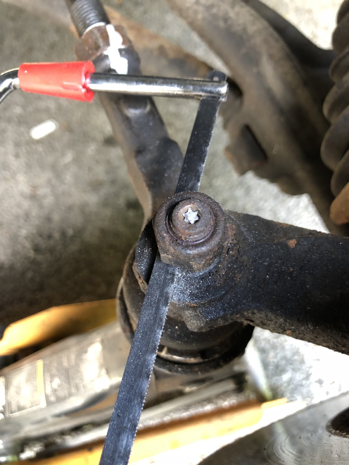

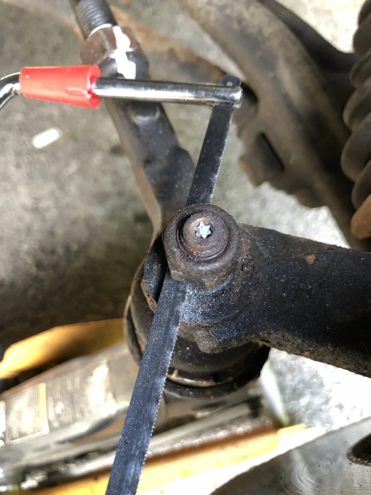

Changed the track rod ends for genuine renault ones today, seems to have sorted the wobble and the noise. The TRE on the passenger side did have a fair bit of play in it. Had to cut the drivers side off in the end!
Correct part numbers are 7701474492 and 7701474493 if anyone is looking
