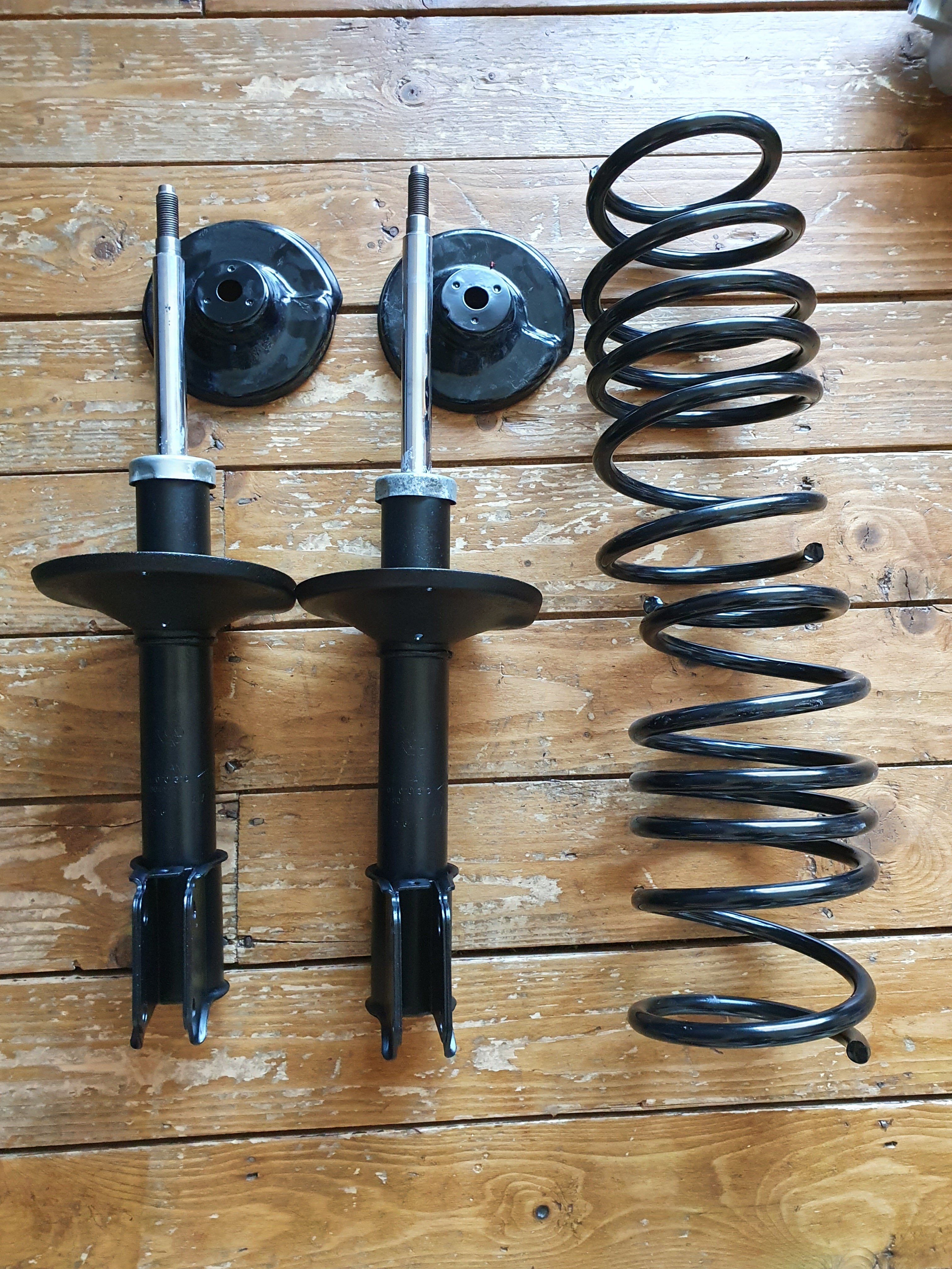

30mm lowering springs on genuine renault standard shocks with beam lowered to match

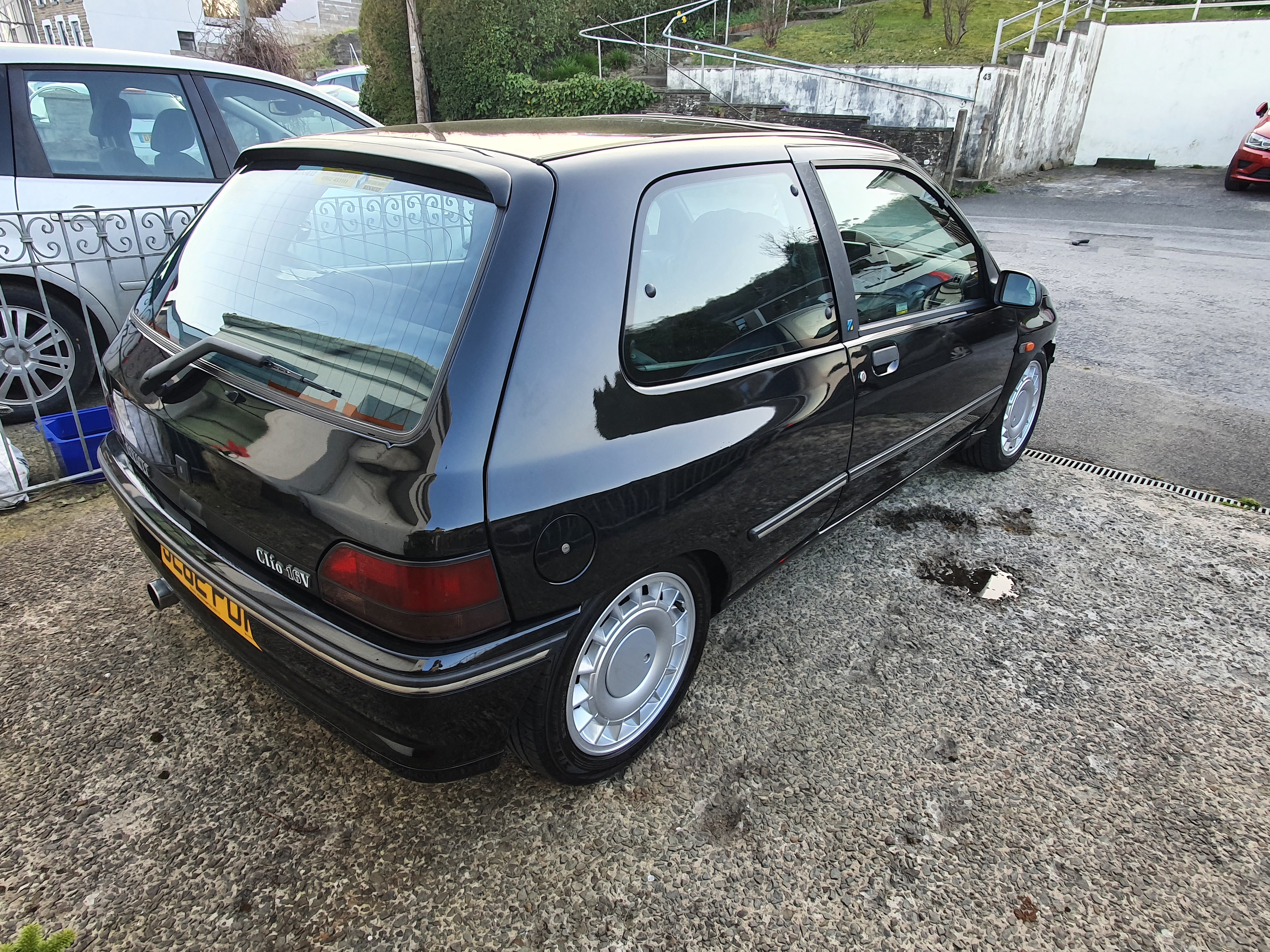

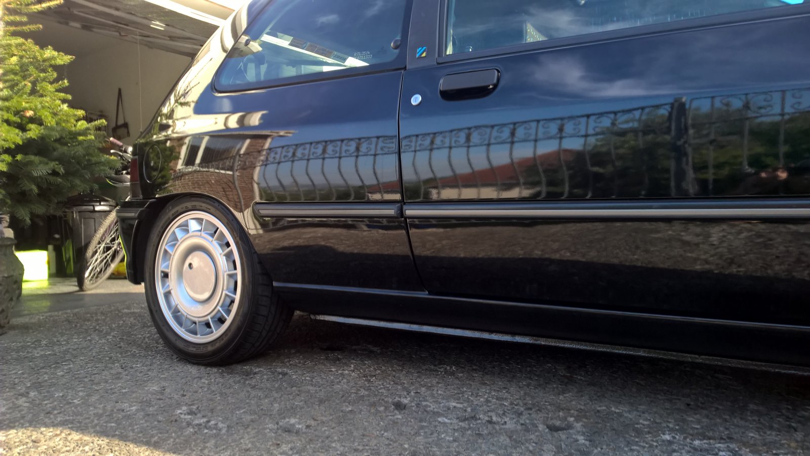

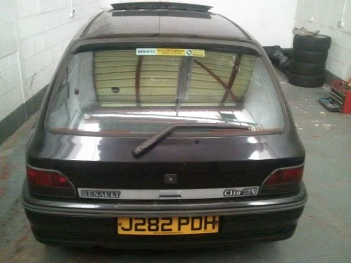

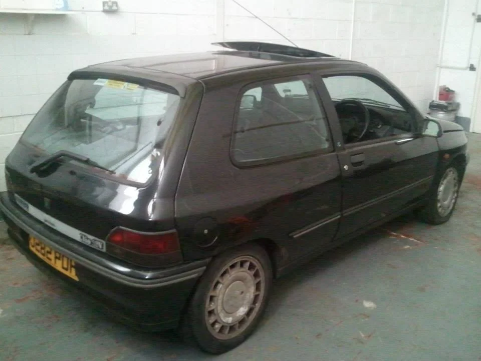

So heres some pics I have, heres when I originally picked it up, rusty arches/sills BADLY pitted turbines
Some of you may have spotted it on last years Fcs issue of Pfc mag

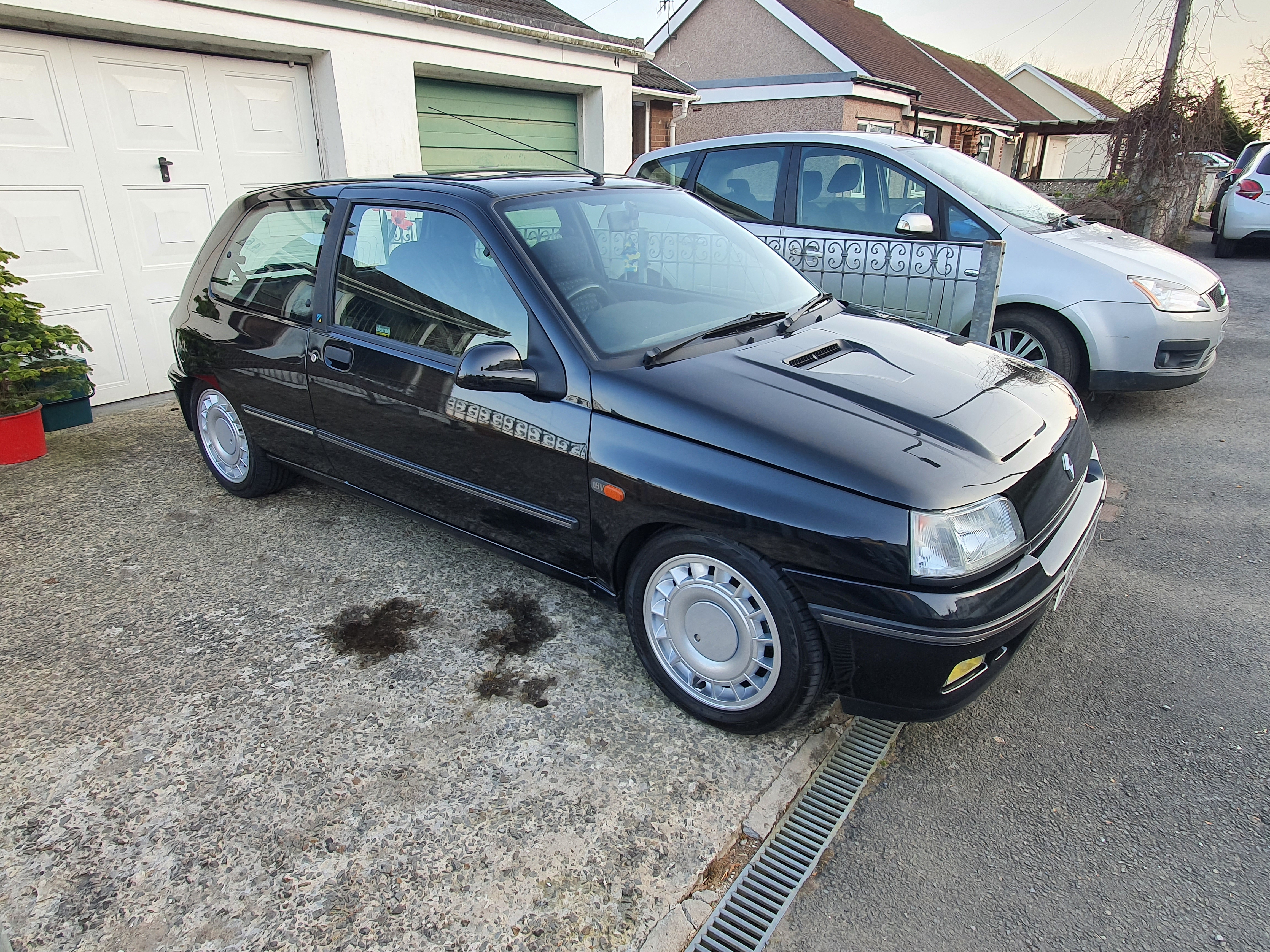

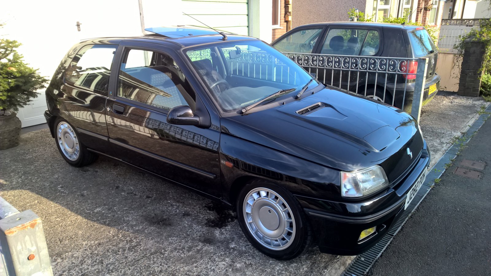

Few pics I have of it

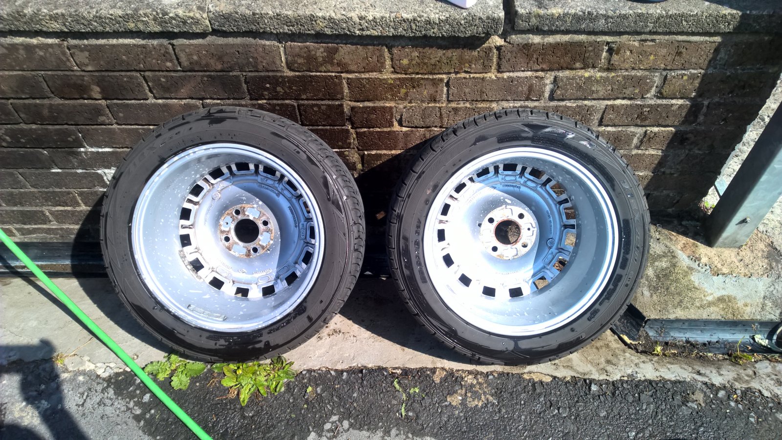

With willi wheels
At FCS
Not far from my workshop :smile:
Took a spin with another local 16v owned by tom :smile:

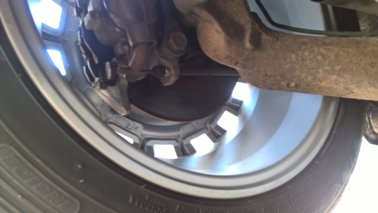

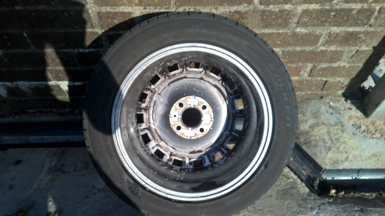

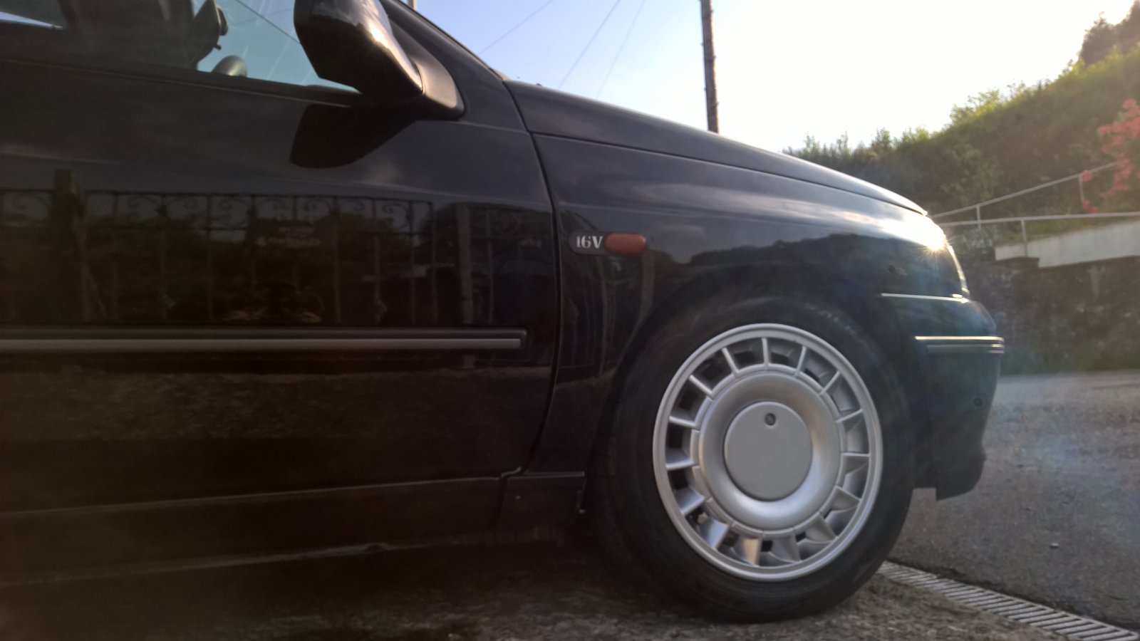

The ONLY modification I would do to this is wide track it at the front.
used to run 20mm bolt on on the turbo, looked bob on pic on stock wheels for reference (rear was 15mm spacers too)
I have some 16mm on the 172 so was going to chuck them on to see what it looks like
looks alot better than what I have now

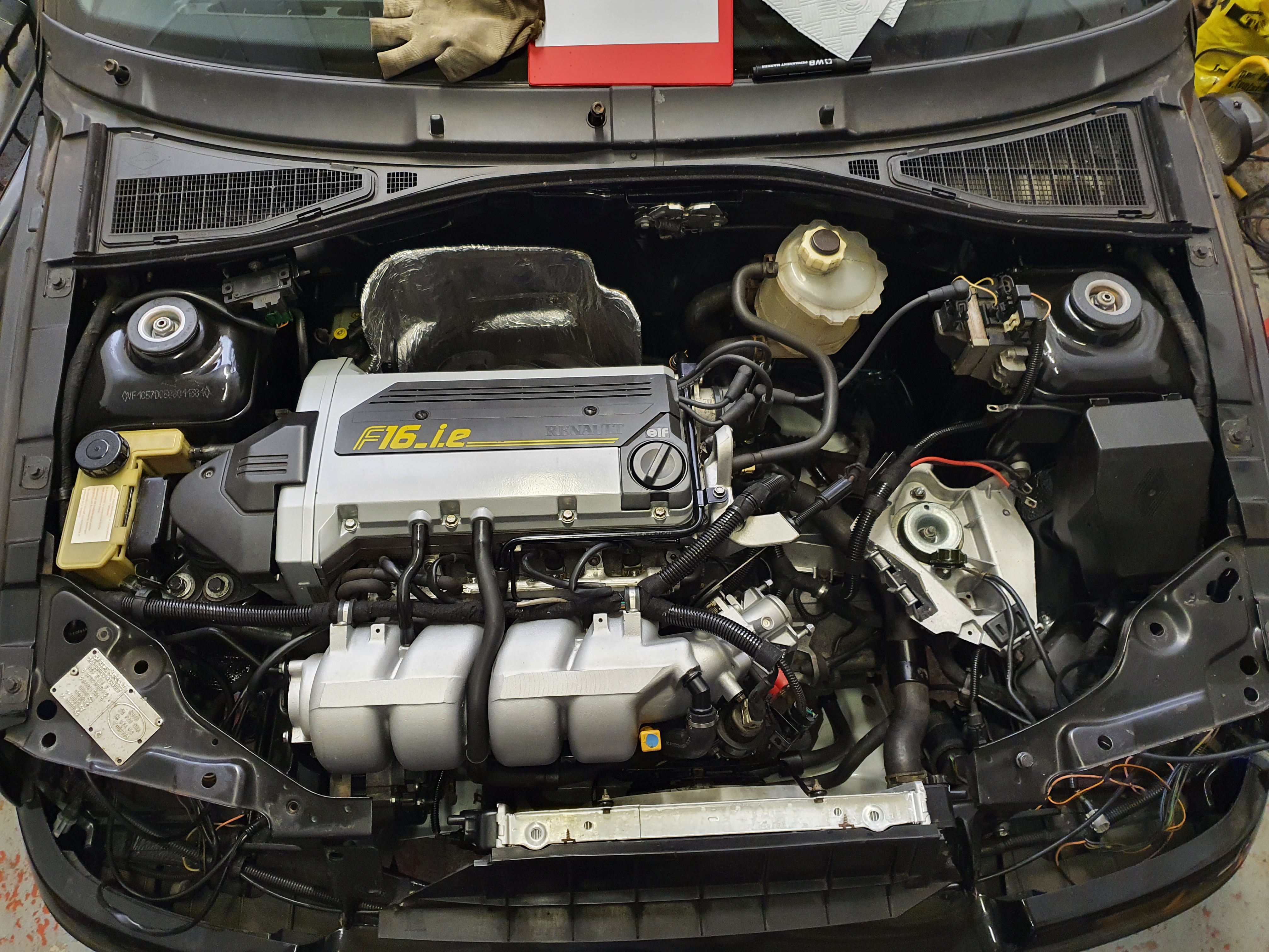

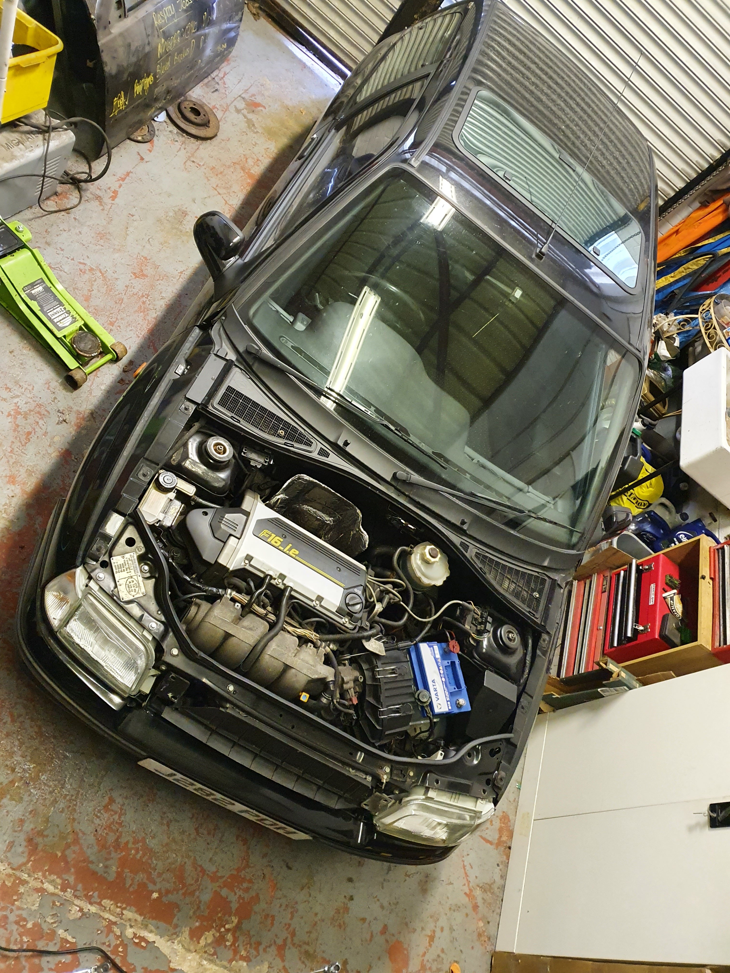

Iv never really payed any attention to the engine bay of the car as it just worked when I got It but its now time for me to get it looking as close to how it did from factory as I can
Couple of small issues I do have currently are that it can be very difficult to find gears at low speeds sometimes especially when on a hill so this needs investigating. I have a PAS hose that basically sits on the Exhaust manifold too so I need to do something with that also
I don't really have many pics worth of putting up just yet so il just add a few and then will be logging pictures as I refit parts 😊

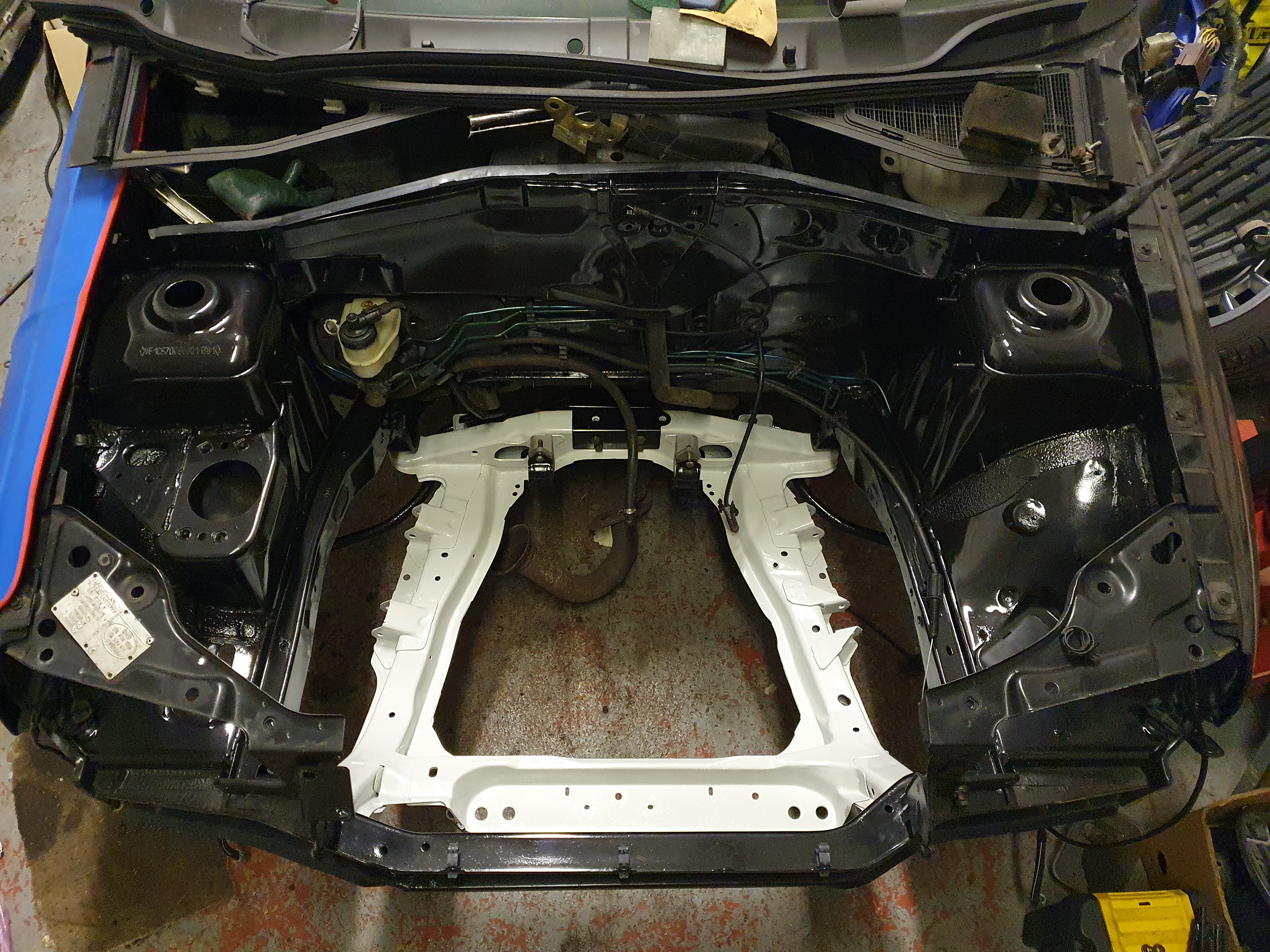

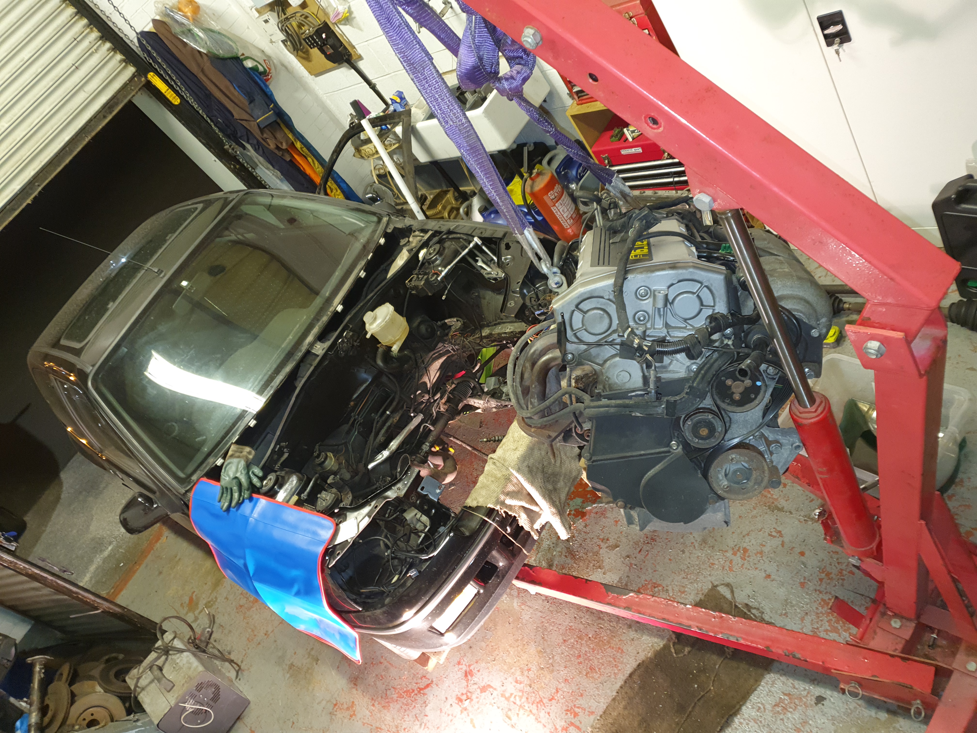

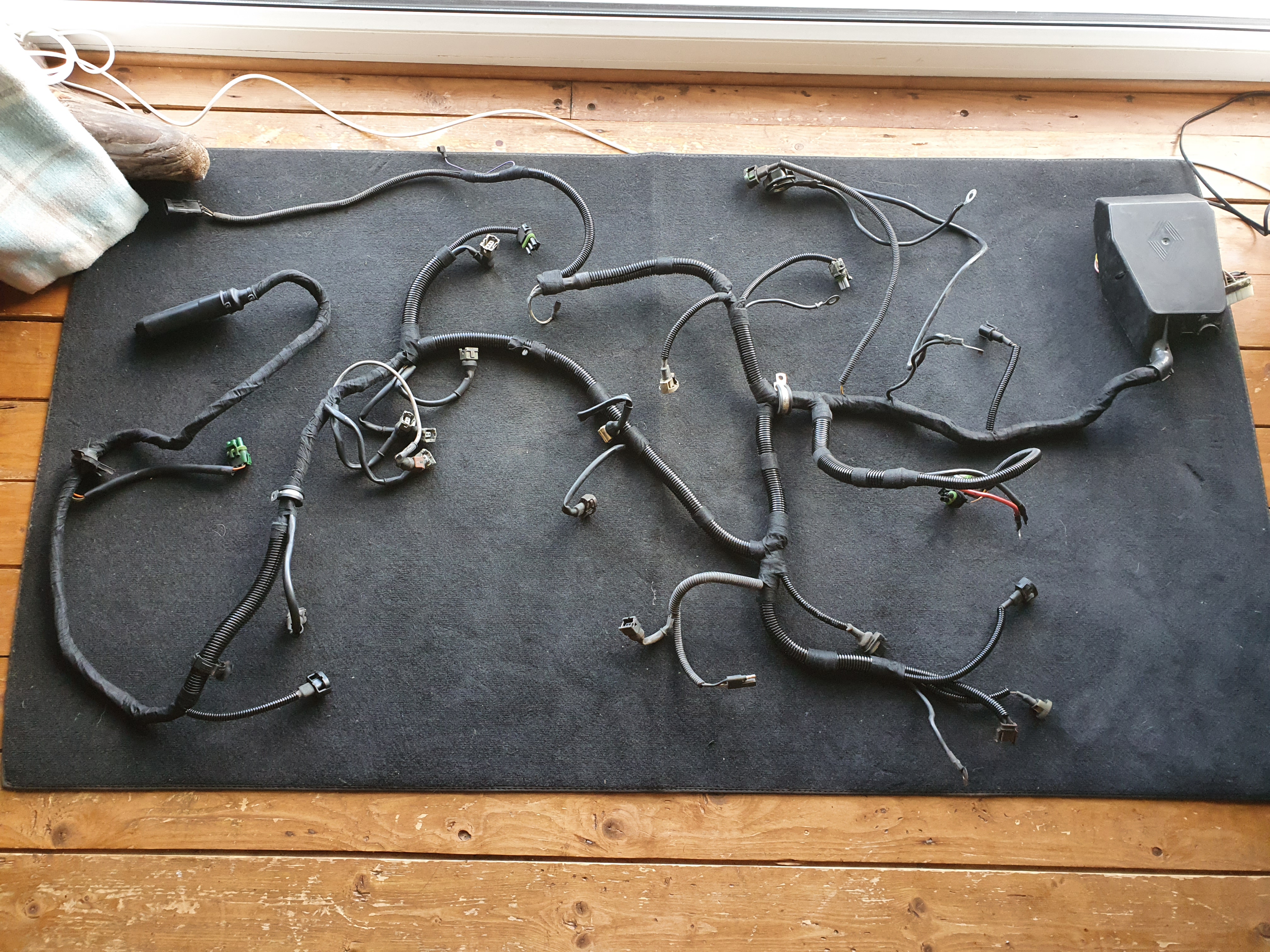

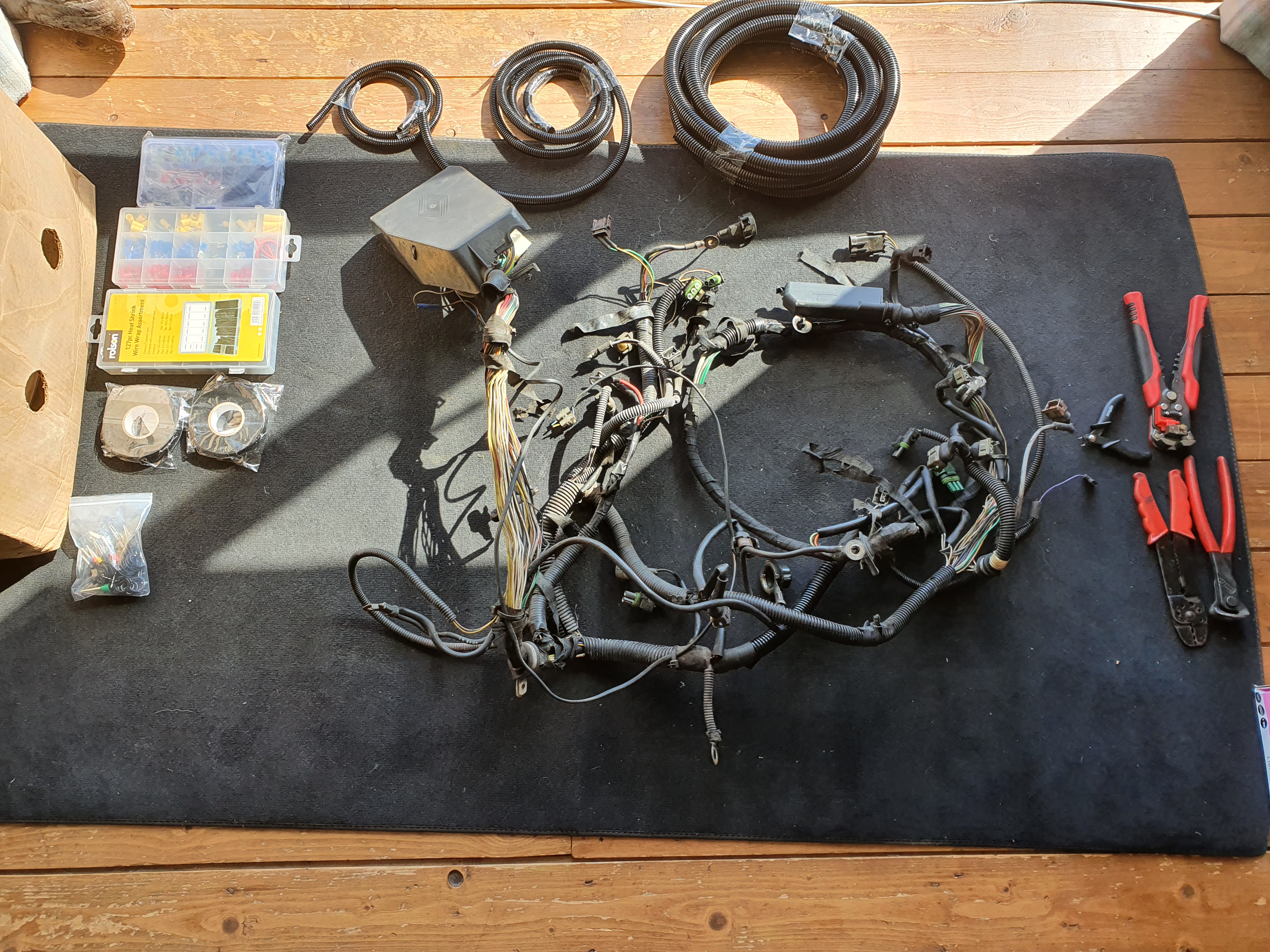

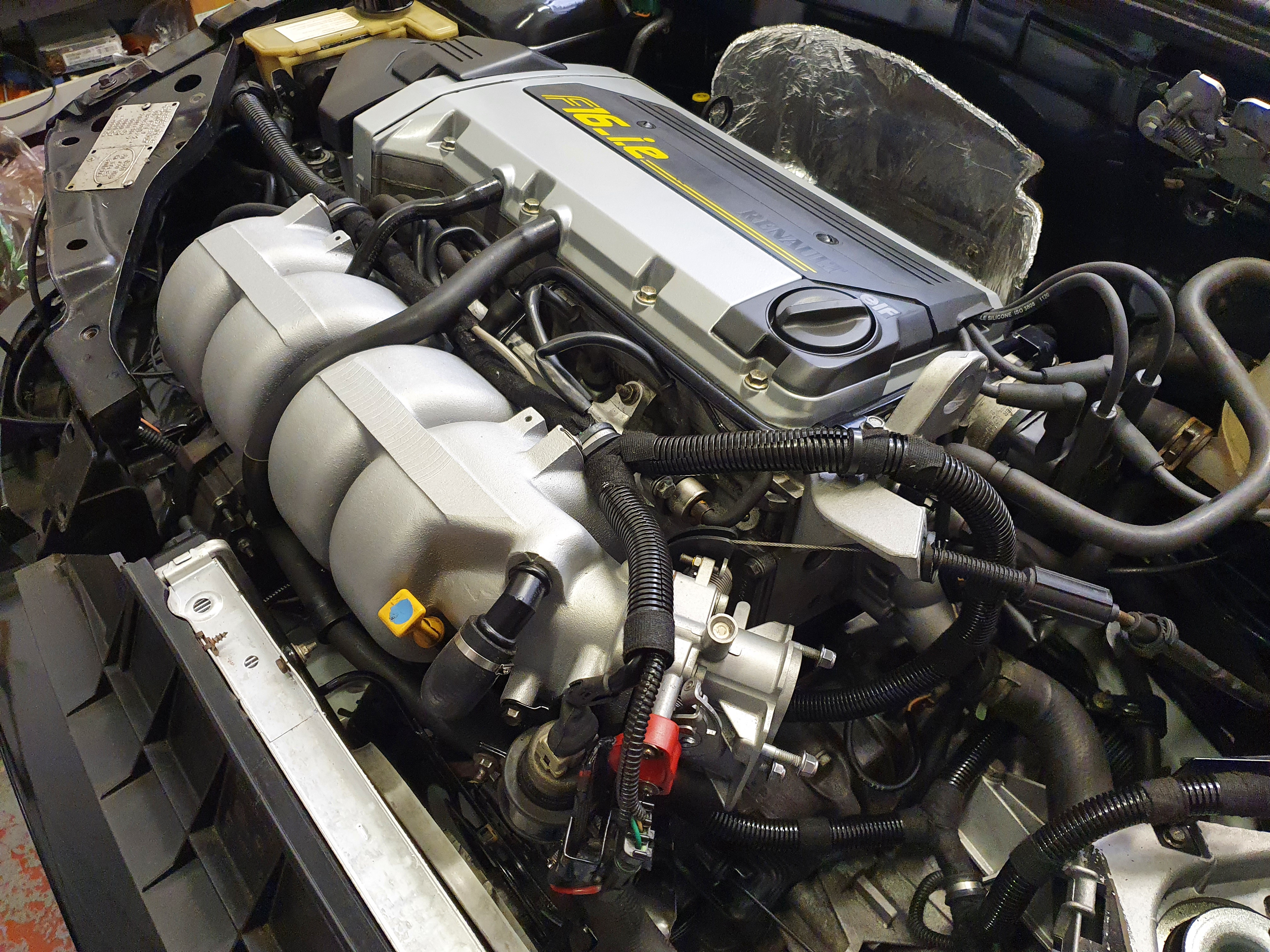

Things I have done so far other than explode most of the parts down are re wraping the whole loom as it let the bay down
Before
After

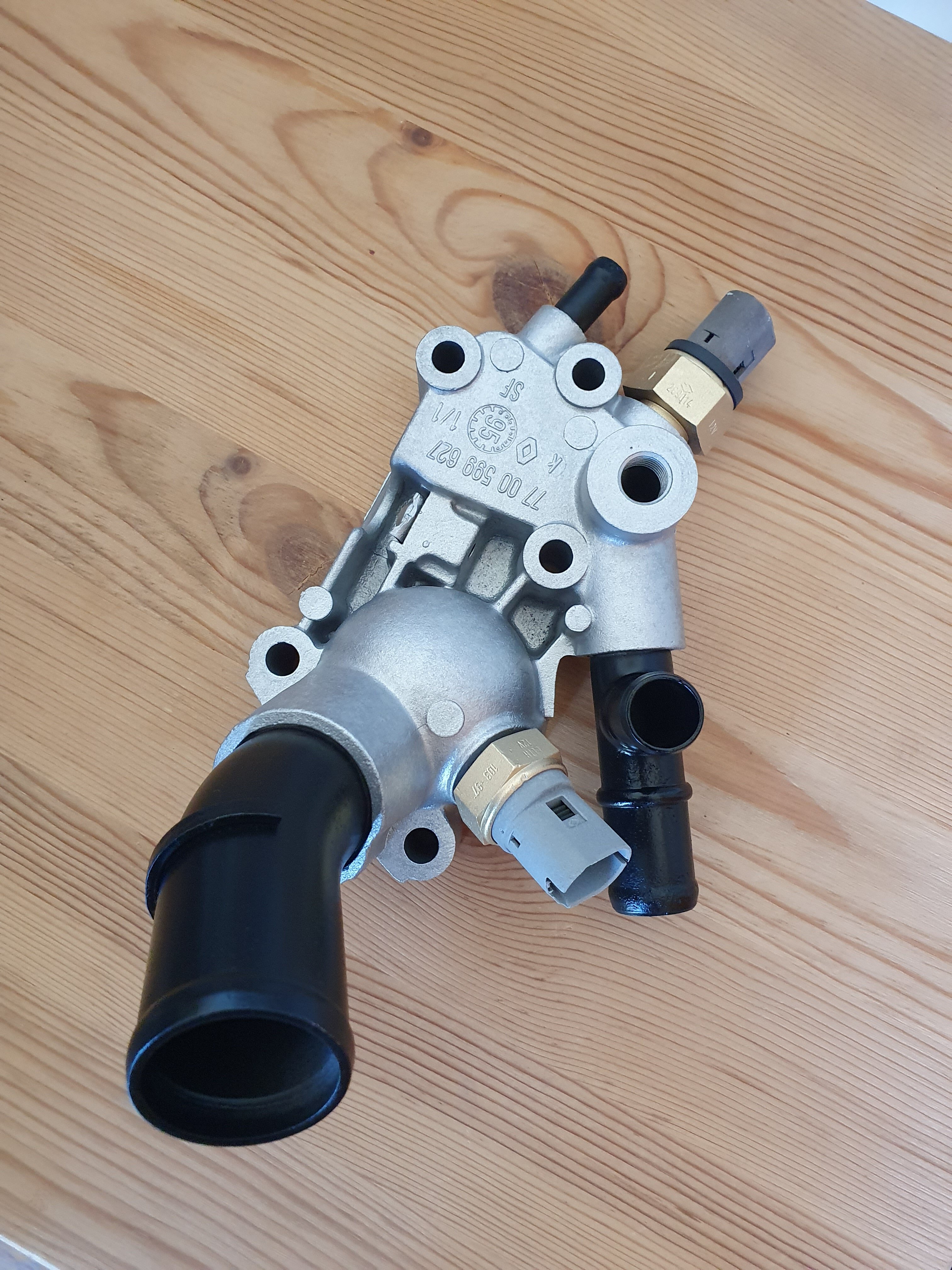

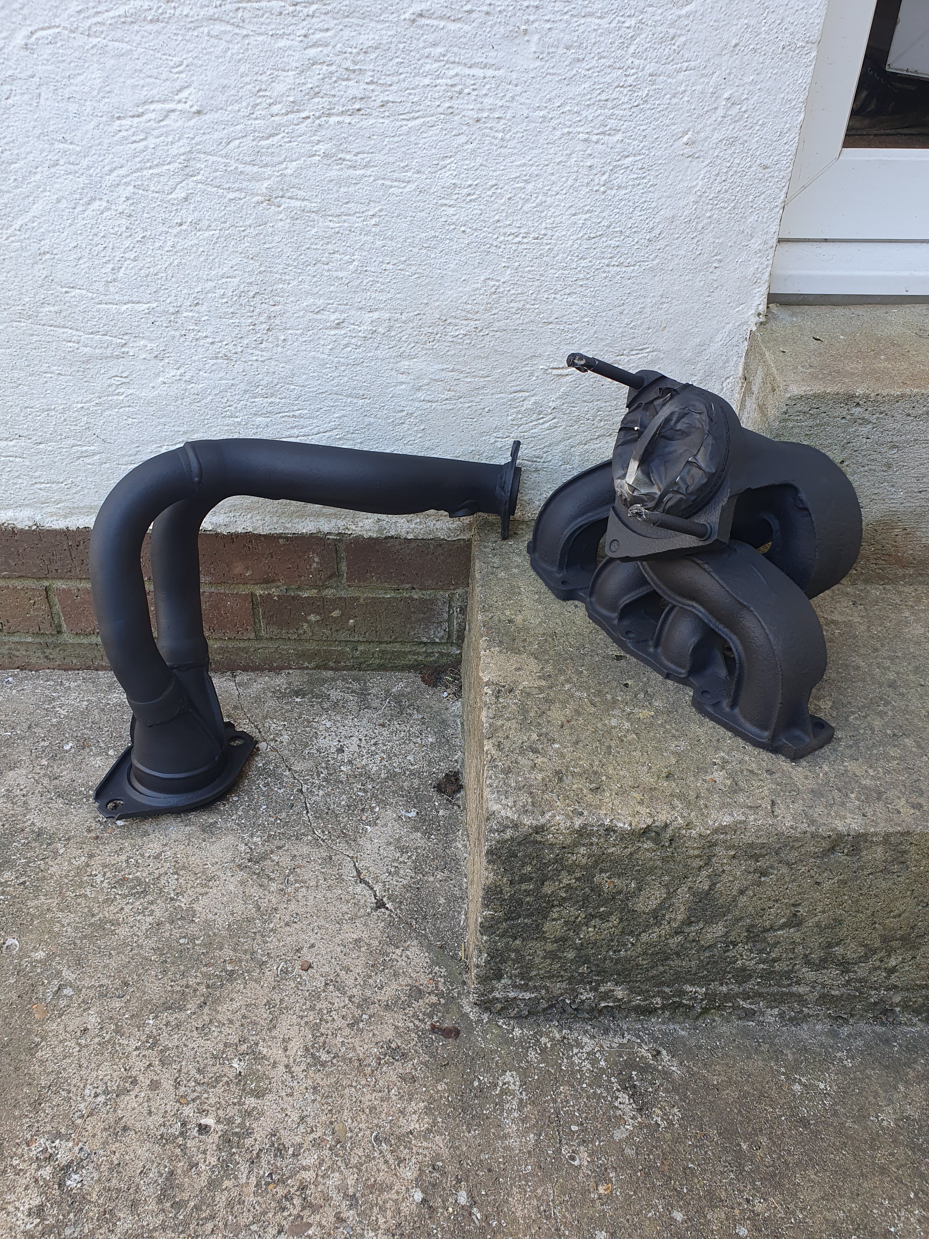

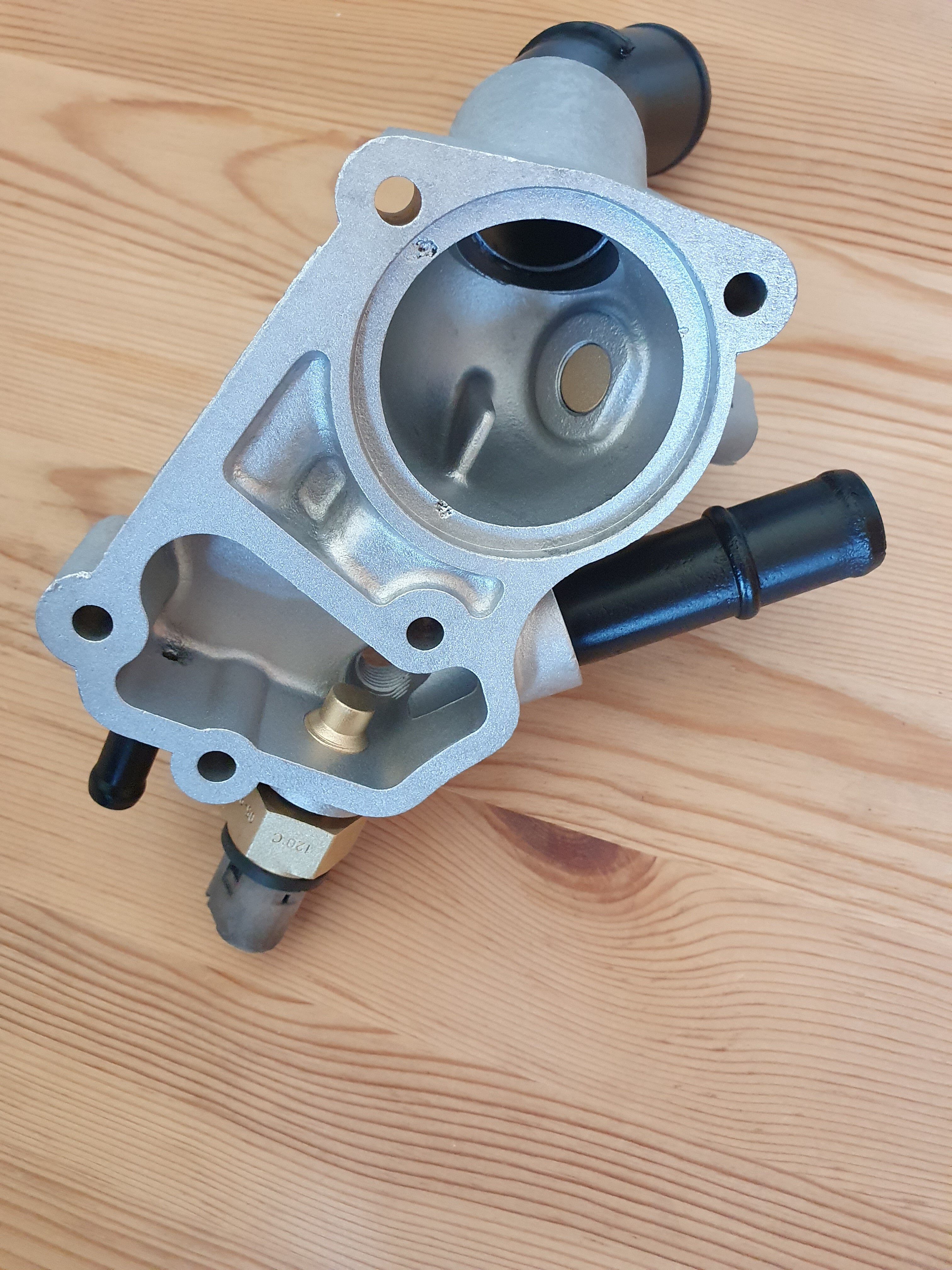

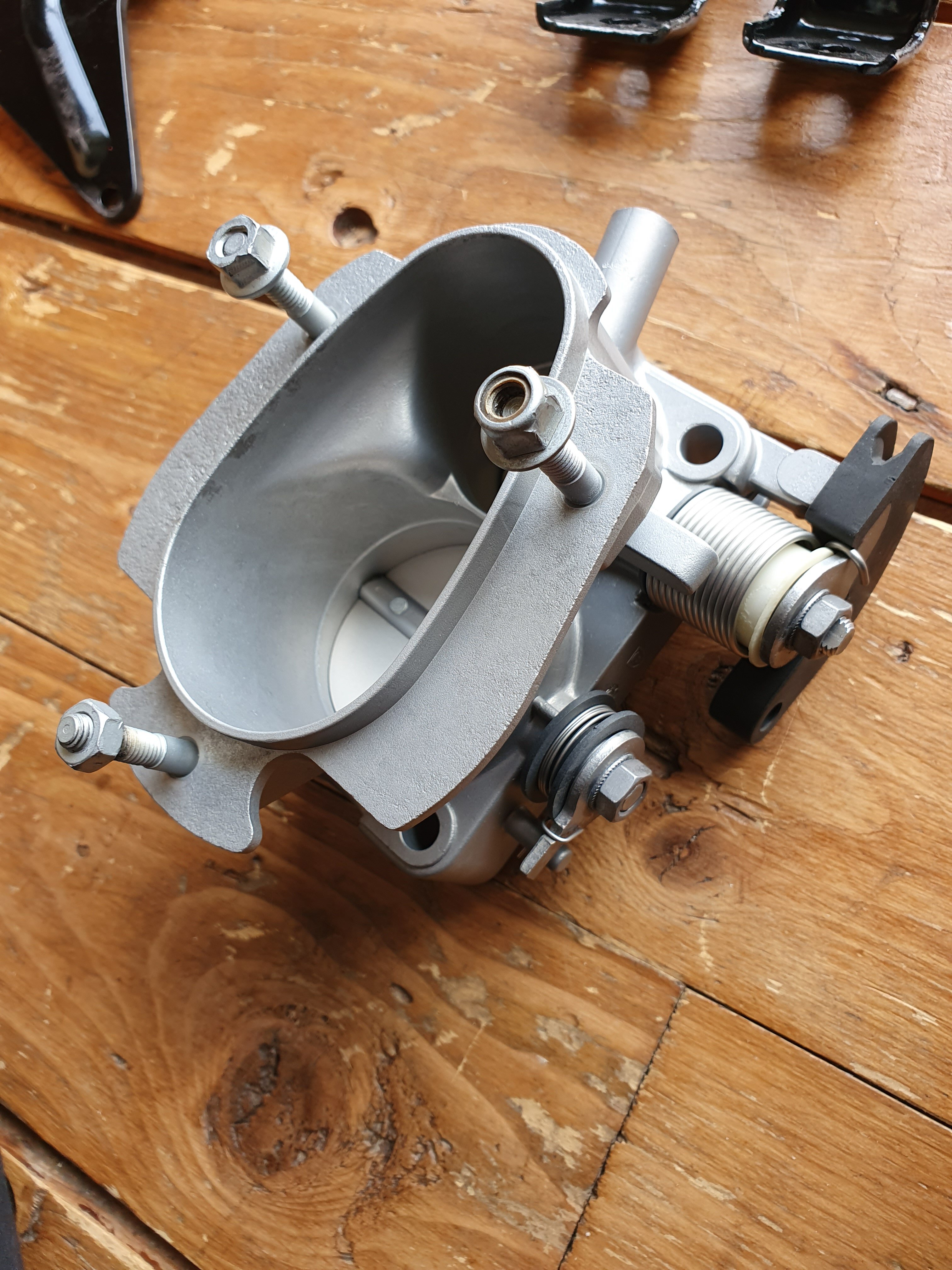

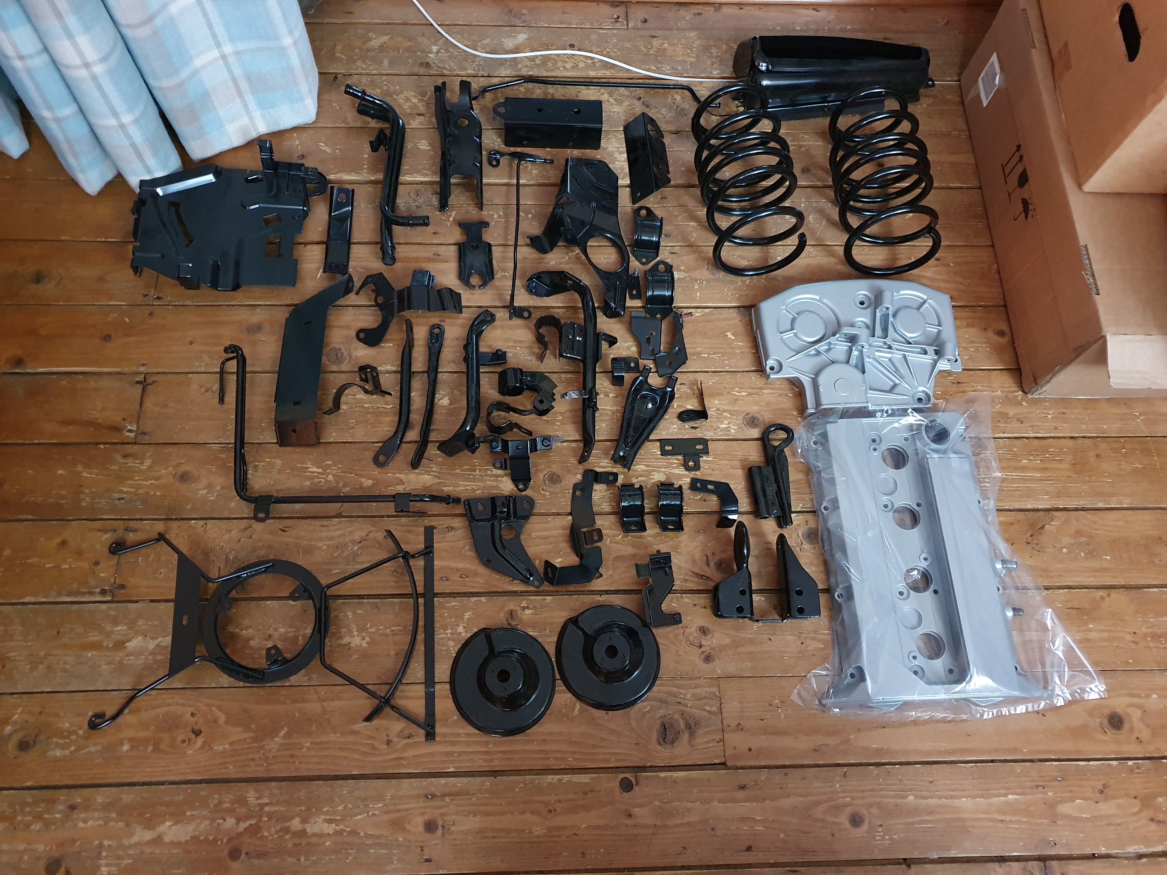

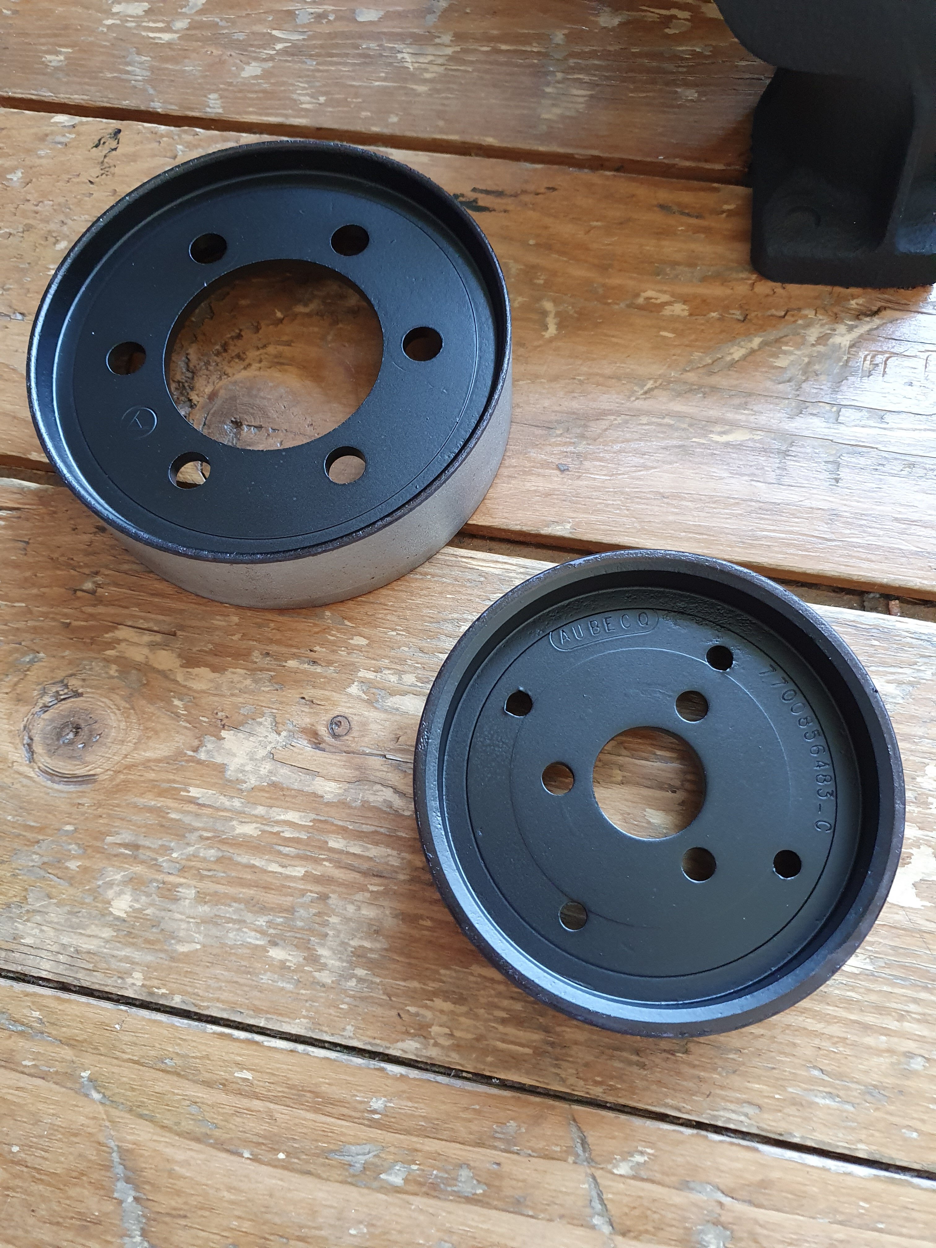

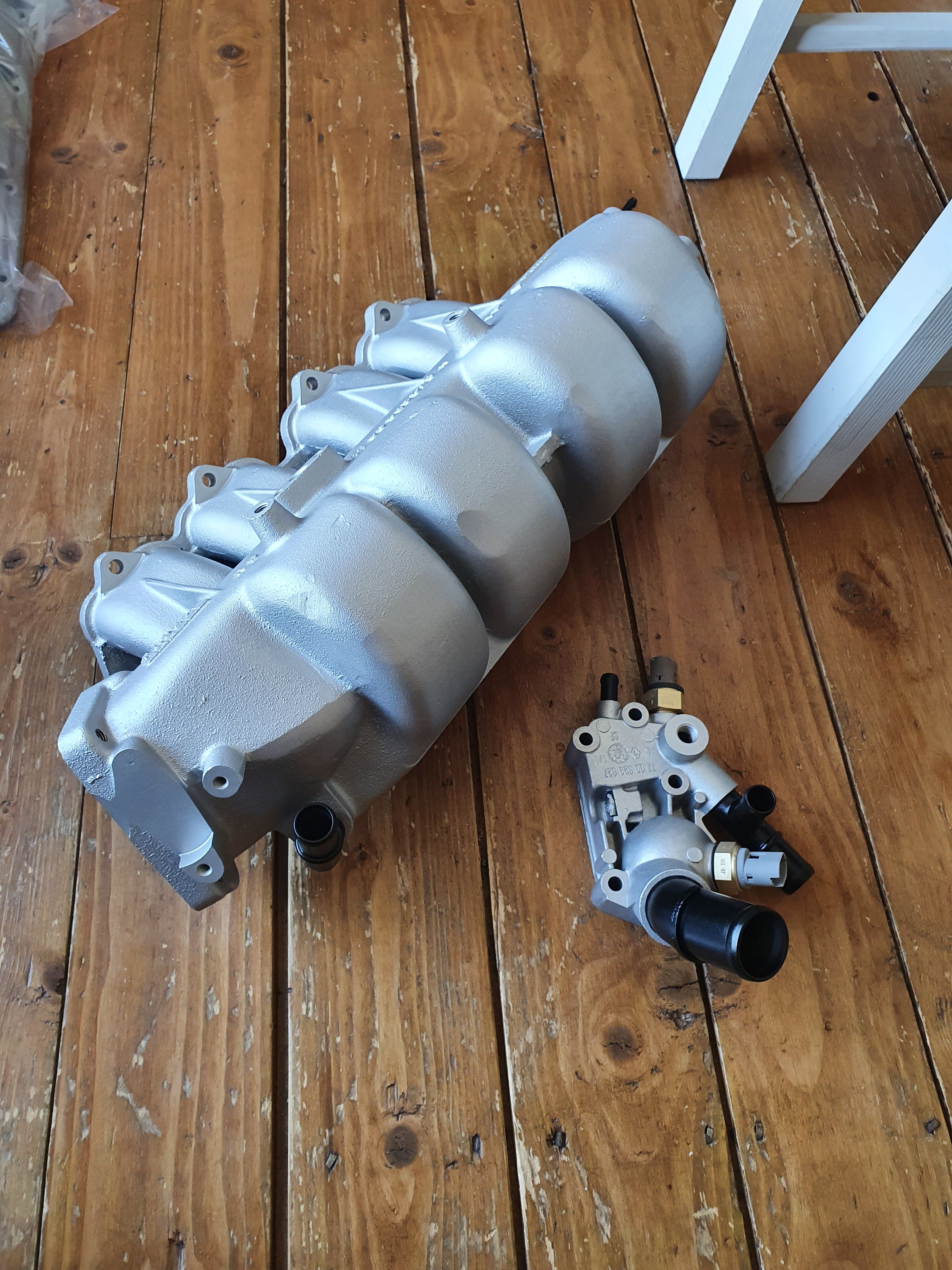

I currently have all the Ali brackets/inlet off for vapour blasting and plan to refut them bare as that's how I believe they came from factory
Rocker cover is being powdercoated in bright silver
Every pipe/bracket is being blasted and zinc primered/powdercoated black

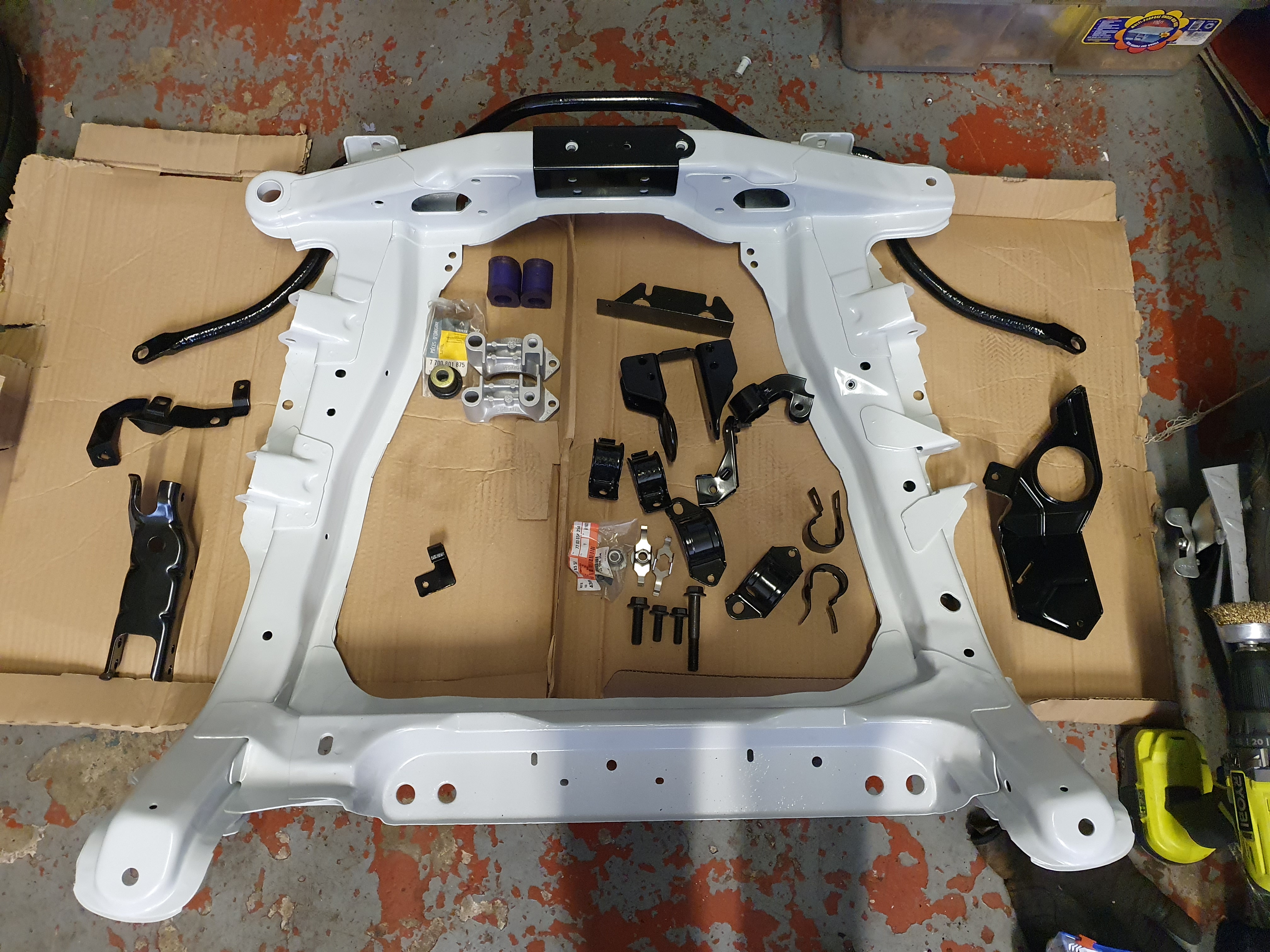

And I'm having the subframe redone in the original grey colour also
So that's where I am at the moment. I'm awaiting parts to arrive and the painted parts to be finished so will update as I go 🙂

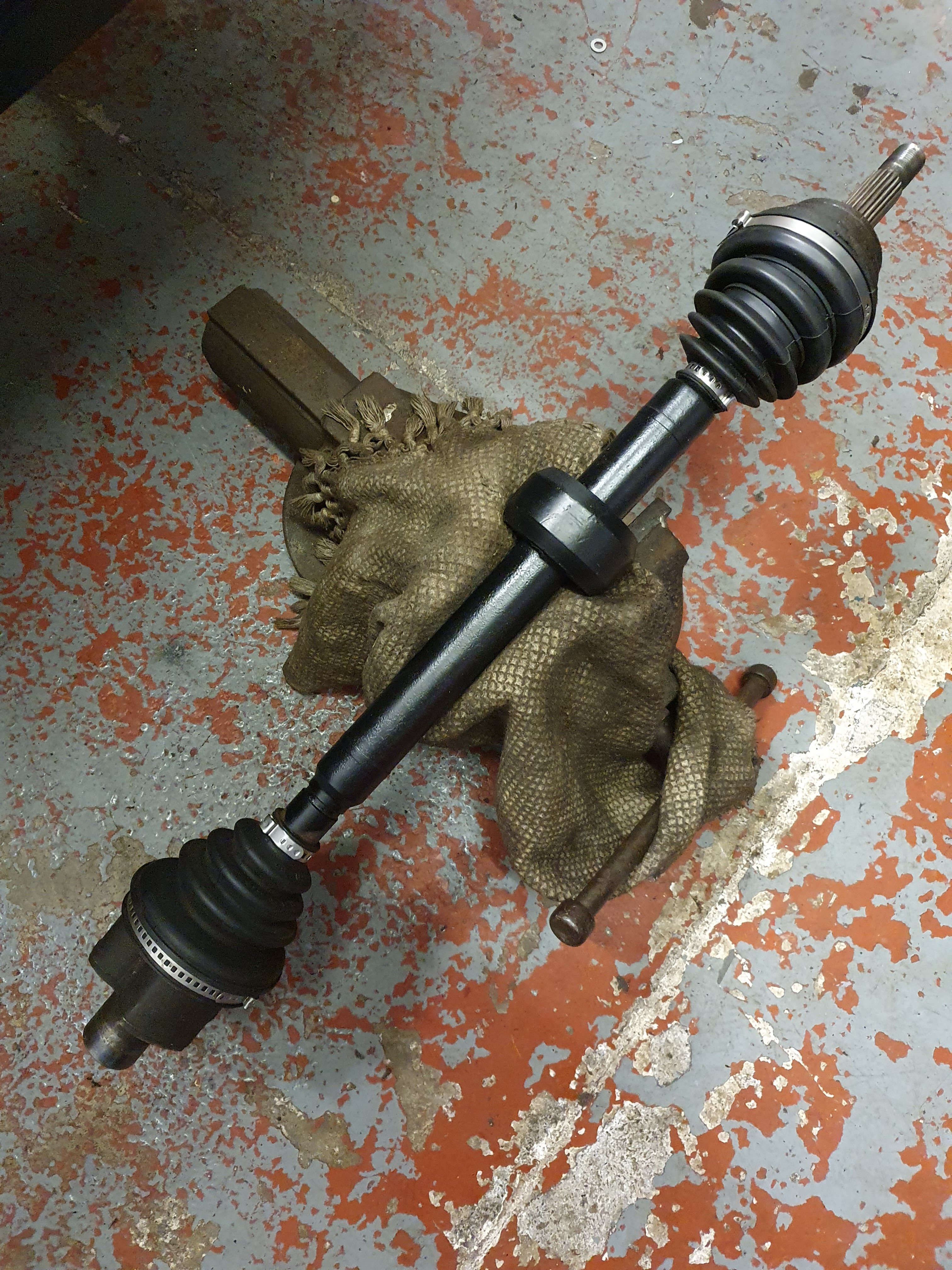

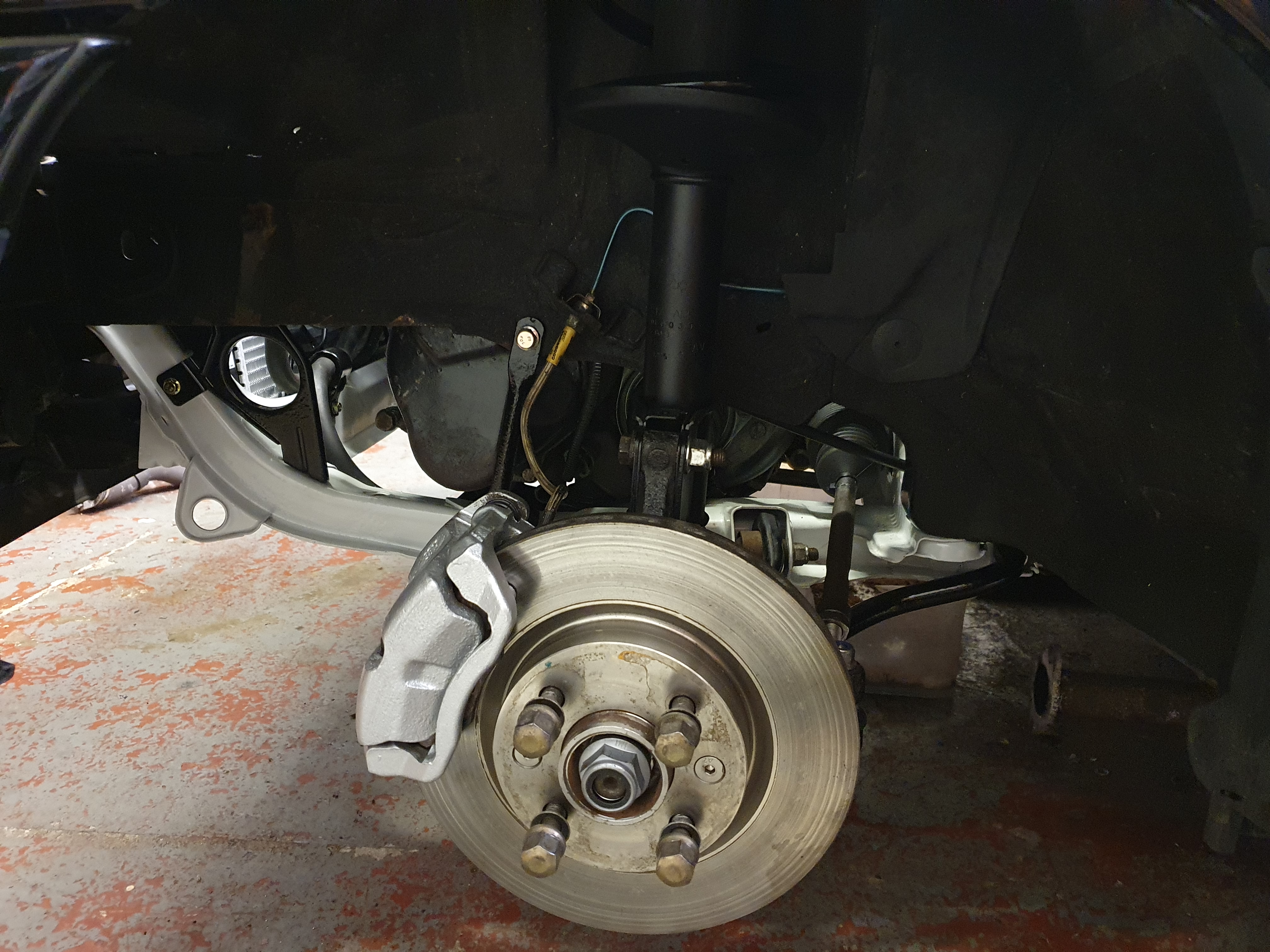

I haven’t seen your wishbones in your pics, have you blast and coated them and having new bushes pressed in or are them ones off eBay any good where you get a pair with bushes and ball joints all attached for £45?
So does it have that glitter to it in the sunlight? I’m trying to find out if mine is an original colour and the code.
Yes I read mk1 phase 2 was Jan 96 on. 110k full history and all its books but only one key.

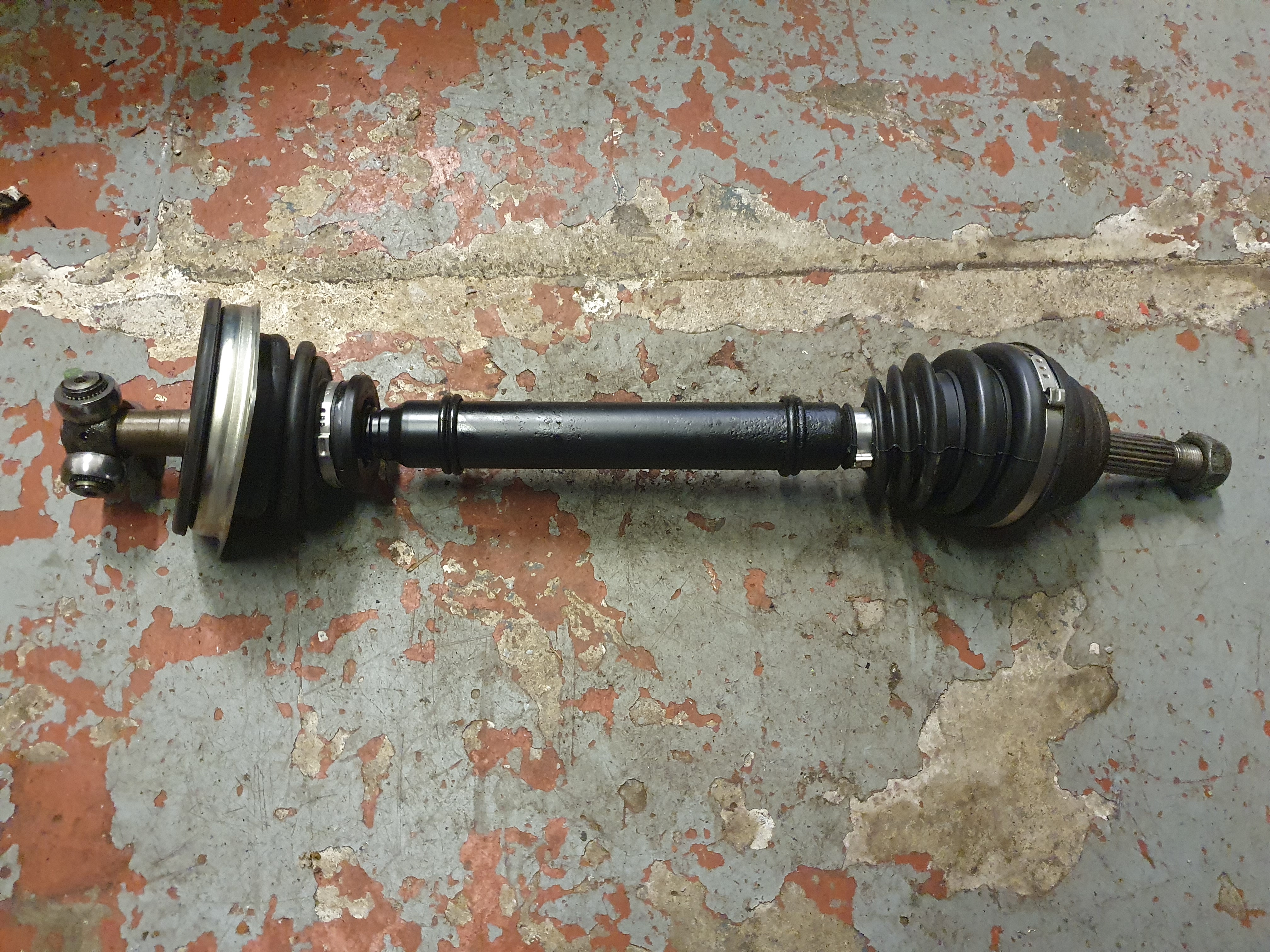

I purchased cheap wishbones 5 years ago off ebay, one of them turned out to be incorrect though after having a driveshaft explode so definitely need to be careful when ordering. Make sure they match the ones you take off. I haven't bothered repainting them as they are half tidy still

Pretty close to completing this now, all fluids topped up, got a few leaks where some of the coolant hose clamps iv used aren't quite tight enough. But so far so good for all other fluids. Seems to be turning over ok too so hoping to have it back on the road end of next week with any luck 🙂

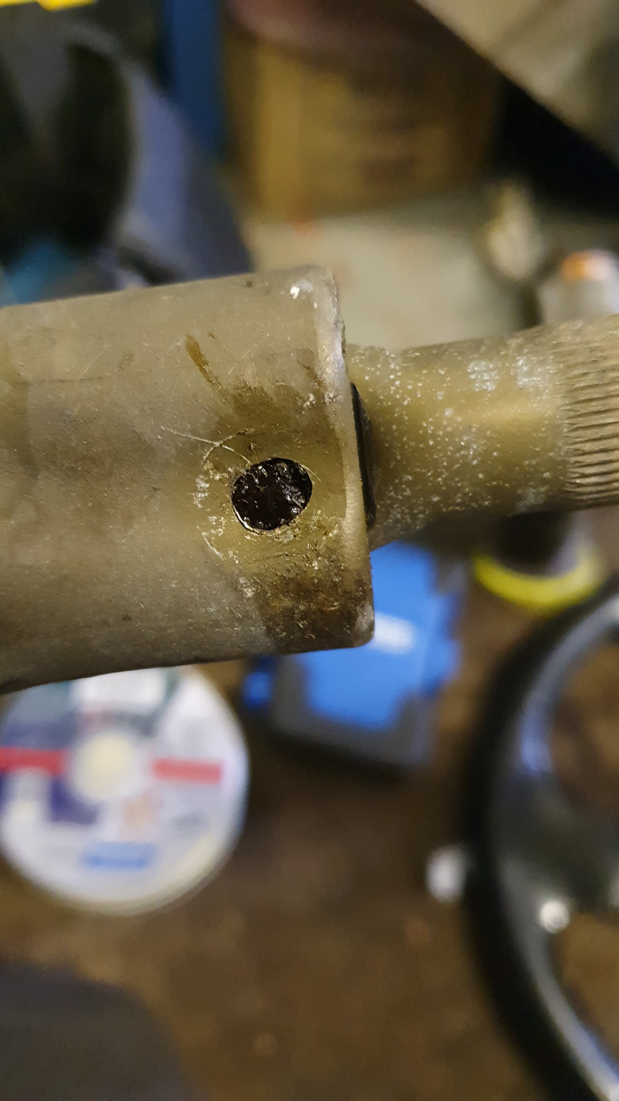

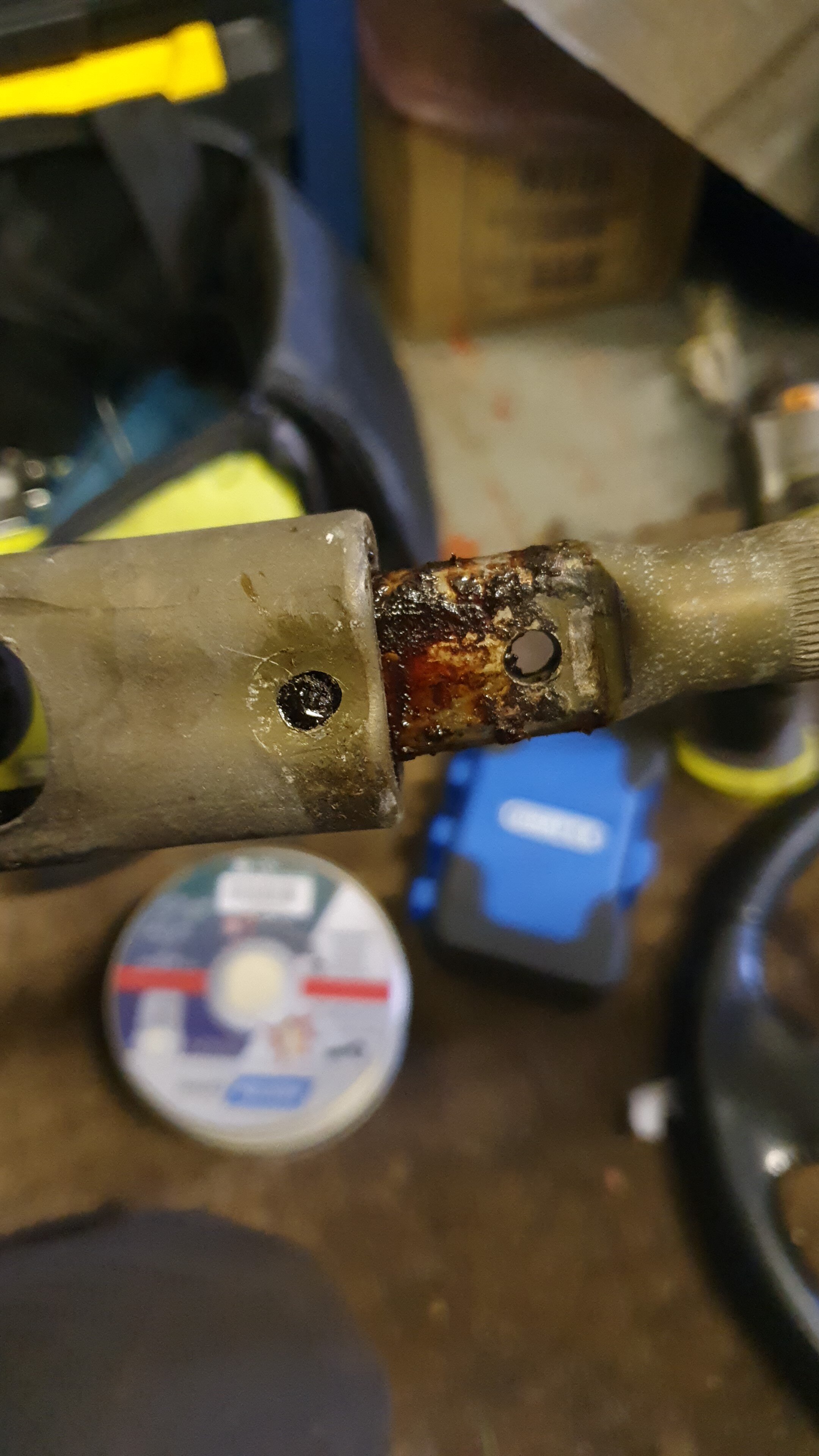

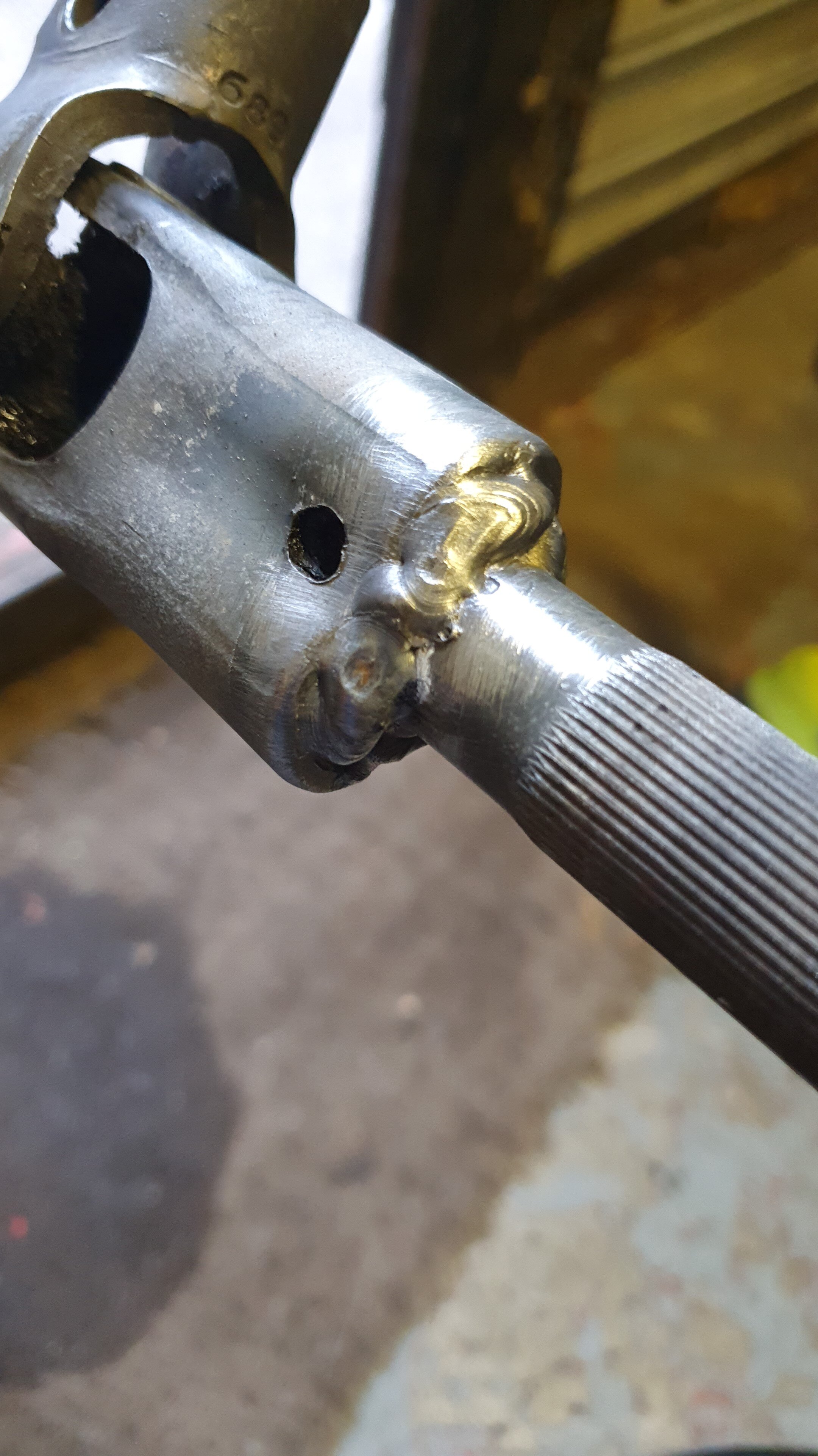

The steering has always been attrocious on my 16v, so decided to take a look at this stupid bush on the steering column. They tend to wear on the mk1 clios. Turns out mine must have been repaired in the past with a nut and bolt which has done sod all to help with the play. Column removed from the car as I didn't want to burn holes in the carpet.
Welded and refitted now the car feels 1000 times better than it did. Should have fixed this any time in the past 6 years of ownership 😂
