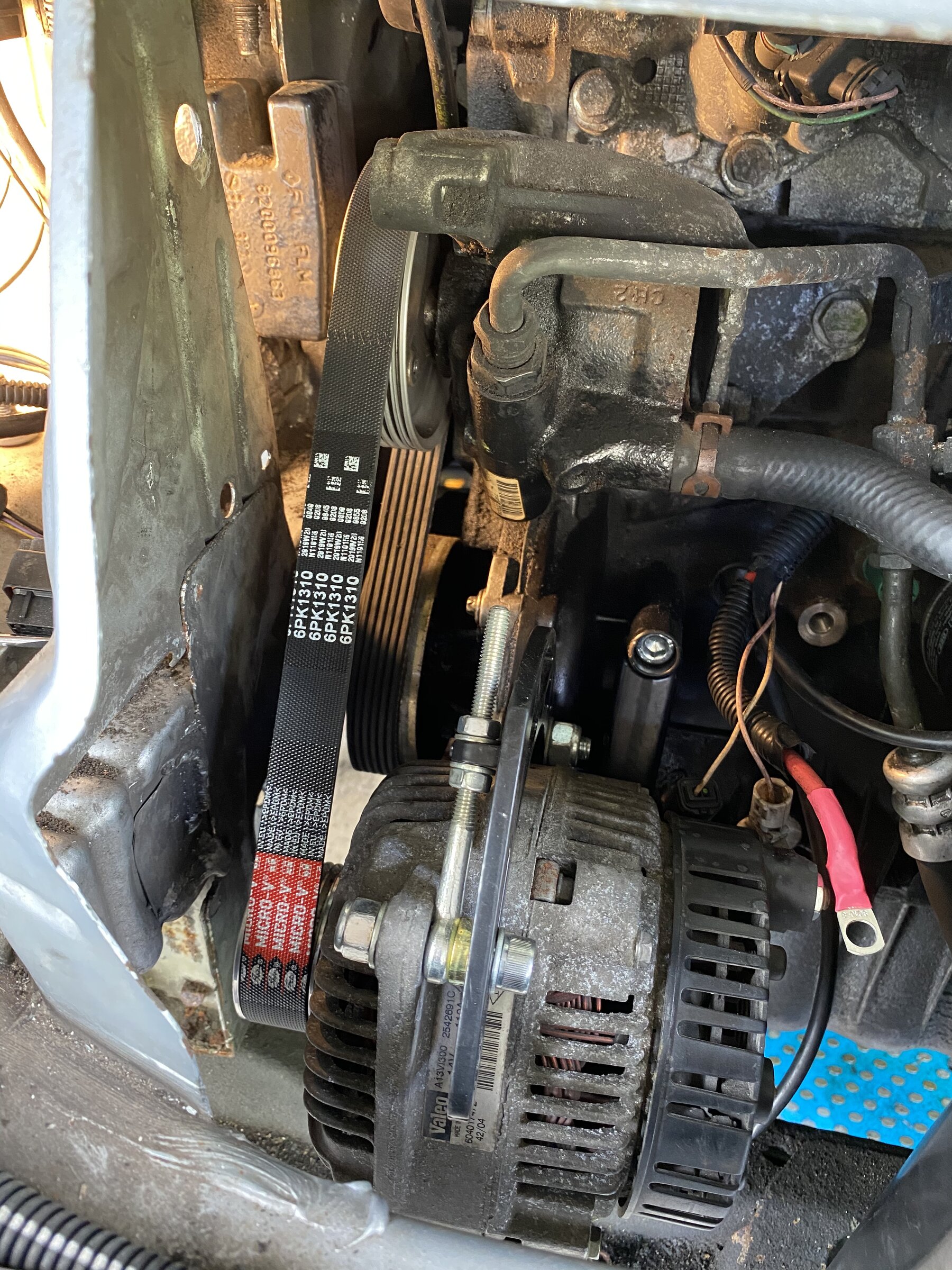

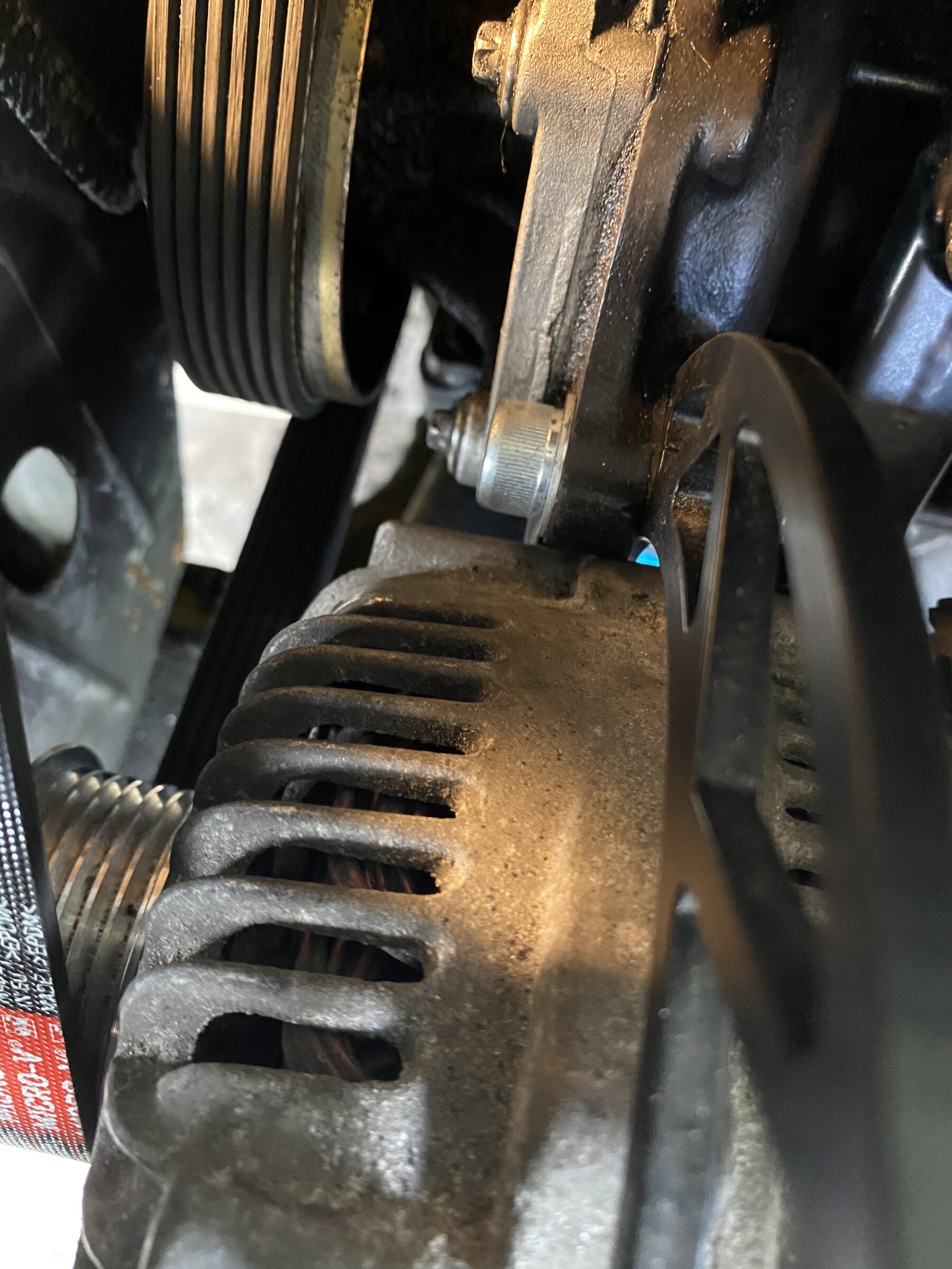

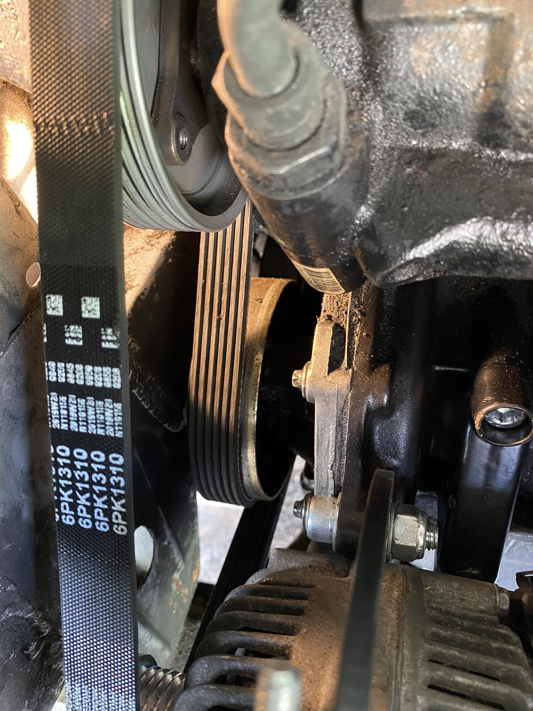

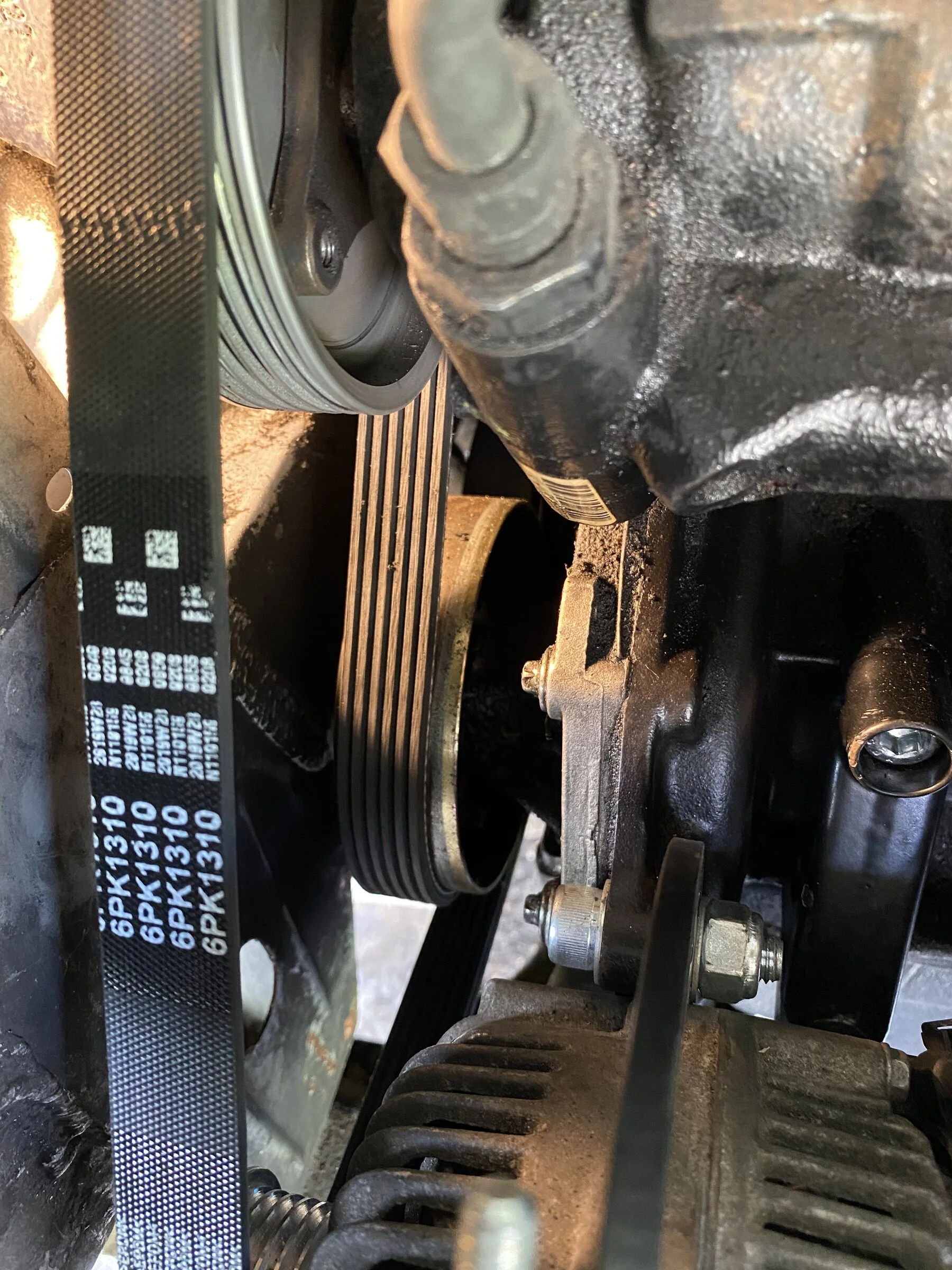

After managing to get the belt on the pulleys (removing PAS pulley). The belt doesn’t sit centrally or in-line on the middle pulley (picture attached). Tried a few times Taking the belt on offbut always got the same result
I haven’t yet turned the engine of by hand via the crank pulley (furthest back/lower ribbed pulley?) as I ran out of time - will this rotation of the pulleys and belt move it in line?
Alternator also seems very close to the block, I’d say it’s touching if not 1mm off - it will move away once the belt is tensioned properly I guess

To answer my above question. When I torqued up the PAS pulley it rotated the whole assembly, the belt aligned itself after a little turn.
