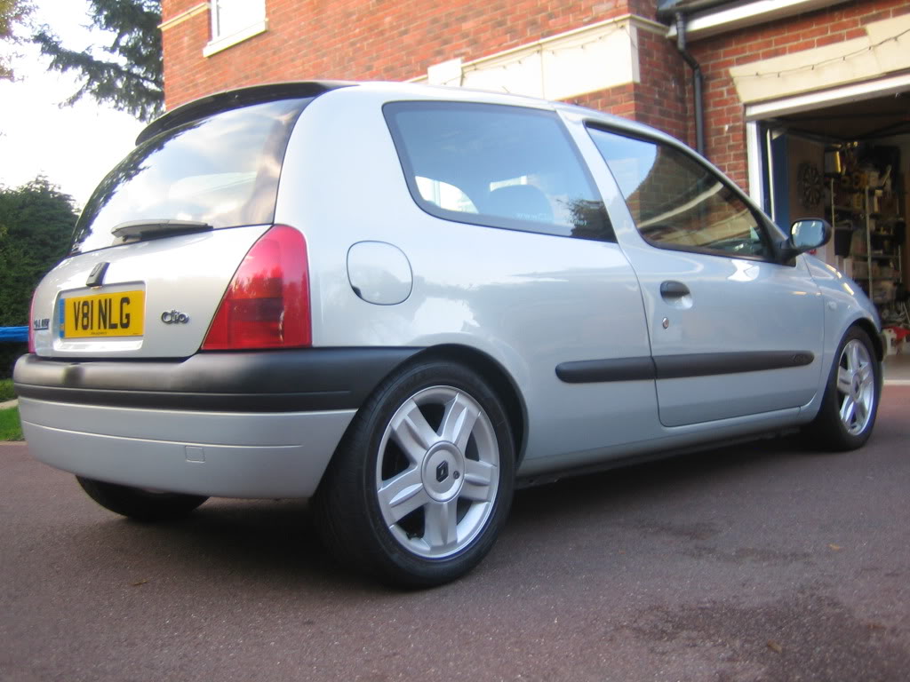

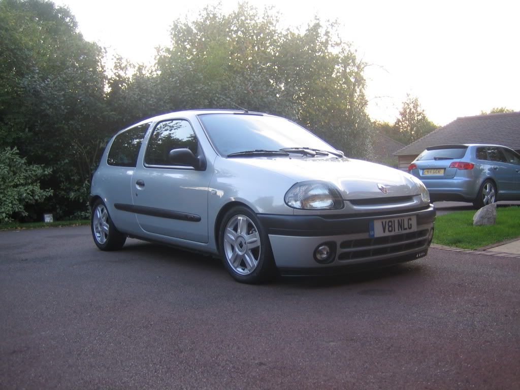

My old car. Clio Alize 1.4 8v :cool:
Lowered 60mm on PI springs, standard shocks.
Dynamique wheels with 195 50 15 tyres.

Looks really good mate! thats exactly what i'd have in mind!
Do you get much rubbing with that lowering? or any other problems?
Thanks for the post mate
I say this everytime, but, 60mm minimum on a non-sport. It won't rub anywhere, ever, unless you've got ridiculously big wheels on.
It rubbed a tiny bit on the rear if you really really hammered it round a bend but from reading on here a 3mm spacer or 185 tyres sorts that.
I had 5 people in it quite a few times and it never rubbed.
Definately worth it, if your going to lower it do it properly atleast 60mm. anything higher is unnoticable.
Thanks for the info lads! ill settle with 60mm, looks good, and aint likely to rub... win win! ill try getting some pictures up once its done. thanks again for the help.
