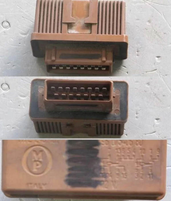

Check the big old double relay, IIRC its brown in colour. Its for the fuel pump and can be tempermental at best.
Edit: Love the car btw!
  Rb182cup+s2 rallye
i did tidy the loom up before taking it out so could be related to a relay, only 2 on the interior. ball ache unwrapping it tho :(
  Peugeot 308
Yeah there pretty unreliable, used to get through loads of them at work.
Looks pretty much like this.

jt yes mate it was the pump that was knackered, replaced with a gti pump and its working great. i can still feel it cutting on corners but it doesnt cut out just hesitates so ill be sorting a swirl pot set up out once i figure out exactly what i need. ive put a thread on rr but its had no replies and doing a search brings back no decent results.

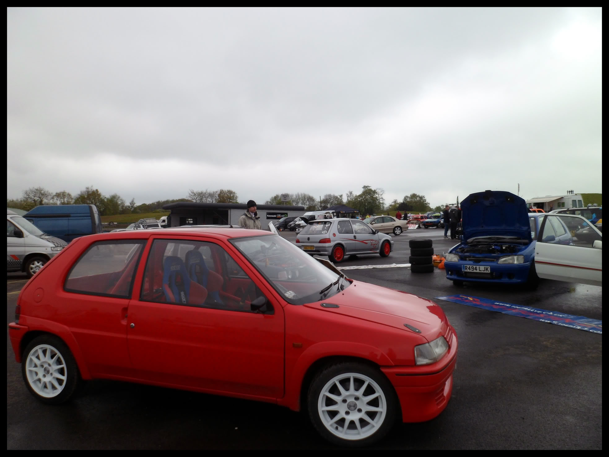

took the car to mallory on saturday and managed to get a blast on track. right before my first session the car over heated in the paddock and like a complete moron i slightly undid the radiator cap and boiling waer exploded everywhere. still cant belive i did it, went all over my arm face and mates face lucking just slightly red on our faces but my arm and armpit came off worse my arms blistered.
let it cool down re filled with water and away i went only managed 2 laps on the first session.
the car was suffering from real bad fuel starvation as you can see from the vid. enjoy
